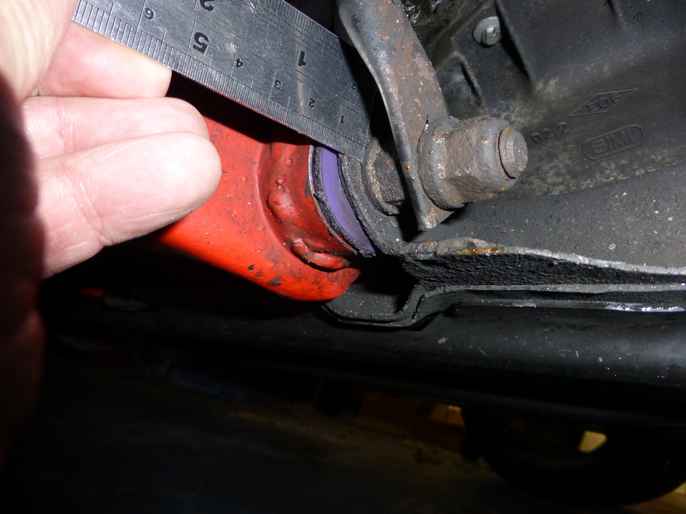

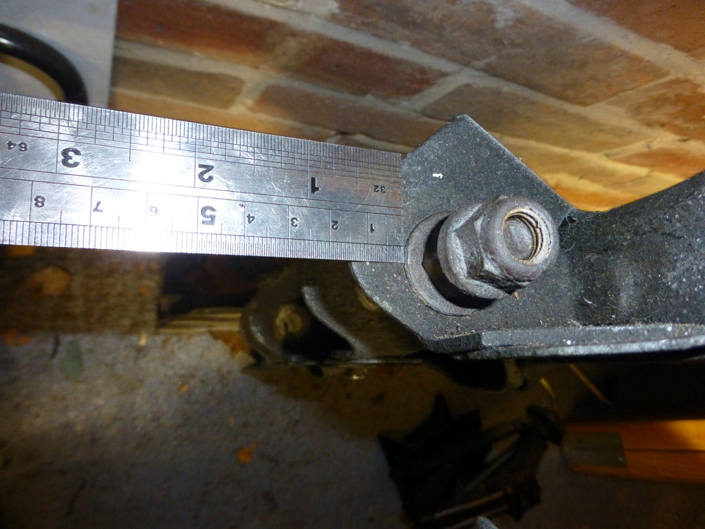

I doubt it, until someone shows pictures comparing the 2 and an alignment reading then Im not convinced. Some people have 2 deg caster on their 182 even with updated wishbones when it should be 3.3, so where is that caster coming from??

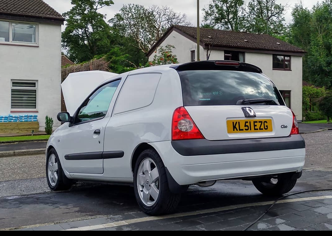

i had them side by side and they were identical but the 182 one had been knocked in a bump so i went with the vans DCI one.
I see. Some says that the mounting holes for the wishbones are some good millimeters inside.
