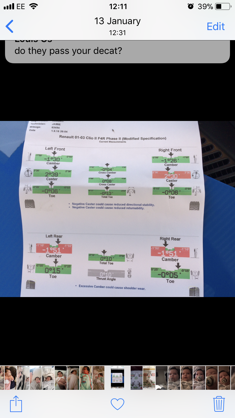

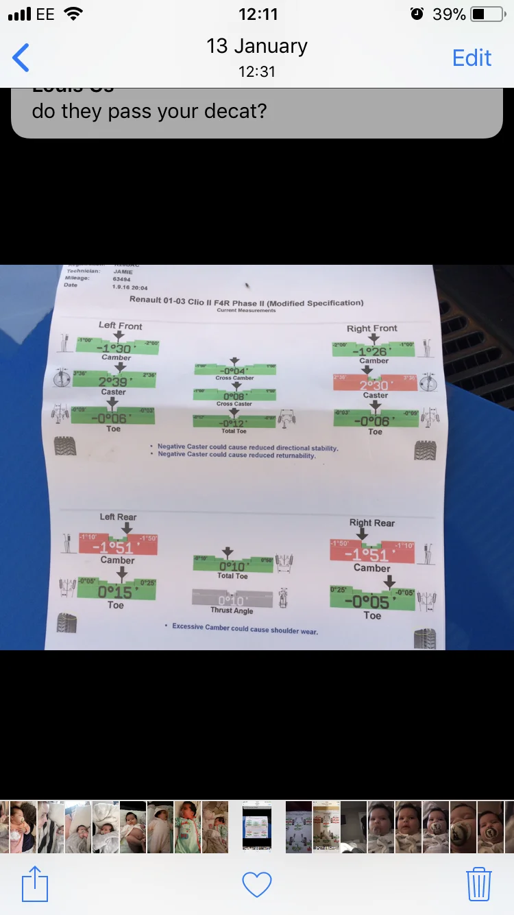

Im on cup shocks - mark fish trophy eibach springs - its on my Kangoo 172cup. Turn in is s**t hot - not done loads and loads of road miles however the tyres do not seem to be suffering.
