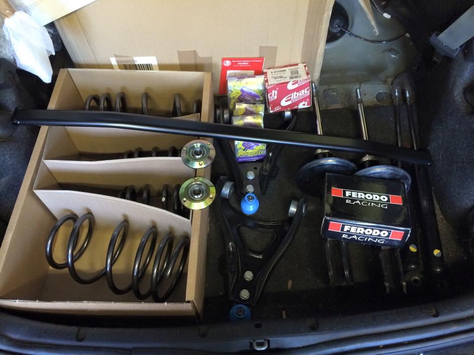

So far I've got the following:
Set of OE shocks
Cooksport springs
OE wishbones with balljoints
PMS top mounts and strut brace (probably total overkill with this setup to be fair, got a touch carried away with the shiny bits :D )
Front camber bolts and a pair of 1 degree rear camber plates
On the suspension refresh side what I'm looking for are suggestions for anything else that would be a good idea to do while the car is already in bits to have that lot thrown at it so that I can save on labour charges, front ARB bushes for example?

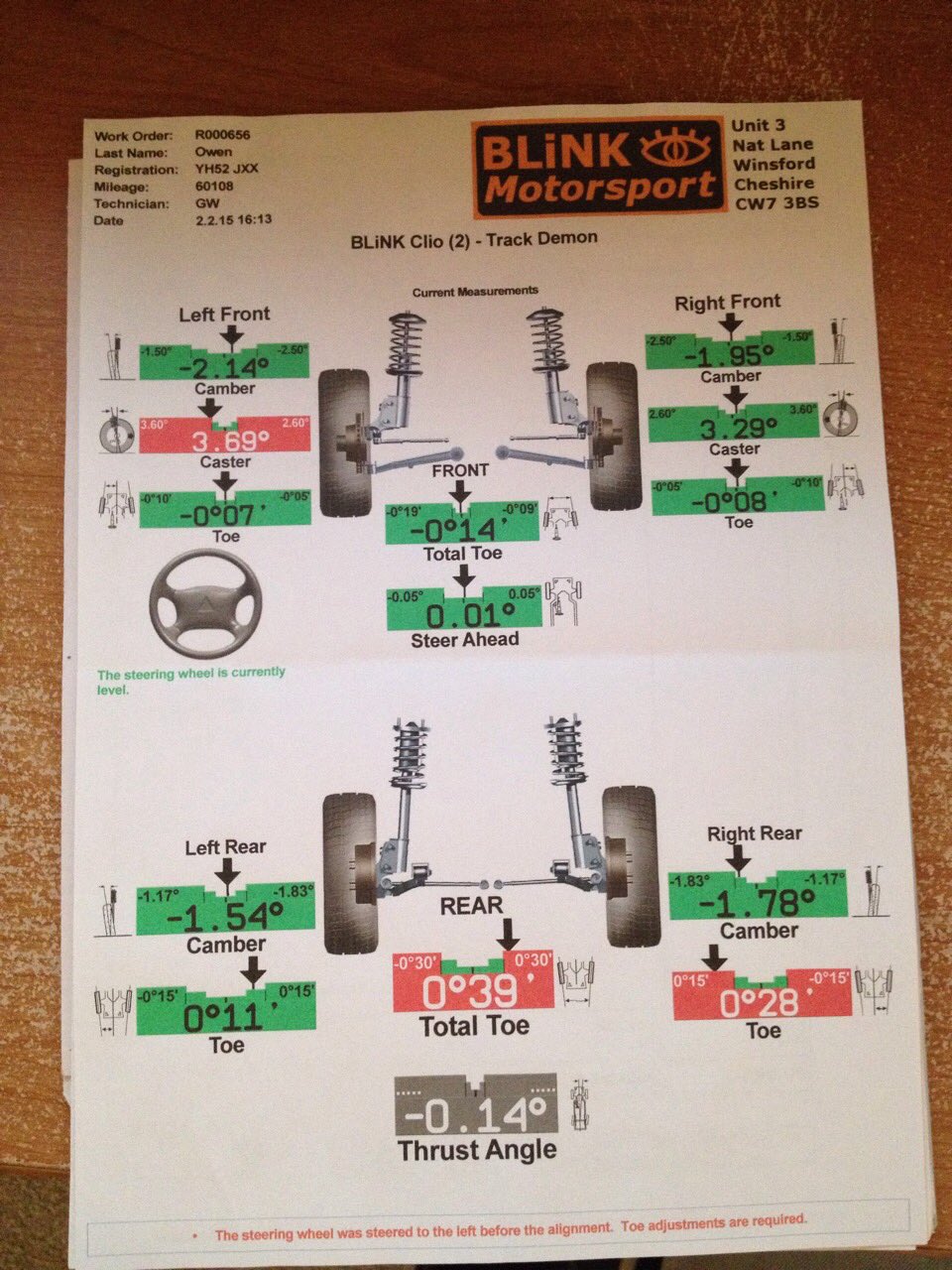

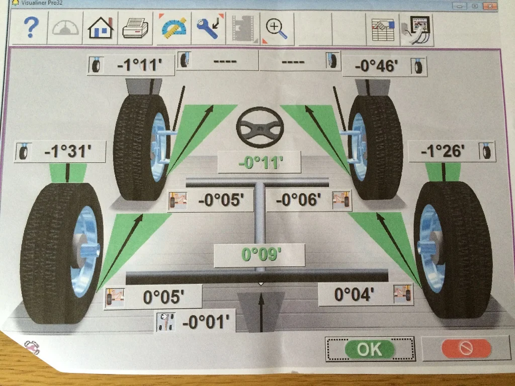

This is my last alignment printout which was done just before I got the car. Does anyone have any suggestions as to what would be a sensible track day/fast road setup? I'm a bit new to actually looking at this myself, usually I just hoik it at a specialist and tell them what I want to achieve. Should I be looking for more camber? There's a place just down the road from me with a full alignment rig but they just set it to stock settings unless you tell them exactly what you want. Or can anyone suggest a good place to get RS suspension setup done in West Berks/Hampshire?

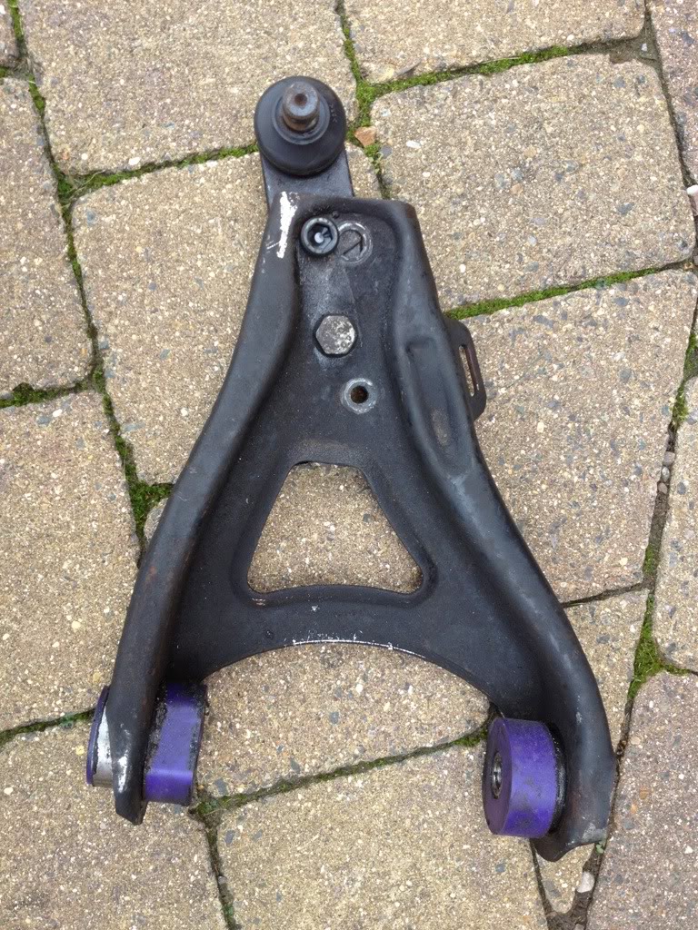

Not the best picture as this one is modified, but on the older ones the hole sat inline with the wishbone. On cup versions and later cars the balljoint was canted forward to give more castor.
charltjr
Thanks for that, I had a look at the ones I bought and I can see what you mean. The balljoint is definitely not in a straight line with the wishbone, it's at an slight angle so the mounting point will effectively be pushed forward.

Just been doing a load of readings about geo setup, talk about a dark art!
I think I'm going to go for normal road toe settings but add some extra negative camber, use the 1 degree plates on the back to get close to 2.5 and set the front to 2.5. Anyone got any comments on that?
Was quite pleased to see how close the rear camber and toe angles are on mine, some other examples I've seen have pretty substantial variations!
  Track 172 Cup
Here was my setup from blink set too their Track Demon settings. I have camber bolts and just bought a shim to correct the rear toe.
charltjr
Mine's standard at the moment but once it's on the CookSports am I right in thinking that will take the camber a little more negative? I'm in two minds about whether to put the rear camber plates on or not, they'd probably take it to something in the region of -2 to -2.5 negative rear camber. Too much?
The car is in all honestly used either on track or driving to and from the track for a good 90% of the time. It very occasionally gets some fast road use but I just don't have the time to get it out of the garage that often.
charltjr
I'm going to leave the rear camber.
I'll give the car -2 degrees negative camber at the front and see how I go. I'm changing too much in one go in terms of suspension and tyres to expect to hit the sweet spot first time out. The suspension refresh and tyres will change the way she drives anyway, so I'll just get a near-OE setup and tweak from there.
Apologies for being the latest in a very long line of people to ask for an answer to a question to which there is no right answer :wink:

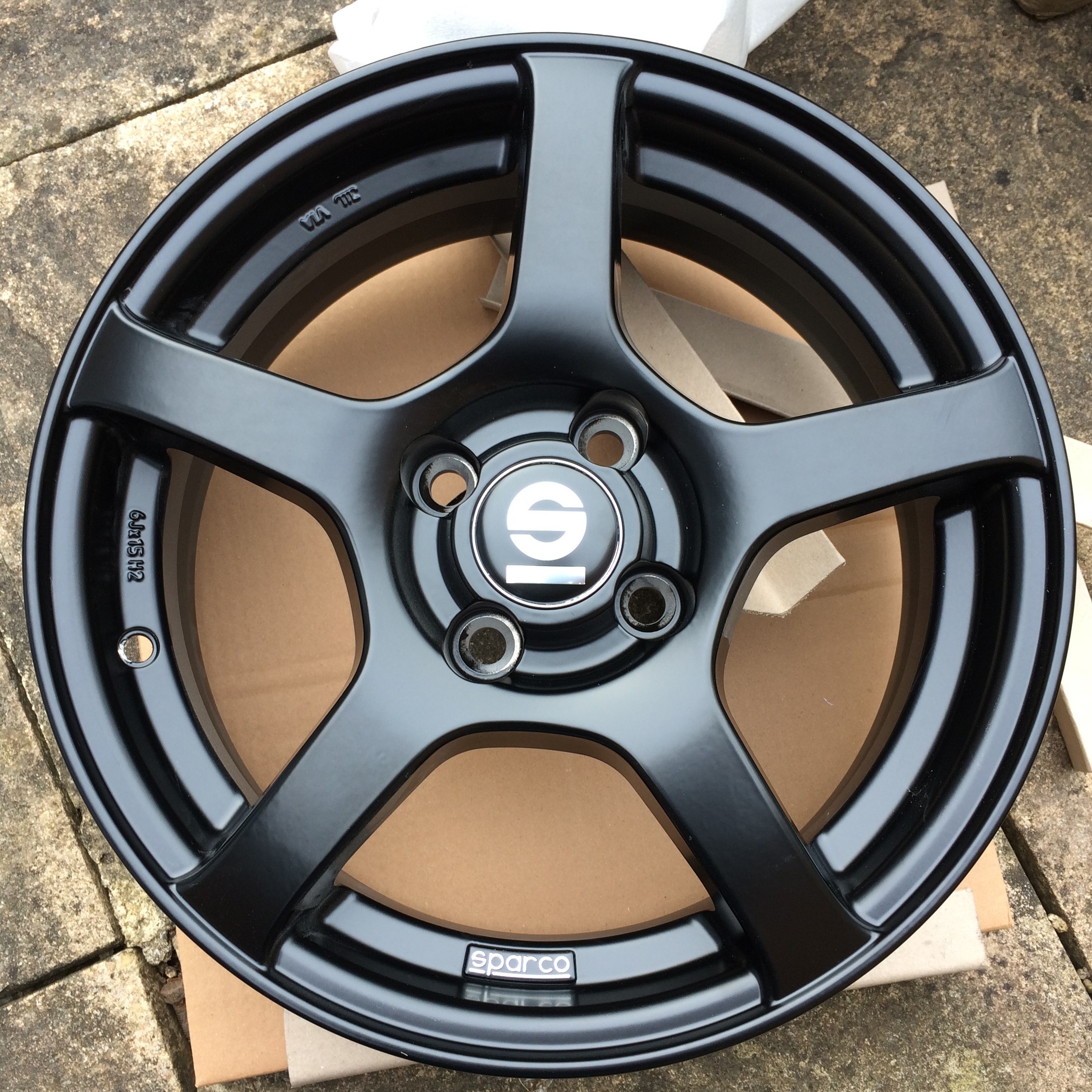

These beauties arrived yesterday, just wanted a decent set of cheap used wheels for the track but ended up picking these up brand new for £275. ET 35 so I might look into some spacers.

I got them from www.alloywheels.com - I actually ordered the silver ones but they phoned up and said they'd take three to five days but they had one set of the black ones on the shelf so would I like those for the same price. Wasn't really fussed about the colour, just wanted some decent wheels at a good price so said yes. Strongly suspect it was a "last day of the month, let's get this order processed and out the door" thing.

Front camber is -2.23 and -2.15, front toe -'8 both sides so -'16 total
Rear toe is a bit to c**k after all the changes at '18 and '2 but I can sort that later with some shims, I want to space the wheels out a bit more anyway.
Car drives really well after all the changes, I'm going to bolt the R888's on this afternoon and bed in the new DS2500's too. I'd really like to thank whoever designed the local roads for giving me a 1 mile stretch of de-restricted A-road with a roundabout at each end. Perfect for putting in the 25 to 30 firm brake applications the DS2500's want. :)
