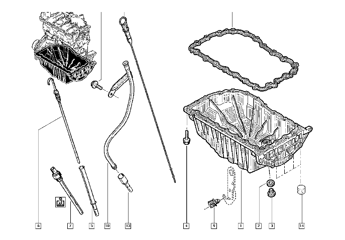

Don't know what the size is but they are item number 4
Pt No - 7703 002 705
Price - £1.92 + vat each
