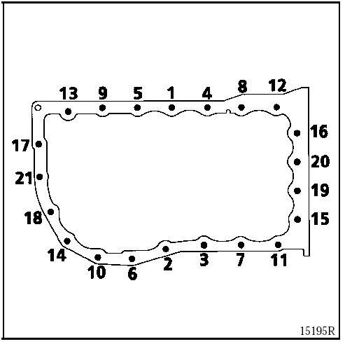

As above, I think with a bit of jiggling about you can get away with doing it without touching the subframe (from memory).
When refitting the sump, tighten all the bolts to 8NM, then tighten them to approx 13NM in the correct order working out from the middle rear. See below
Nope, It's either drop the frame, or raise the engine a bit! Curse to do! Is the weeping bad?
no need to drop the subframe, just lift the engine up a bit, tw*t to do though
Yep I remember you telling me this before I did mine! And it was an absolute ballocks to do! Hahaha! He'll have fun doing it!

Done it I didn't find it to bad as long as you lift the engine
high enough on the O/S. I found it easier to remove the slam
panel to allow the engine to be lifted high enough then the
sump pan just dropped out no messing around with wiggling
hear or there. Just my two pence if it helps????
