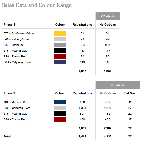

The sunflower register thread showed about only few on road with most scorned.
Think 29 or 30 were accounted for and about 20 odd at most left

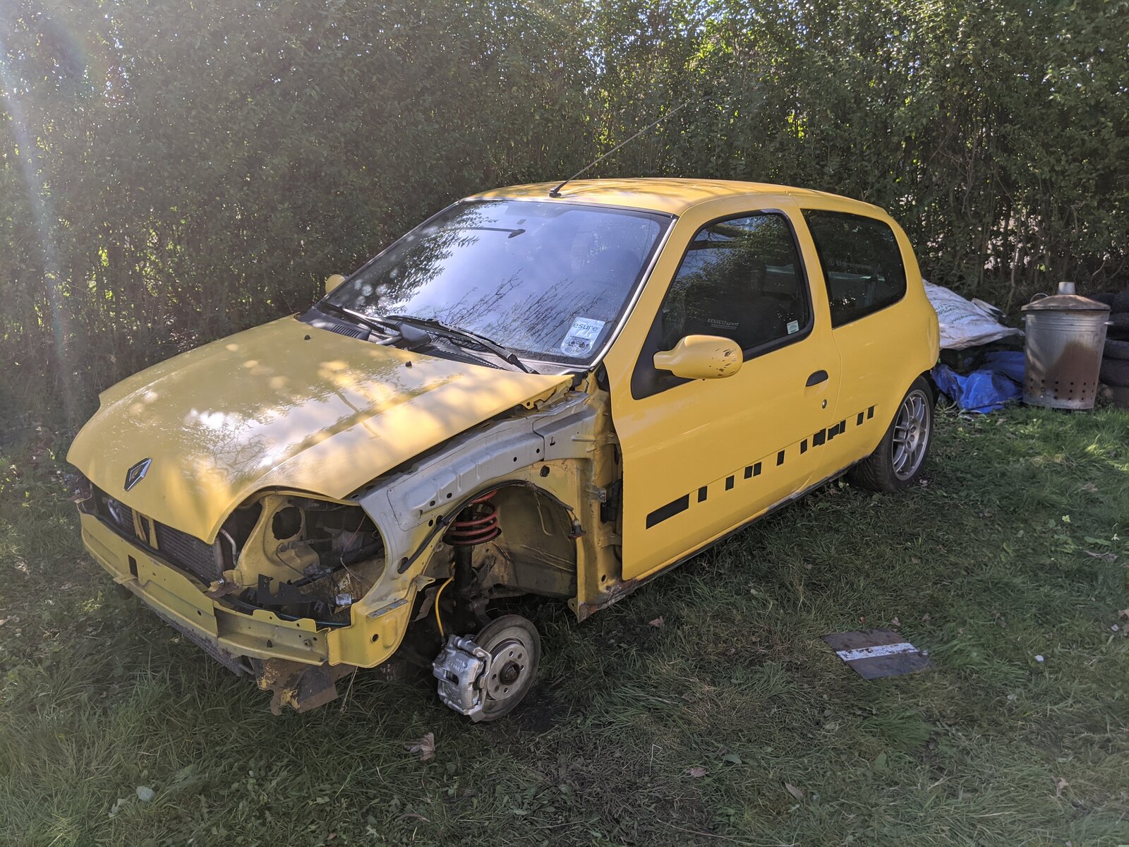

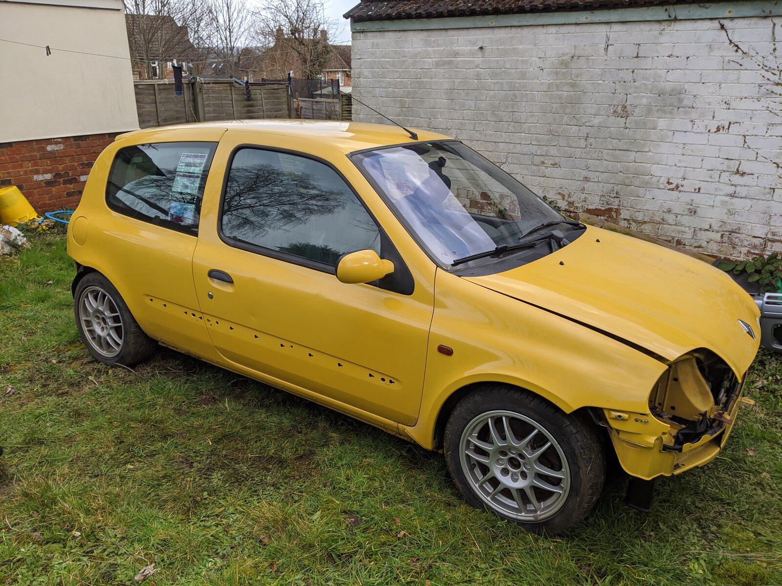

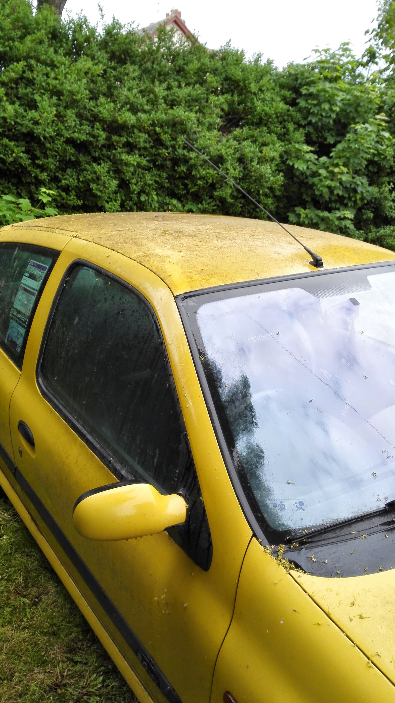

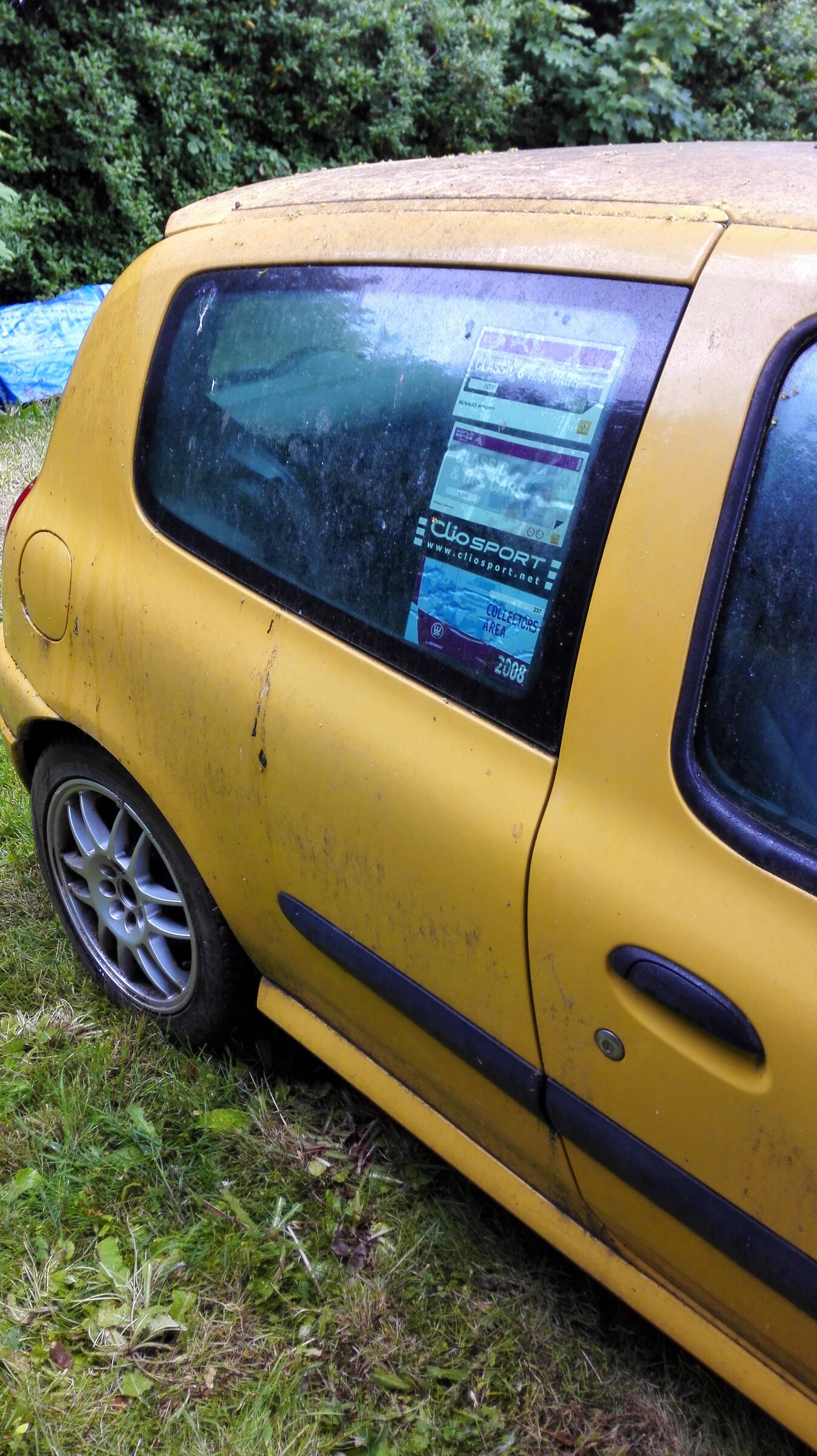

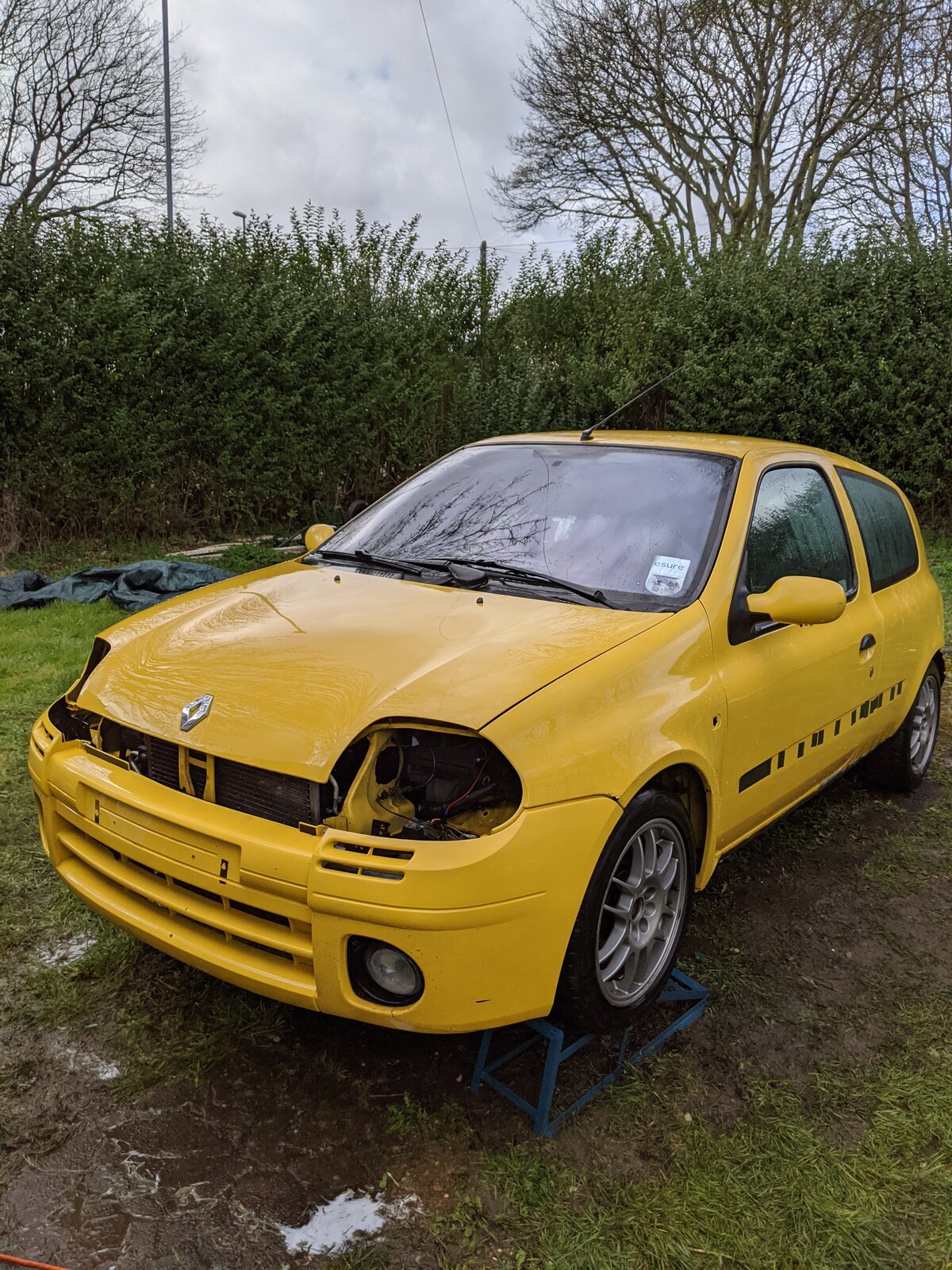

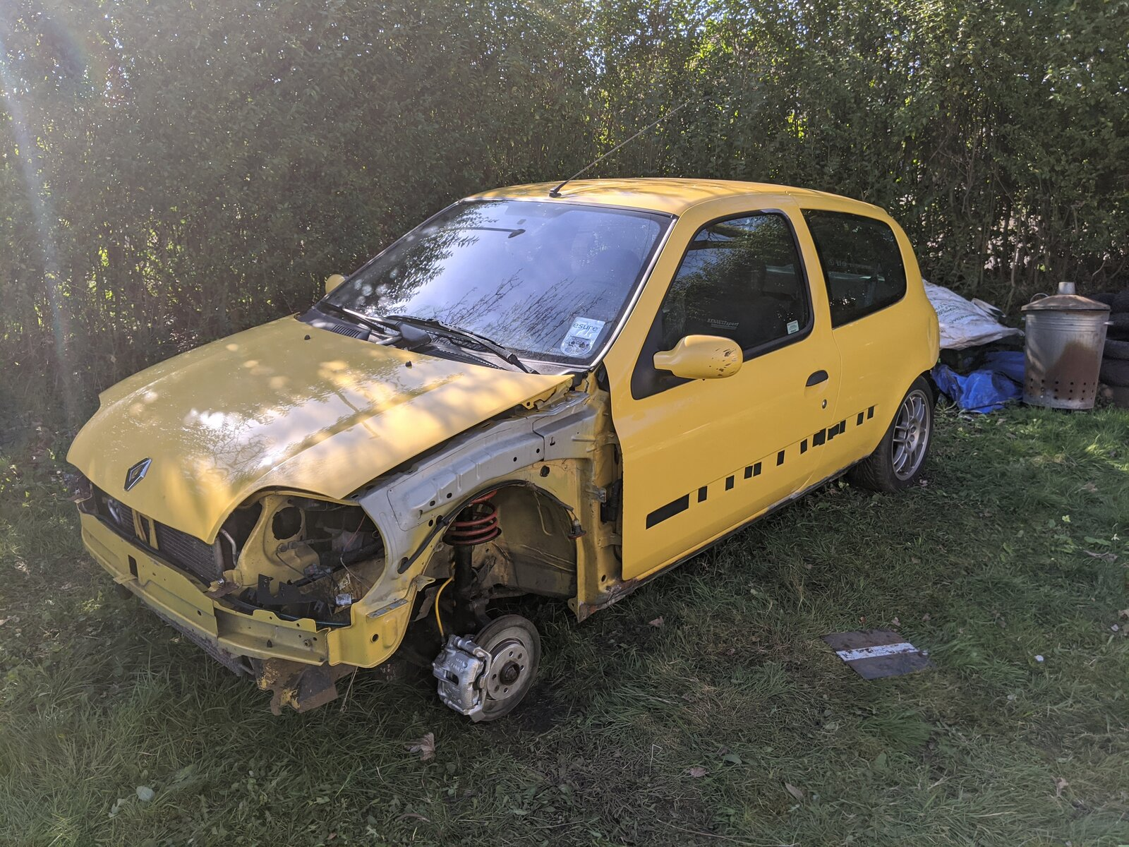

What are the plans for it? What needs doing?
firsst job was to disinfect the interior, after 8 years in the garden there was a good layer of bacteria.

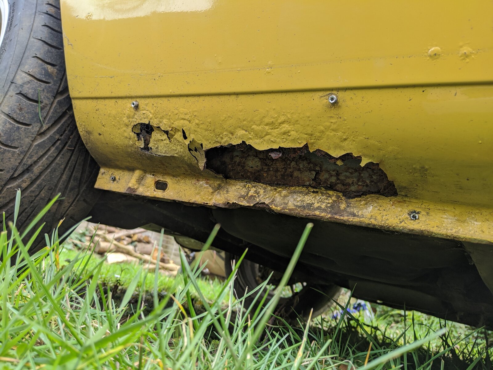

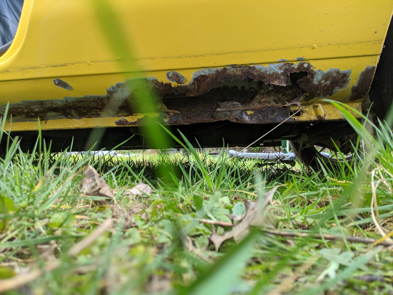

the sills need some work and should be addressed in the coming weeks with a bit of luck. engine management light is on, think it is either coil pack and injector change and will be healthy.
i have all the partse needed to rebuild it back to standard. it always has been a standard car apart from a set of proline springs due to it breaking a standard spring when i had it on the road.
it surprises me how good this car is, apart from the sills there is no rust, the paintwork needs some work.
think im going to do get the engine running as it should and get the sills sorted then decide what to do with it from there onwards.

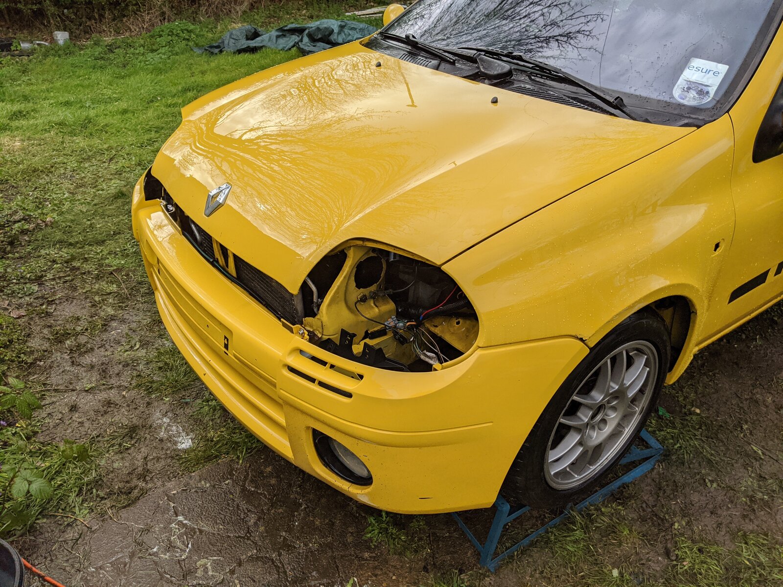

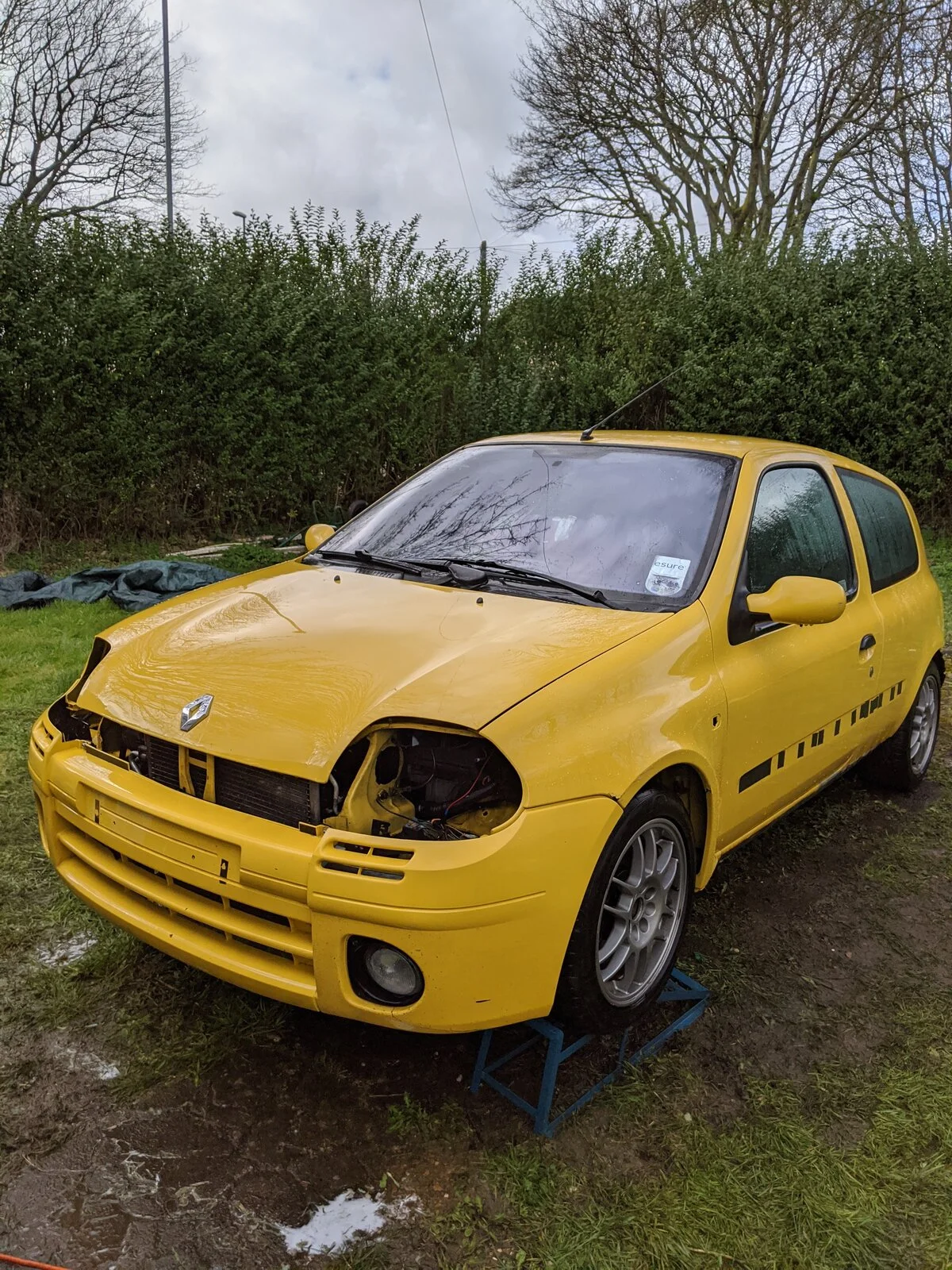

We are on a roll ! Taking shape.

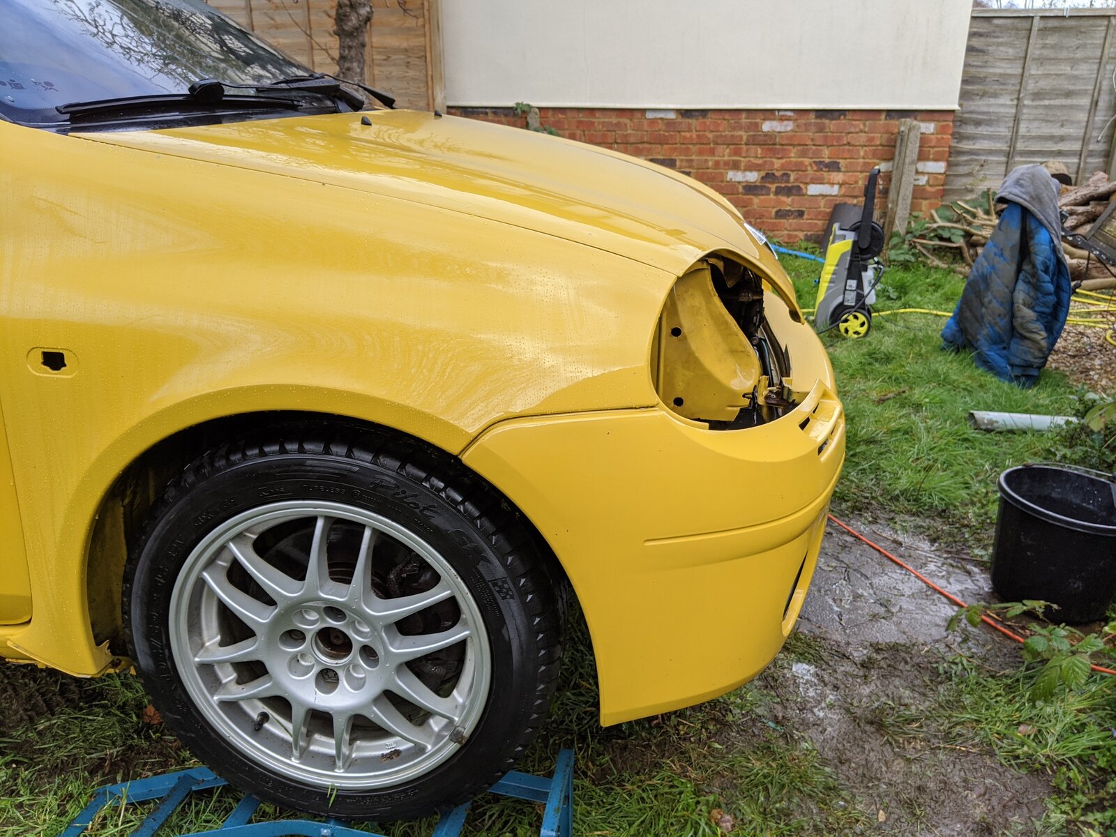

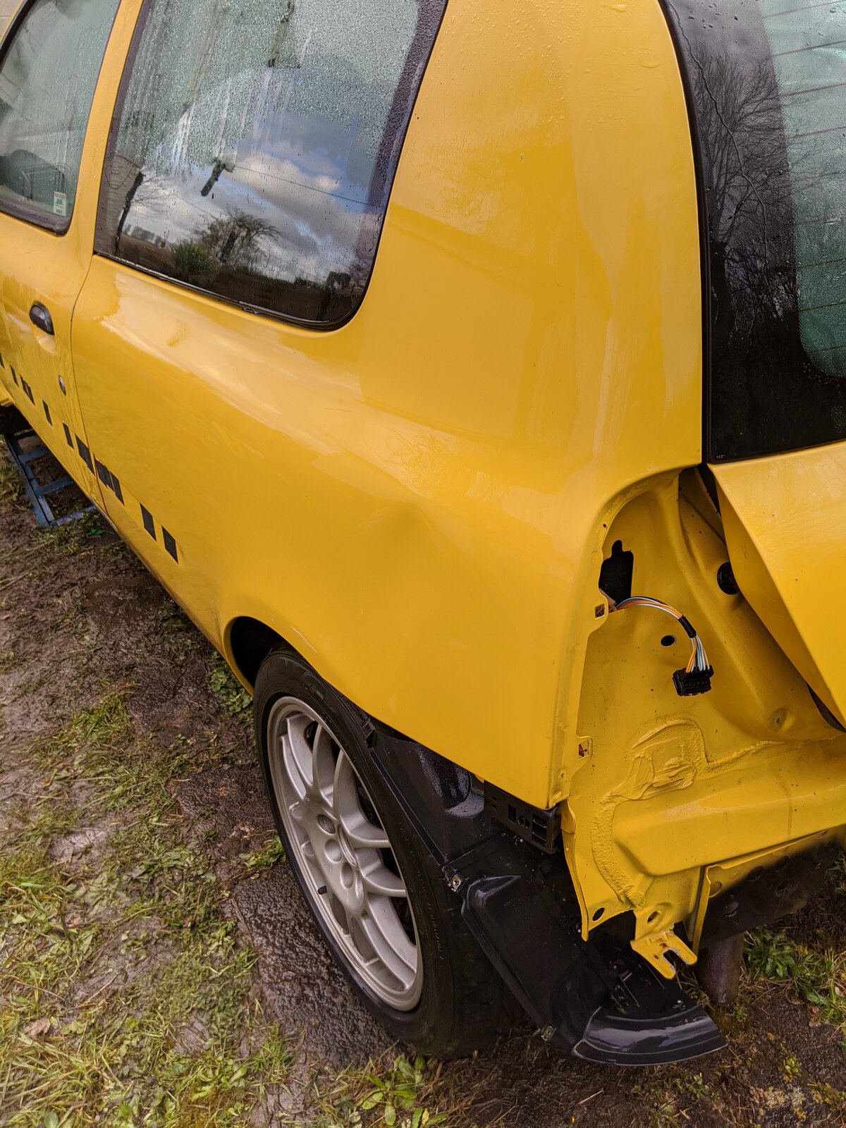

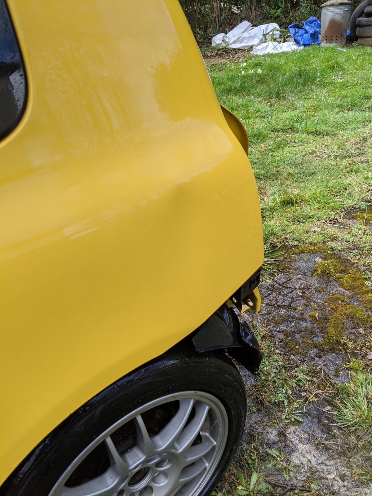

Sorted engine code this morning. Injector issue

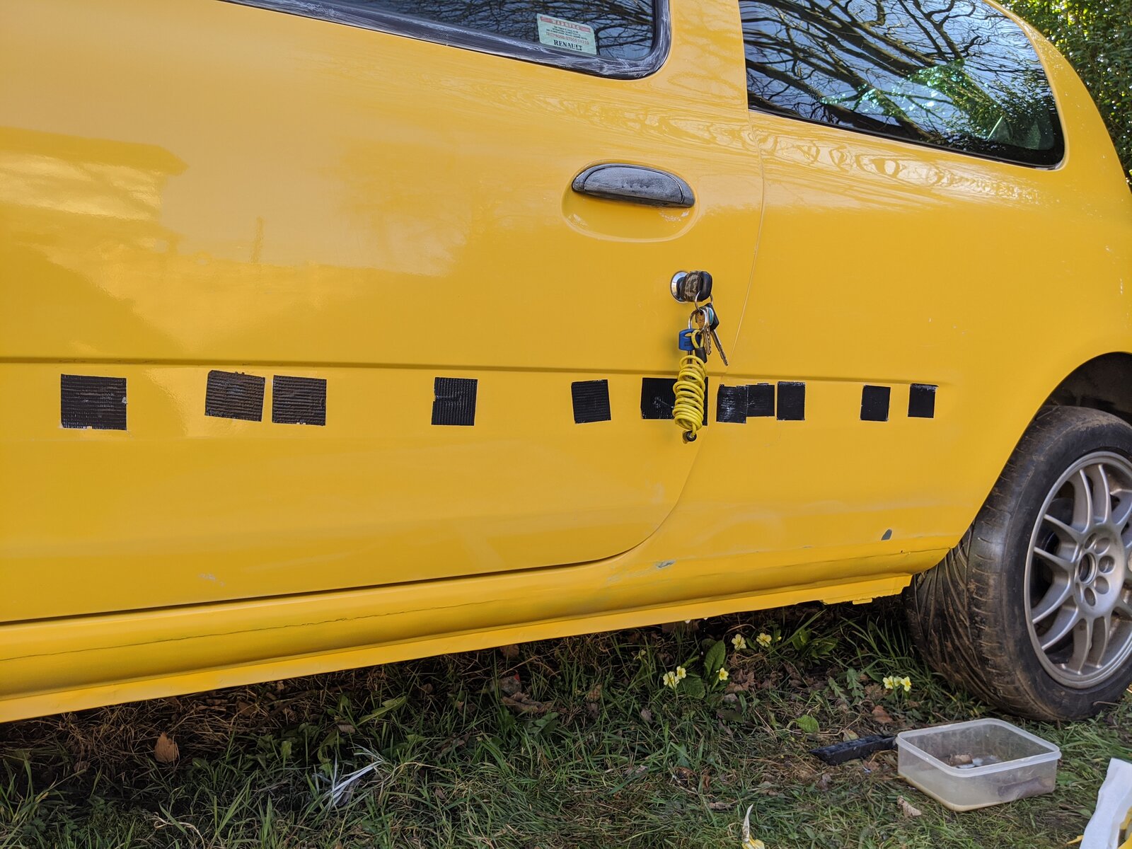

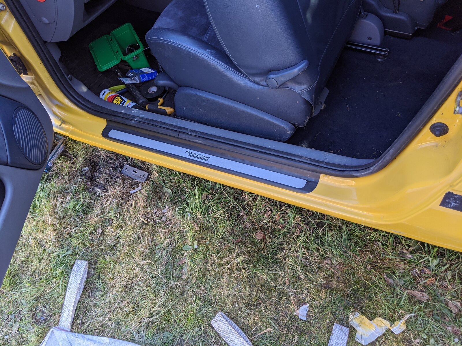

  172 Sunflower

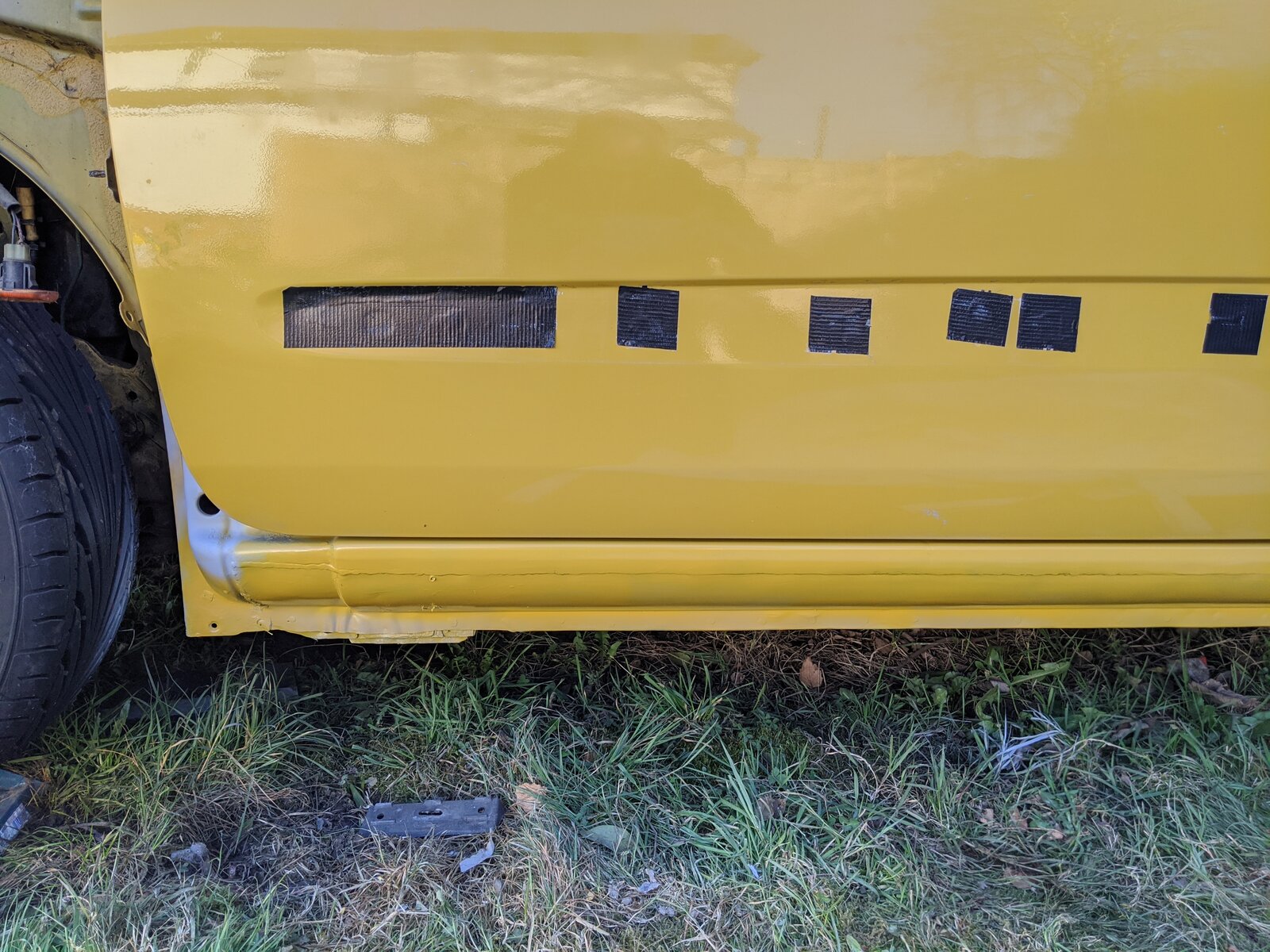

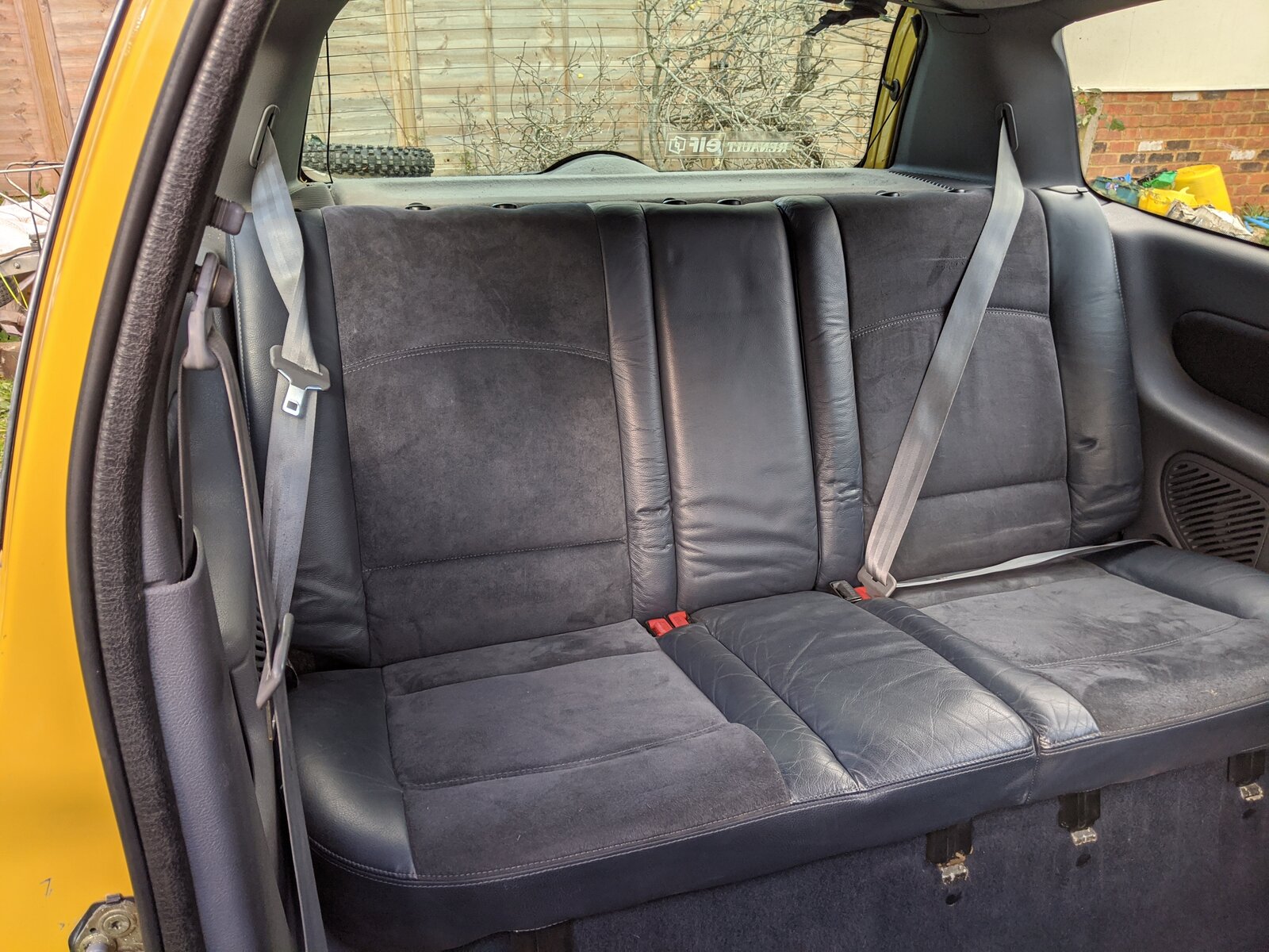

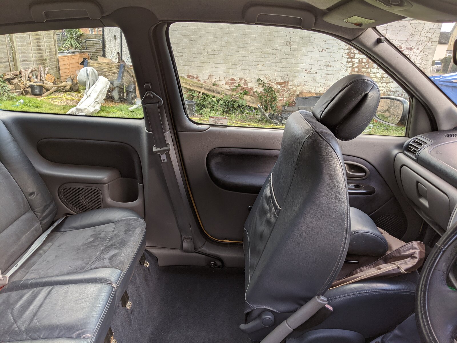

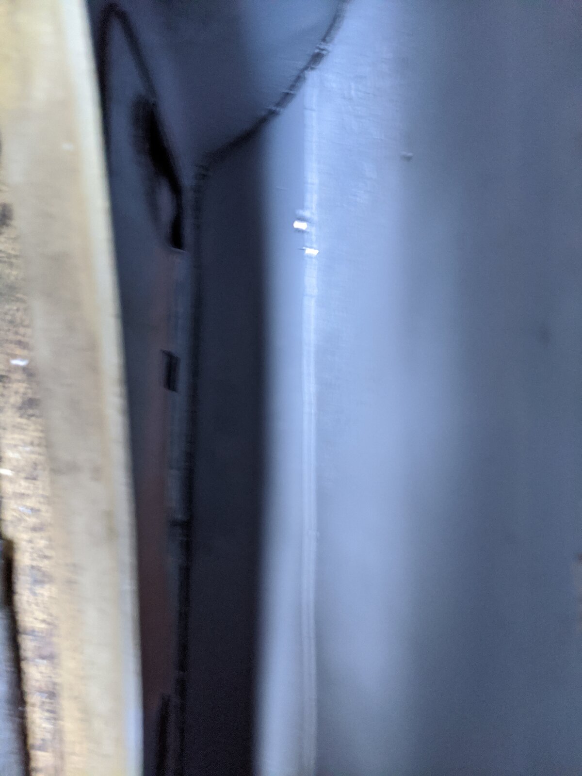

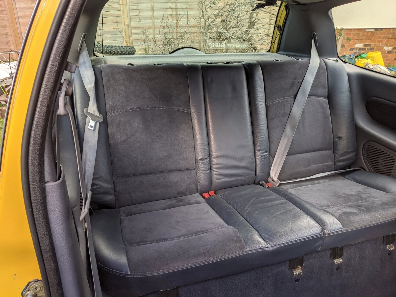

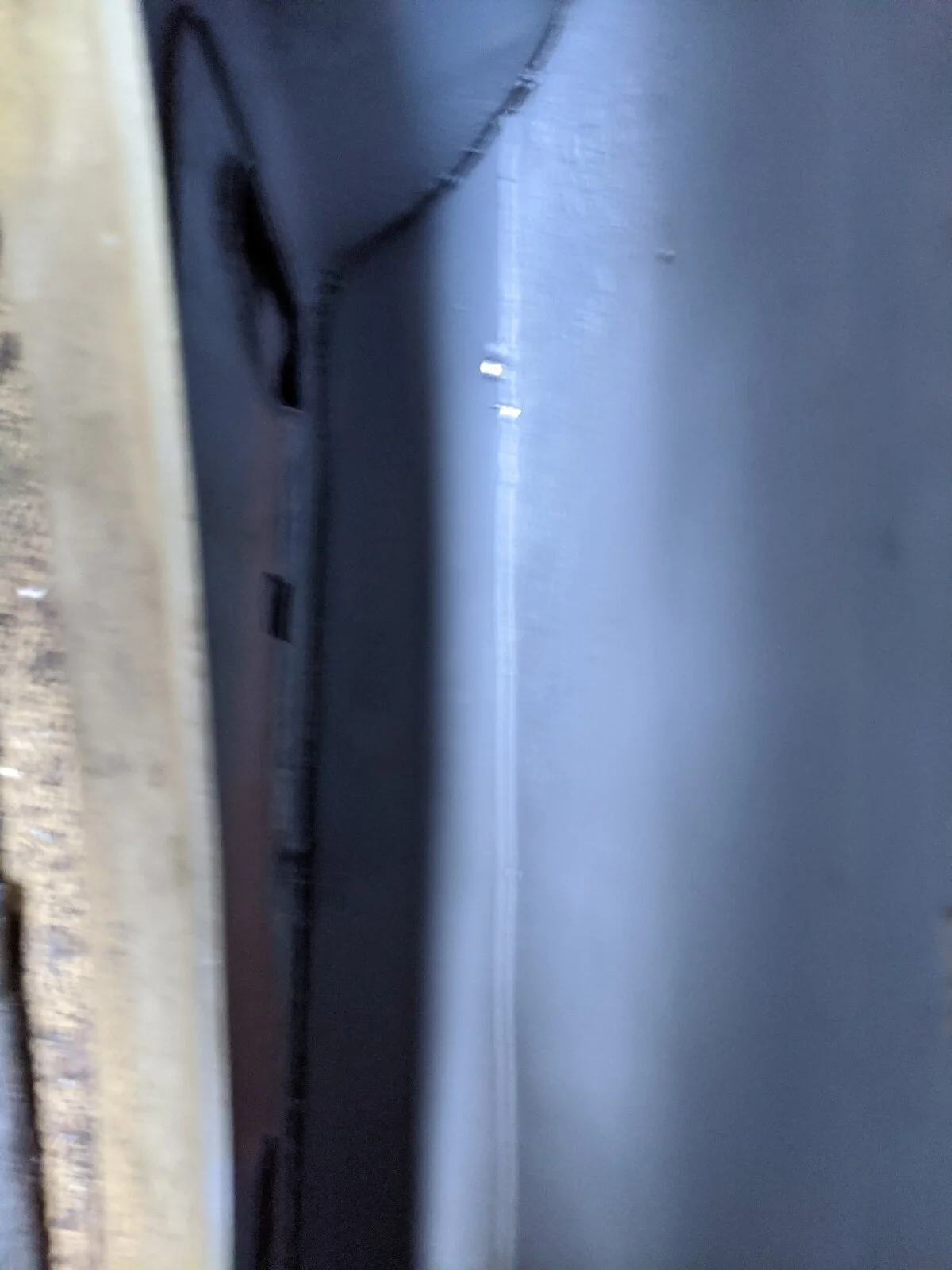

Interior back together after inner sills sorted with Dynax S50
Interior is ok for a 20 year old car with its own ecosystem living in it !

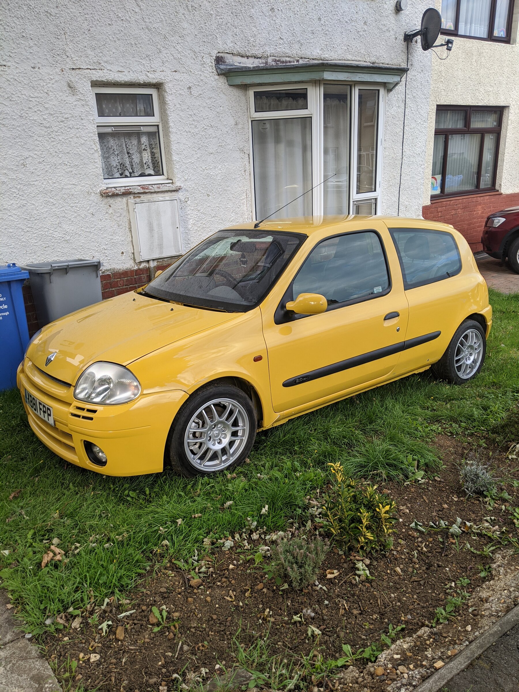

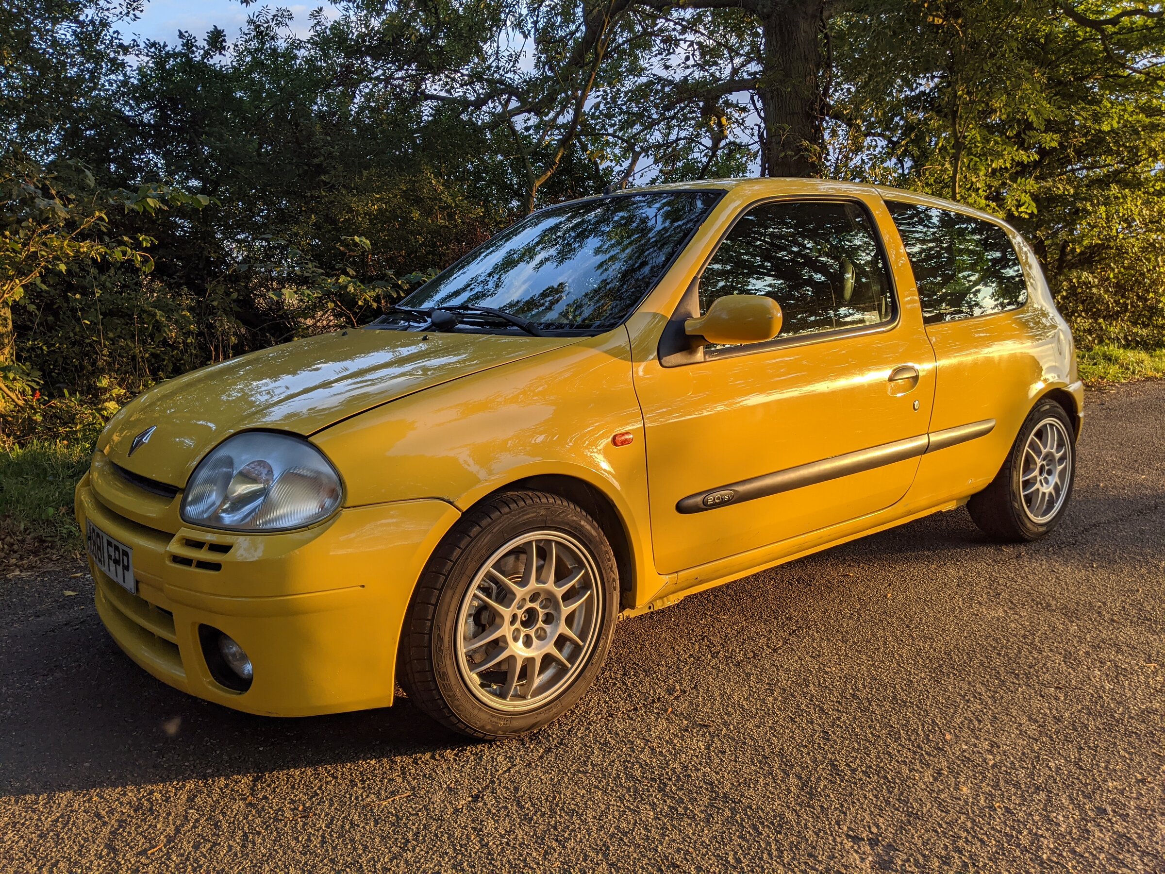

  172 Sunflower
Had a run out this evening after fitting new driveshaft and cup shocks, has improved the drive massively
