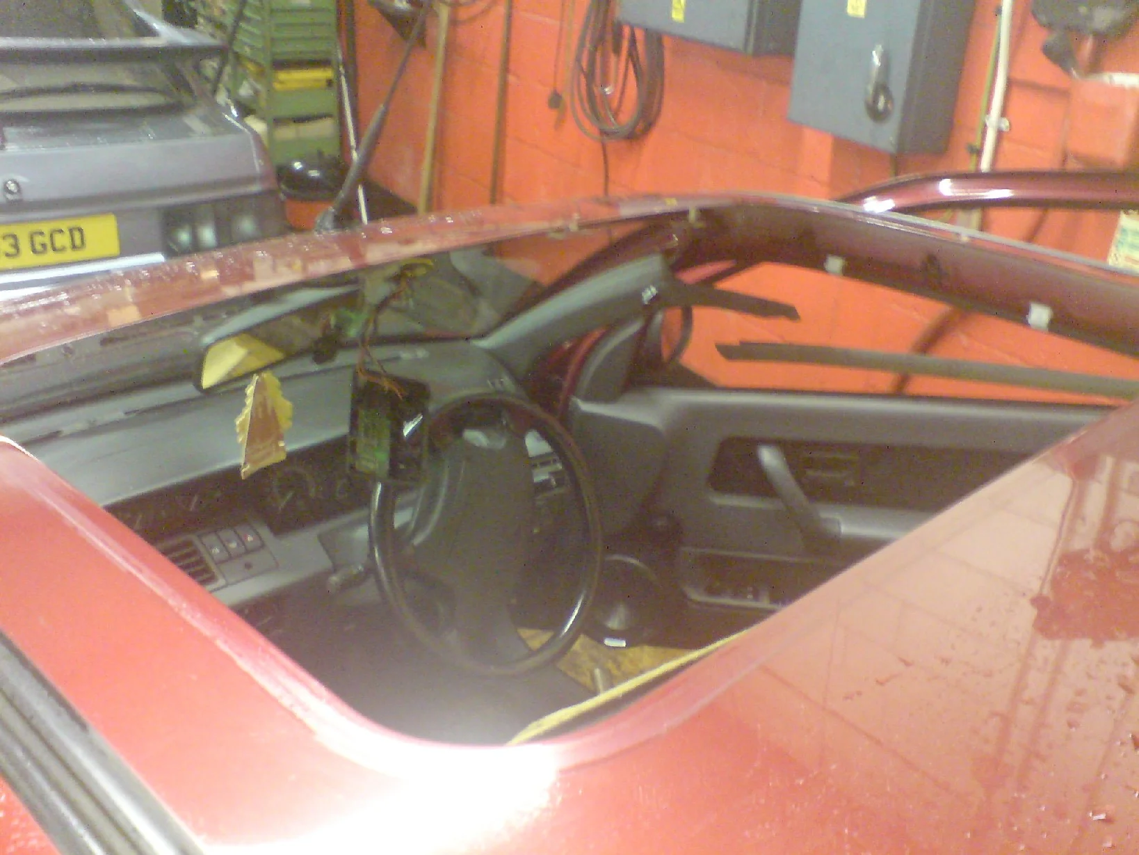

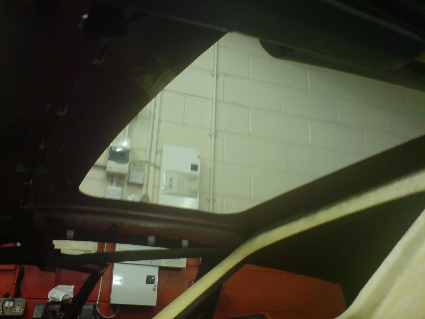

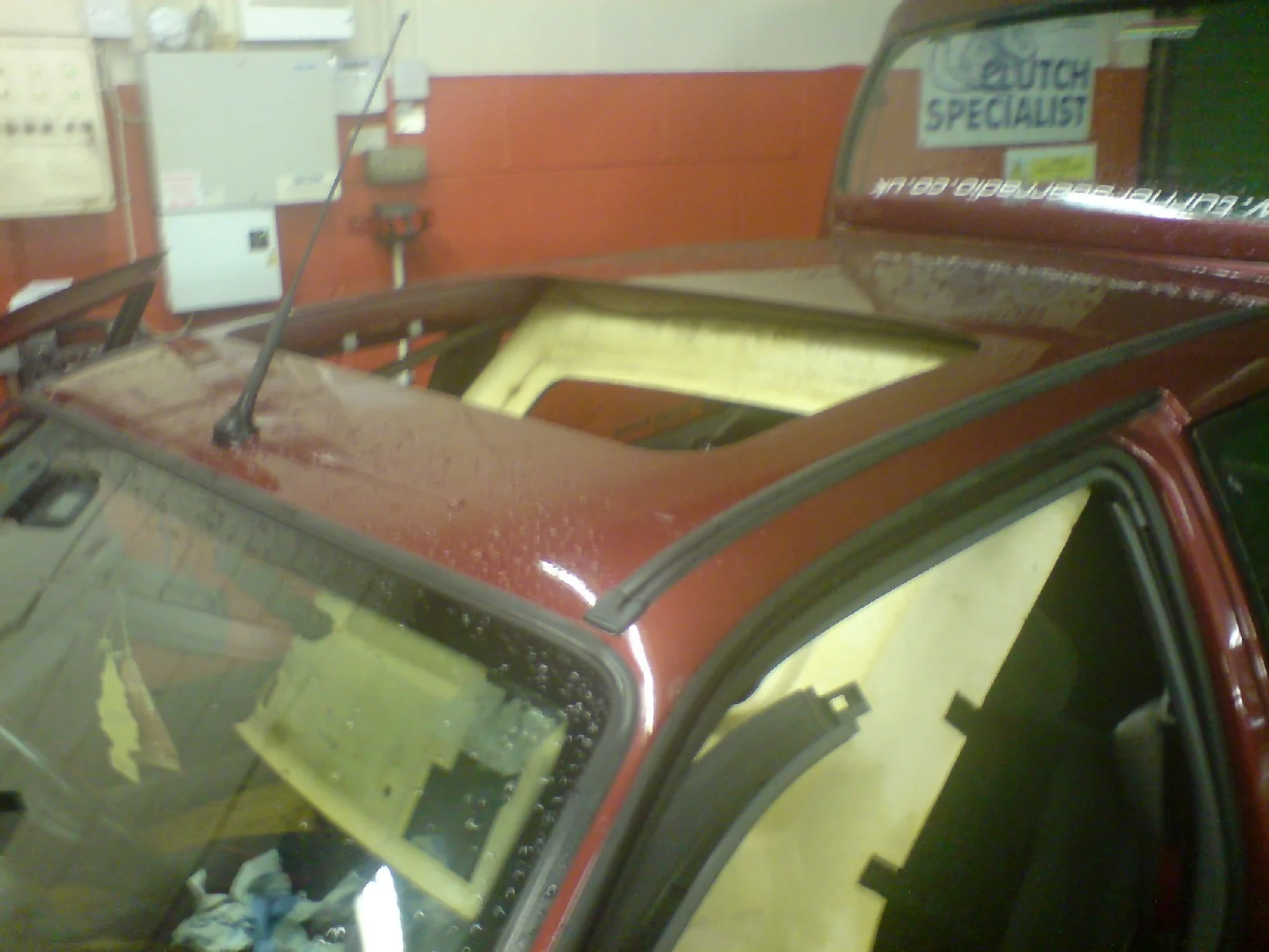

as pretty much everyone knows that the mk 1 was prone to sunroof leaks i had had enough of having a cold shower every time i turned a corner!! so i first of all tried the easy option i first stripped the sunroof control plastic and central locking sensor to see if it was the ariel or the sunroof the area around the ariel was bone dry so it was the sunroof. i thought id take the easy option and silcone at the top first to see if it worked this lasted all of 1 week. so more drastic measures were to be taken. . . . .

after stripping out the sunroof i could see how it was leaking there is a seal which sits underneath the plastic surround on top of the roof and the bolts that hold it down tight from inside the car had worked there way loose allowing water to get in under the seal so in order to stop this happening again i silconed all around the seal in side the plastic and bolted it down tight using locktite on the bolts and it has not leaked for a month now so i couldnt be happier. just thought i would share this incase any1 wants to attempt it themselves.

course it still opens the sill is underneath the plactic suround that sits on top of the roof and the water was getting in between the roof and the plastic suround. i silconed it underneath the black plastic suround and bolted it down so is now water tight it doesnt leak in between the rubber sill and the glass.
