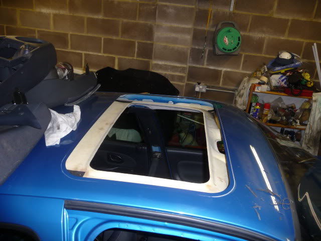

sunroof seal
I bought a foam seal from Renault directly I'll see if I can find the part number
Hi, Did this foam seal work ok? How much was it from Renault? Im debating whether to buy original seal, or go awall with the sealant.. Id prefer to do it right
Most of the time its not the seal that fails, over time the roof and the sunroof flex and this allows water to pass the frame and the skin, just put some sealant on the edge of the frame, even the gum gum tape from a door membrane works, refit the sunroof and you will of probably sorted it.
