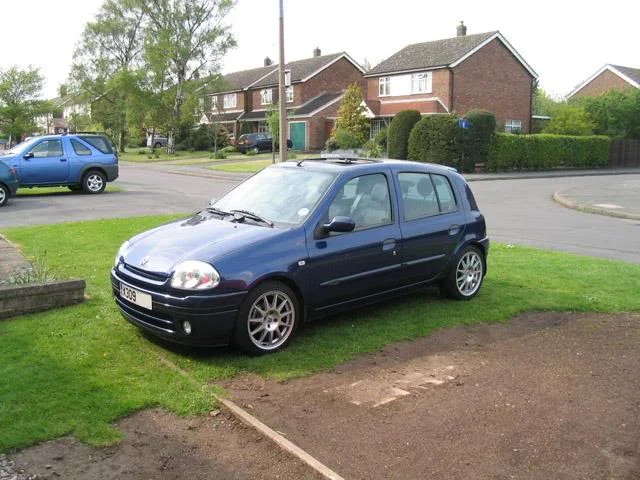

Dave great tip re: removing the glass! Got mine out after I washed the car then so it's keeping cool. Should be good going for a drive in bit!
