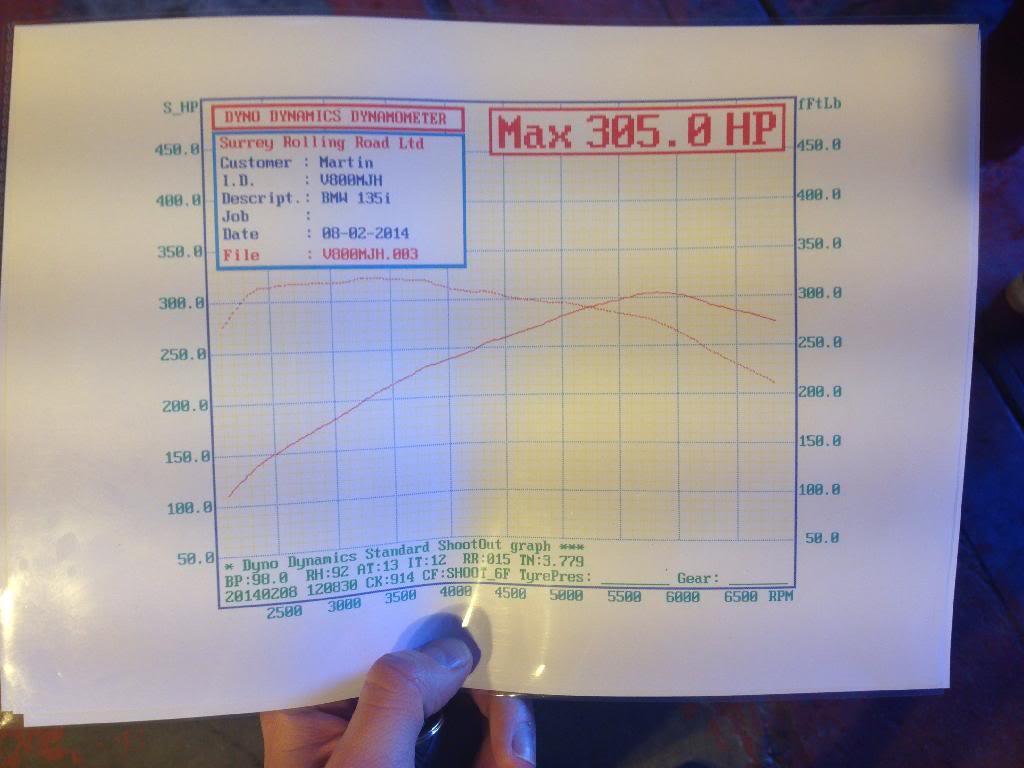

v800mjh, it dawn on me yesterday, ofc BMW will map differently to enable similar perforamnce in the lower ev ranges due to weight differences.

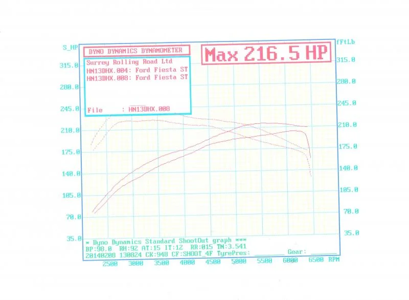

  Fiesta ST Stage 3
Only if you drive it for me mate :)

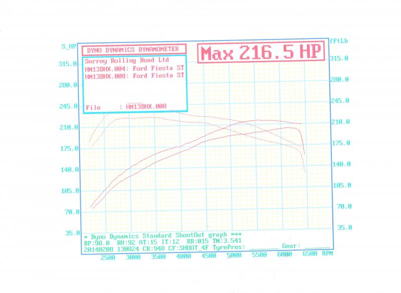

Quite happy with 234bhp/ 225lbsft from the family wagon
Decent power from the Z4 (3.0 bi turbo?) mr2 turbo (let me know if you would like to come to the ring Alan ;p) , the mountune fiesta ST - it must be pretty nippy, good all round package! A ITB'd clio that made good power and sounds lovely.

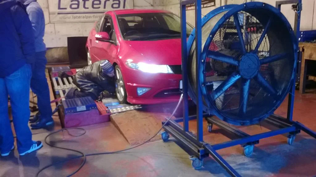

  Fiesta ST Stage 3

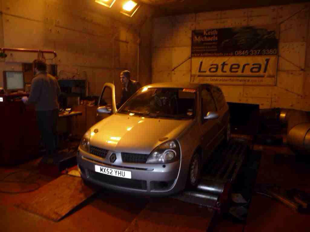

The only pic i took and it was not even my car LOL
Still have a thing for the Honda or Pete FN2 should i say

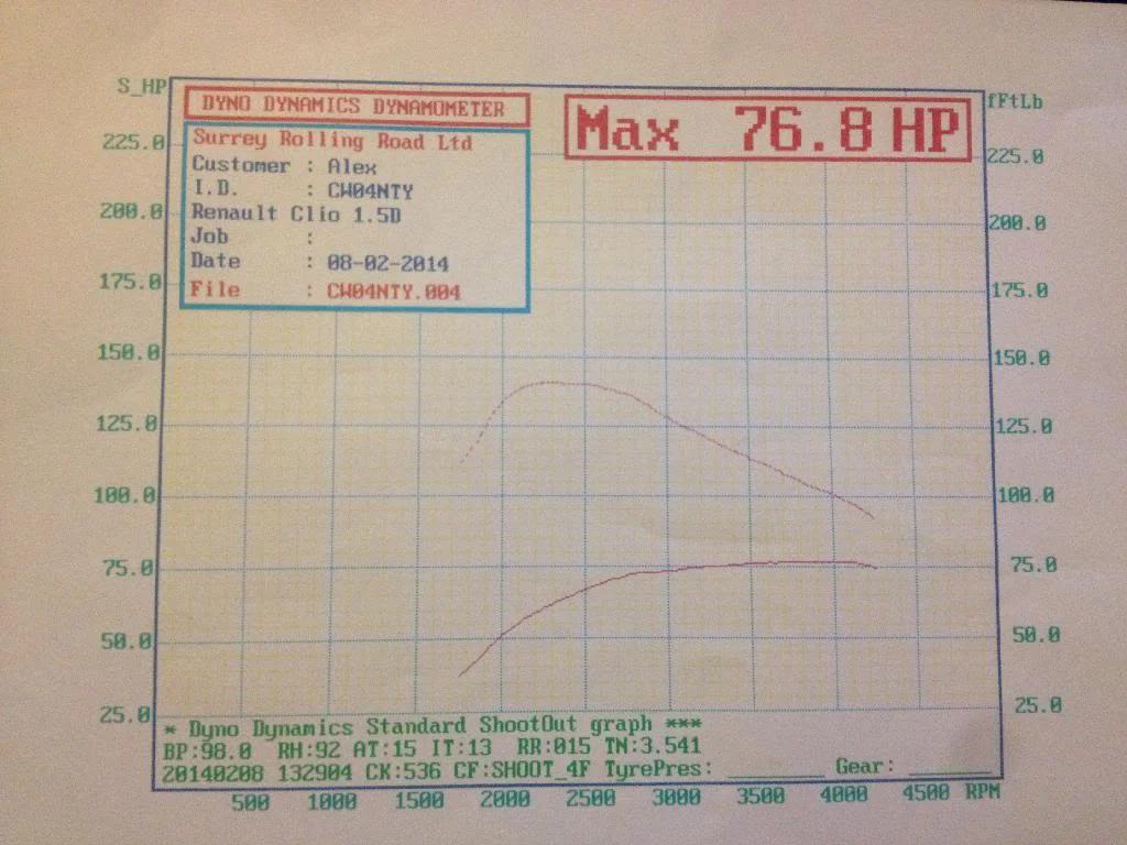

Did @AlexW run? interested to see power there compared to Rindy's.
Yep I did.
I've done mods since Rindy's so can't compare at all! I made 67.4HP and 114LBFT at Rindys, on a completely standard engine.
Yesterday I ran 76.8HP and 140LBFT with an extra 10k or so, Decat, no backbox etc and intercooler.
See below...

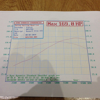

Untitled by fletcher10, on Flickr
Dissapointed with my RR results TBH :( Charlie thinks something is restricting it, because it just drops off. It made 171.5bhp last time at SRR.
The drop off is the dephasor switching off I would think.
Its 2.5 bhp different to last time. That's the same reading really as runs vary that much back to back sometimes.

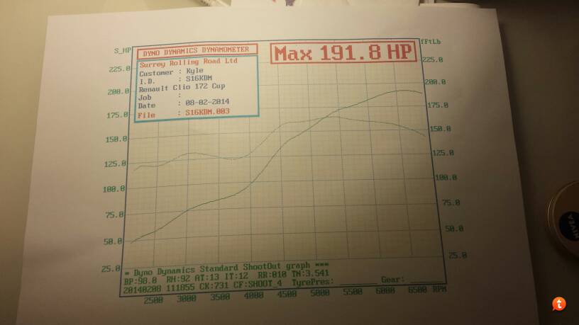

Heres my graph from yesterday
Not a great pic as for some reason my tapatalk dont give clear pics from my S4
I hadn't thought about the dephaser switching off. All new belts and dephaser fitted in Sep 2013. Also had PMS AC delete, and matched inlets fitted since the last run, so was hopping for 172bhp or more TBH.
Harsh reality is matched inlets make very little difference and AC delete makes nothing measurable if it's run with the aircon turned off anyway.
Maybe the timing now isn't as good as it was before the belts done. Can't be out by much though to be only a few bhp short.

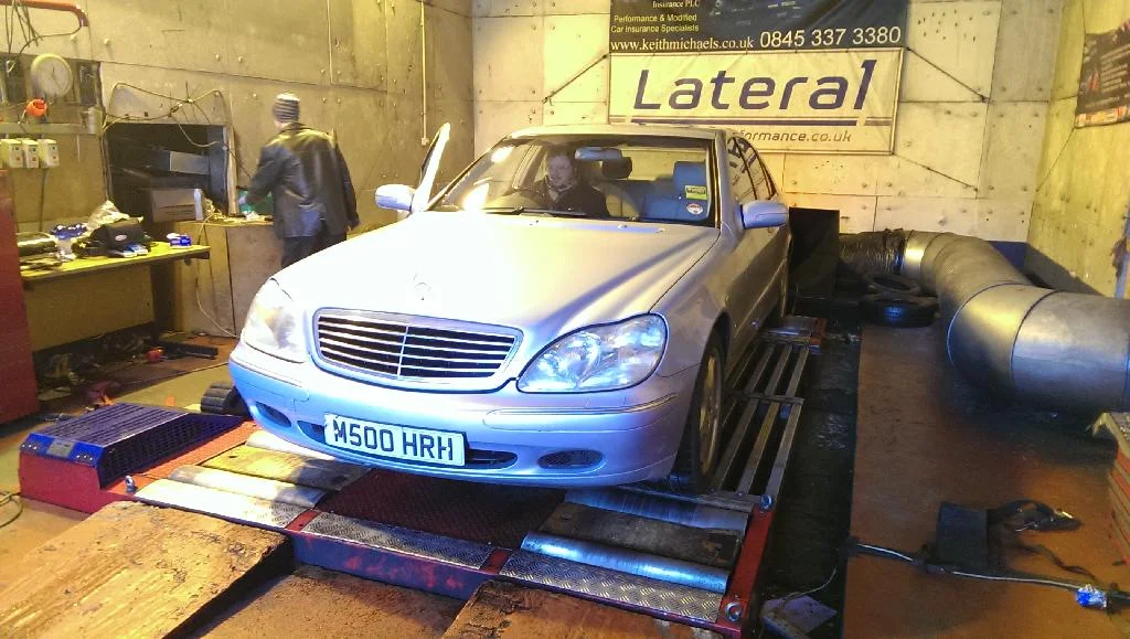

terryc101

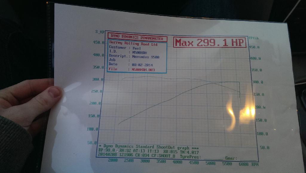

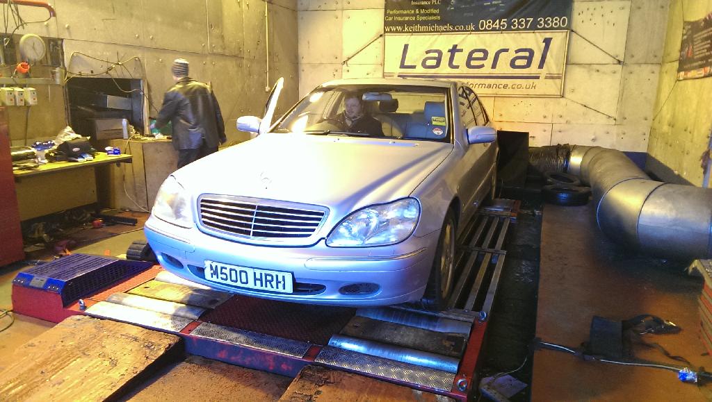

Had a good morning as usual at SRR, spoke to a few people who's names I have no idea on lol. Didn't take the 172 as it has a slight coolant leak so convinced my dad to run his S500/our towing car.
  Many.
Your merc was one of the funniest of the day I have to admit. Right from "Is it running?" to the dyno run and not being able to hear when he was doing a run!

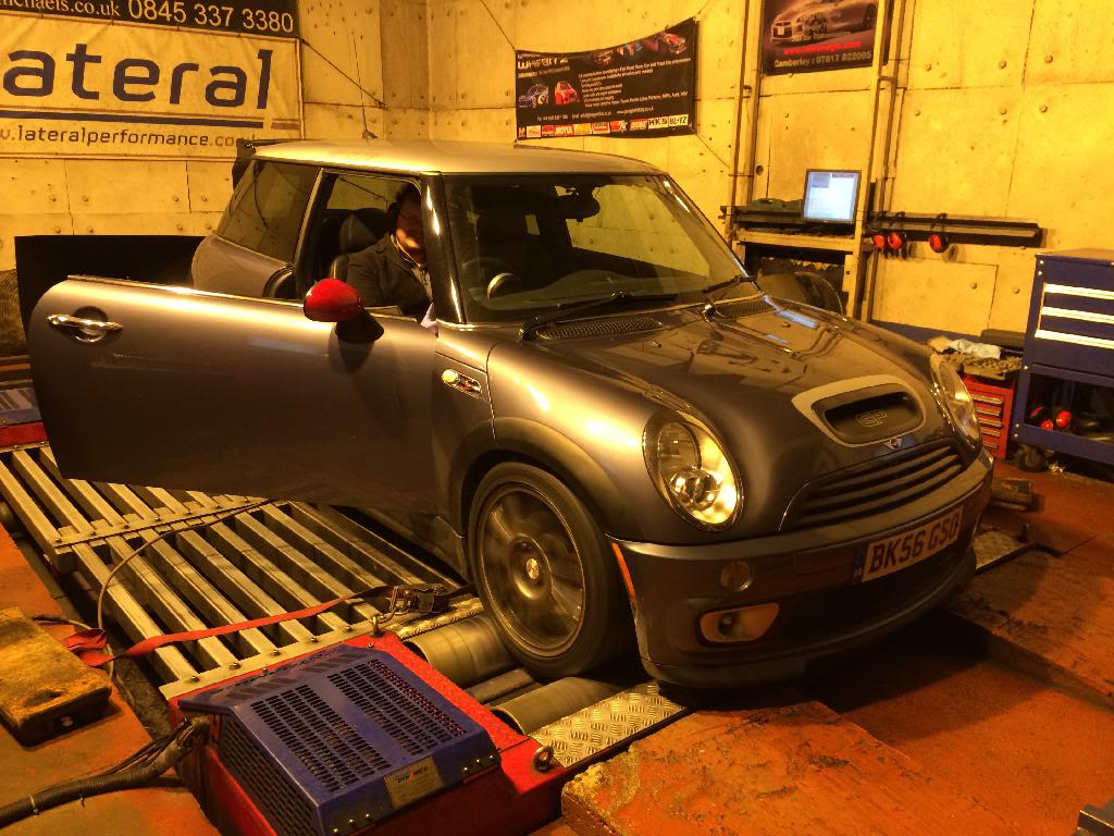

Aren't mini GPs rated at over 200hp?
Yup. 218 lol.
Bit narked really, had an Insp2 done 2 weeks ago (with a new s/c belt) and well, after getting only 194bhp Charlie said i should check it. Had a look when i got home and its stretched/lost tension already. Doh.
I hadn't noticed the complete lack of puff from 5-7.5k as the max speed i hit on the way to work is usually about 30 lol.
Little hoon on the way back from SRR suggested that it is poorly, although still not exactly lethargic!!
Getting a new belt fitted tomoz :)
