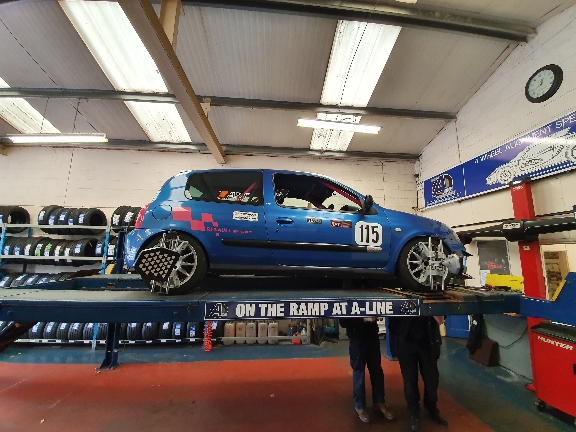

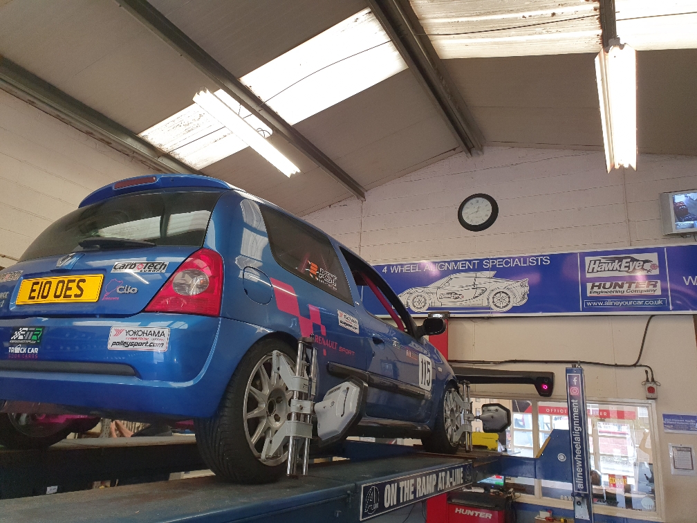

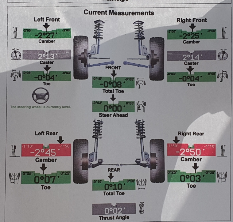

Cheers for the help all... went to Aline today and got the car sorted!
will get it corner weighted once finished with mods that will affect weight.
How does it feel now? Are you happy with the results?
Sent from my SM-G977B using Tapatalk
Yes the cars feeling great!!! Going to Donington the weekend so fingers crossed for clement weather and I’ll report back then on the true benefits 👍👍👍

Car handled real well the weekend at Donington. Steering was sat slightly off to the left though. Had noticed on the road but always questioning if it’s the camber in the road etc , plus it dos by really get drove on the road other than to get work done.
to be honest it had a geo by the previous owner and there can’t have been much wrong with it.
