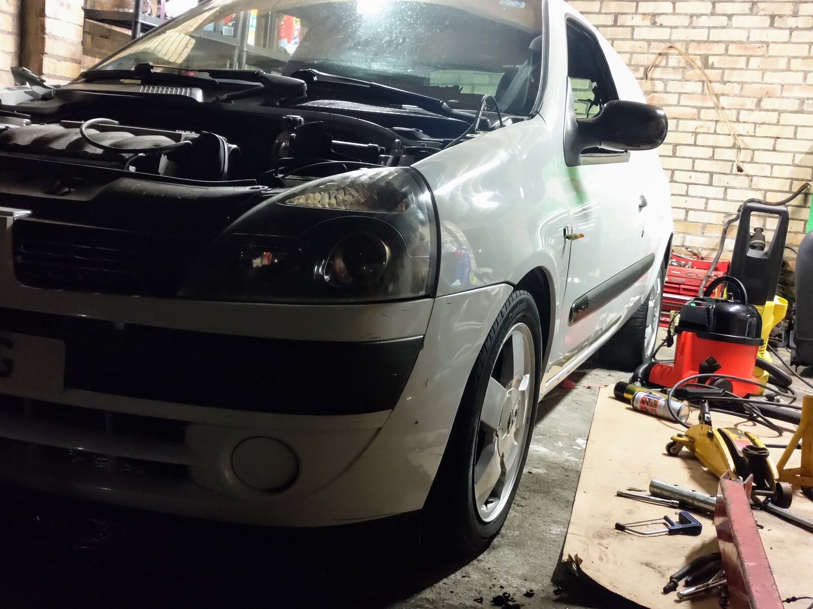

suspension swap
Yes they will but you will need to swap the subframe, wishbones, hubs, driveshafts, and struts for sport items. I have a video on YouTube which shows you how.
shouldn't need to swap the subframe? just the rest.
The wishbone holes are further out on the sports I believe. I've actually never measured myself but had it confirmed to me by someone that did. Swapping to a sport subframe will also give you the hole and opportunity to run the 4th gearbox mount.
Na subframes are identical apart from the hole for the 4th mount, 30 seconds with a drill and they are identical, just finished the swap using the standard subframe
