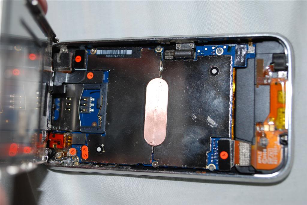

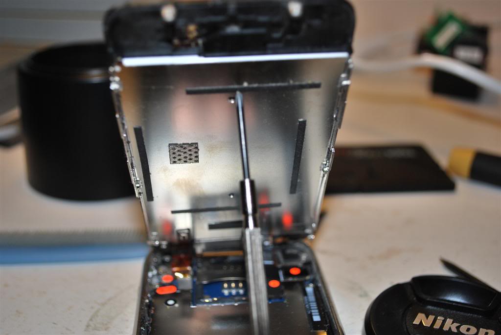

so i got hold of it tonight took the screen off and no water damage at all. the connector that connects the screen to the main pcb had come off.
plugged it back in and guess what..... phone works just fine.

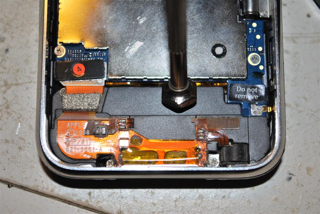

can you see water or green crap on the metal contacts caused by water damage or water stains on the back of the screen

If the repair centre open the handset and see any evidence of "Liquid Ingress" posh word for water inside the handset then it does just void the warranty and they will not fix or even look at anything inside the handset as it voids the warranty as water damage and physical damage arent covered. There are several indicators and checks they do to test.

indeed but no water here
what do i know that they dont? probably nothing yet i got it working and they couldnt?

In this case 2 of the several visible indicators aren't triggered.
The bits i've circled would be pink if activated by water.
