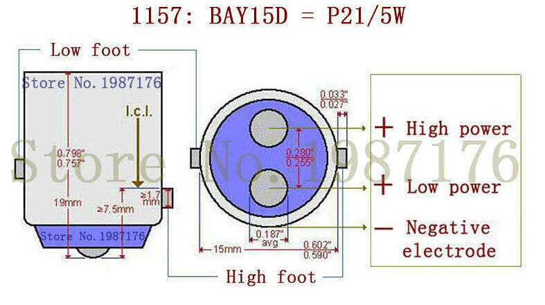

BAY15D
P21/5W
Two parrellel legs with offset heights
Two bottom pos connections

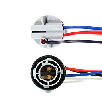

So this isn't on the Clio but thought I would post anyway.
I have a rear light with this set up but the passenger one is constantly on as brake (21w) when side lights are on and doesn't change when pressing the brakes.
I have tested voltages and continuity, everything is ok, I have placed the bulb in the wrong way round (as can't lock it in) and it works corrently as expected.
Strange thing is that it is a waterproof BAY15D holder with rubber inserts around the cable, so I am wondering how or even why the pos connections have been swapped over or weather it was like this from factory, if so that is a poor check over, it is from 2004 though.
Just wondering if anyone has ever took the contacts out of one of these before as I haven't.

Ye, if I turn the bulb the wrong way it works, there is no board it is just the bulb holder pictured that twists into the rear light casing.
I have checked all electrical connections and the ground is correct (on the side of the holder) the two pos connections on the bottom seem to have been switched.

I am wondering if maybe as the bulb twists in it slightly twists the lamp holders pins and they short across the bottom of the bulb intermittently causing it to light both elements together?
It's the only thing I can think of if all cables are ok.
