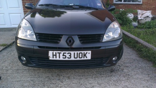

Alas, finally got around to fitting these! Forgot to take a before picture, doh.
Changes the front end so much, I didnt think it would! Will get a picture in the dark later this evening. RS Grill next! C&C Welcome as always.
Headlights make a huge differance, Every time I walk to my car now and see the front end, I love it.

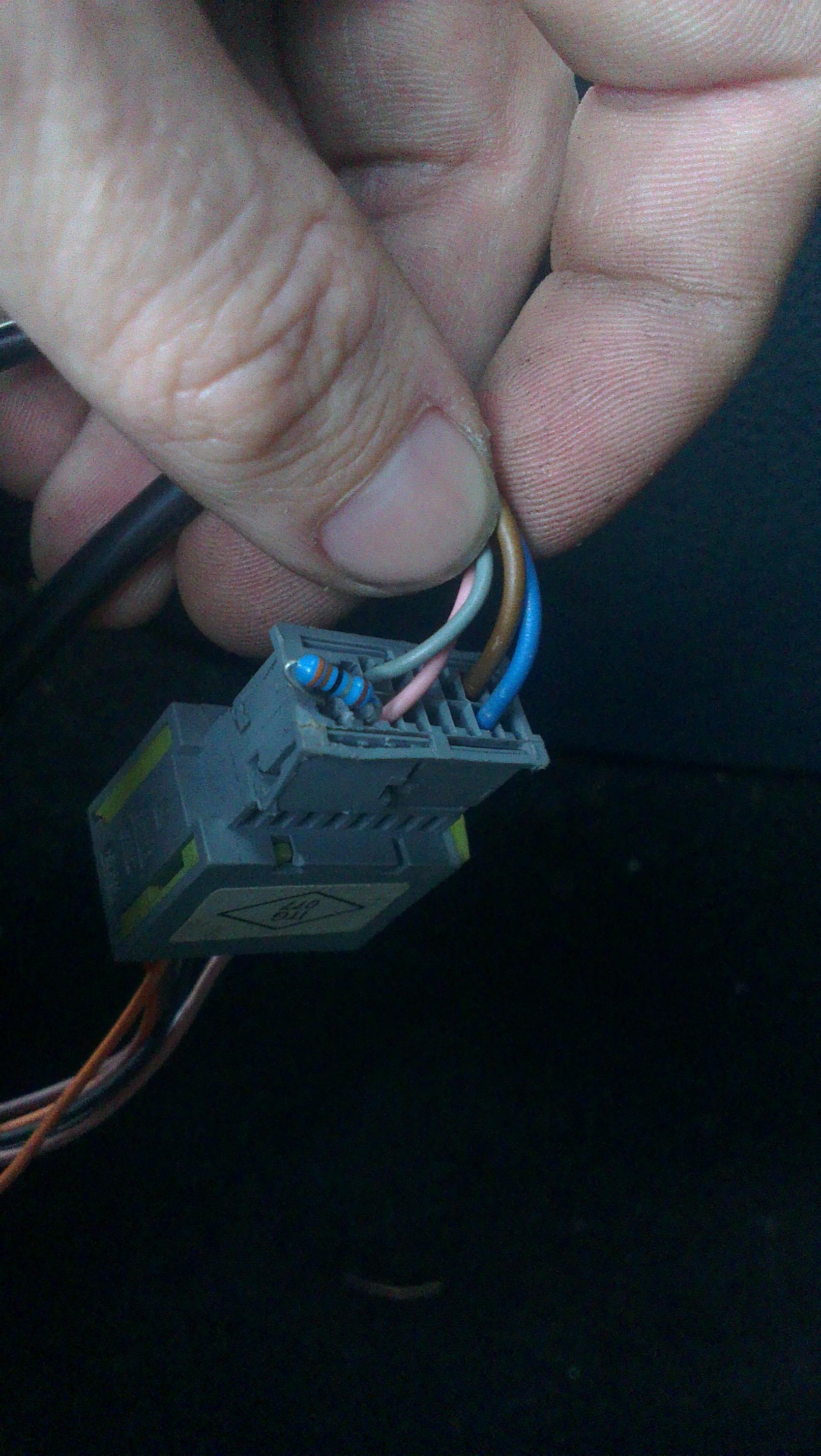

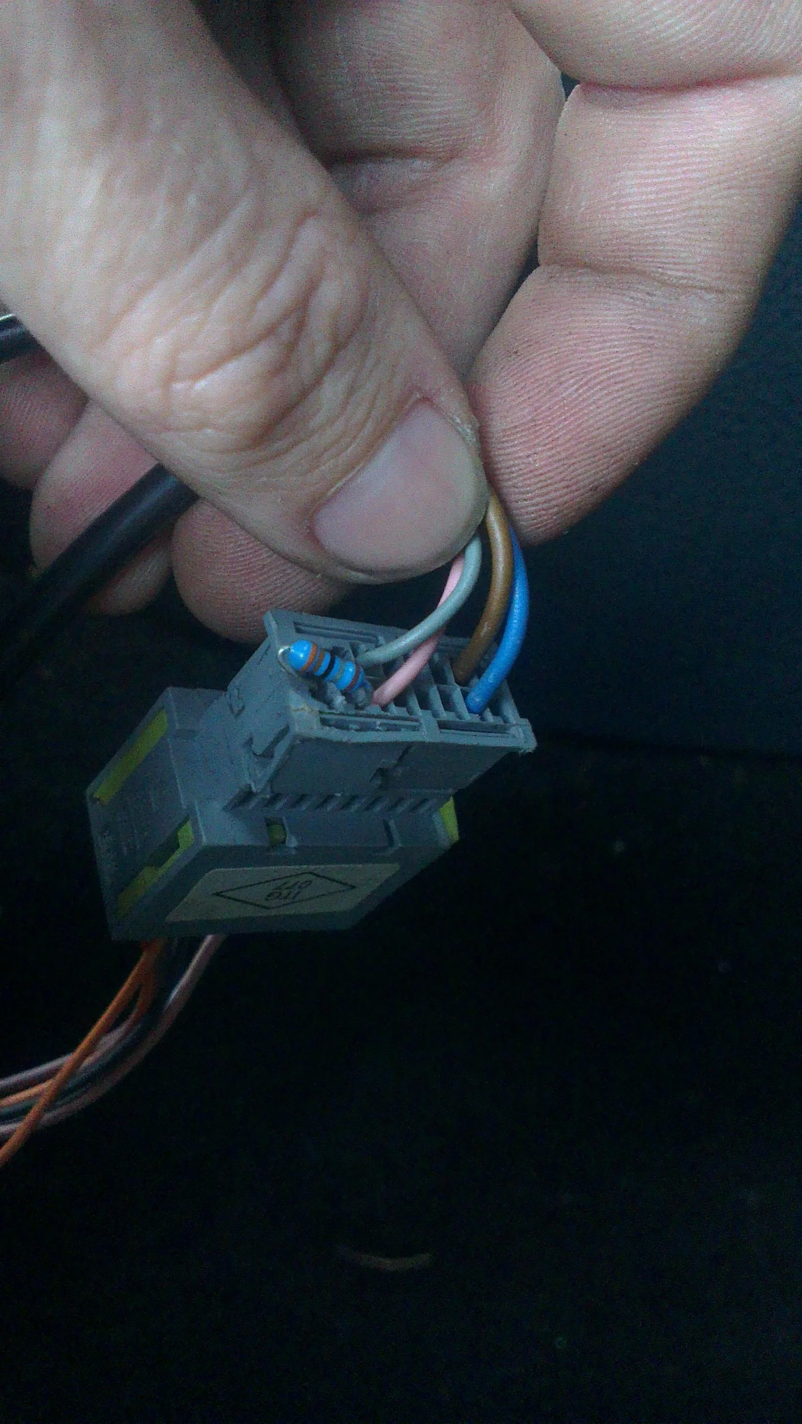

Airbag fault: SOLVED.
Turns out it was the drivers pretensioner that wasn't connected. The wires had been cut to about 3-4mm on the connector block and it was proving impossible to get it all wired up (Destroyed a connecting pin in the process) so along came the resistors! Straight in, not a problem since. Will get around to fully wiring it in once i've done a few more days of electronics classes at work!

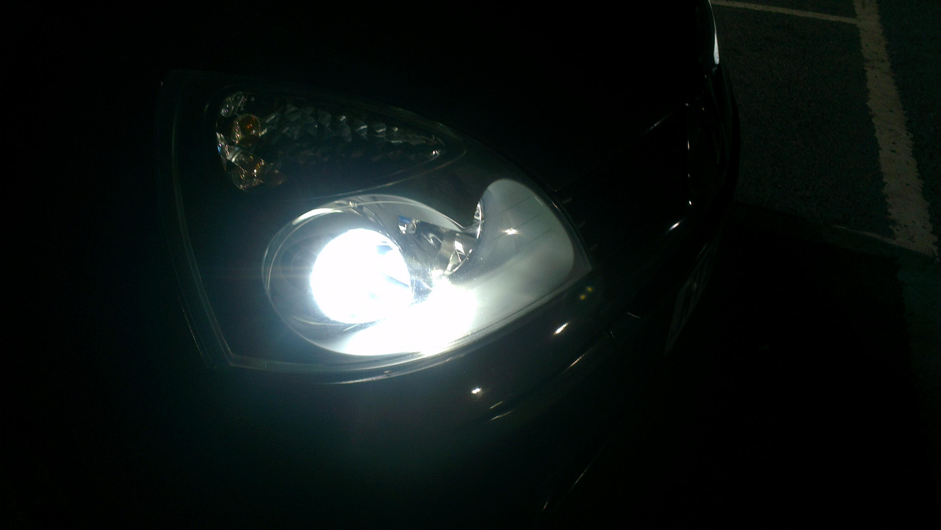

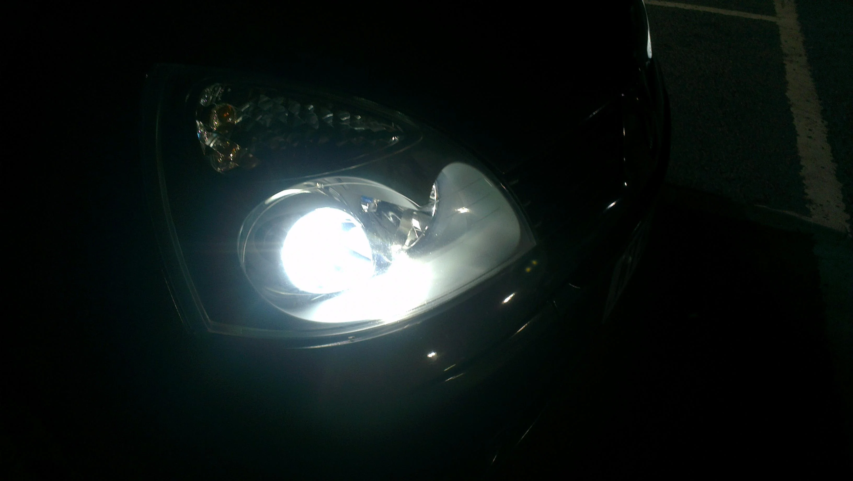

One more for the night since I'm bored, heres the said xenons in action:
Theyre 6K HIDs, not thatblue, but a nice tint. Haven't got any side lights in at the moment, will be getting them in when I get some LED ones, rather than spoil the look with the standards from my old headlights.

What was up with the airbag? My airbag light is on and i cannot do a thing to turn it off! A guide or something would be class!
I looked through and the Blue and Brown cables for the drivers side pretensioner weren't connected. Connecting made no difference, so whacked a 3.3Ohm resistor in their place to loop it back - Voila, no fault code. Theres a guide on here somewhere, its a bit vague, but gives a fair idea :)

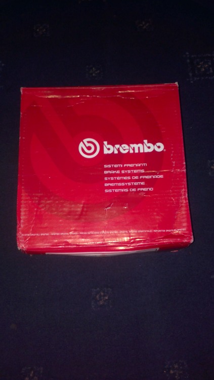

New Brembo Discs are on!
Glad to not have any juddering now, just got to treat them carefully until theyre bed in.

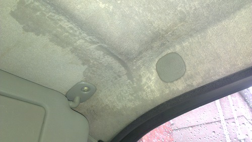

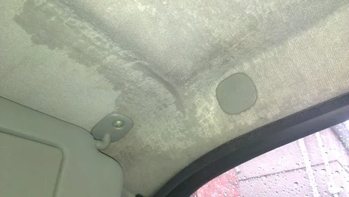

Mines just sprung a leak in the same area again. It was a b*****d to do last time. Wear gloves as the back of the headlining makes you itch!
its that stupid plastic trim around the sunroof that leaks and the gutter pipes blocked
I hated doing that job on the old 1.2, Worth it as long as it stops dripping on you while driving though!
Electric sunroof makes it a whole lot more of a ball ache :( my dad's old dci leaked on the manual room , he just sealed it to death with some aeroplane spec glue lol

Managed to halt the leak by clearing out the tracks and giving the seal a bit of a push back in to place, so thats one thing solved.
