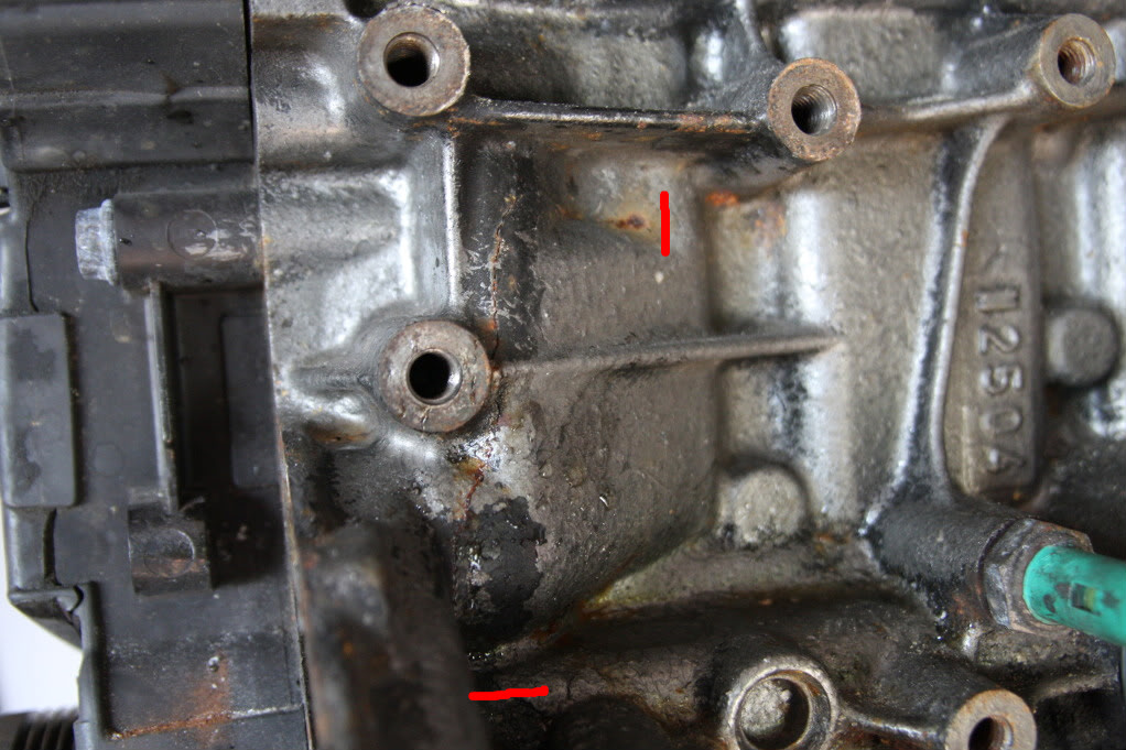

I left mine parked up outside a couple of winters ago for 5ish months, started it every few weeks and ran it up to temp, didn't stop this happening though:
Had plenty of anti-freeze in too. Could see daylight through it after I stripped it apart. It was a really cold winter but it just shows anything can happen, regardless of what preparation you do. IMO leave it as it is, just start it every so often, ideally garaged but at the end of the day its a Renault, not a Ferrari. It will be fine if you check it every so often and not just leave it for the tyres to go flat, etc. The last couple of winters haven't been as cold though I guess.
