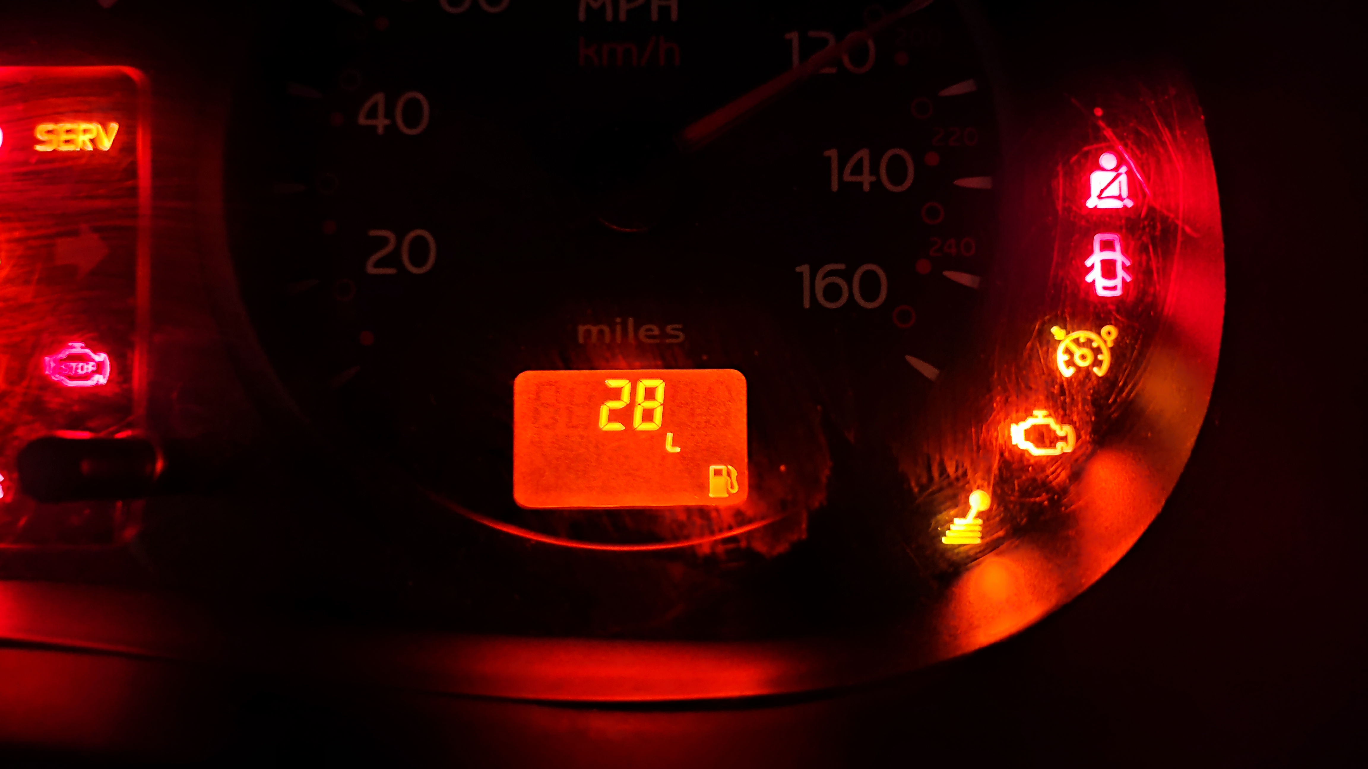

Thank you so much, since my racecar once was a non-sport i didn't had the trip button on wiper stalk, but Yesterday night I took it of and modified adding an external button for trip computer, I then tried your procedure and it works like a charm!!!!
Usually at which value do you stop filling? Thanks a lot!!

I add an update to this topic. I brought the car to fuel station and filled it there until first click.
Then checked through suggested procedure and it displayed 51 liters.
So I will take 50 liters as reference for full when manually filling at home from jugs.
