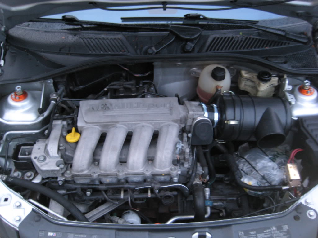

Nope it shouldnt have ran low of oil, I now have a V6 air box running straight off the TB and the pipe that runs the oily air back into the plennum is just routed to the floor.

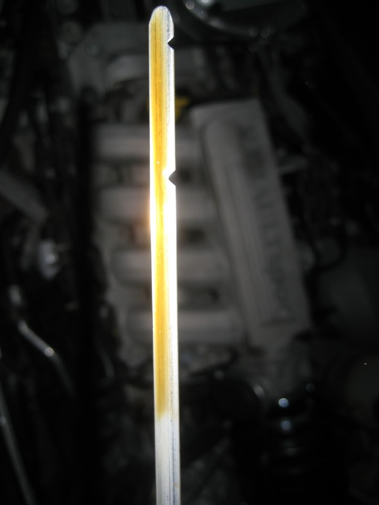

I changed the oil for Moutle 300v about 4months ago. I checked the Dipstick yesterday after i had driven to the shops and it was actuall about 2 inches above the Max mark. Its parked on a hill facing down usually but the journy to the shops is 4ish miles so it was all warm.

Here is the picture of the dip stick.
I take it you've left the car for atleast 10 mins before checking the oil level?
Yeah i let it warm up a little and then drove about 4 mils (40mph limit) and checked the oil again and it was still high. But then maybe because the car had been parked on a hill the oil hadnt had time to drip down again.

I just checked the oil after and its now just under the max full level :) so thats one little good thing.

I think i may have taken the reading when the eigne was still running. The oil level is back to normal.
I must have been doing somthing wrong :S
Erm. That explains the high oil level. You should switch off and let the engine cool down for about ten - fifteen minutes.
