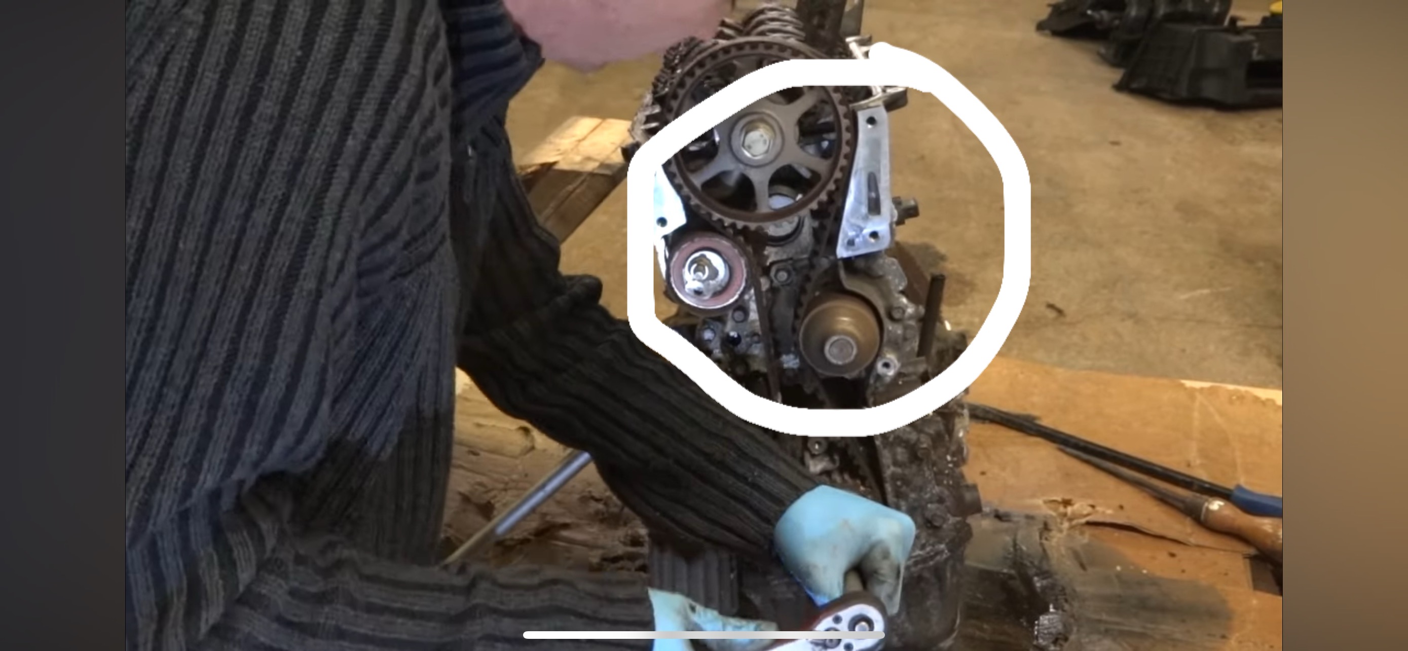

My car is tapping at idle and with rpm around this location, any ideas of what it could be because I’m going crazy lol.
(I used one of them listening things to figure out where it was coming from it’s it’s the loudest within the white circle)
Thanks.

What version of the 1.2 engine is this?
The area you’ve circled in white above is the water pump.

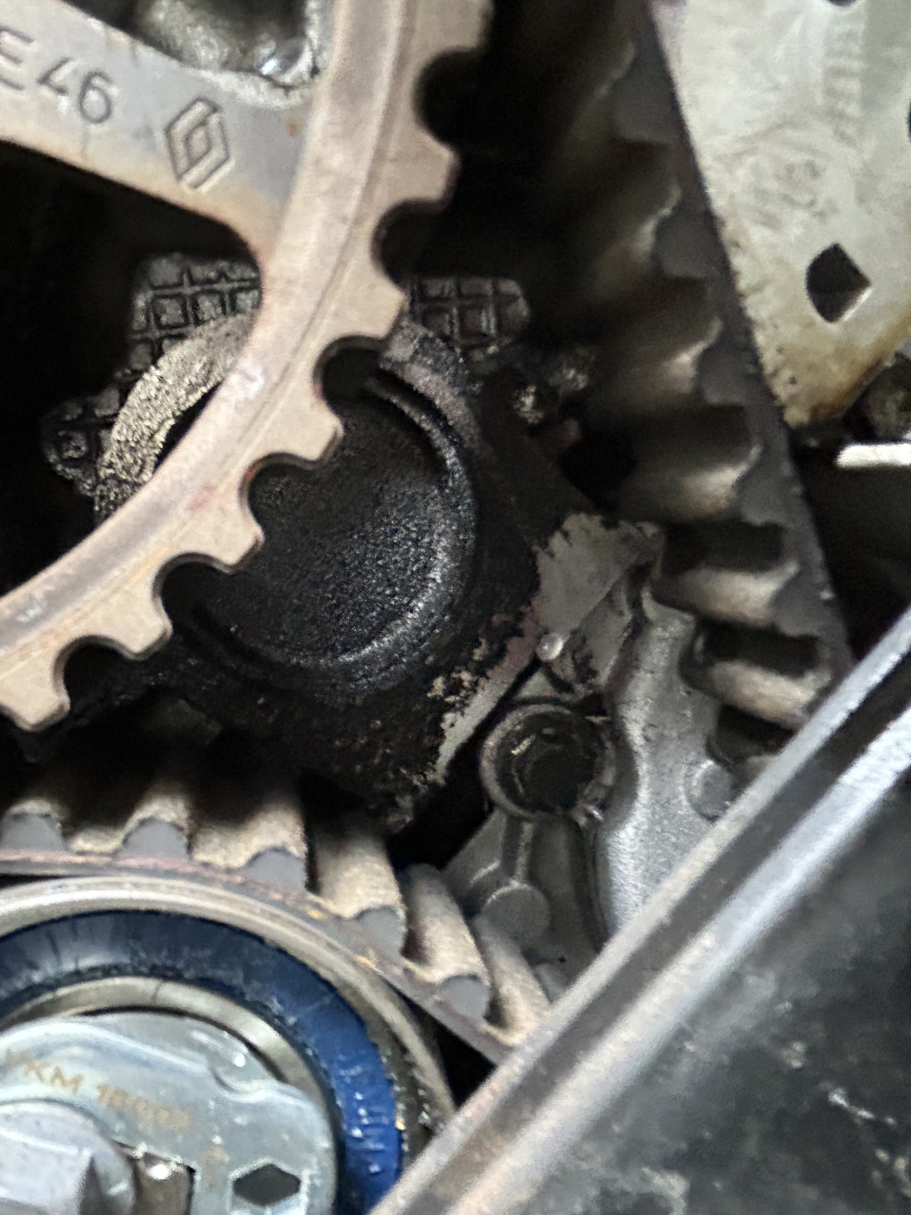

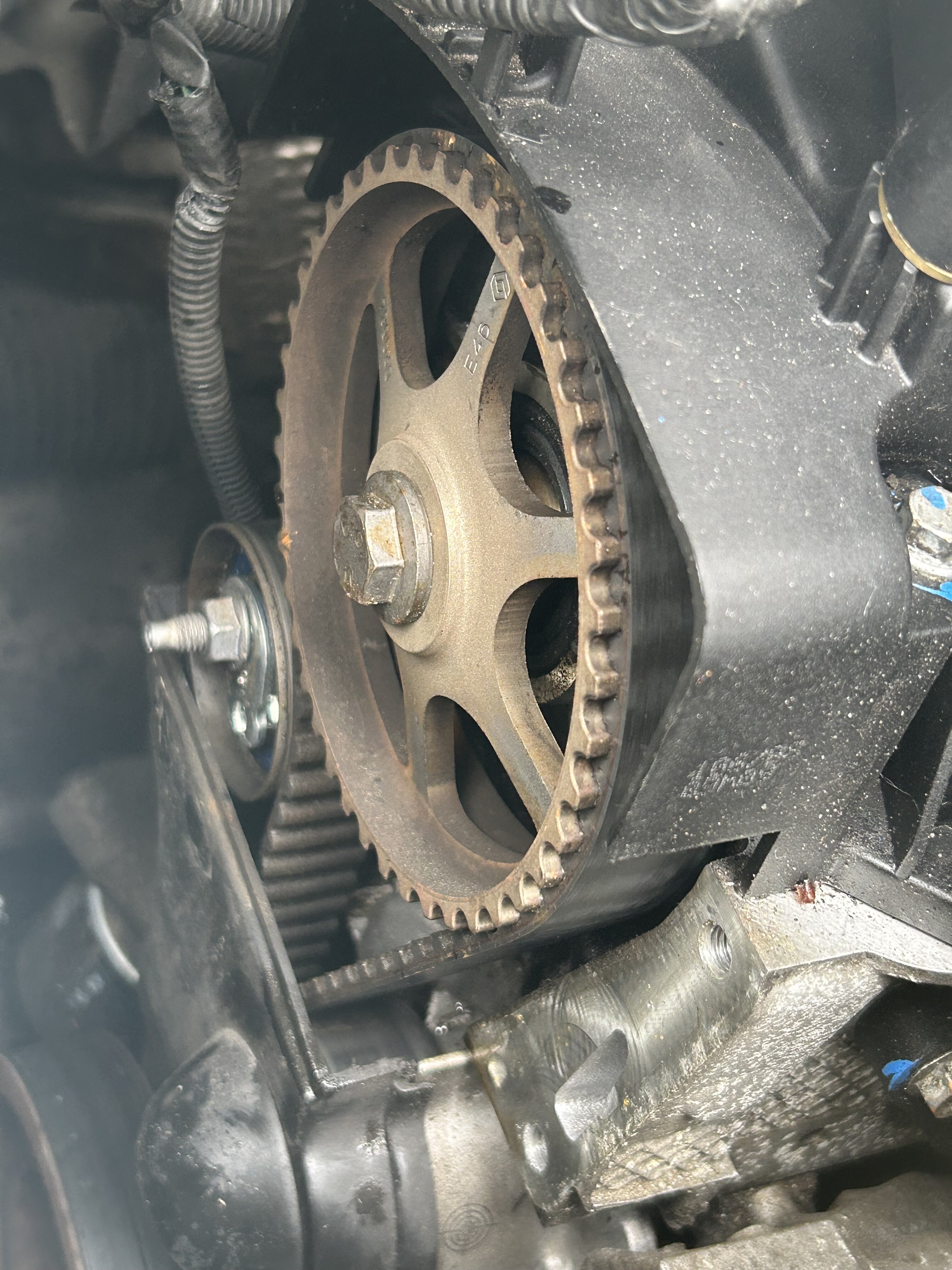

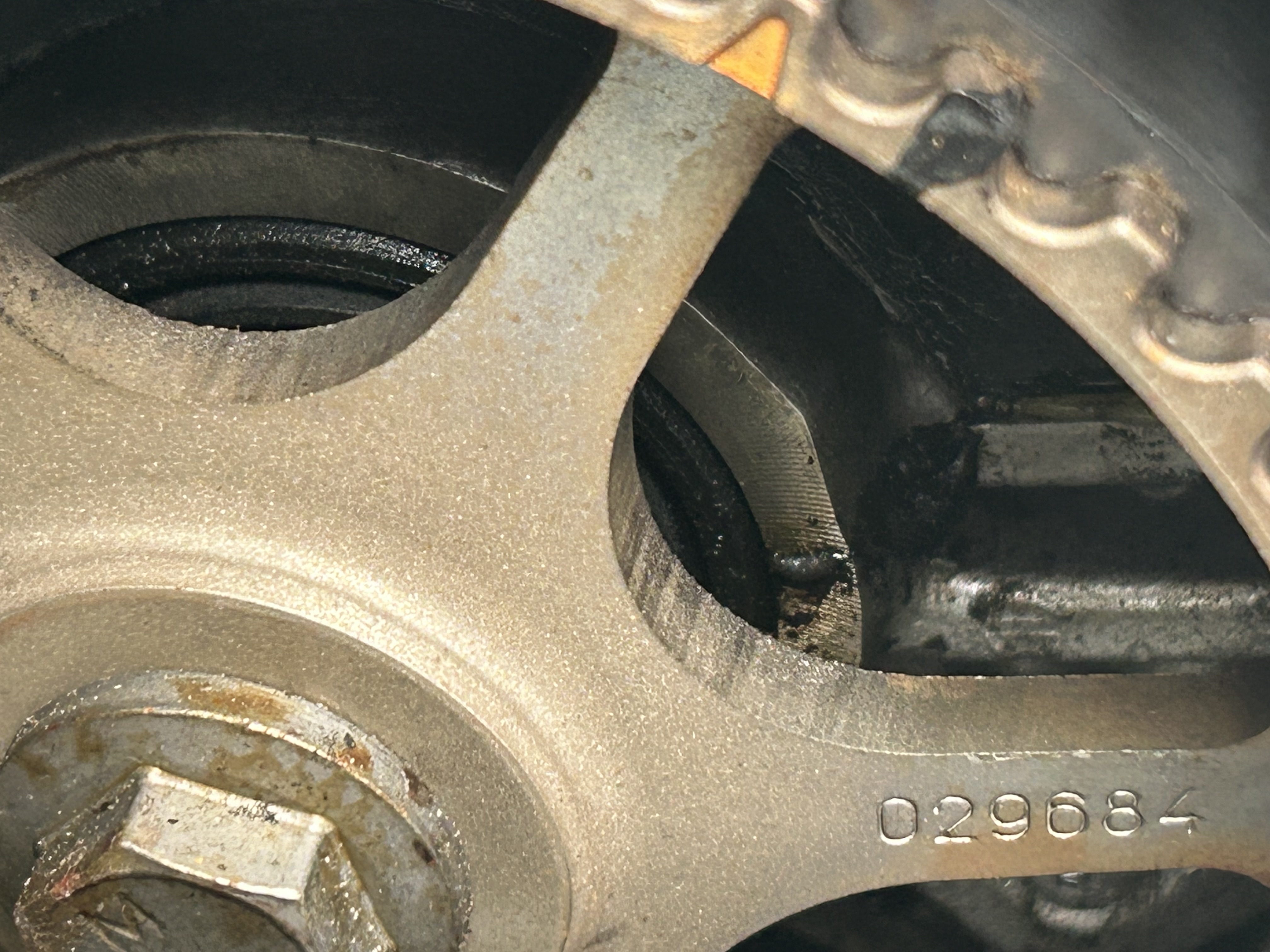

Yeah still ticks when applying pressure, the cam belt/tensioner is new as I’ve just took the mount and cover off to look. Started the engine up and I couldn’t hear any noise or see anything wrong with the belt/camgear.
Seems like the tick is coming from behind the cam gear so it’s probably a worn valve/rocker exc.
I’ll upload some photos and videos soon to try help other people helping me figure it out hahahahaha.
