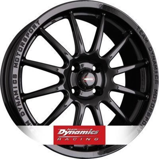

Demon tweeks currently have a good deal on these. Only the black are in the offer and come with fitting kit
Size is 15"/ET35 for that price
Thought this might be helpful to others :)

Not that I need them. But wonder if they are a direct fit without spiggot rings. Curious
I emailed asking if I could have them with the correct centre bore but they just replied saying they come with fitting kit so didn't really answer my question. soon find out I guess :)

I fitted a set to a friend's car this weekend, which he ordered from Demon Tweeks a few months ago and they have refused to take back.
They are the same as offered above in white. The front wheels fit fine, the rears rub on the brake pads. This is due to the generic fitment and spigot rings imo, which are big. There is no chamfer on the outer edge of the center of the wheel. I have had to chamfer the edge to prevent them rubbing.
This is definately an issue with the wheel and not the car. I have exactly the same wheel on my car with correct center bore and they fit perfect. The center of the wheel is different and there is a chamfer on the outer edge.
Demon Tweeks refuse to accept the wheels are not fit for purpose, despite bring ordered specifically for a 182 in the correct offset. Without modifying they would not fit!!! There customer service is terrible and I would avoid. Order from somewhere with correct center bore and guaranteed fitment.
