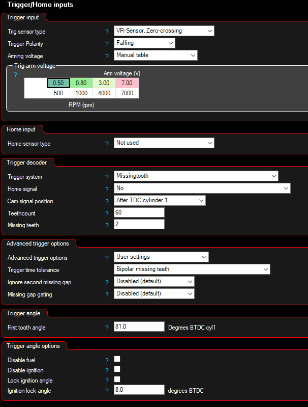

I run a MaxxECU Street in my car. Verified with timing light on K4J 1.4 16v. Reduce trigger arm on 500RPM to 0.25 tho.
