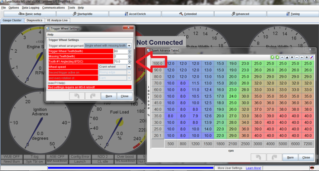

tooth#1 angle
Car  Renault 5 Gtt ph1
Im building a renault 5 with a 172 engine on a Megasquirt 2 ecu, i already got the engine running.
But i am not sure about the ignition settings and table could anyone confirm if this is a good base map
and if the trigger wheel settings are correct?
