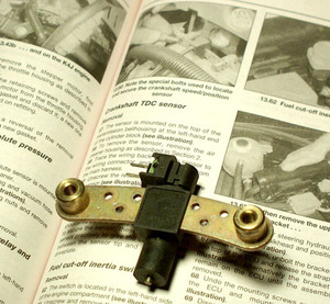

  Clio II RS ph1
In case you need to know how it looks like mate.
