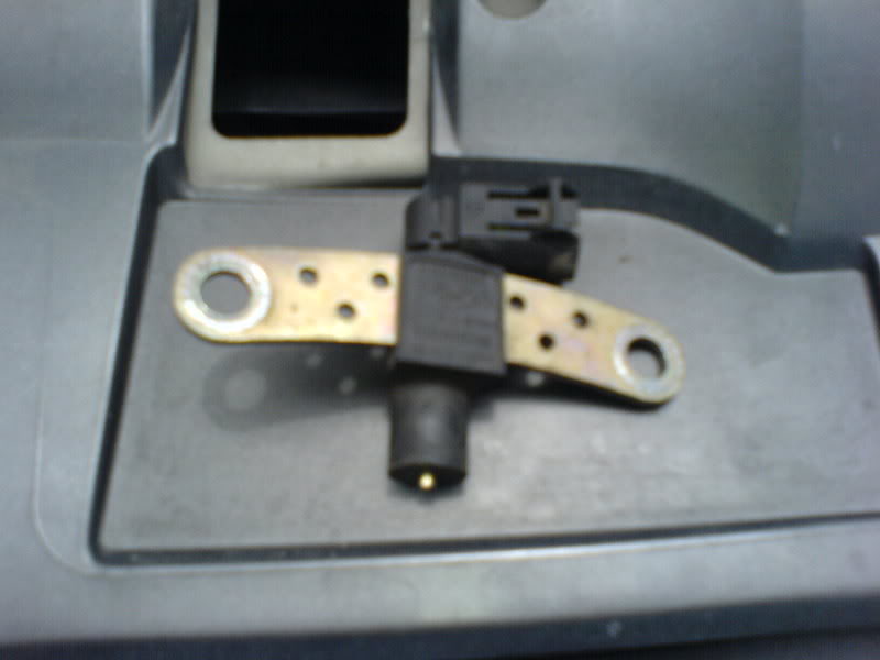

TCD sensor, or CAS (crank angle) sensor provides the ecu with crank position information. Its either a hall effect or variable reluctor and uses a pulsed feed to provide the ecu with rpm information, and uses a missing tooth or teeth on the trigger wheel to refence a certain position on the crank, (usually 90 deg before tdc).
I've not seen one fail because of cold weather, and if one does fail, the engine wont run at all.

Hi, the TDC sensor just detect like Ben said the crank position so if it fail just do not start the car and no problems with cold start problems due is a simple magnet so or detect or no detect, and in most cases the real problem is the TDC conector
