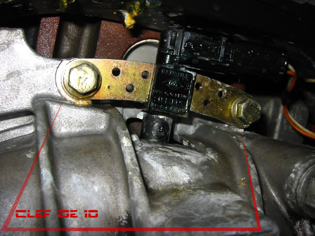

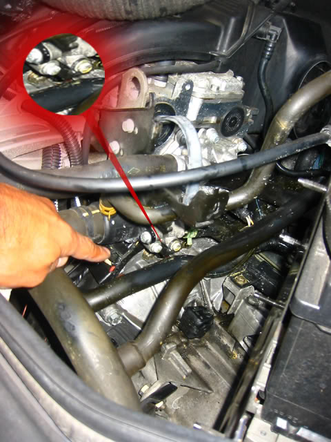

TDC sensor sits right ontop of the gearbox bell housing. Dead easy to change, if your getting a new one from Renault you'll need to cut and swap the loom over to the new improved one.
