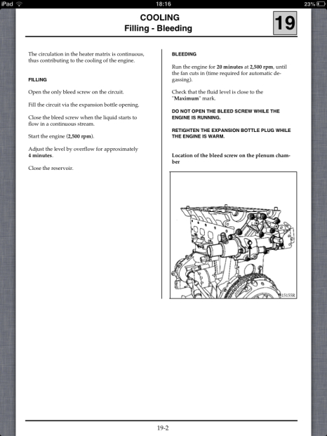

Guide to fill and bleed correctly
AH. This anit no air lock mate. Something's up with it. Still appreciated though. Thankyou.

You said it could be, plus when refilling you will need to do the correct procedure after changing the thermostat
Yeh old be now ive topped it back up. But why's it doing this? My main concern ATM. I'll follow the the guide ttomoz when fitting new stat. Thanks Dan.
