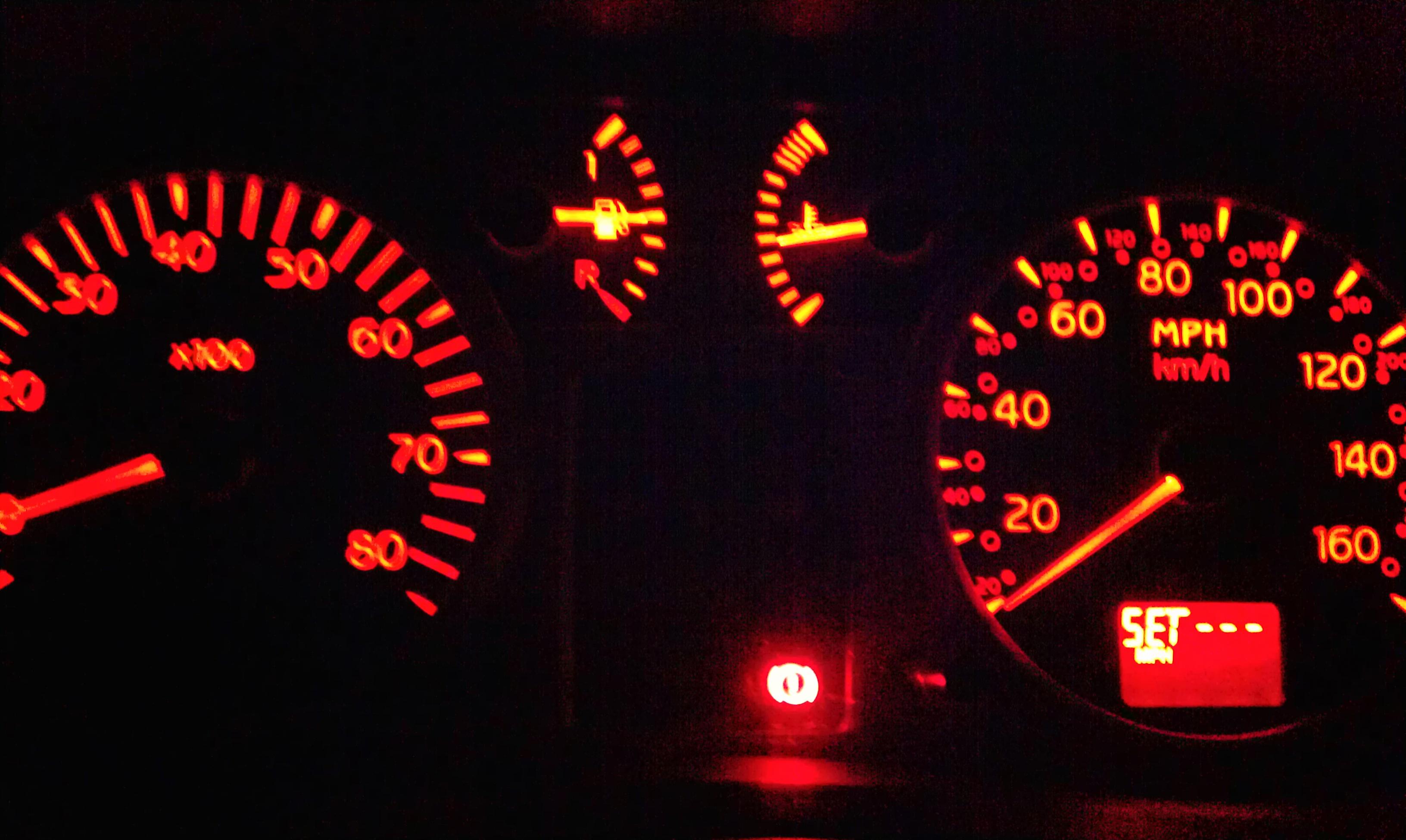

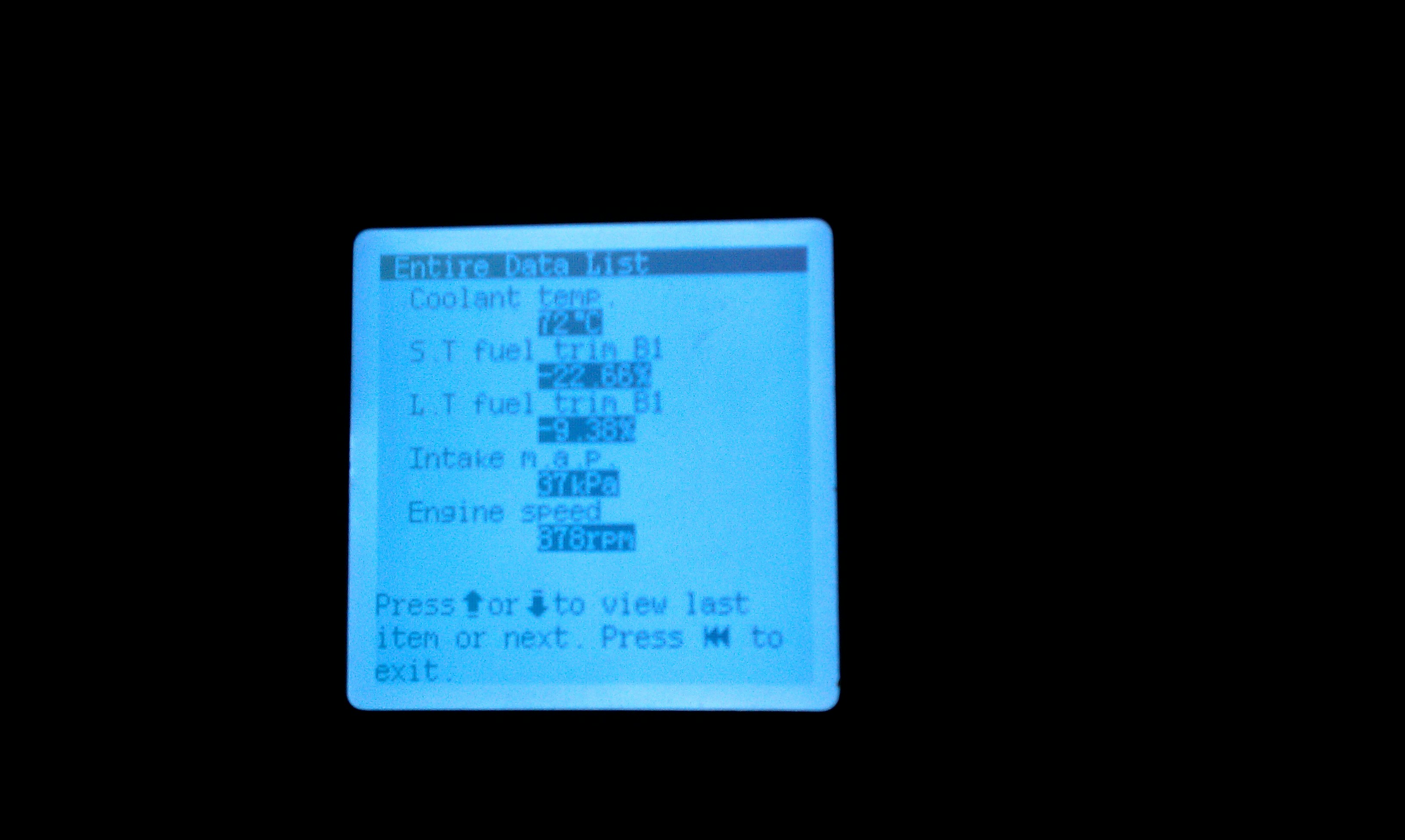

I have similar problem.
1 hour drive home from work, live data stream indicates coolant temp never went over 72 degrees C.
Was reading this forum last night so checked rev limit in second gear several times never revved over 6800.
Is it just thermostat, cts or change both?
Some pics: after 1hr drive.
  182/RS2/ Turbo/Mk1

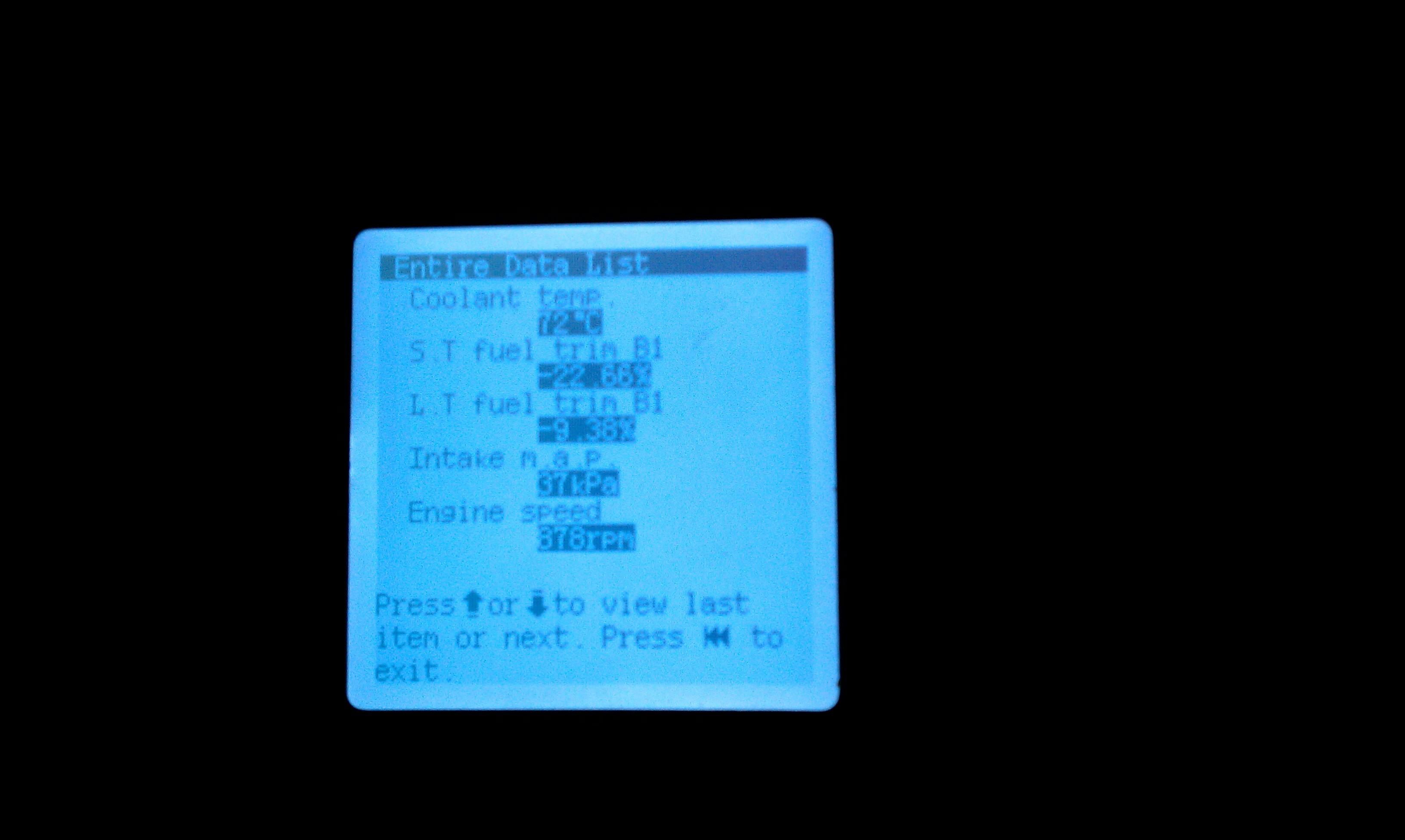

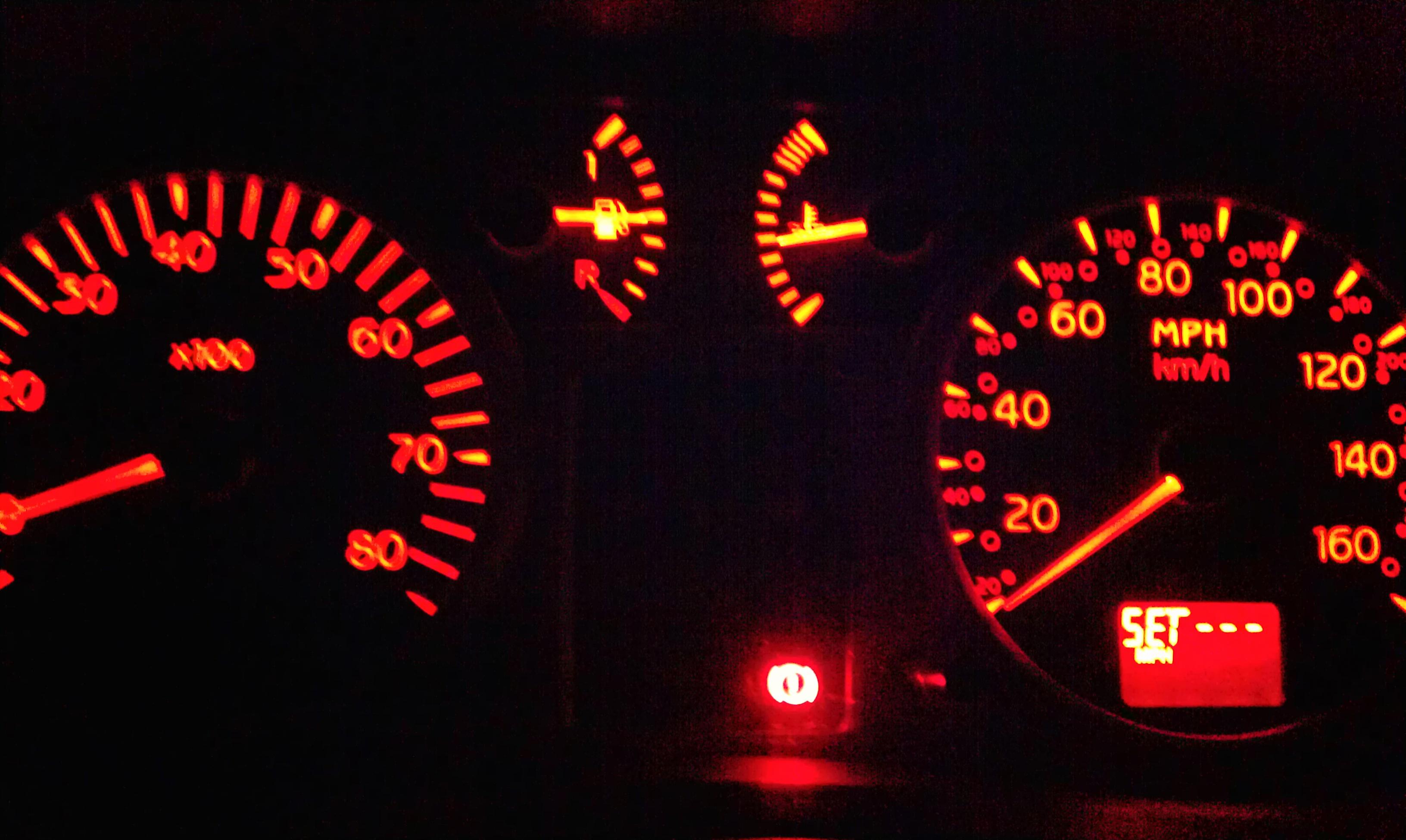

CTS is far more reliable than the thermostat, so change the stat first, if it still doesnt get upto temp it *could* be the CTS so worth changing that as well at that point.
I think mine might be the same as yours MWRS182 but will test it out tomorrow. What device are you using to see the live data in your picture?
  derv biege barge
BLT : i use this : http://www.launchtech.co.uk/enthusiast-diagnostics/c-reader-v
I managed to obtain one on ebay for £50, compatability varies from car to car but the official claim is "any OBD2 compliant vehicle 2001 or later for petrol & 2004 or later for diesel"
It works ok on most cars I have tried, although on the clio it only reads engine codes in the form of freeze data, it can turn off the engine light though and perform full data streams, I have used it previously on my old Saxo VTR, Helped me diagnose a duff map sensor and 2X lambda sensors( 1 on saxo 1 on clio) so worth the money in my opinion.
