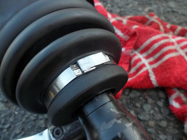

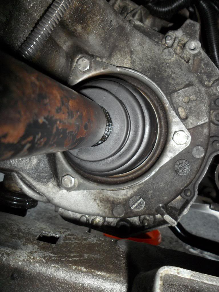

I would drain whats left in the box oil wise, remove the shaft and clean the inside and out of the boot and use a proper clip that will last and seal properly, not a random one. If it's not the right fitment / done up too tight / not cleaned up properly etc, you'll risk it popping off, and that isn't something you want at the back of your mind when your pushing the car in my opinion.
Here's the clip I used on my old one
Does yours look the same at this one below?
Unsure what you mean by large clip?
Should just be the triangular plate for the 3 bolts to the box, the boot and a small clip on the bearing side.

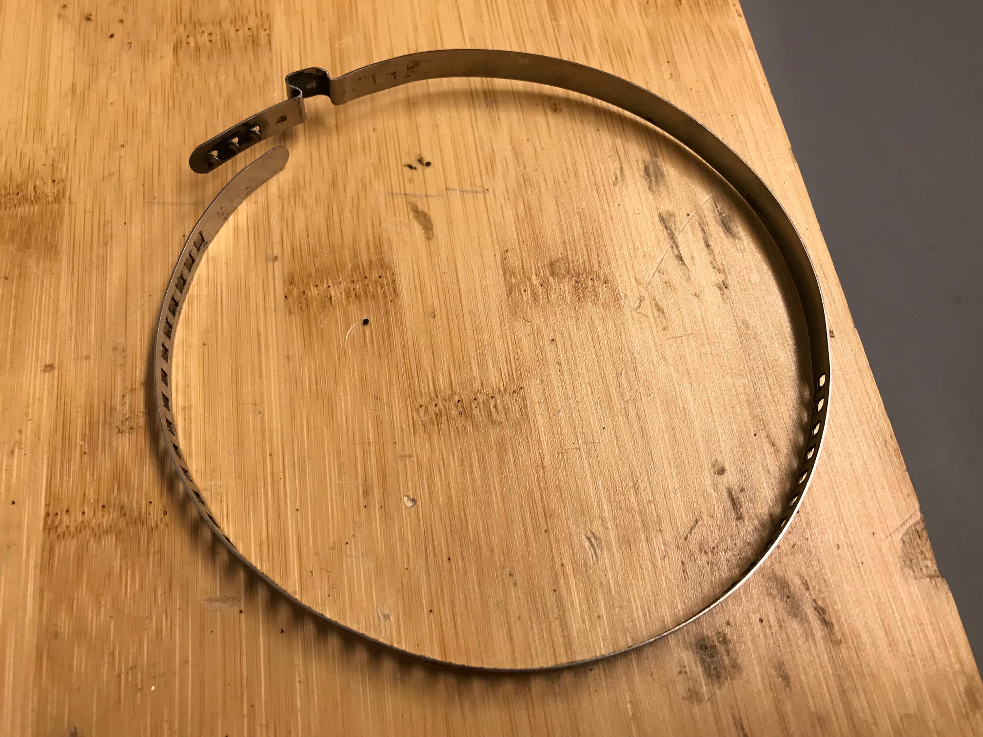

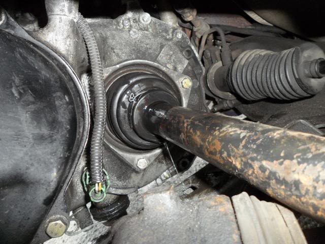

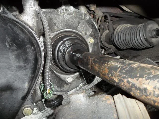

Thanks Chris, that's really helpful. It's all back together now but I've just gone and checked the car and there's a drip of gearbox oil on the boot next to the jubilee clip, so I'll go and get the proper CV clips as you suggest. It looks exactly like your 2nd and 3rd images.
The only snag is that the large clip below was found on the boot. I'm not exactly sure where it came from as I was trying to mop up gearbox oil at the time but it's in the photo below. It's confused the hell out of me as I thought the traingular plate with the 3x bolts just clamped the boot up to the gearbox on its own....
Bloke, sorry you're quite right, it's not a circlip, I'm not thinking straight :S
Chris, yep just checked, it's come off the other end. I'm such a muppet, it's so obvious. I just assumed it was somehow off the gearbox end.
