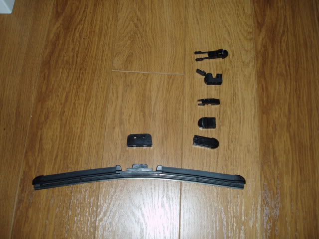

here's a pic of the existing blade and then the tesco blade with all the adapters.
Any help on which one i should use?

i used that one and haven't had any problems with them, and they've been busy over the last few days of rain
they might not be compatible, but see if the adapters on the arms you've taken off can be used; what i had to do when i bought some Halfords blades anyway

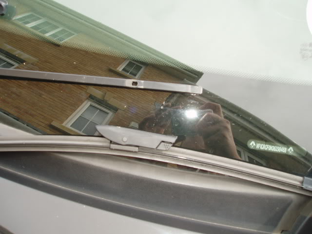

Thanks, but i don't have a hook on my arm it's just flat. can't remove the existing attachment either :( Do these only work if you have the standard hook type arms?
Ah, that's probably where the confusion arises. The Mk2 has the hook on the end. I've just fitted a set of 22" blades to the V6 as well in literally 3 minutes flat.

The bit that is directly above the blade in the centre, should attach on the blade and I think I used the 3rd clip down on the right which clips onto the top of the bit on the centre. Pretty sure that's what I did with mine. Then you hook the wiper arm through the gap between the two pieces and close the pieces together with the wiper arm hooked inbetween them. I can't remember if that's exactly right as it was a piece of piss and I didn't think too much about it lol

From what I can see in your photo your blades look like the flat ended arm ones, and the tesco ones shown are for hook ended arms if Im right, so you need the blades specificially for flat ended arms, like the one you took off.
