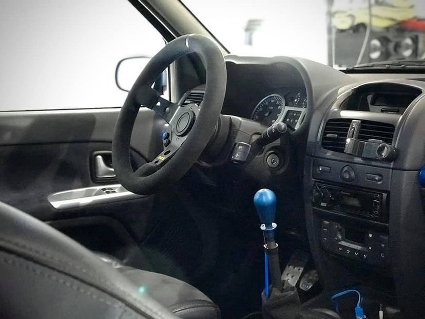

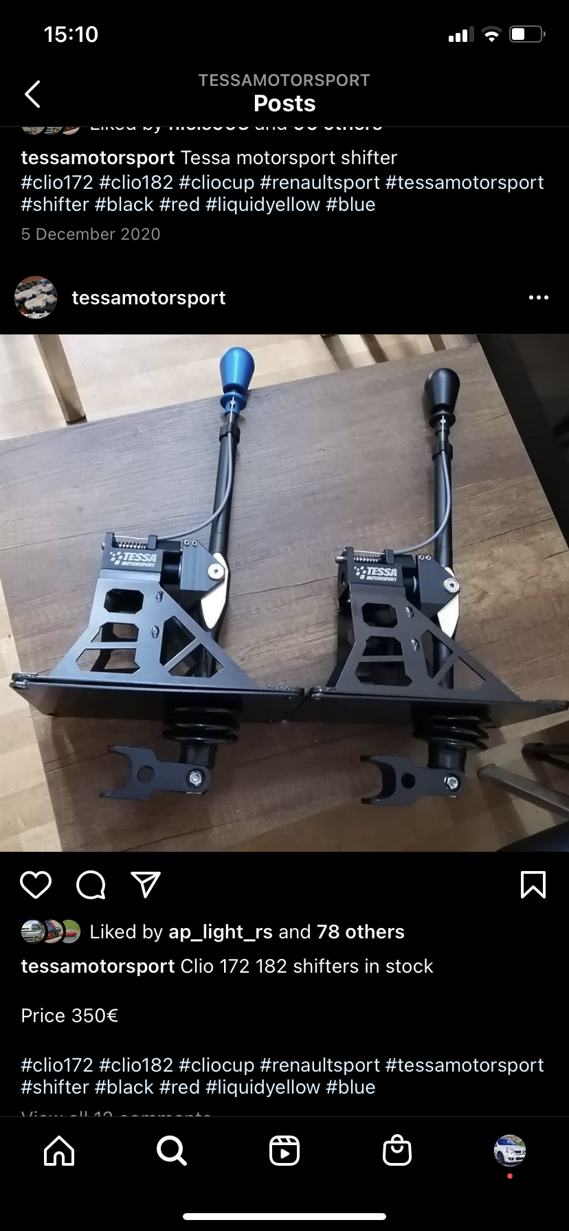

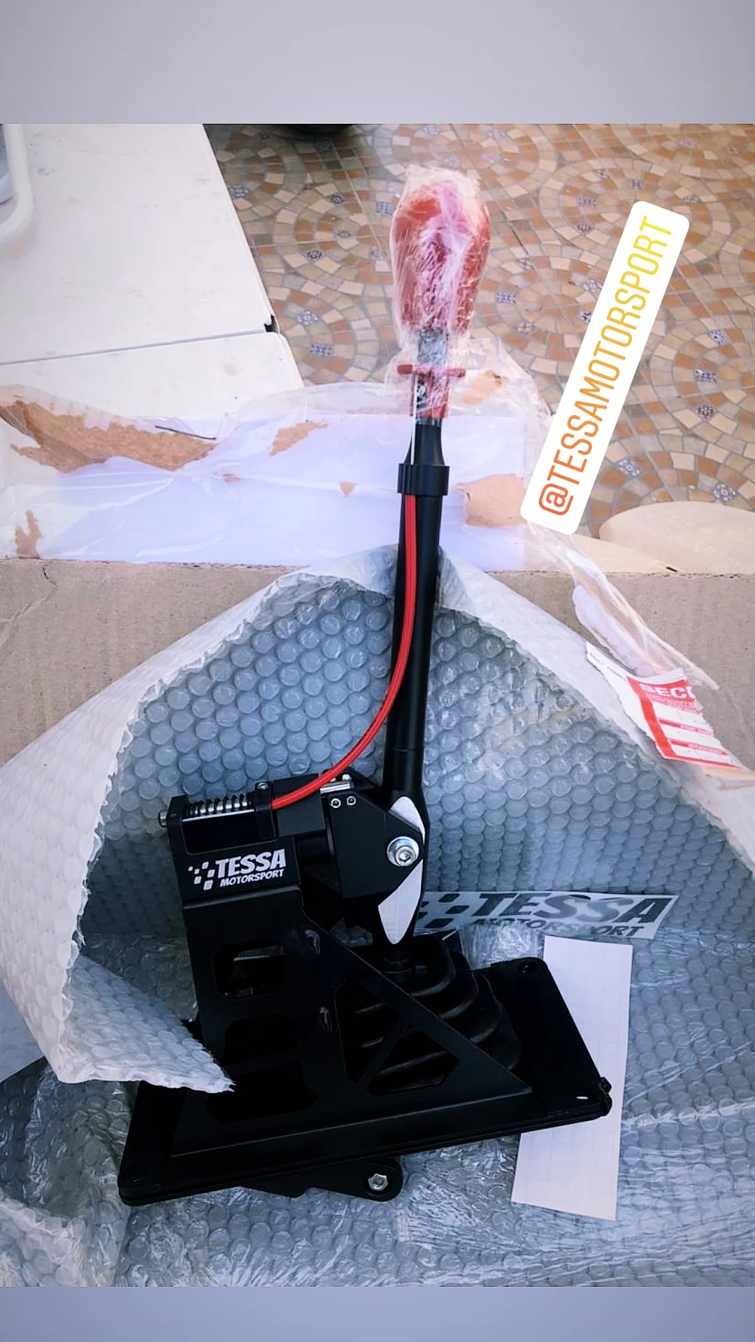

So understanding there is some history over the inlet manifolds. But that to one side, anyone know anything about the Tessa Clio shifter? They look pretty cool, but other than that I can’t find any information. Do they use the standard linkage? Anyone know what the gear shift is like, are the completely s**t? Ignoring the standard response ‘just buy a PMS’ I’m genuinely interested on thoughts, or views as for €350 delivered they look decent value

Nope, I have been speaking with him but he doesn’t give any informmation other than sending more bloody photos. They use the standard linkage, that’s as much as I have found out and are about £300

You only get the upright for 300 and it looks like a child designed after watching a Ken block video imo
Can't imagine without the full bushing and linkage arm etc you'll get the same precise feel of the pms and the cable reverse lift design is just cheap and sloppy imo

That’s right, it uses the standard linkage. From the video it looks like a halfway house between PMS and scenic style shifter. I don’t think anyone would suggest it would be as good as a PMS, but maybe a compromise? Can you share a link to the Ken Block video around it? As I can’t find anything online about it at all

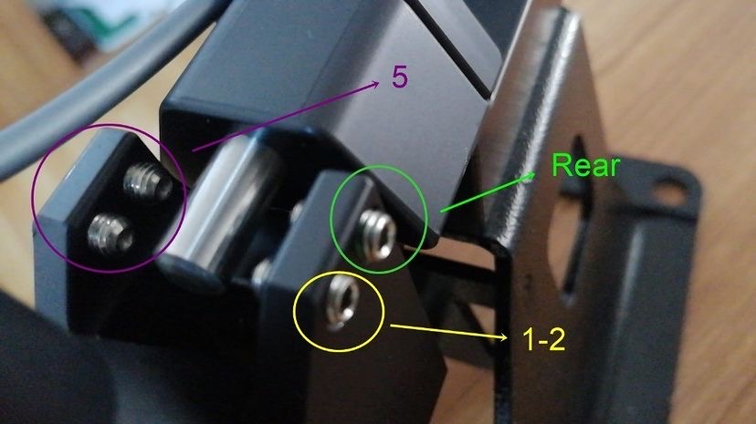

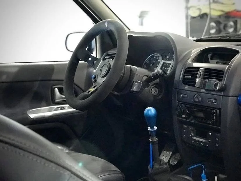

I run one.
I bought it about a year ago and everything was plain sailing. Fits fine, mine is without the seal so is open, but it's just a track car.
Feel is precise, as far as a single rod link gearbox can be. There's not much you can do to the JC5 box regarding feel.
Fiddly to set up to start with, those videos look like they wanted to modify it for an even shorter throw, you can see they've extended the two lower parts, they should be flush together. They've had the 'extended' section come loose. The other videos look like product errors, I needed to modify nothing on mine to fit..
Even as a road car mine is totally usable, I only go down to the shops really, but it's fine for me.

Do you have any photos for installation. Cause I bought one and willing to install it next week

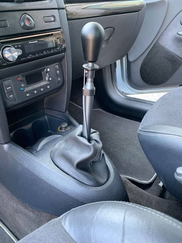

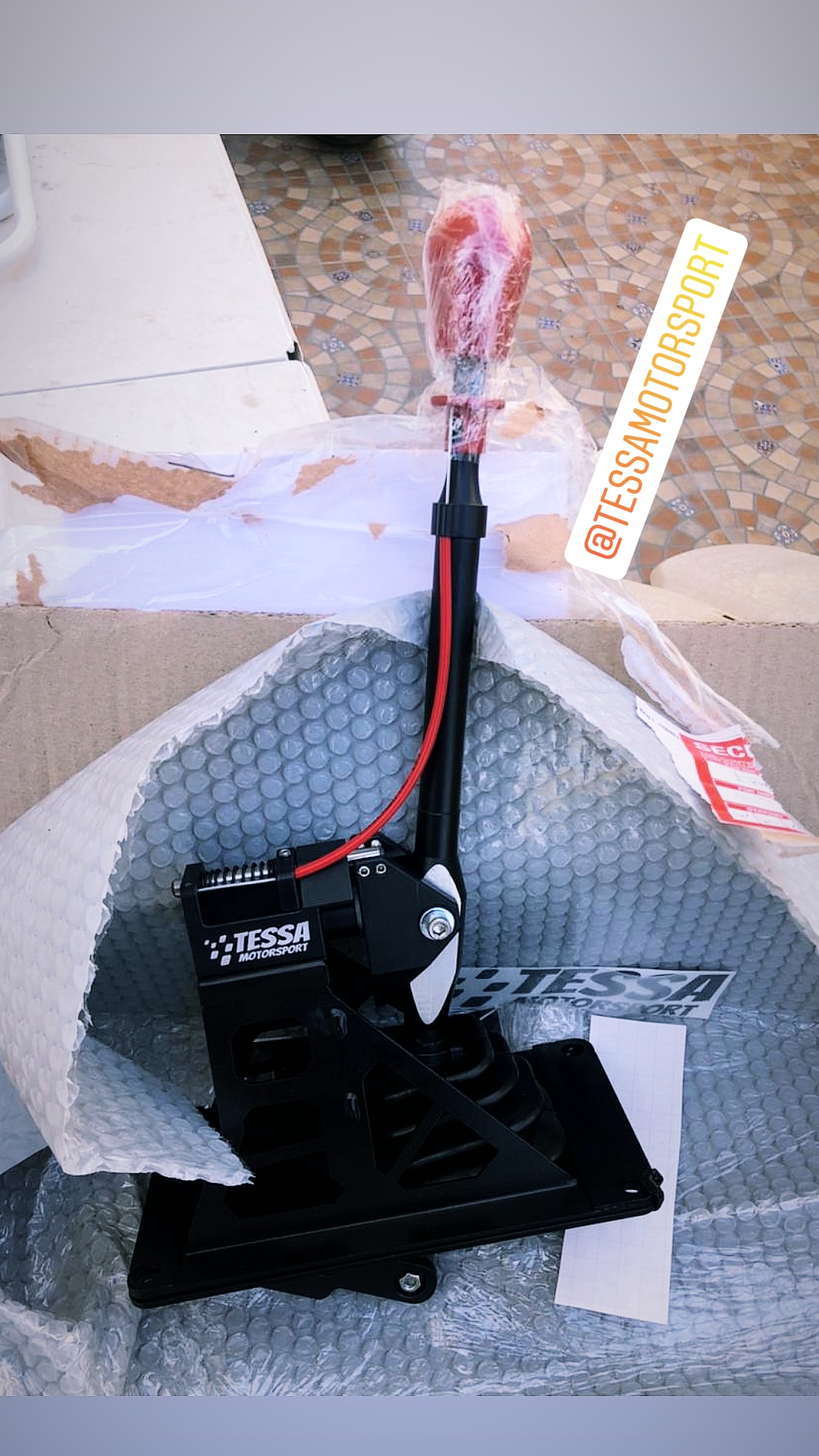

my review of it:
received it. paint is fine but the material isnt a nice and good looking as the CAE,PMS and ZPO shifters. when fitting holes were fine, but it left a gap in the floor letting me stare at the exhaust. then shifting is good, but feels flimsy. if you have anymore questions, feel free to ask. i think its a hot pile of garbage

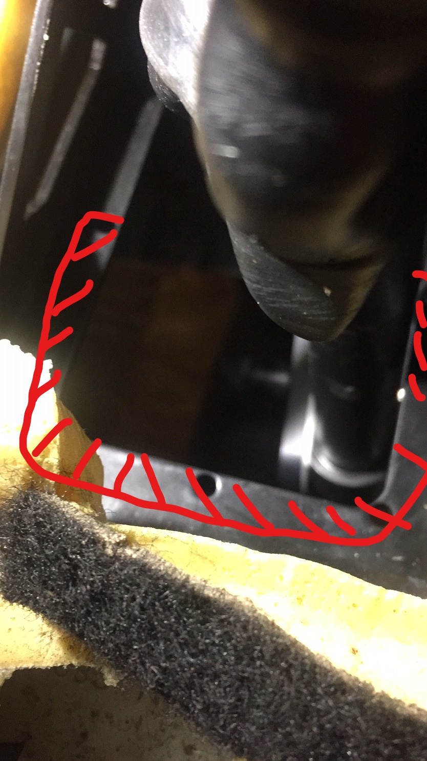

Any suggestions about reverse gear??? Mine can't go into reverse
Right so, It's a nightmare and the design does not work. You will need to dremel out a lot of the gator plate in order to have enough movement for 5th and
reverse. This will allow enough movement of the gear lever.
