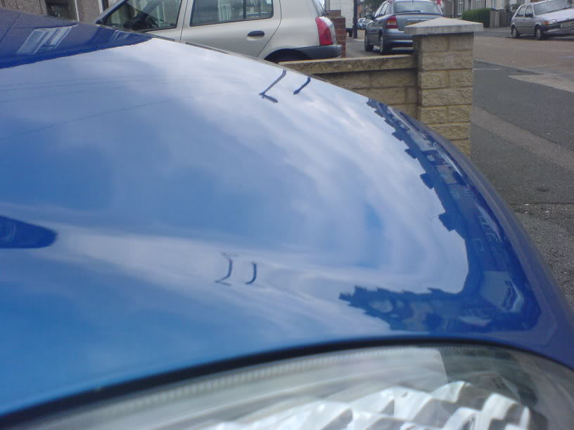

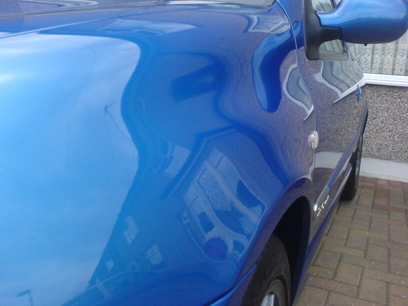

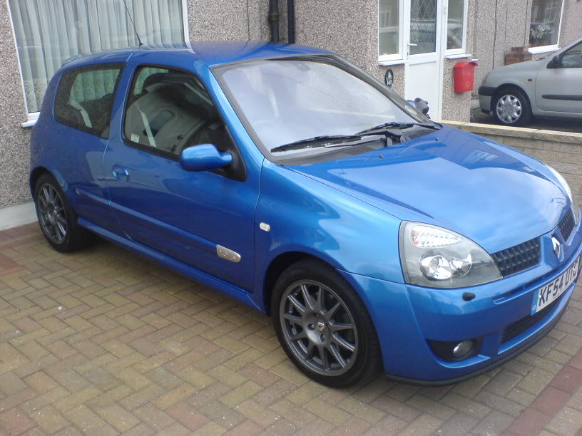

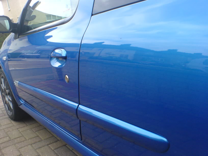

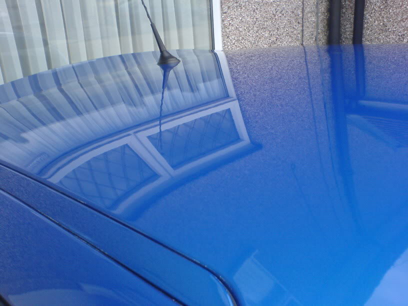

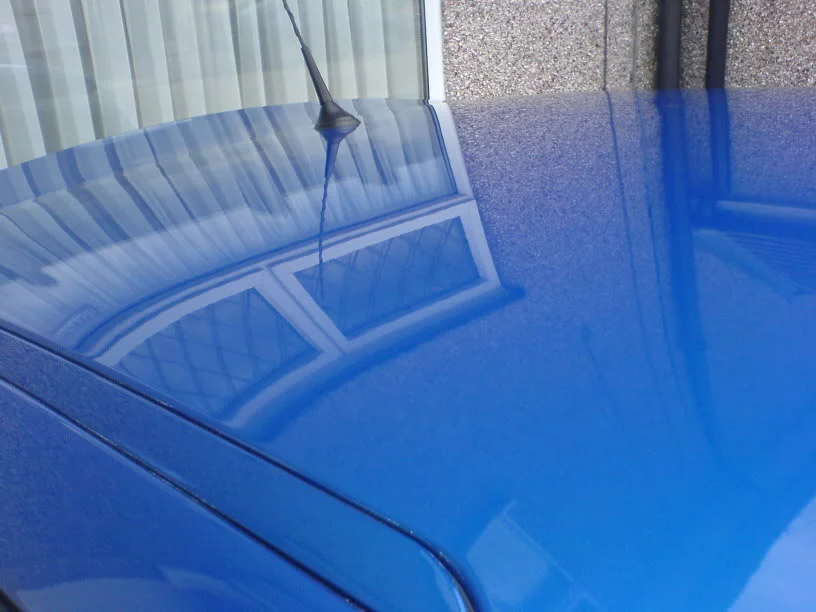

Lads...Thanks for Yesterday...I'll let Brazo write the boring bit but here are pics.
About 6-7hrs worth and then it rained us off.
Note the pics are after a 100 mile drive home from Swindon through light rain at motorway speeds. I touched the bonnet and roof us briefly with some detailer but other than that....here they are anyway.

Pisser it went dark and rained, still looks good despite the drive and rain. Good to meet you fella :)
Would have looked stunning in the sunshine...its overcast here but you can still see the otherside of the street in the bonnet pic!

i hate masking up :( lol Black trim came out well ;)

Rotary to bonnet megs #84, IP and FP2 all at 900rpm
PC and FP2 everwhere else bar roof which got IP first

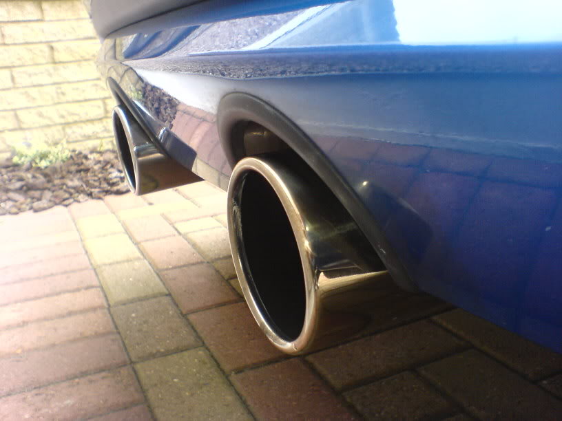

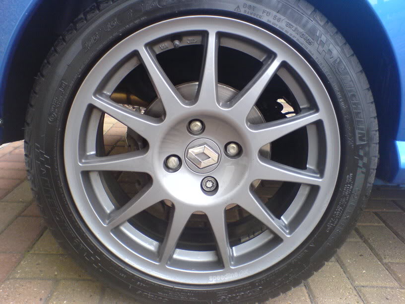

Wheels AIO and EGP
Tyres and arches powermax 3 and then megs tyre gel on tyres
Wirewool 0000 and nxt metal polish on zorsts
Oops and IPA wipedown, Z6 wipedown and Zaino Z5 x 2 to seal!!

Never liked that colour on the 182's but those wheel make it look sooo good!!
Lovely mate!! :)
