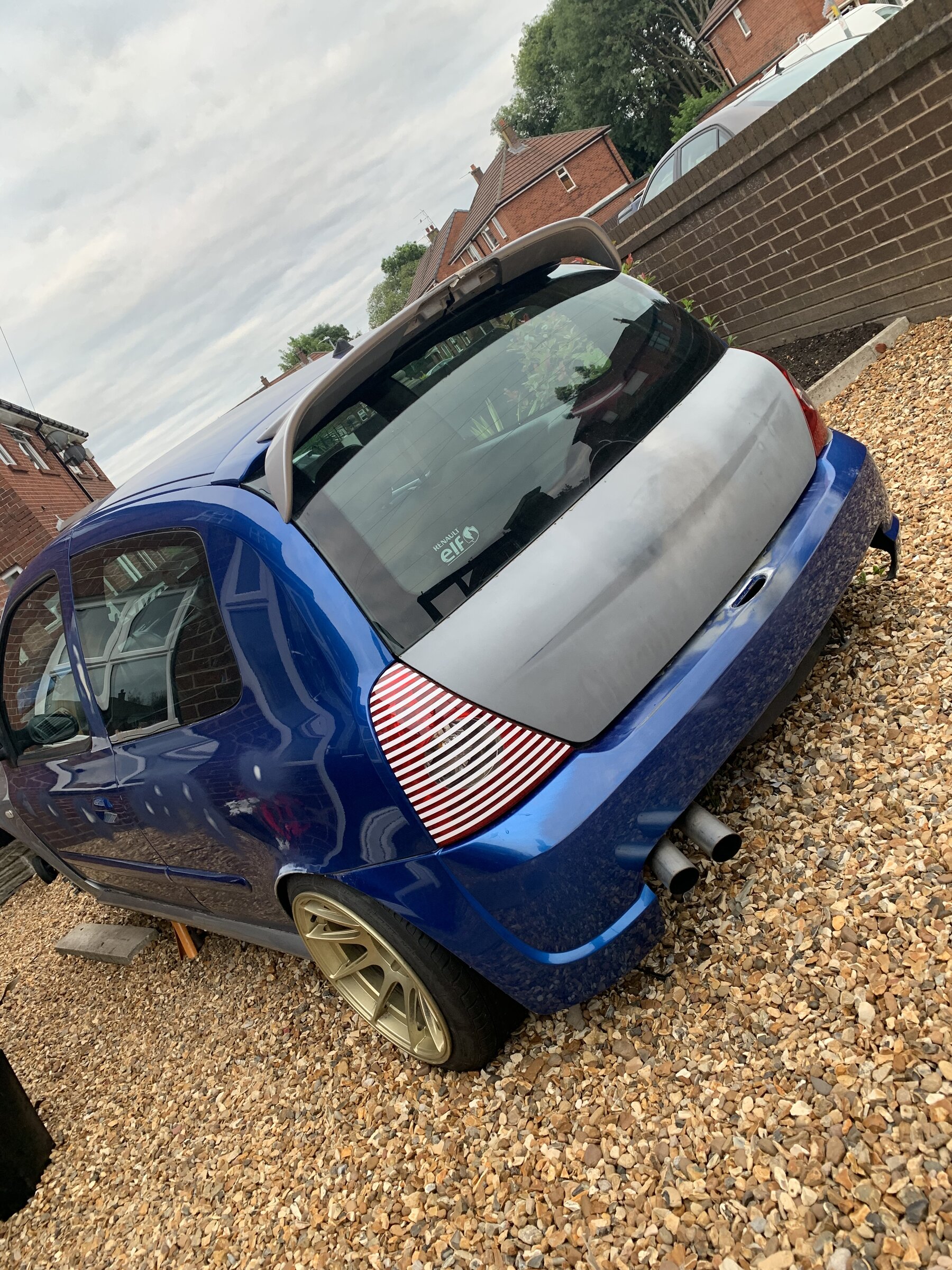

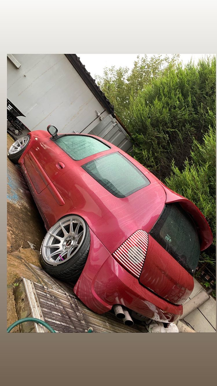

New to the forum, im aware how much hate i will receive as its a 1.2, its bagged and its pink.
But i thought it was time to create a thread whilst im doing a full rebuild.

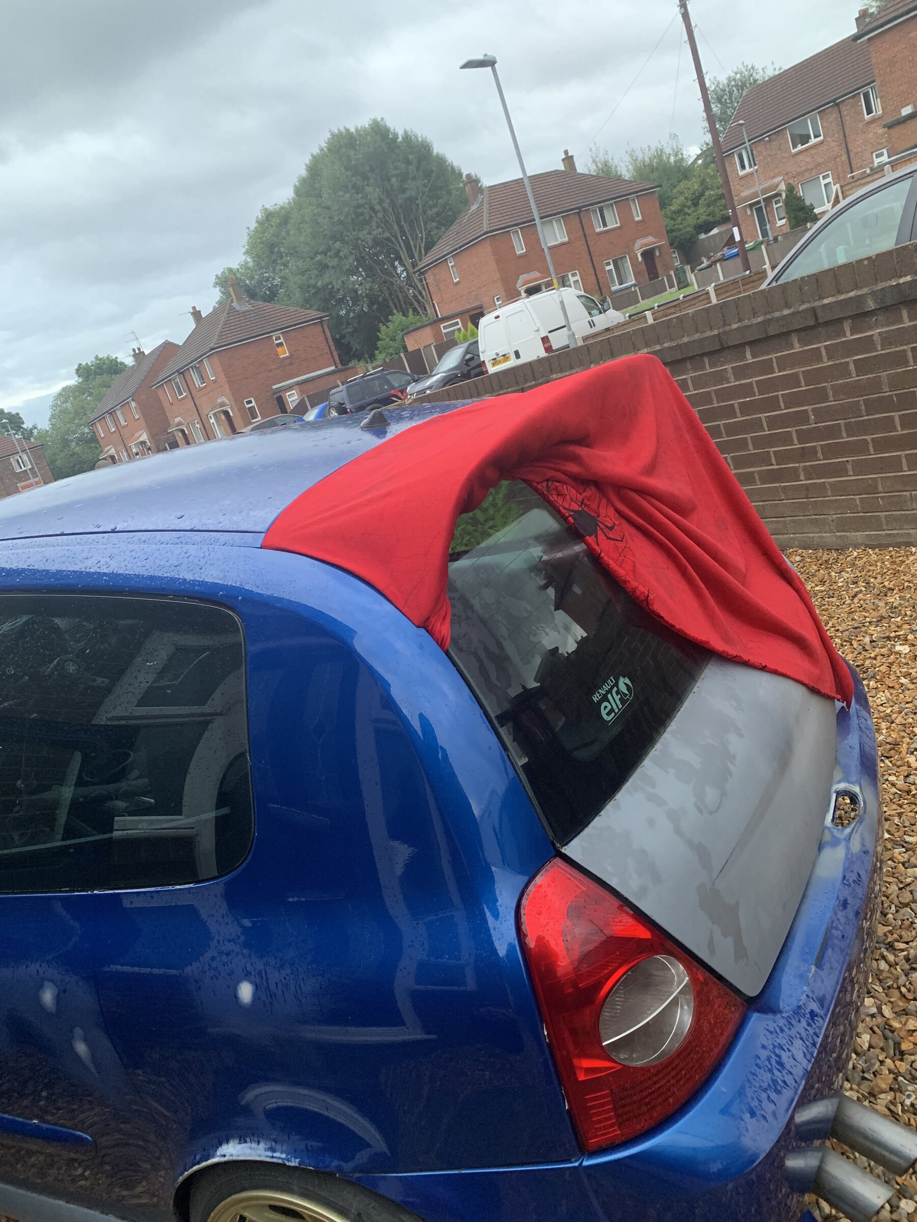

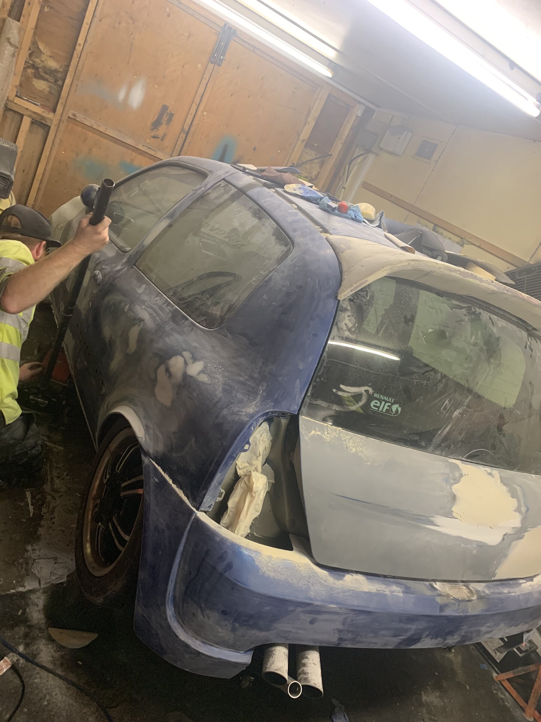

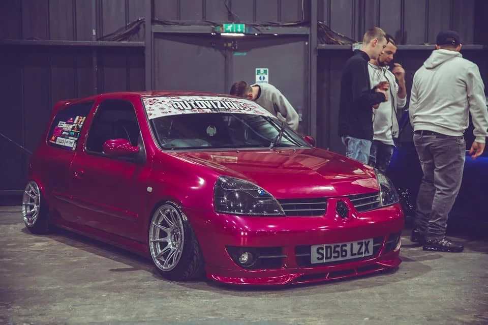

this was the look of the car last year, after having problems with the paint and having someone ram me i took it off road for yet another rebuild. But this time im actually doing things properly instead of trying to make the outside look decent, whilst the rest of the car is Old, rusty and a load of w***.
all the car has been done by myself, its been a learning experience for me as ive never done mechanics, electrics, bodywork, custom parts and upholstery ect before.
only things ive had other people do is structural work, and the paint.
  clio campus sport1.2

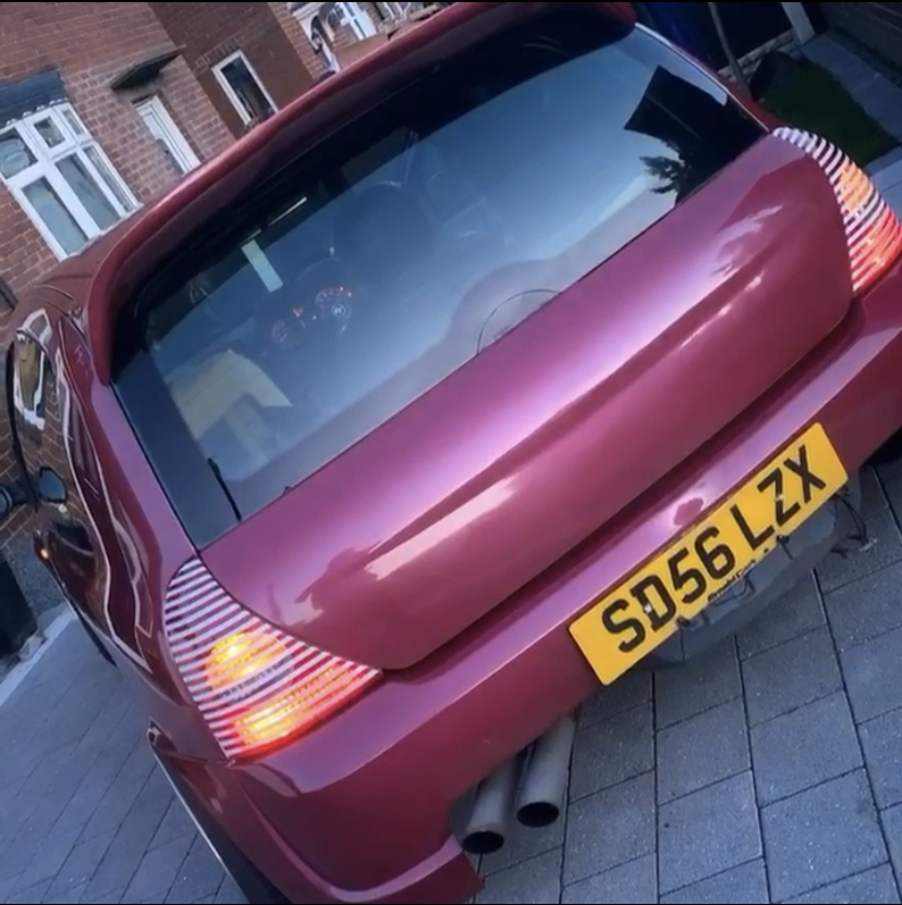

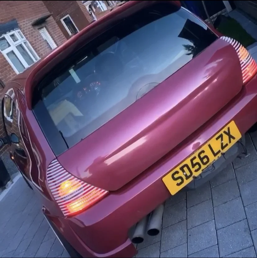

Tbf it doesn’t look too bad from the front but WTF with the rear.
(Welcome though, we take the piss but if you’ve got thick skin you’ll enjoy it here)

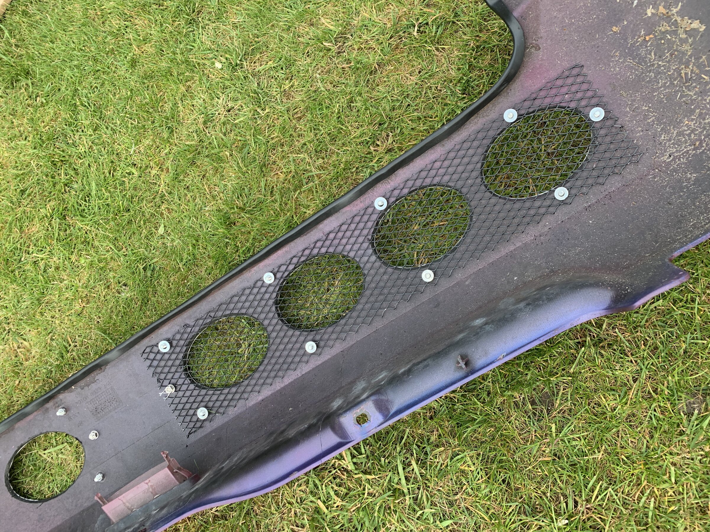

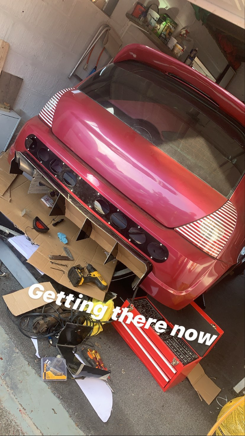

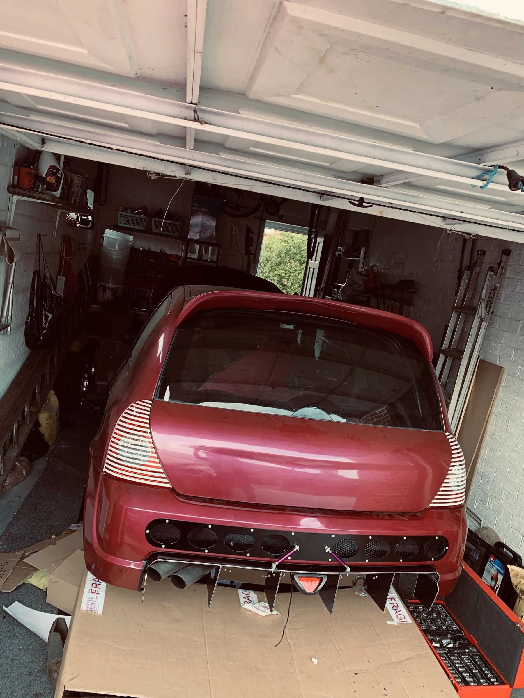

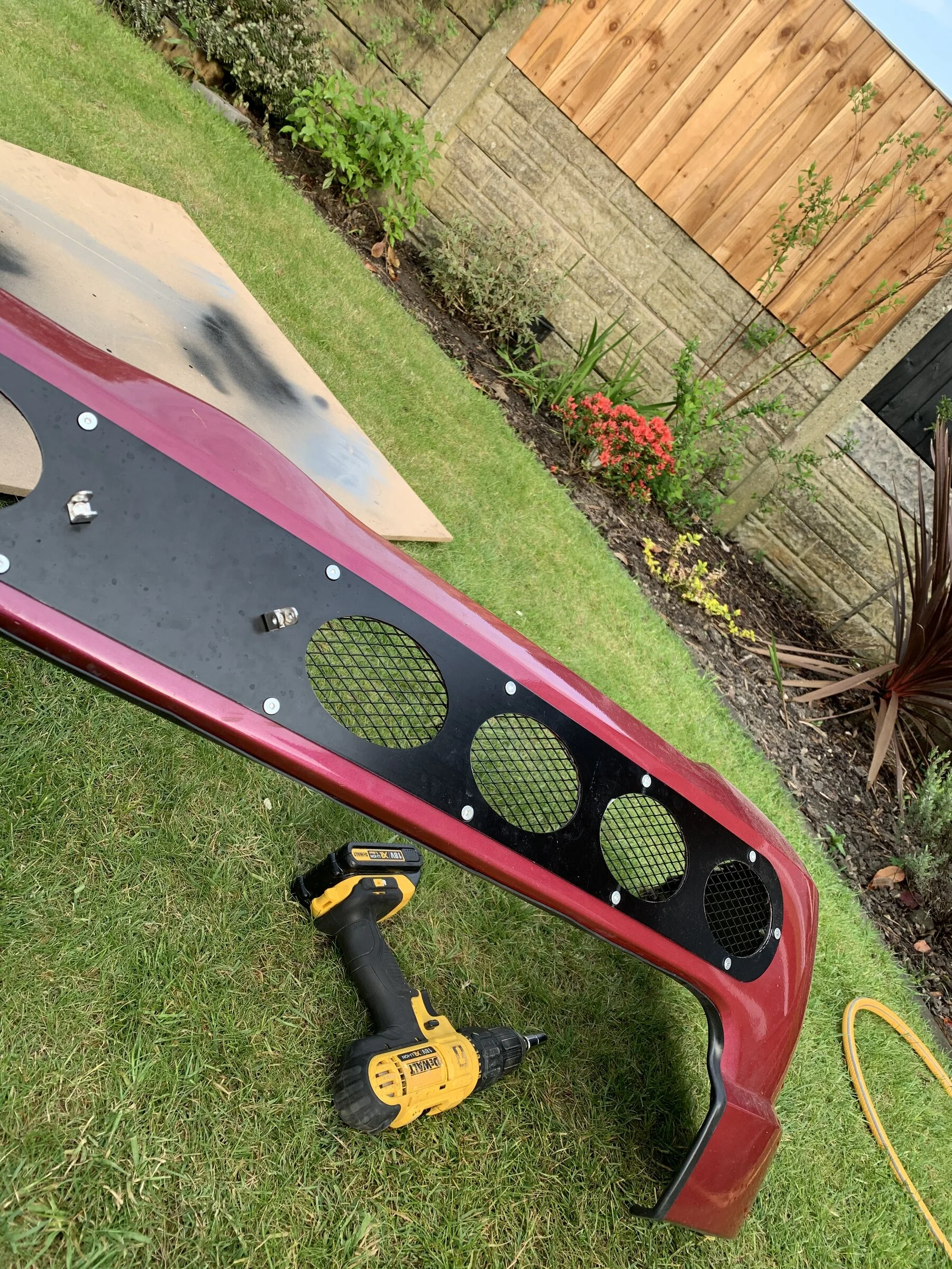

Got to have thick skin to drive this thing trust me😂, and ive since made a diffuser for the rear end. That was the plan last year but i never got round to doing it.

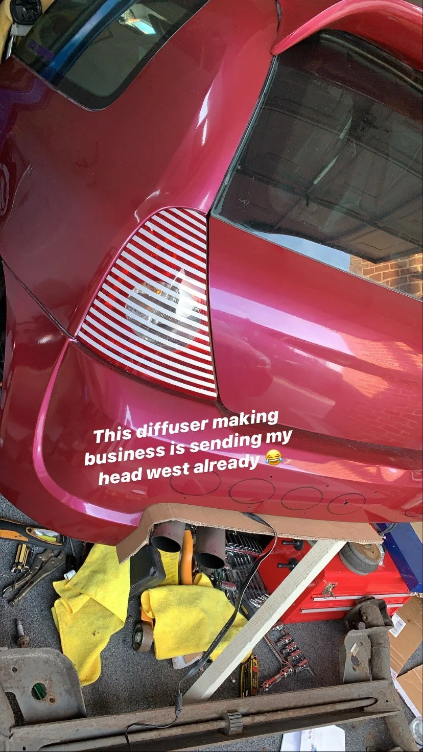

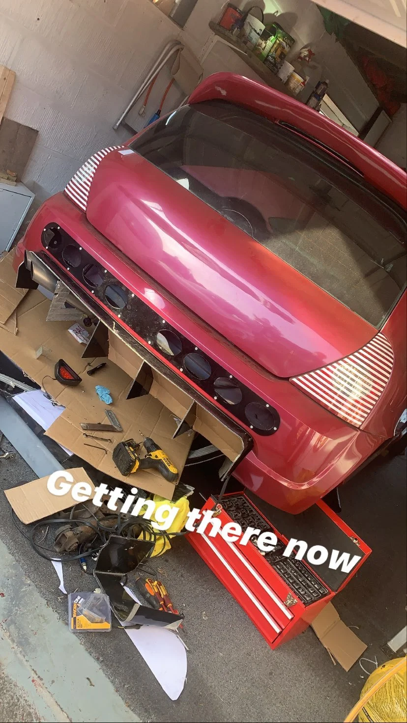

I was going to say, nobody really wants to see your rear wheel well.
Still not a fan of Kanye’s sunglasses on the rear lights though.

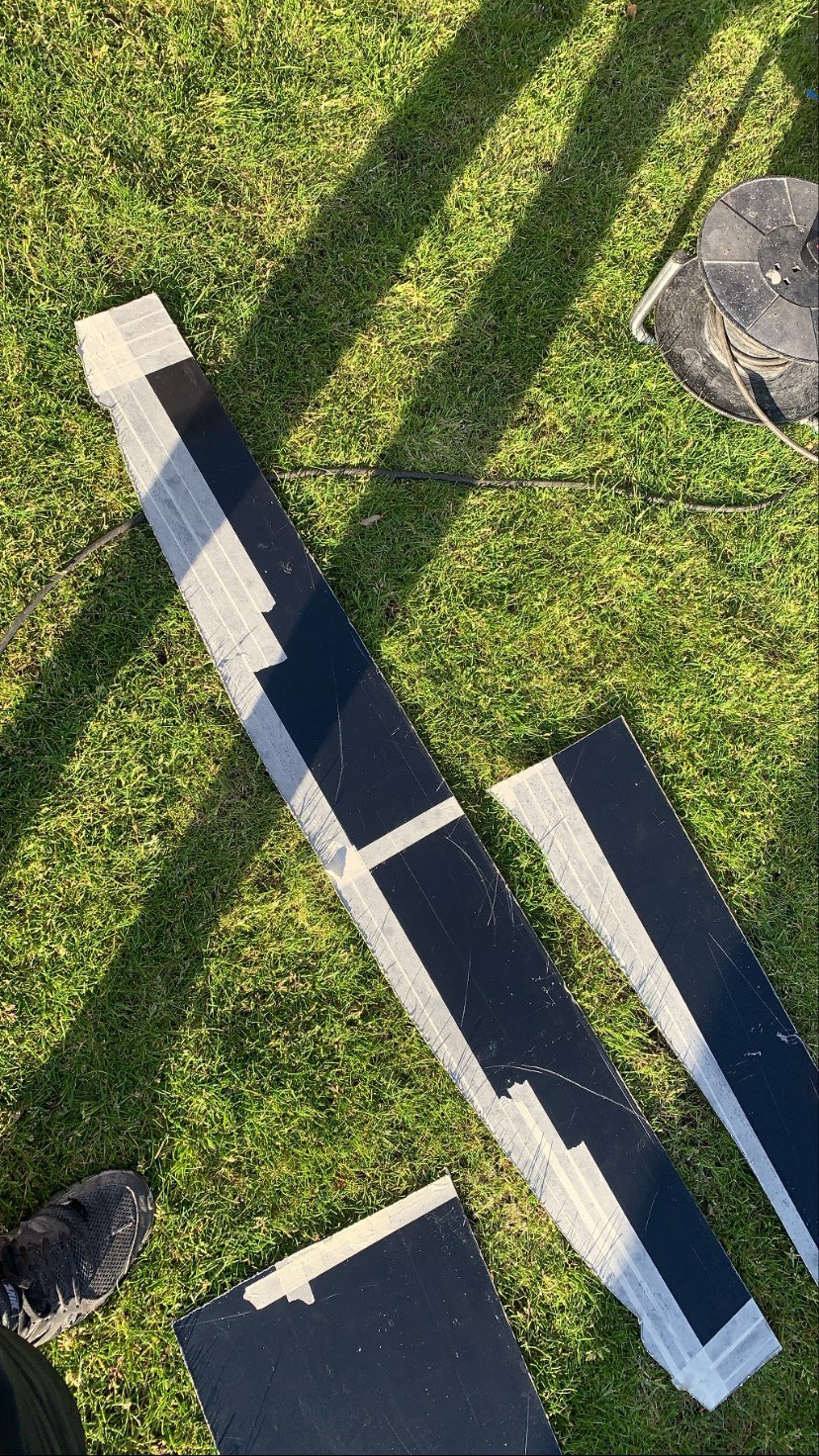

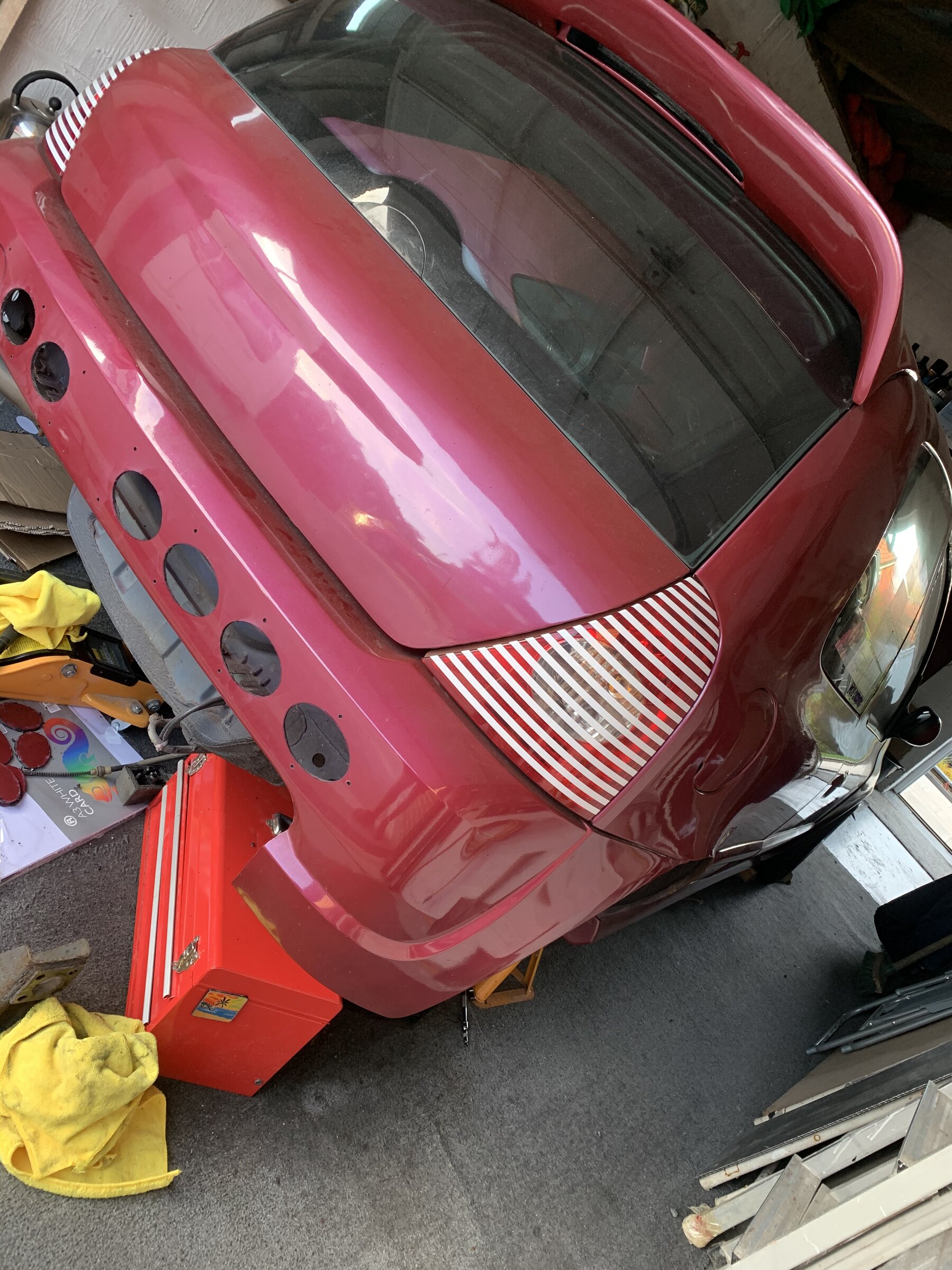

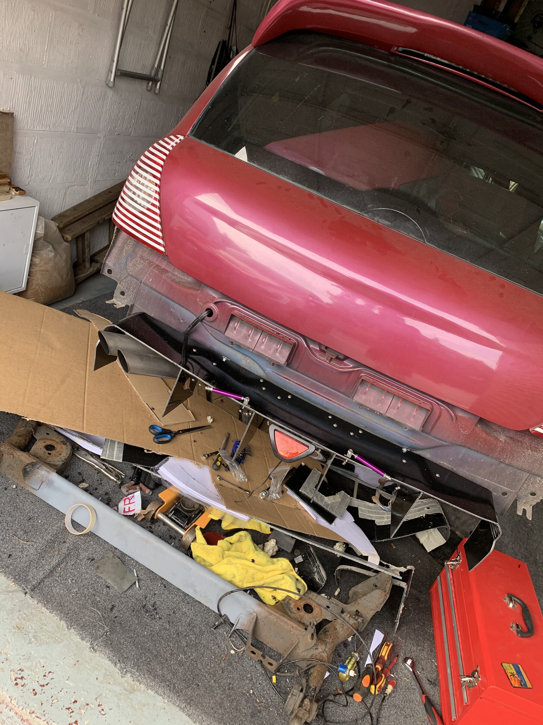

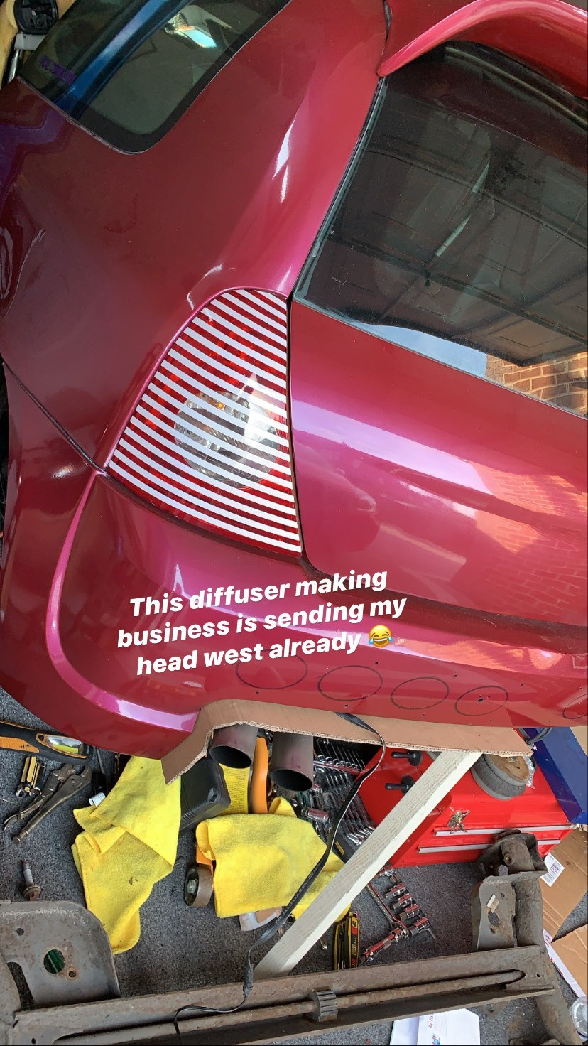

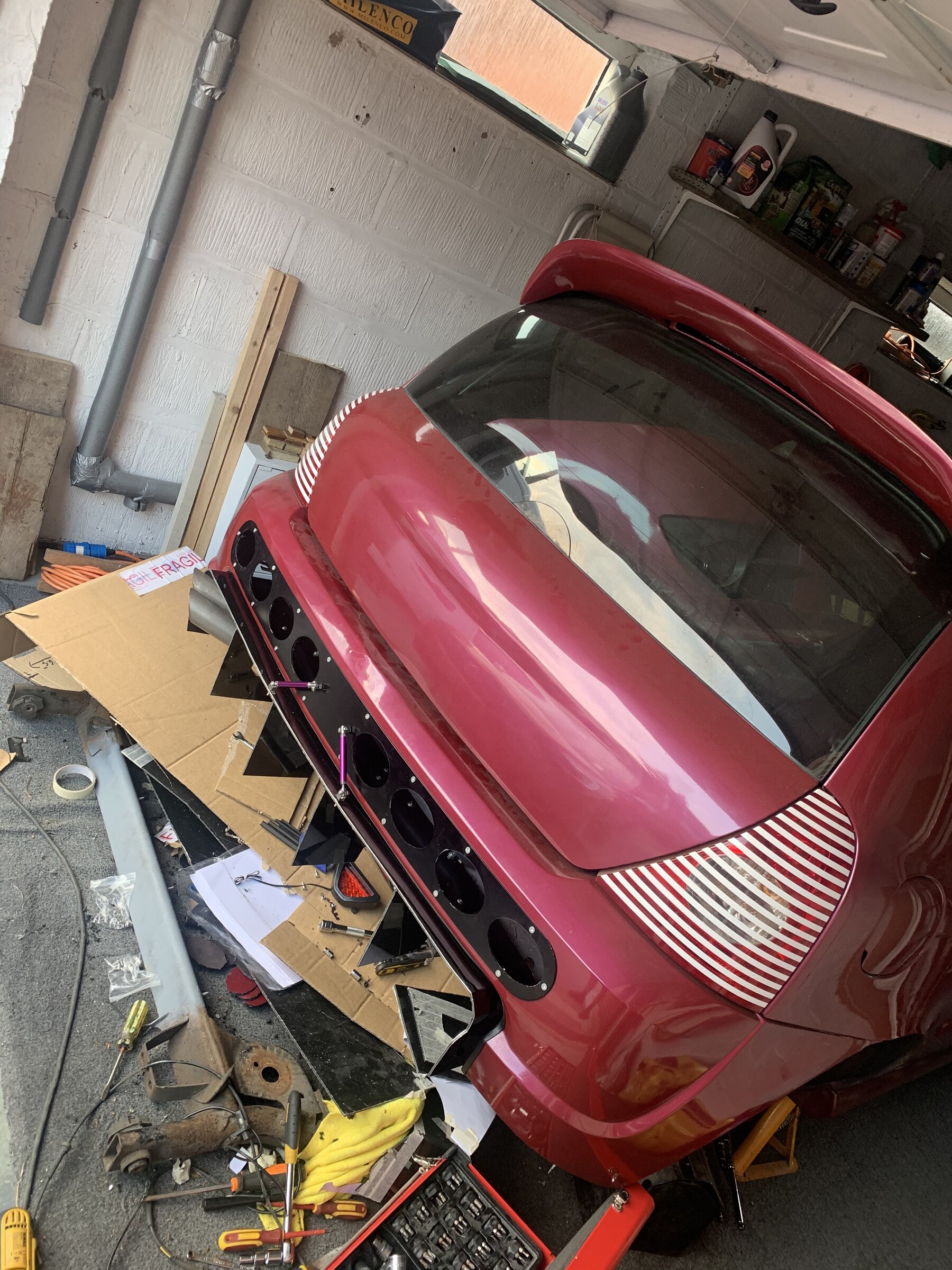

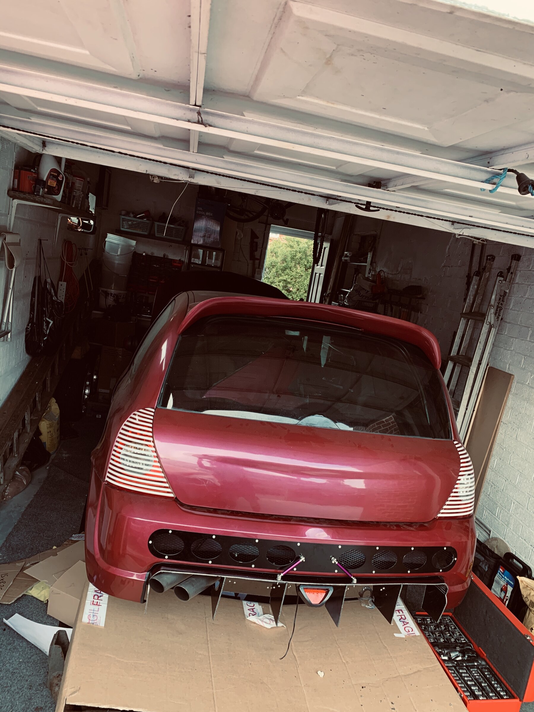

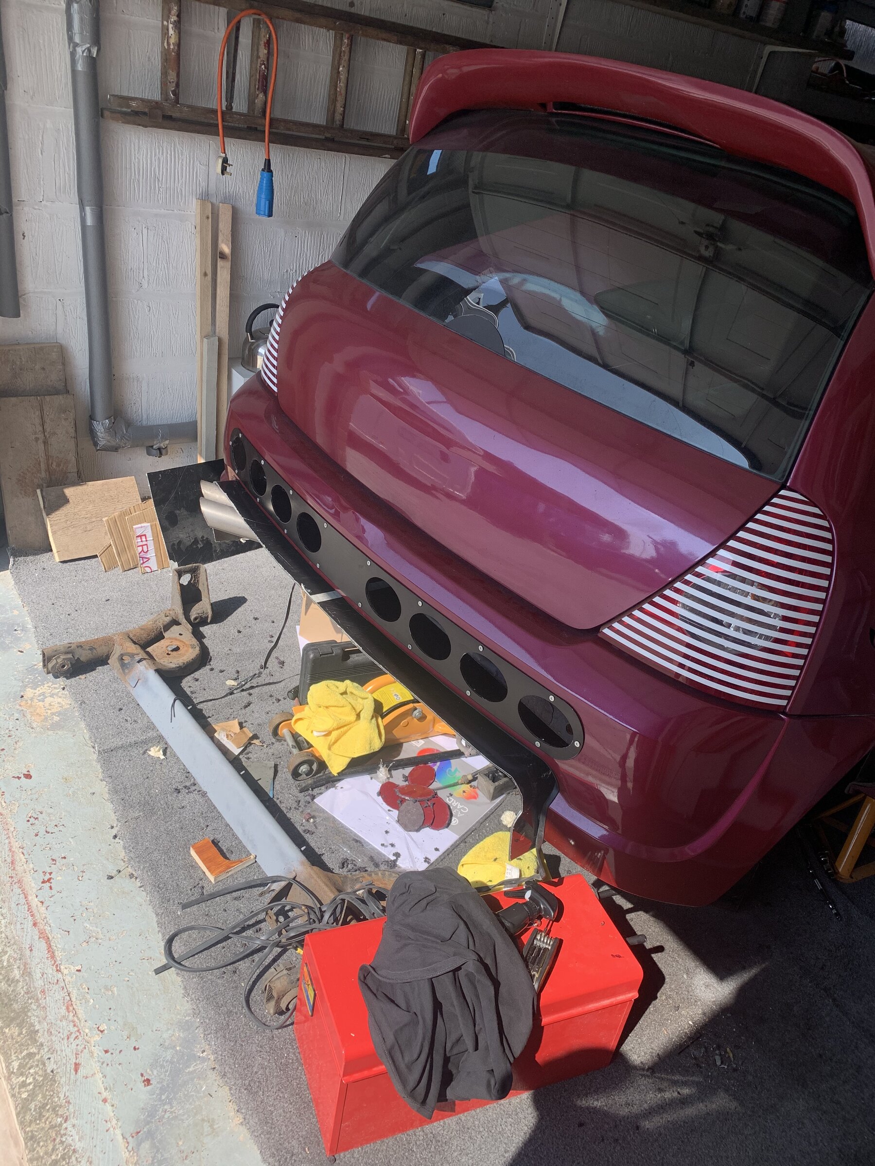

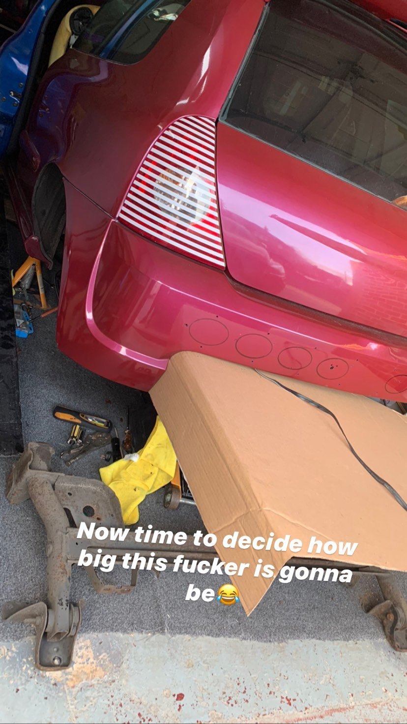

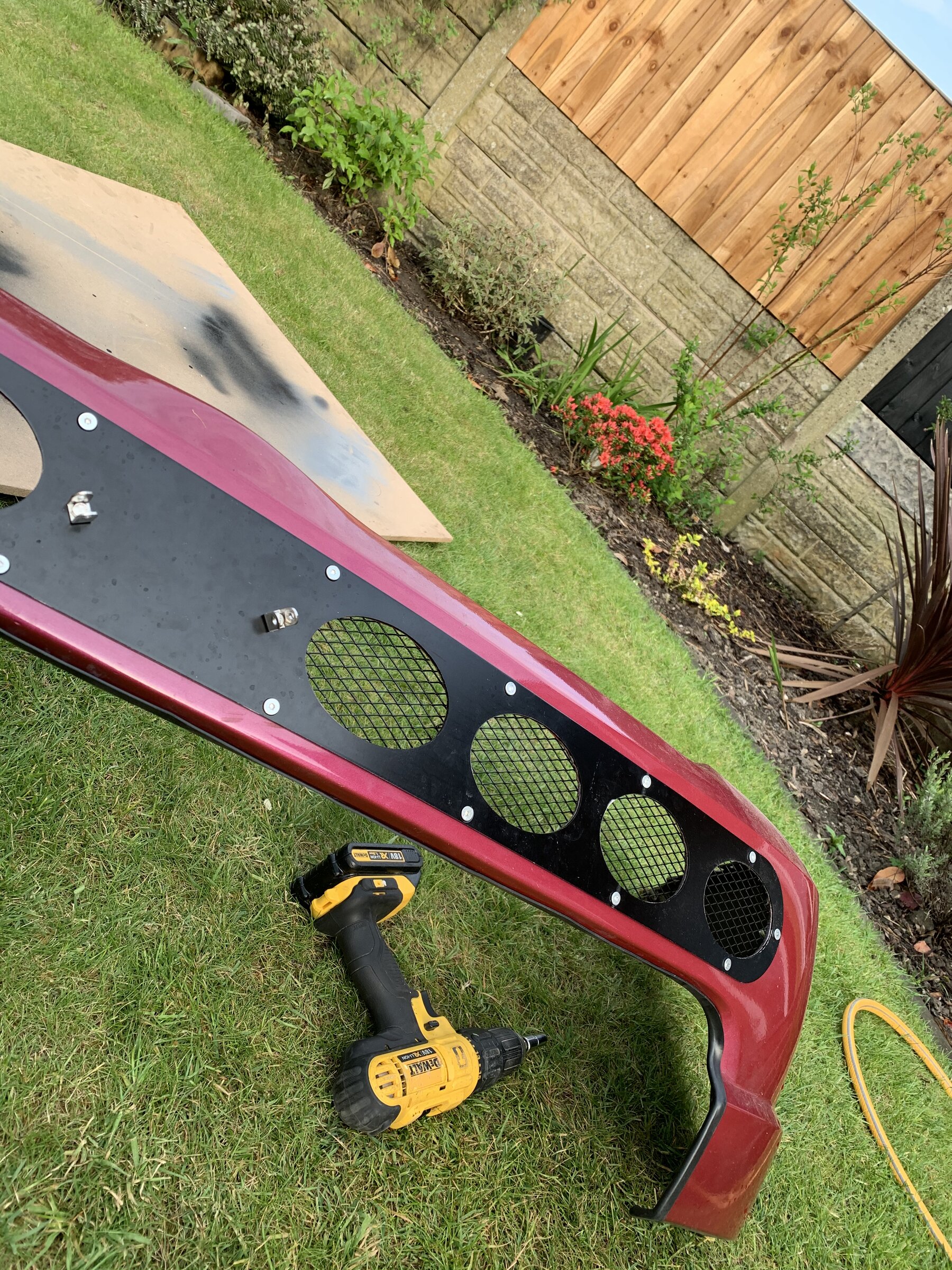

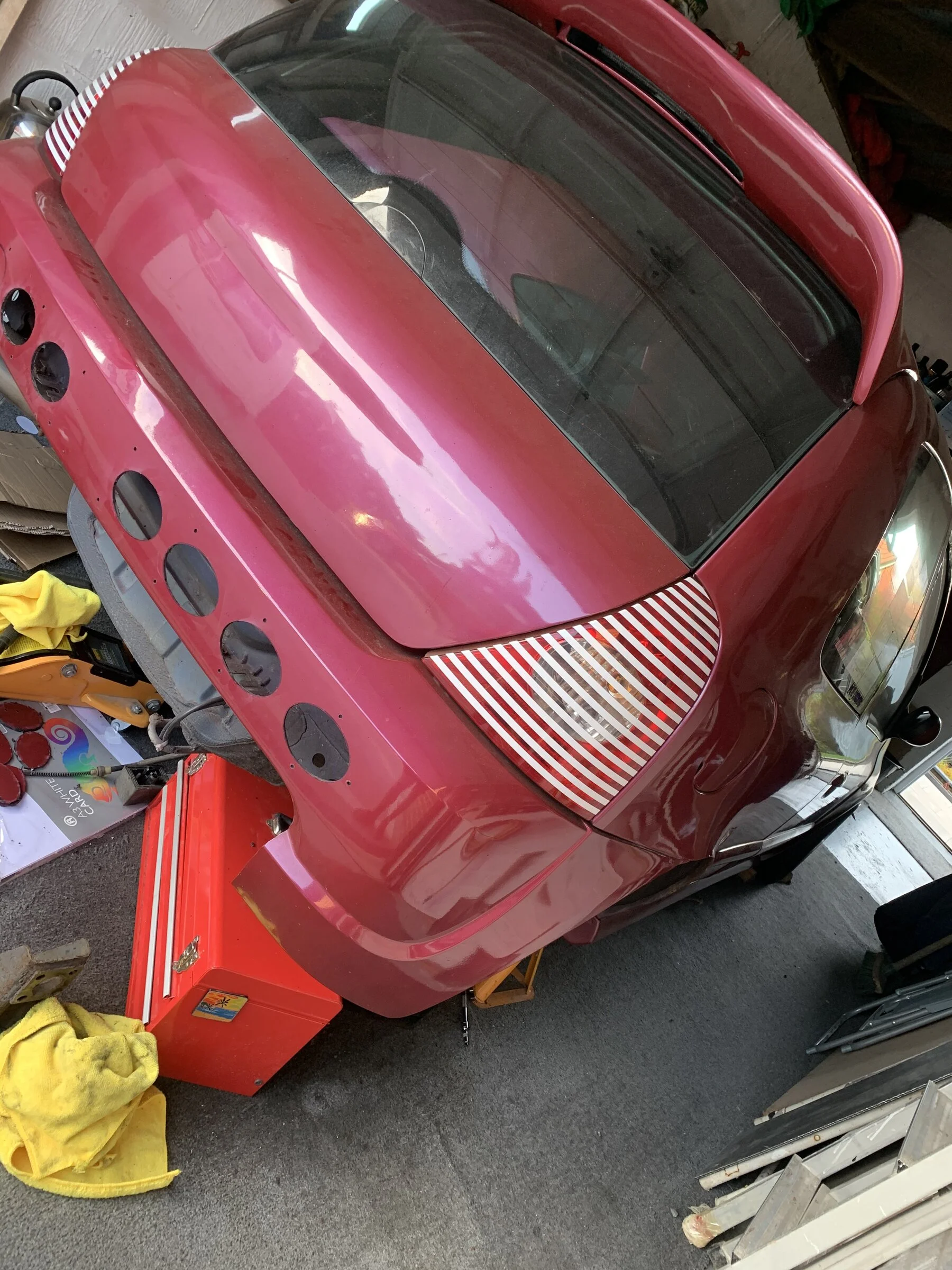

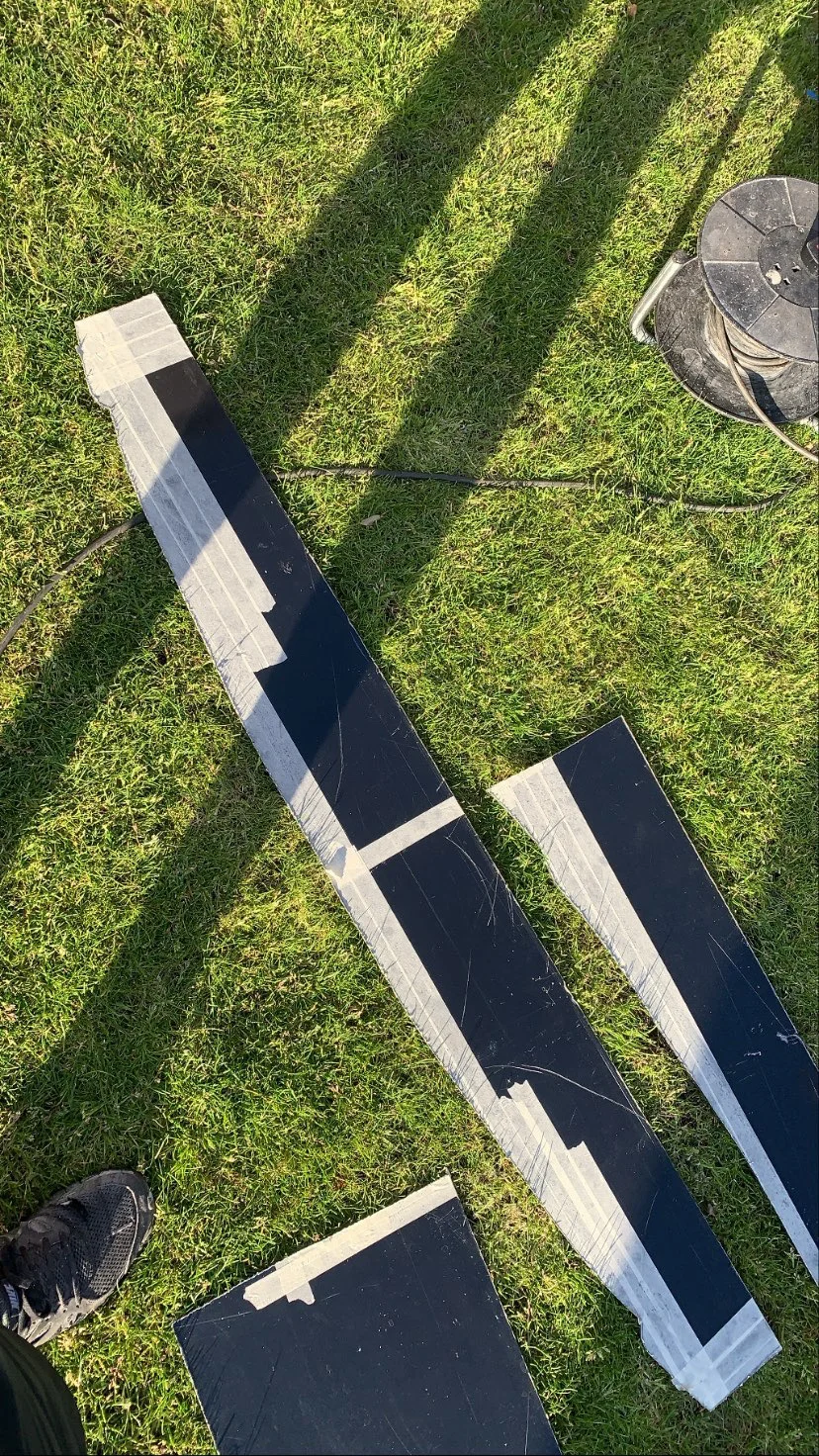

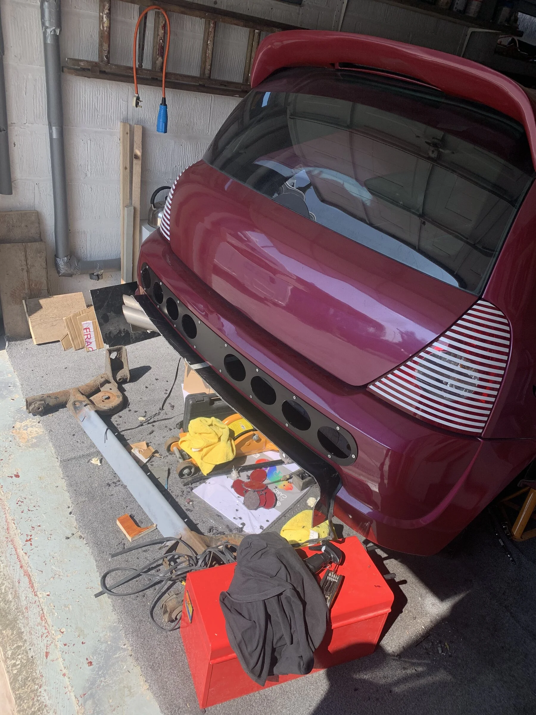

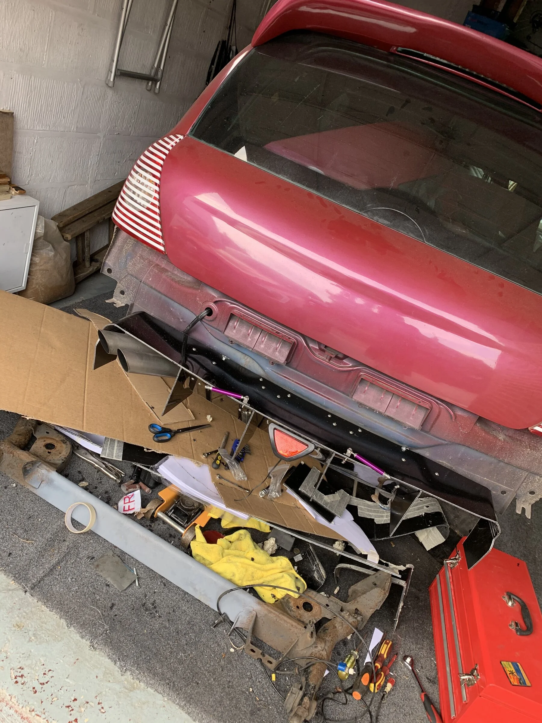

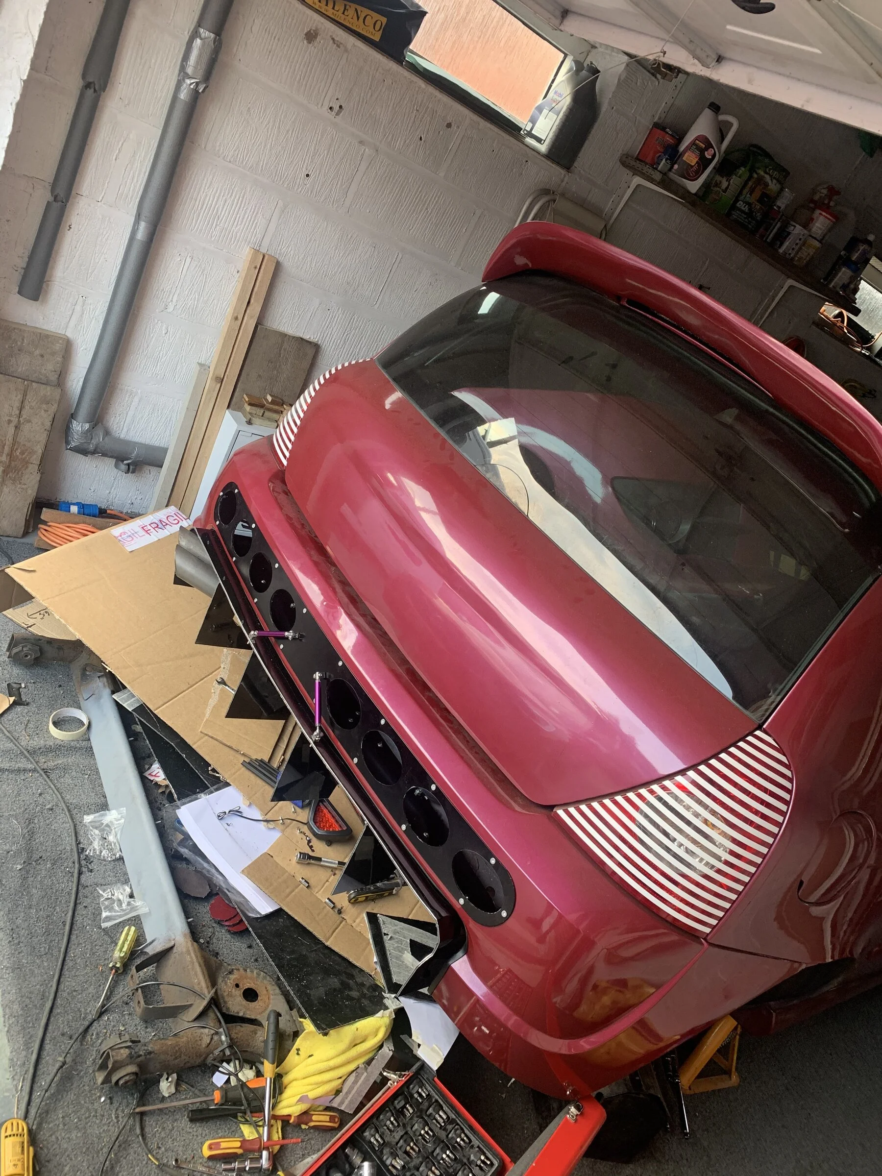

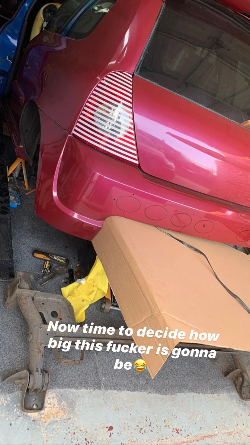

Theres a long ass list of things i have planned, so far ive made a diffuser for the back, stripped down the rear end and refurbished it. That included some custom fab work to allow the car to sit even lower than before. And ive just started to work on the front set up now.

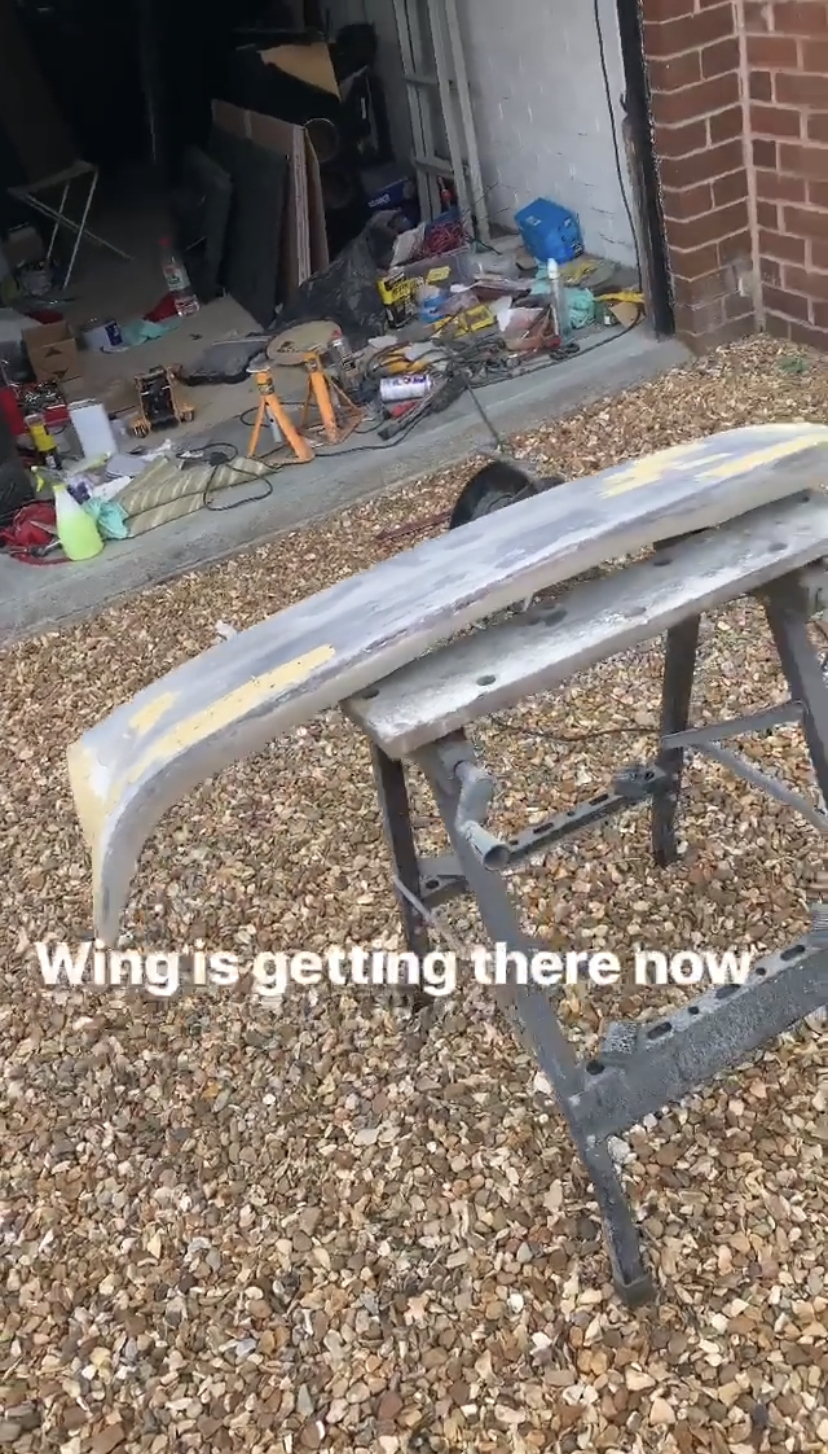

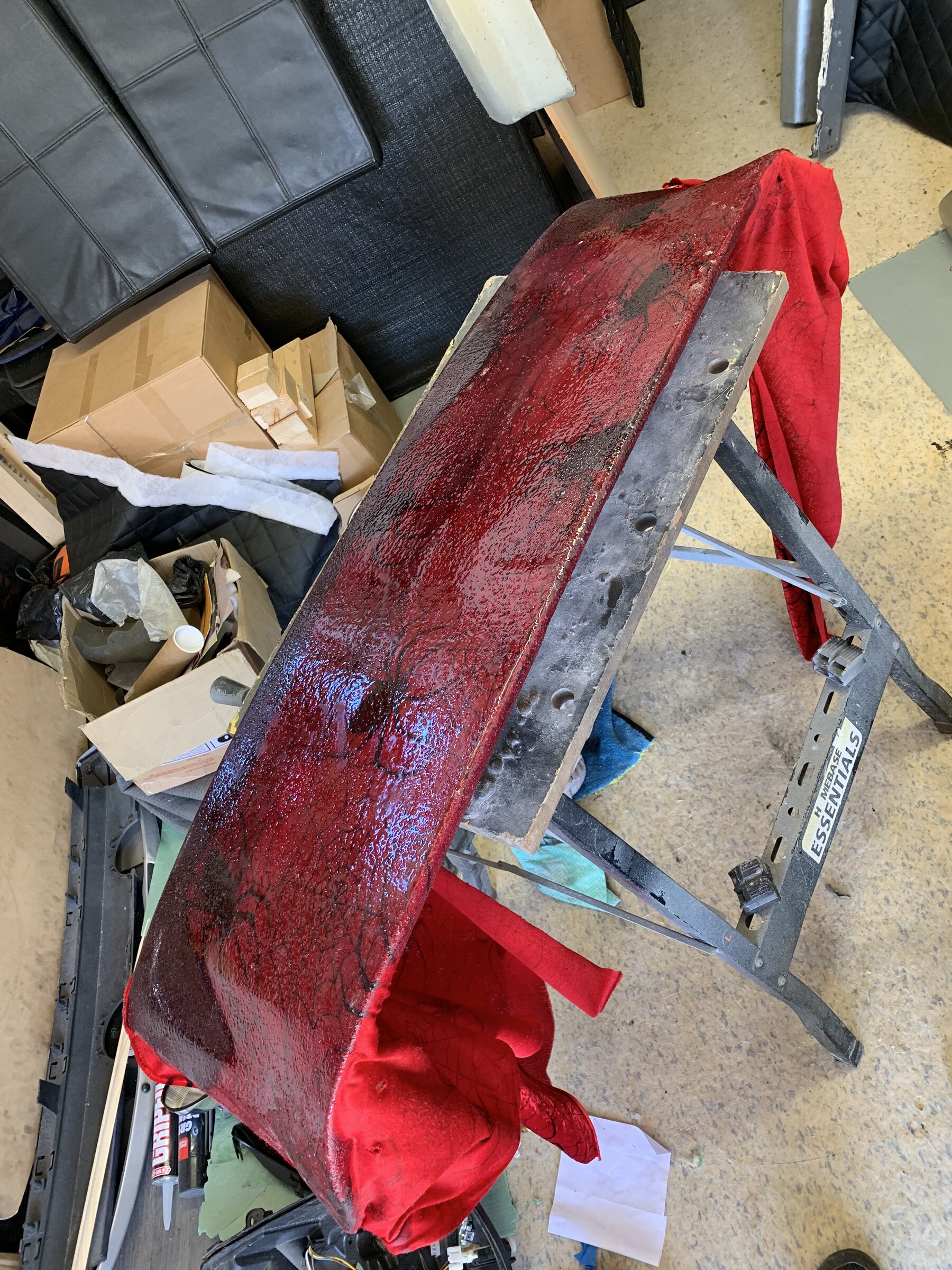

Those diffuser braces are adorable! 🤗
Good on you for doing your own thing. Look forward to seeing the progress
Haha i know, the diffuser hold well just attached to the car. I only fitted them to reduce the gap it was creating in the middle. Having it pulled up closer to the bumper made it look more flush.

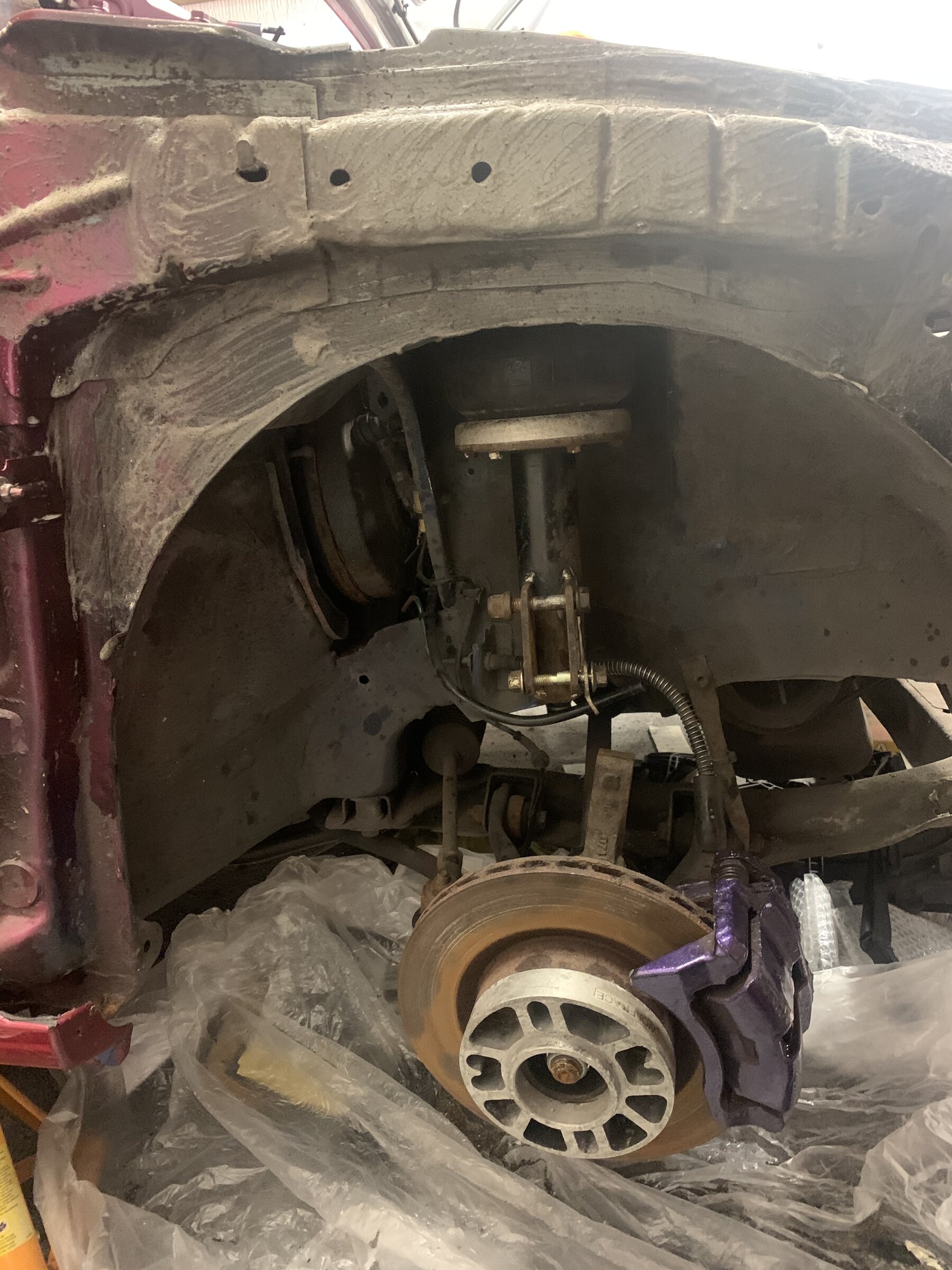

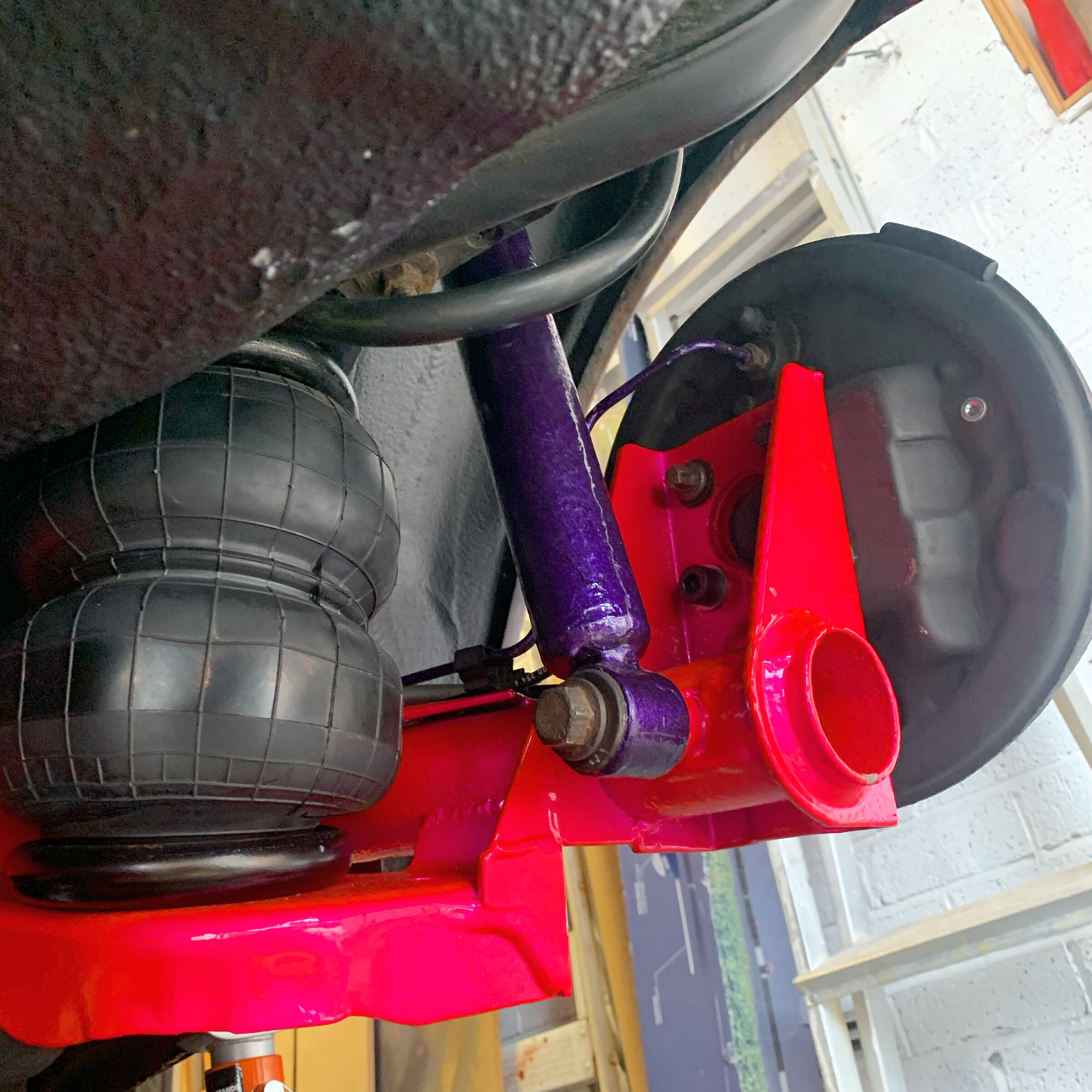

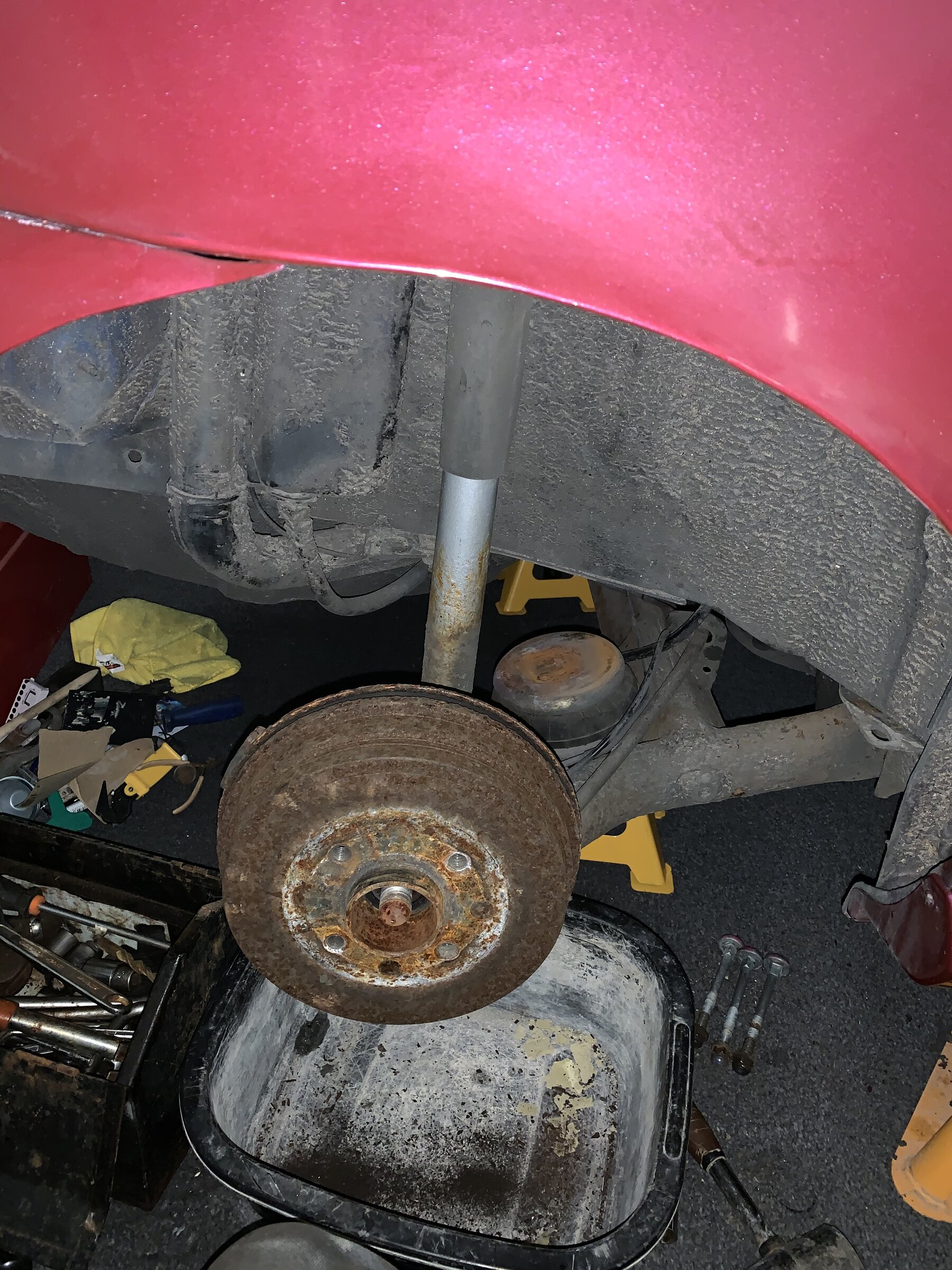

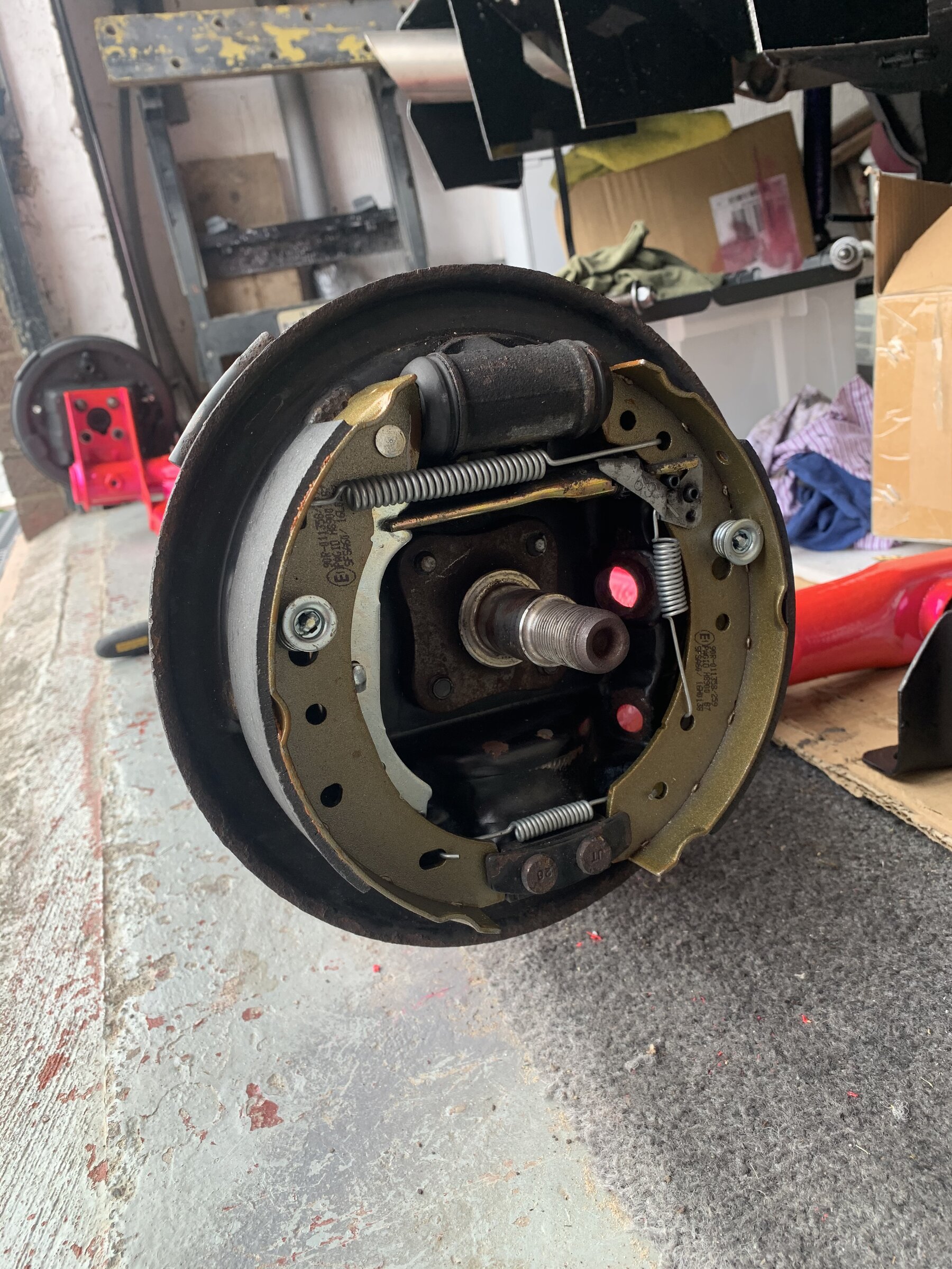

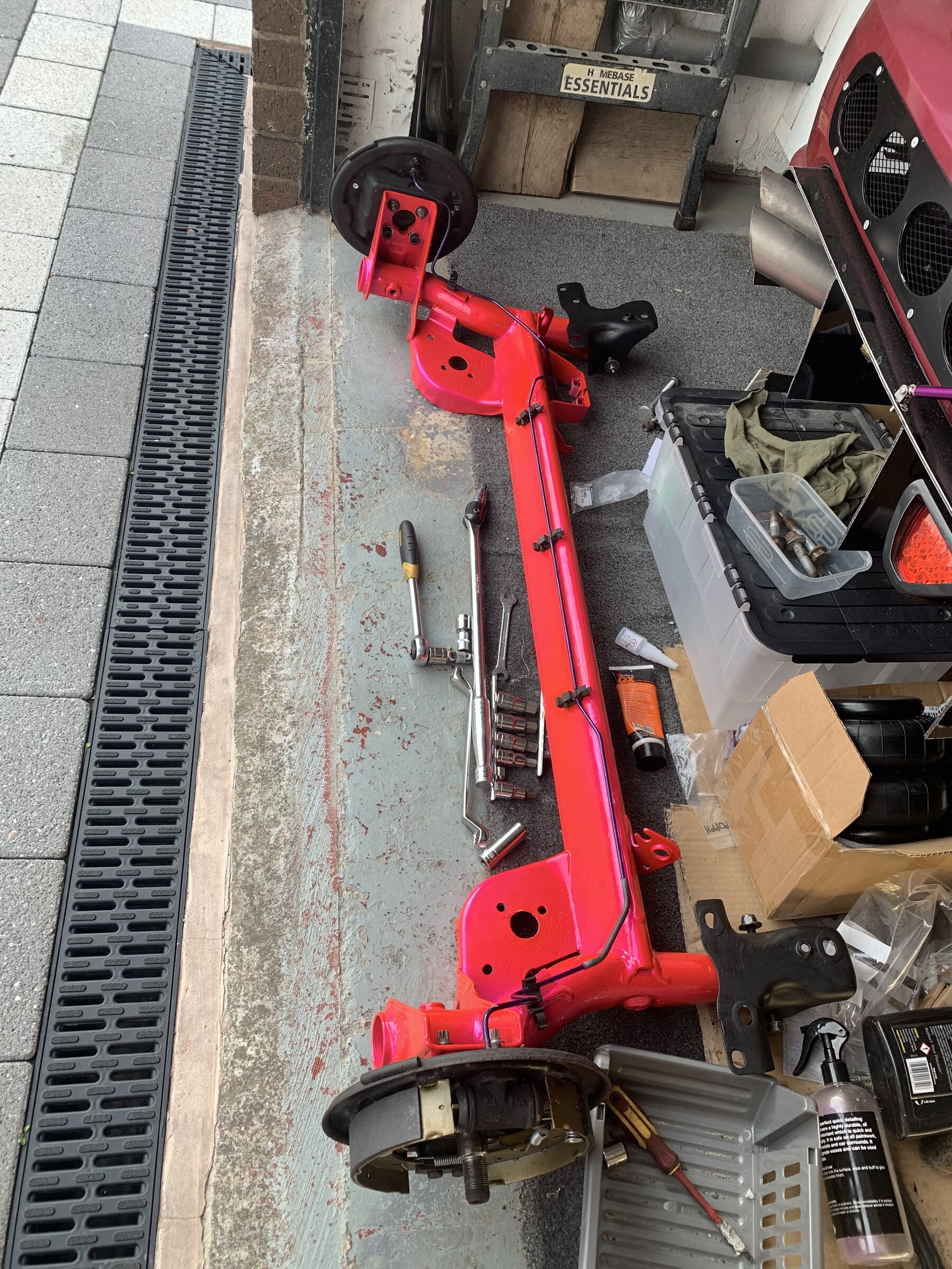

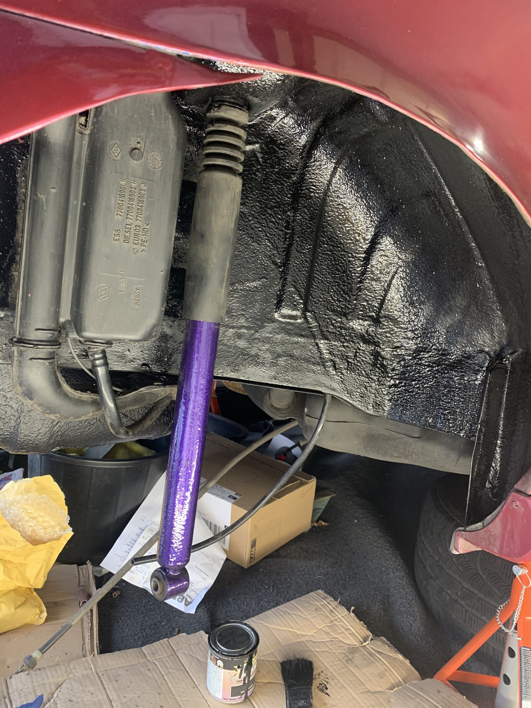

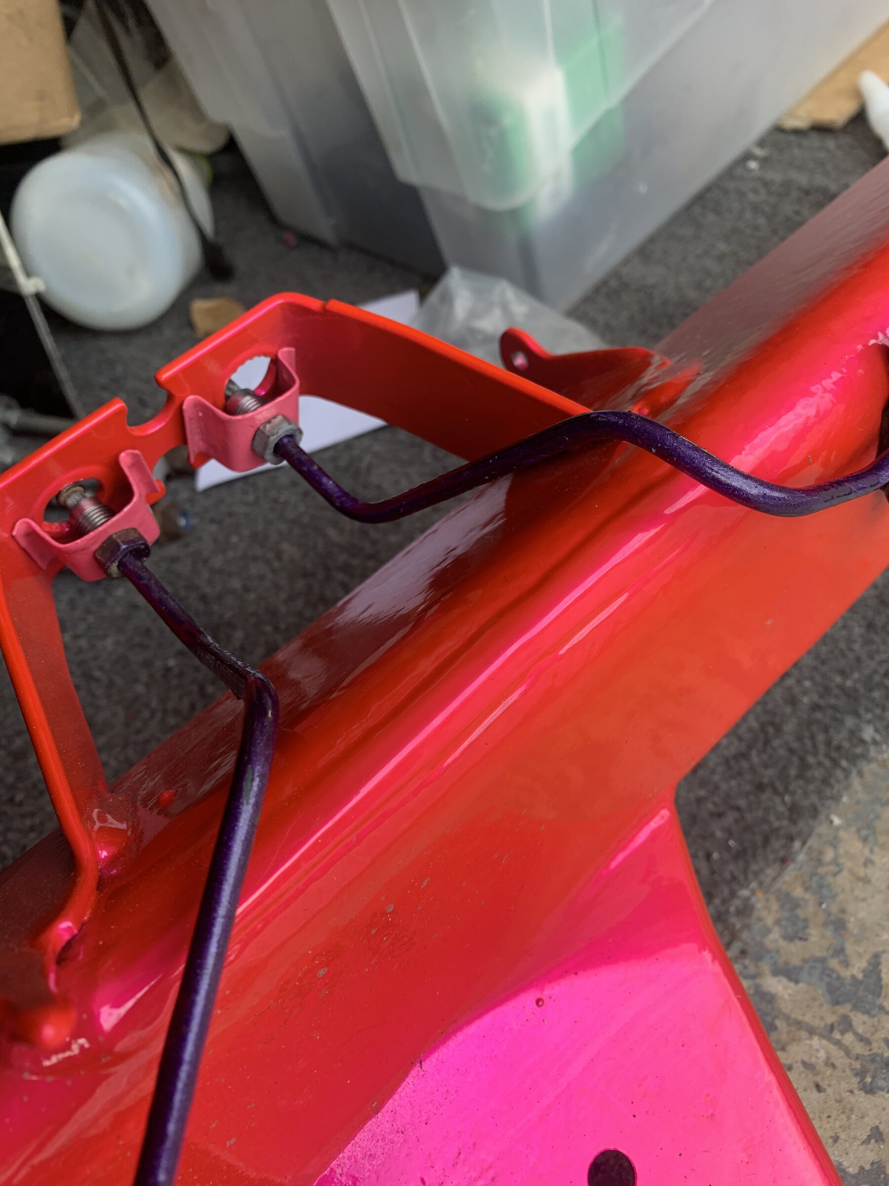

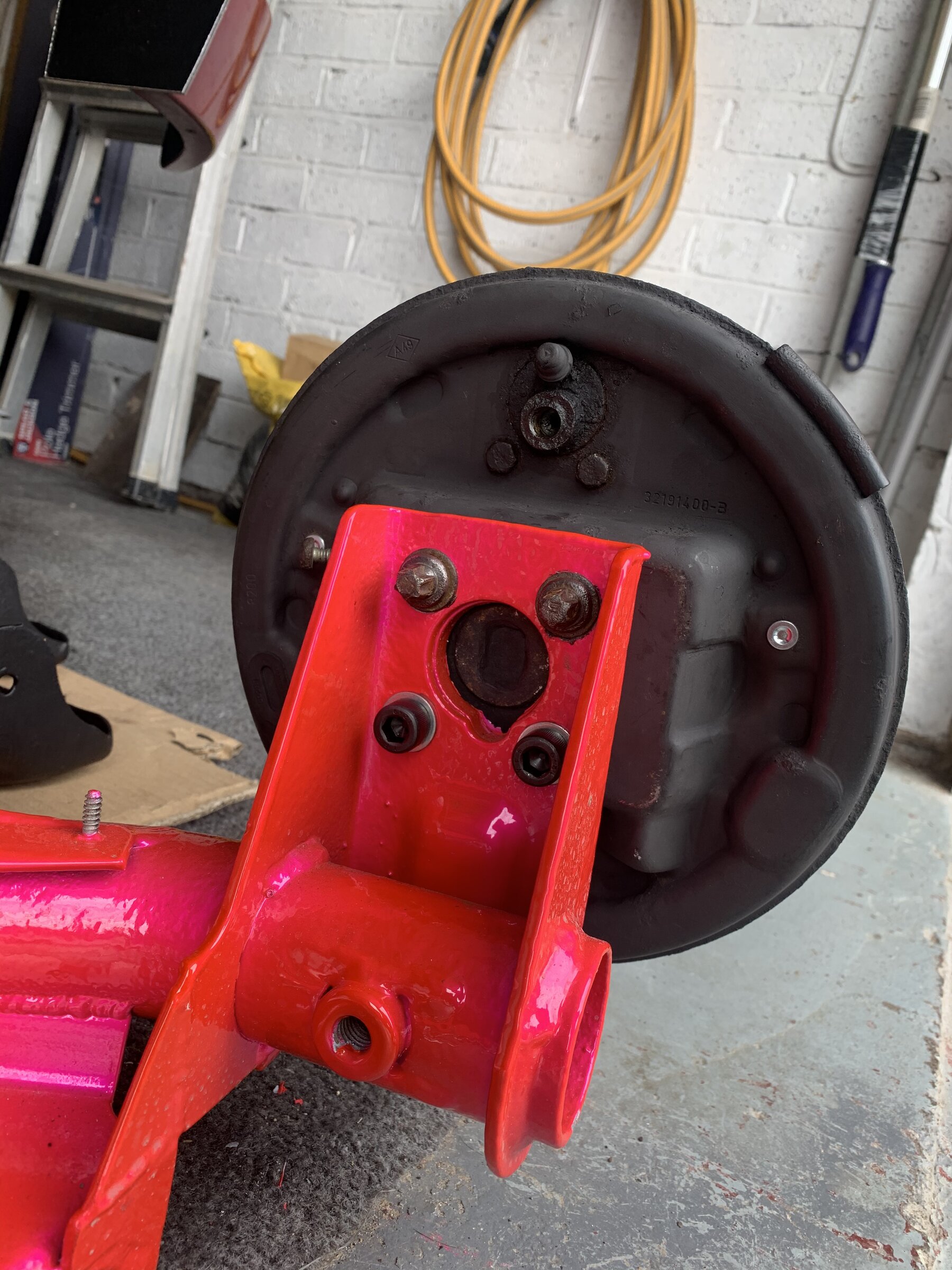

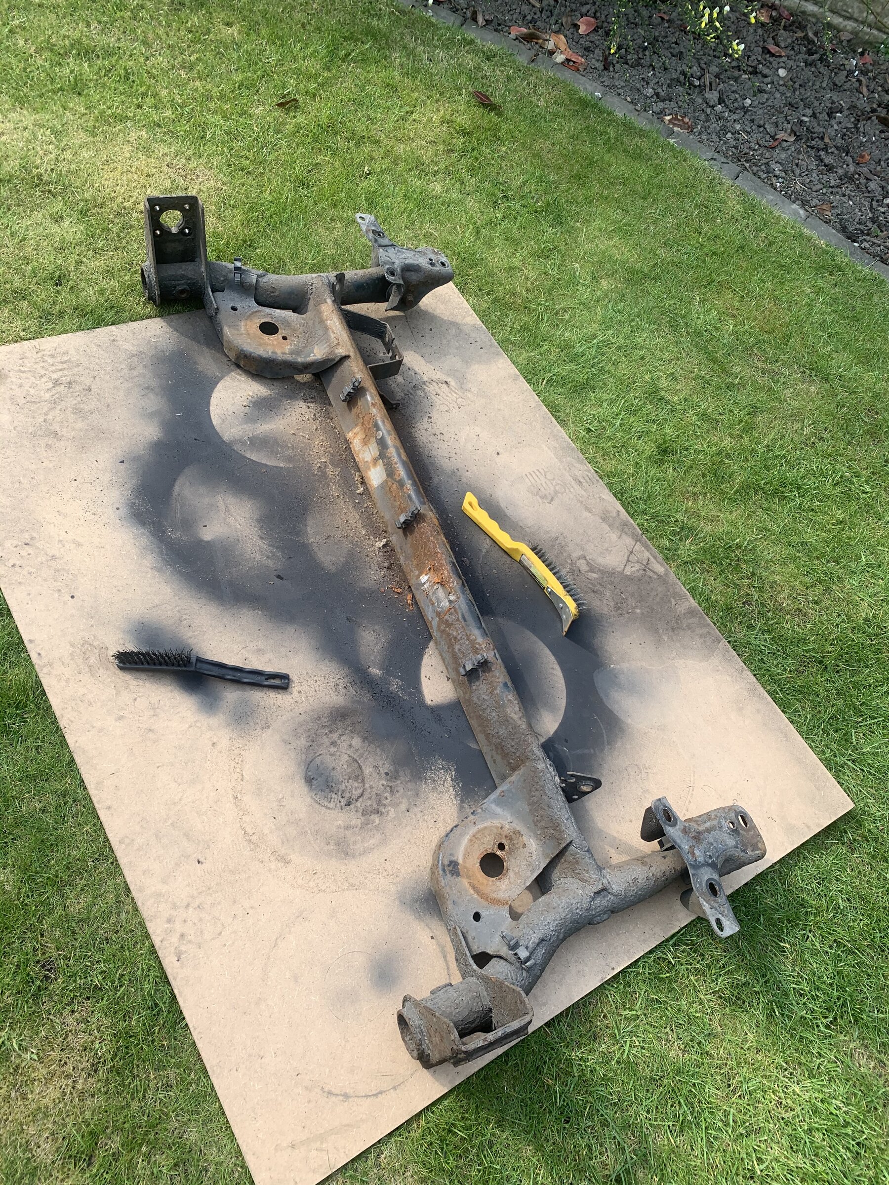

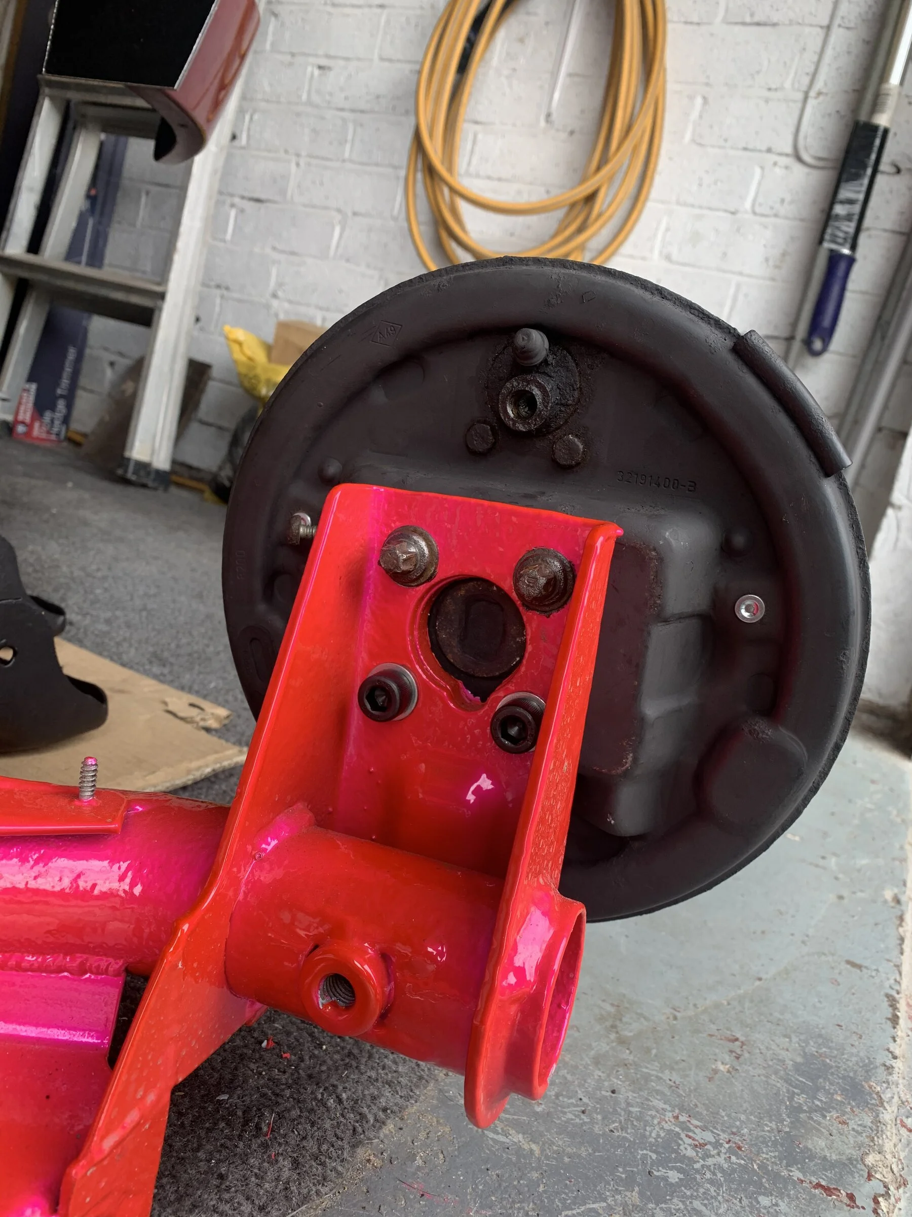

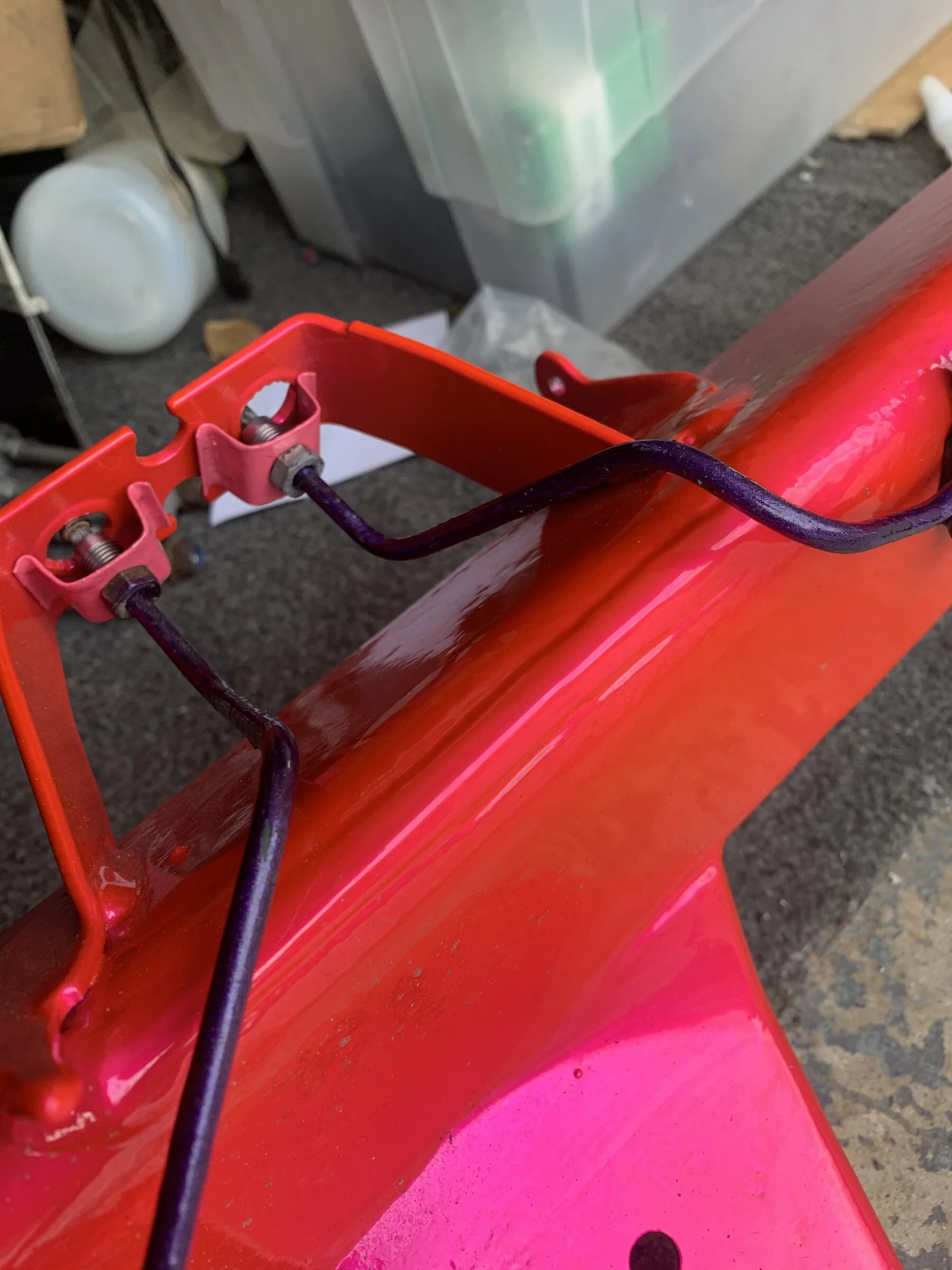

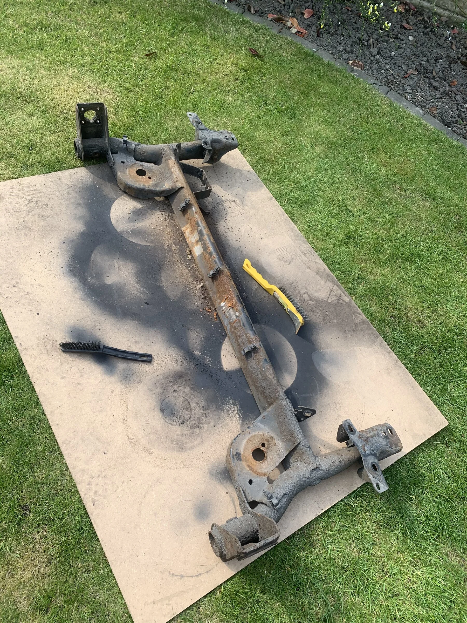

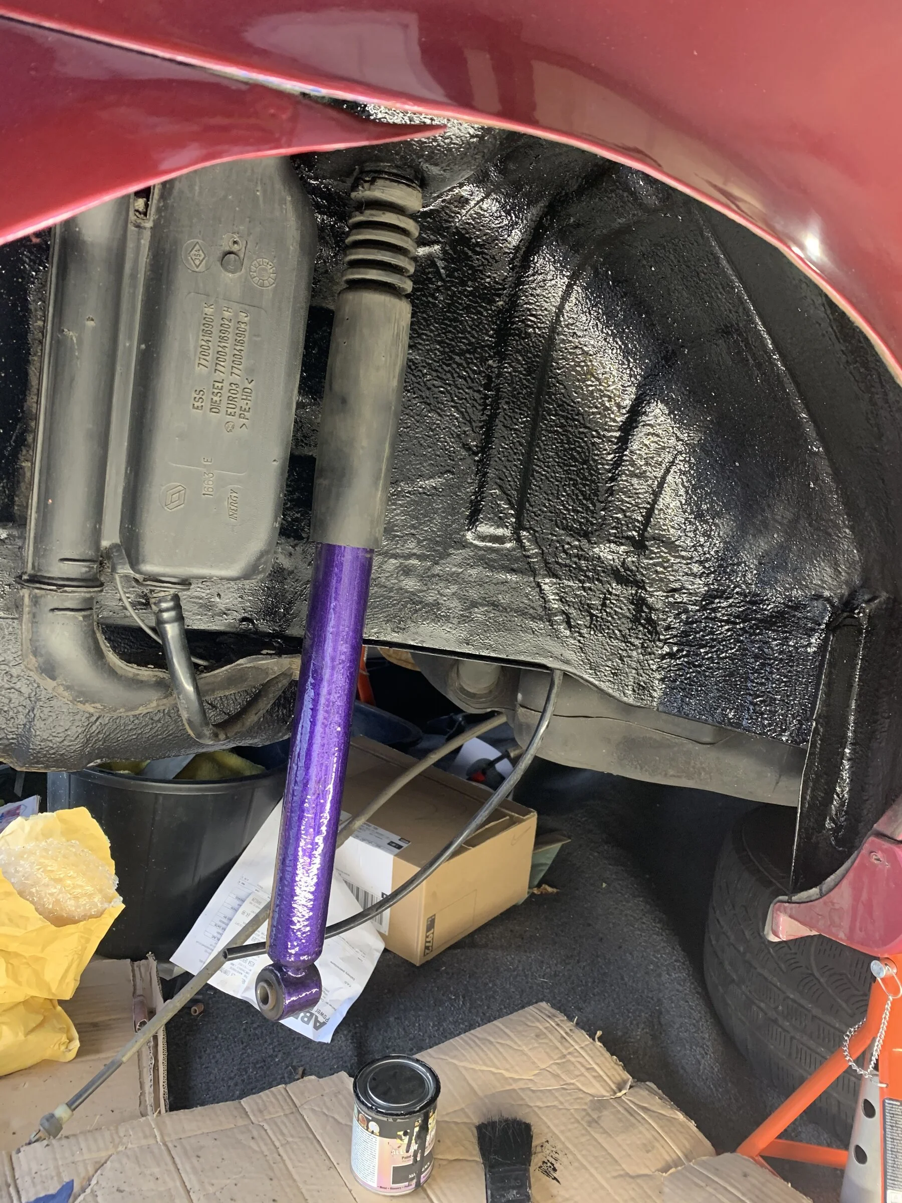

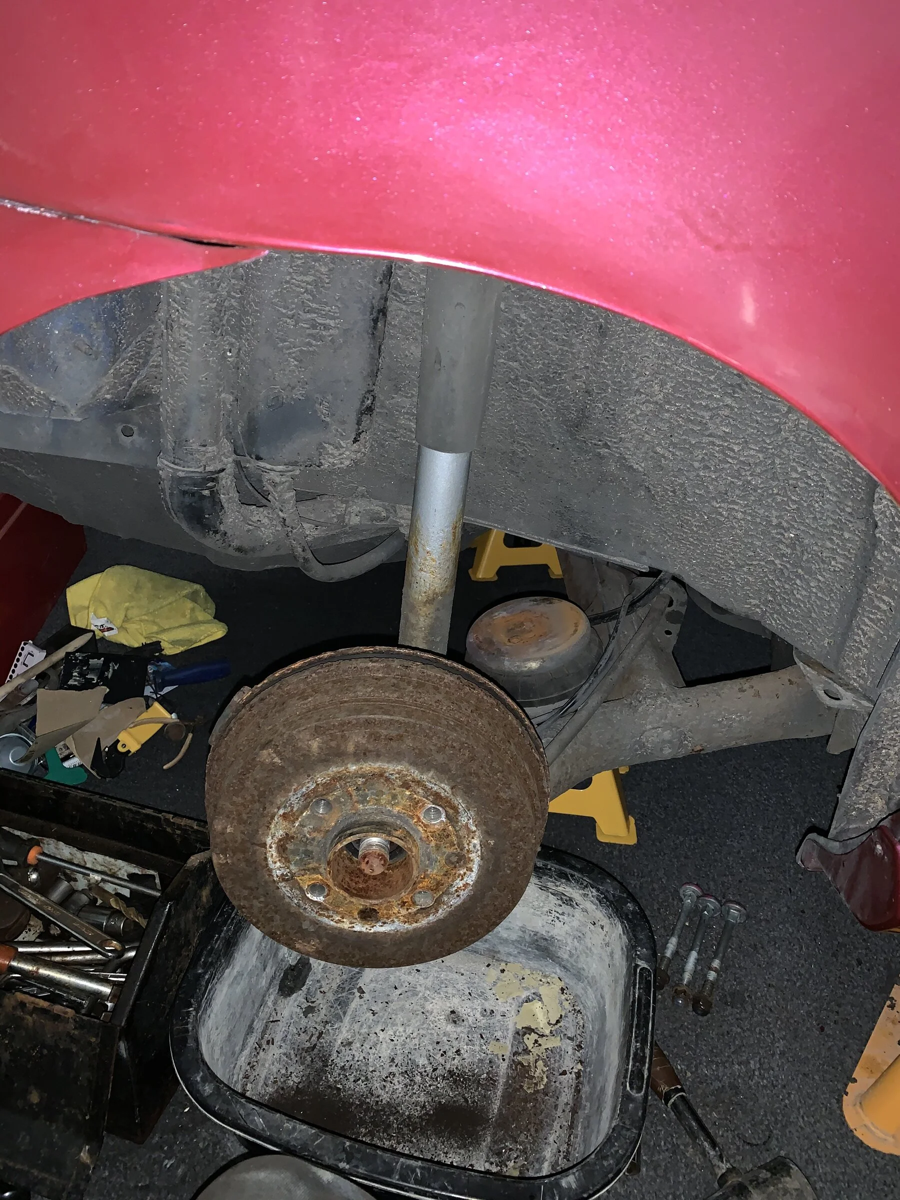

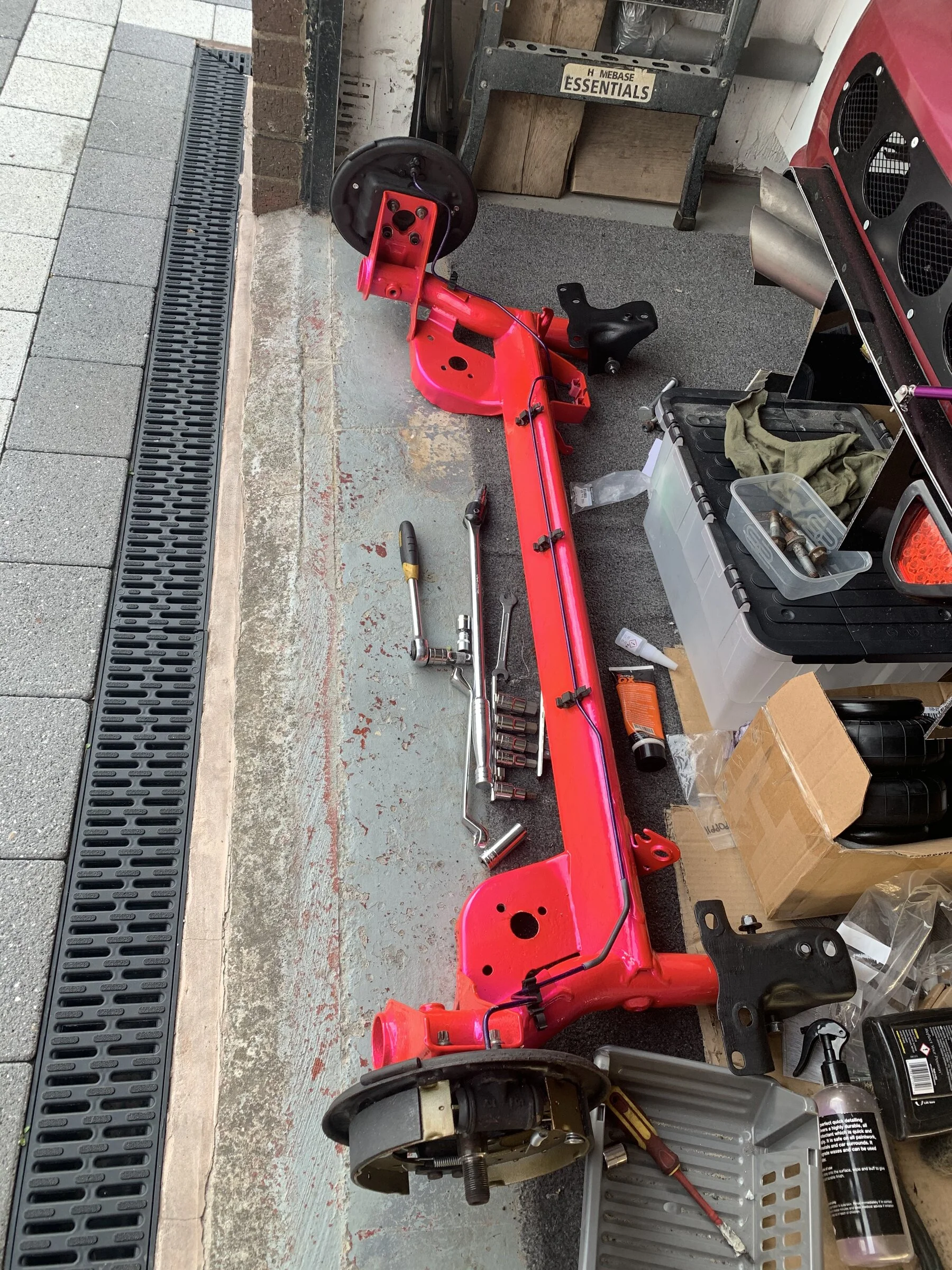

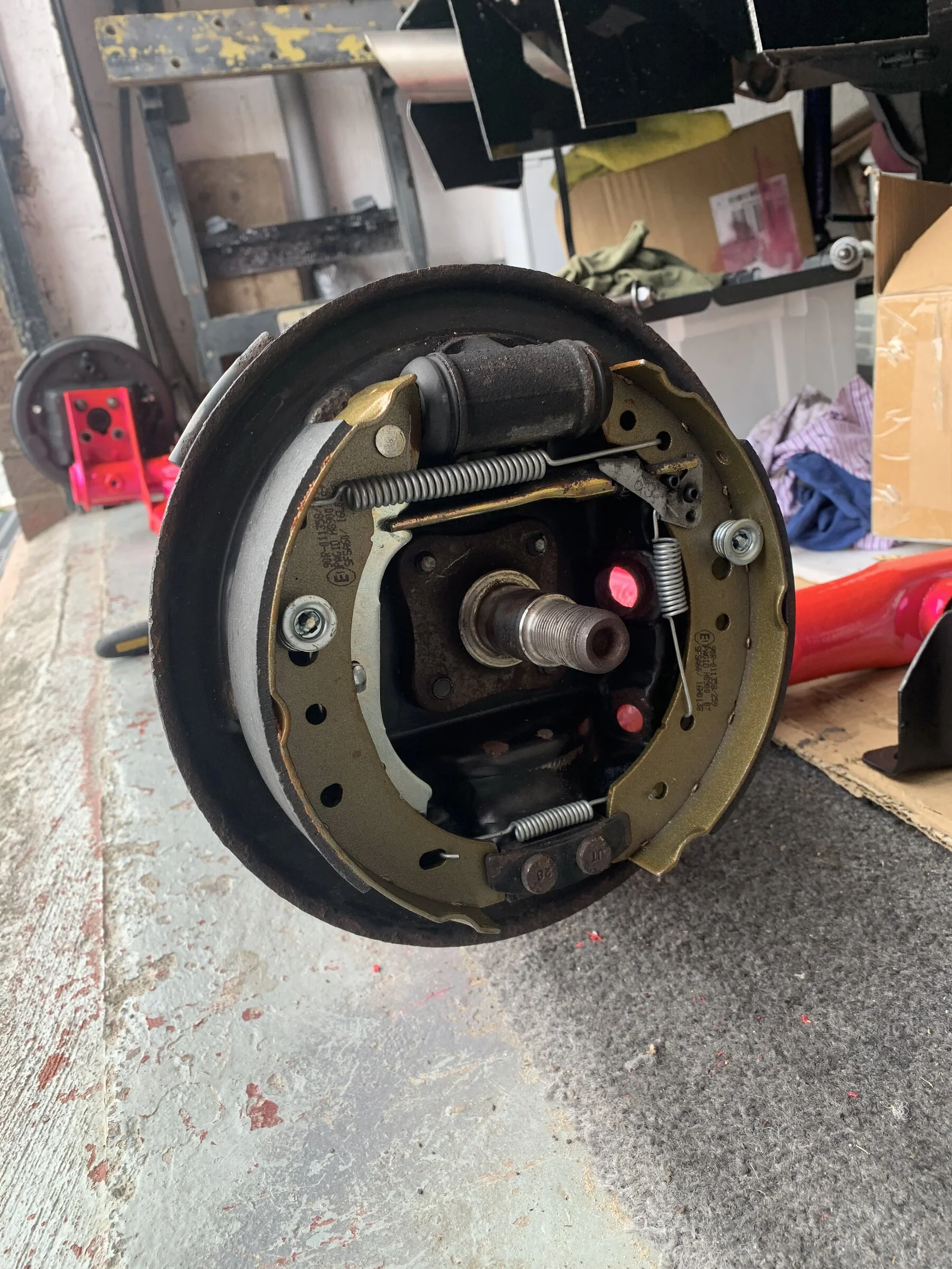

This was where im at now with the rear end. I was running single bellow bags before.
Swapped them out for double bellows. Mounting plates have been dropped 3inch.
New shoes and refurbished drums( was going to covert to calipers but i cba).
Painted brake lines, and polished up the original bolts.
Painted struts.
Undersealed the rear and the arches.
Powdercoated beam by retro coatings.
And changed the bottom hub bolts to 12.9 gauge ones as im running more camber now.

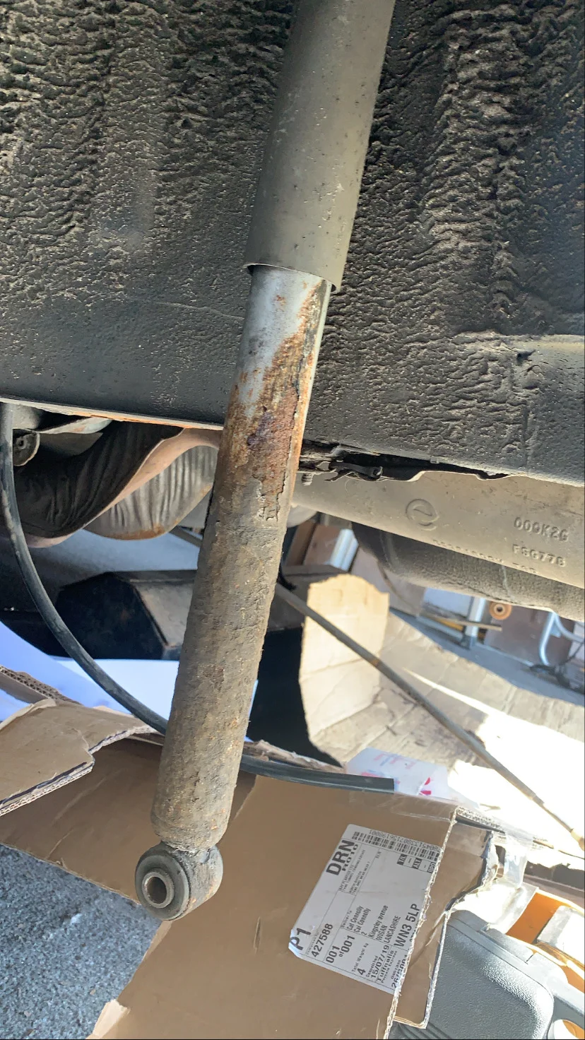

Bit of a update, rear end us finally all mounted up. Just had to make some custom brackets for the top of the bags to mount to, i would of shown pics but i never got round to taking any. (The rusty bolt for the shock and since been replaced)
time to get cracking on the new front set up.
solid top mounts have been purchased from mike arter, and ive had the plates re welded higher up on the shock by luke from outcast customs for a little bit more lows.
