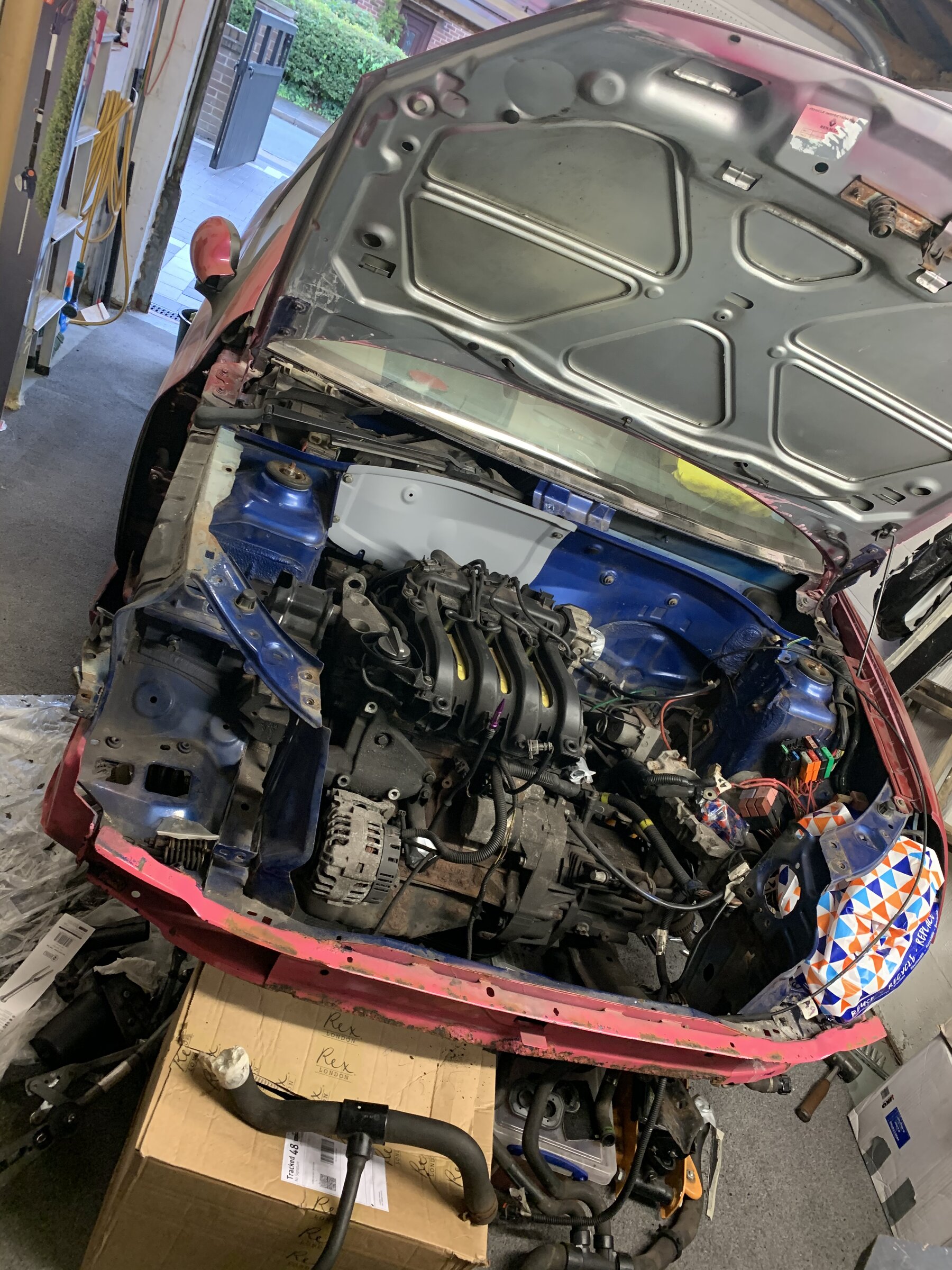

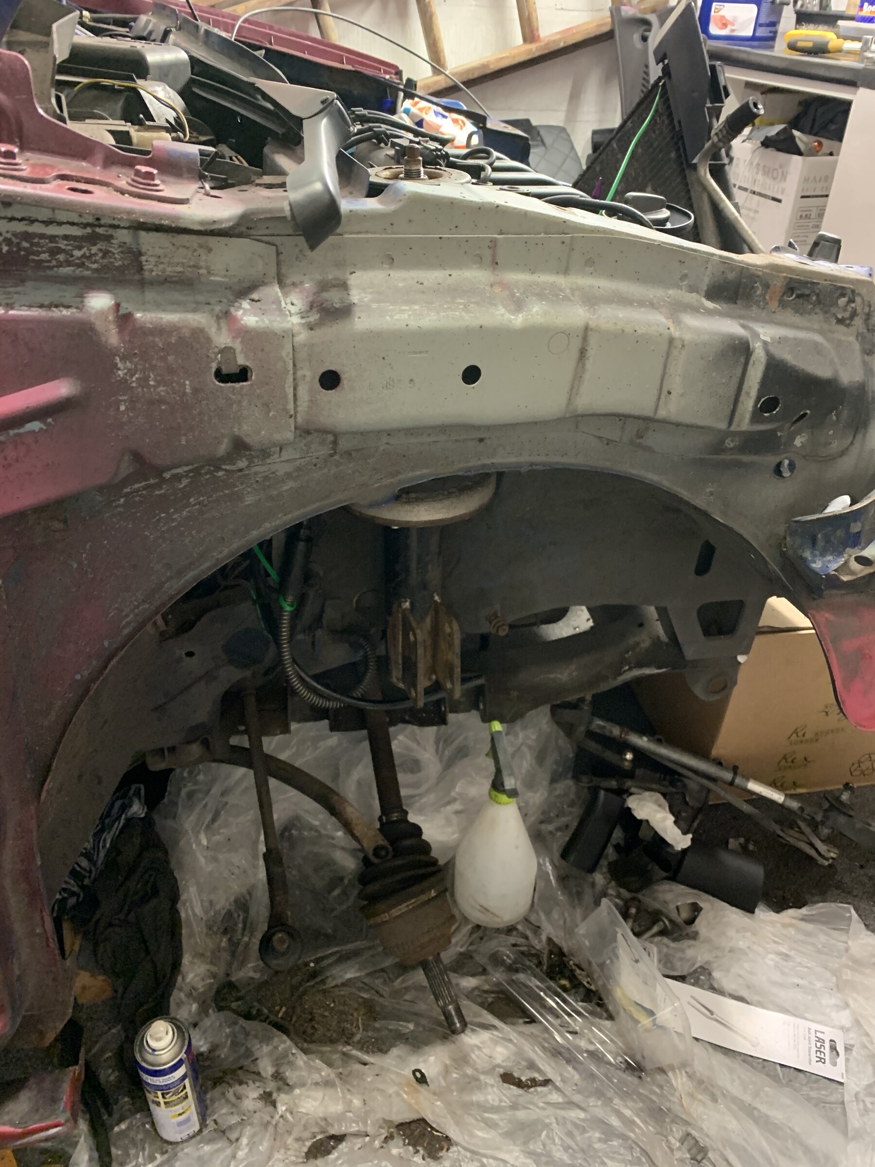

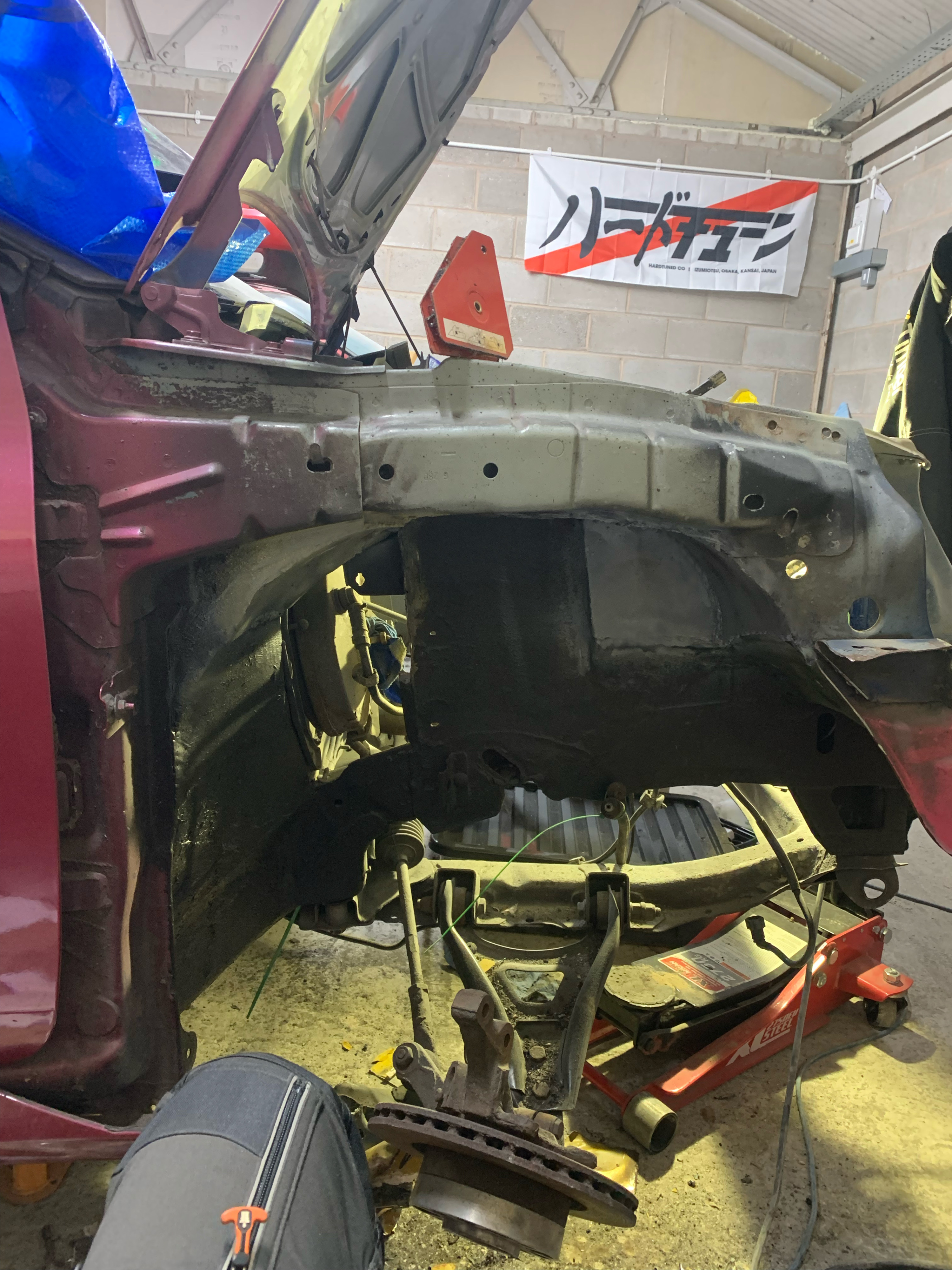

Got around to getting it all ready for the engine to come out today. Just the shafts to come off and crack off the engine mounts.
i had someone work on the car before it got put away in the garage, new clutch and all new bushes on the front, and i can happily say i wont let them work on it again. One of the threads for the Driveshaft had been stripped in the gearbox so I've had to drill it, and replace it with a helicoil. And the bolts for one of the anti roll bar bushes had been put on that tight it had ripped the rubber in half and completely stripped the threads.
but all the damaged bushes will get replaced. Along with new disks and pads for the front set up.

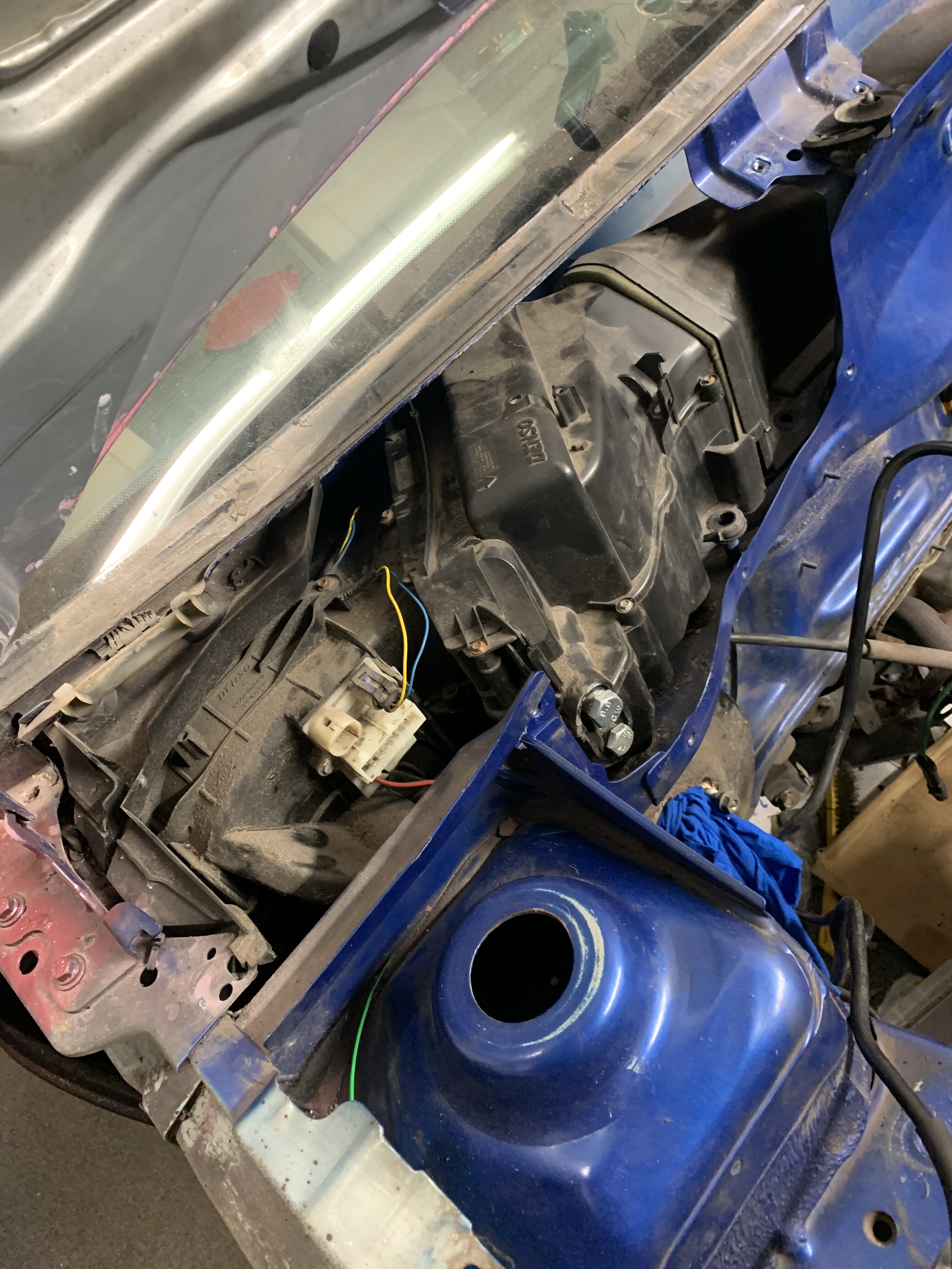

as im no longer running a form of a/c or oem heater unit. Im stuck on how to remove this. Im guessing the rest of the removal involves taking the dash out. Could anyone possibly help before i begin to remove the dash.

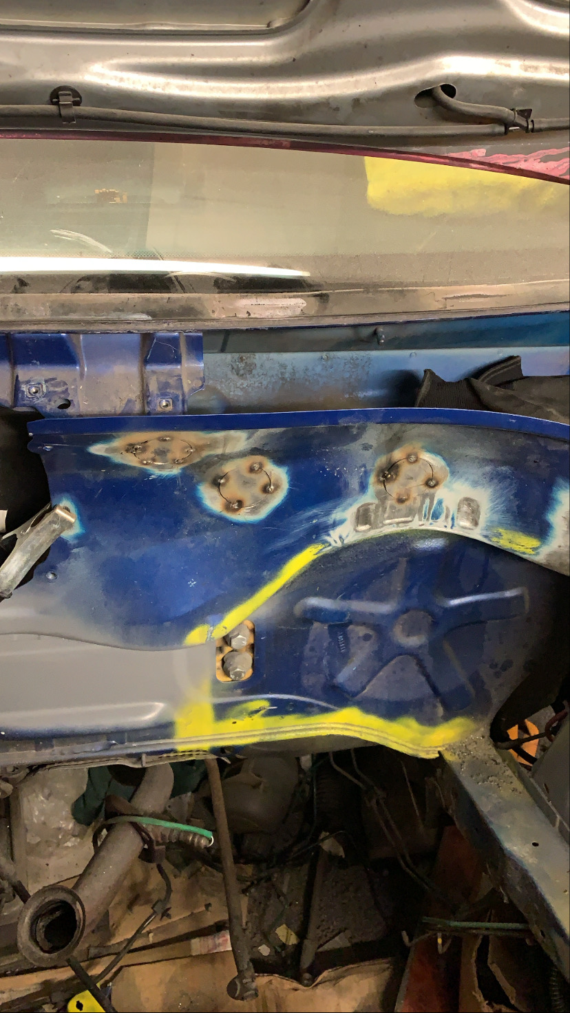

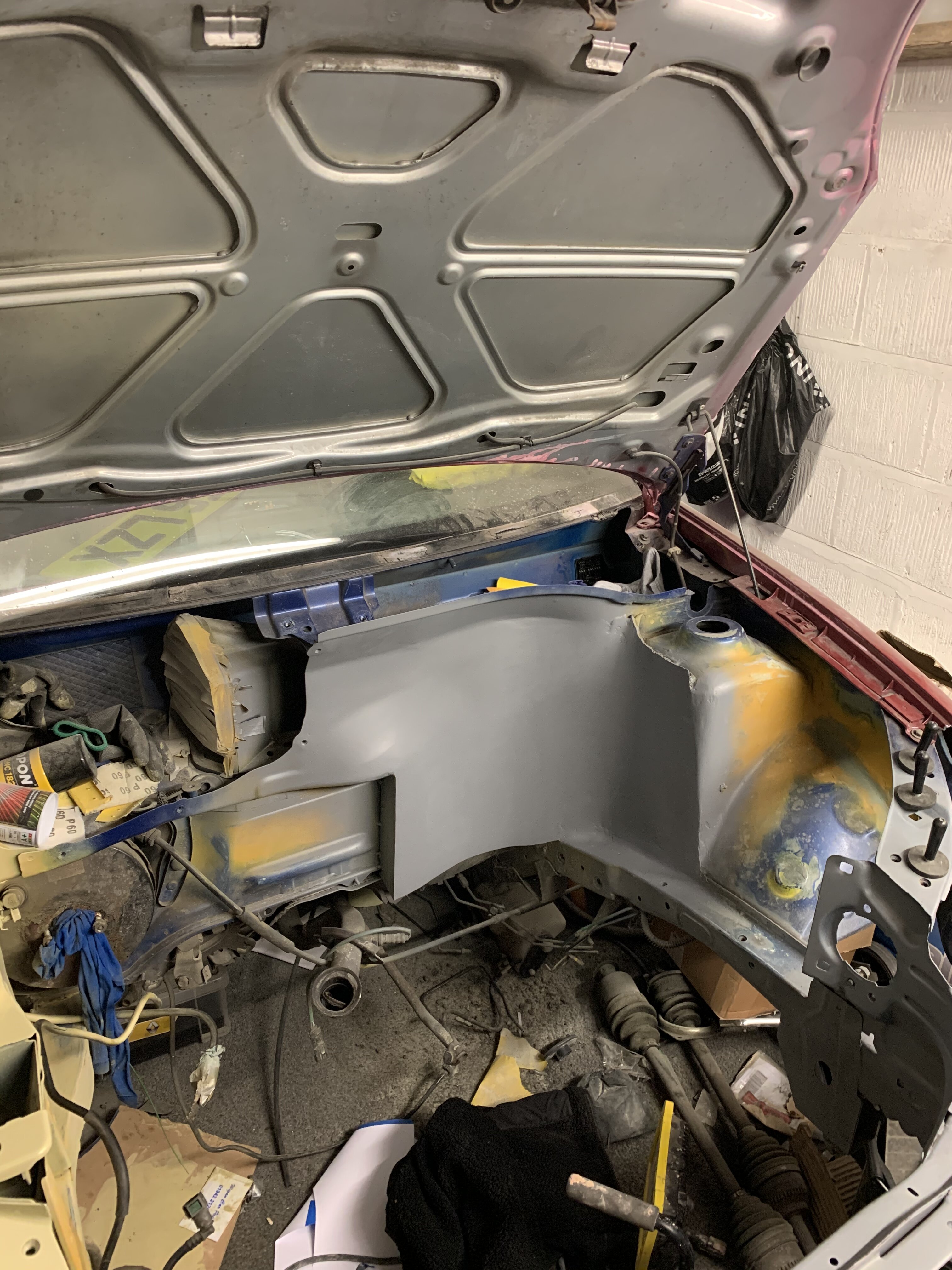

Again, been prioritising other things so work has been slow. Started the pain of a job which was removing the seam sealer and getting the bay prepped for fab work.
Also roughly marked out areas that need cutting out for more custom fab work to be done in the arches, to allow for a bigger wheel to fit and for the wheels to sit lower.

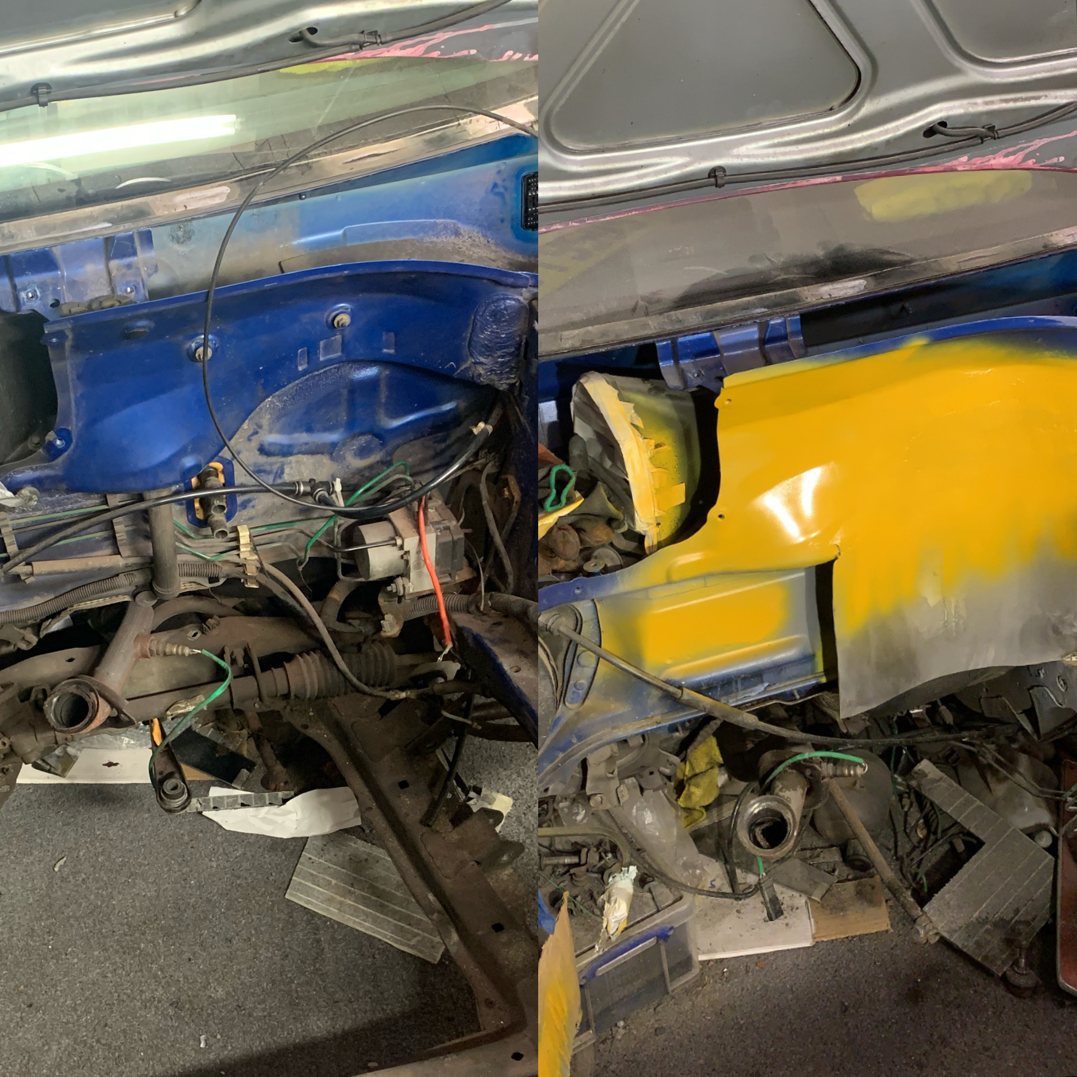

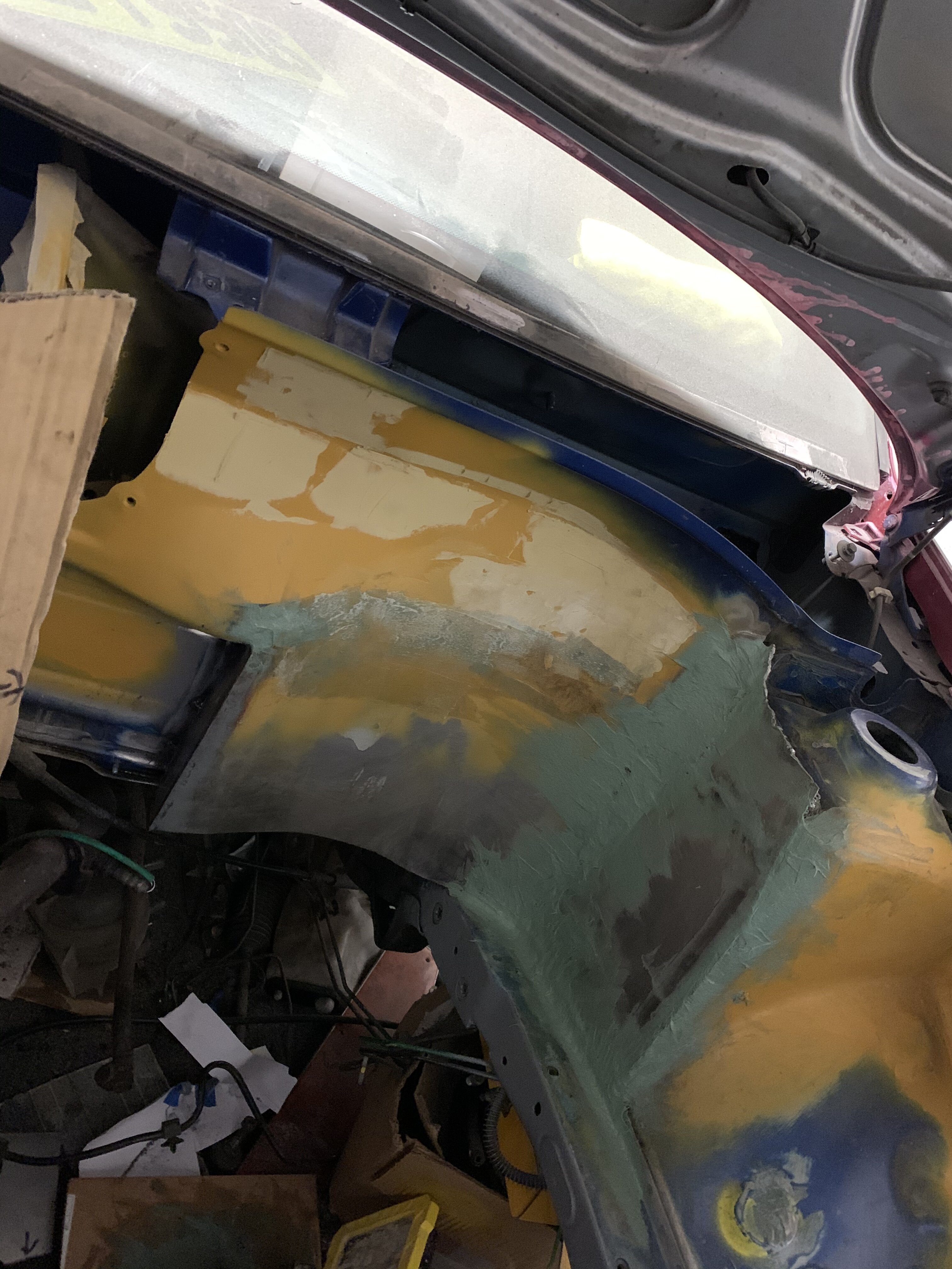

Bit more work done recently. Started removing rusted areas, applied some rust prevention over and then some primer.
Also started to apply fibreglass filler into the areas that are going to be smoothed.

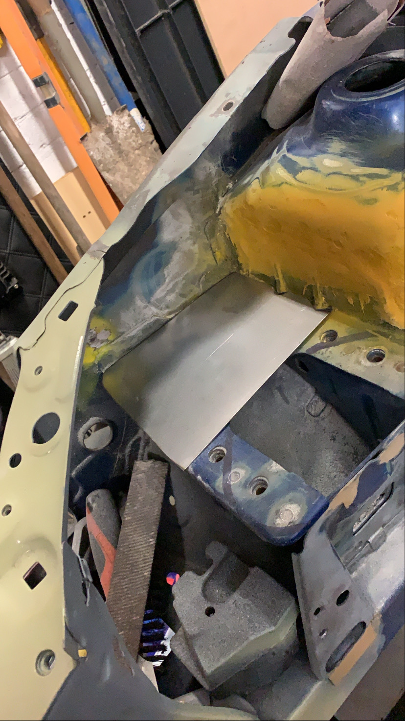

Templates made up using card and then cut out and bent into shape ready to be welded into place. Was my first time fabricating with metal, so it was all a learning experience to me.

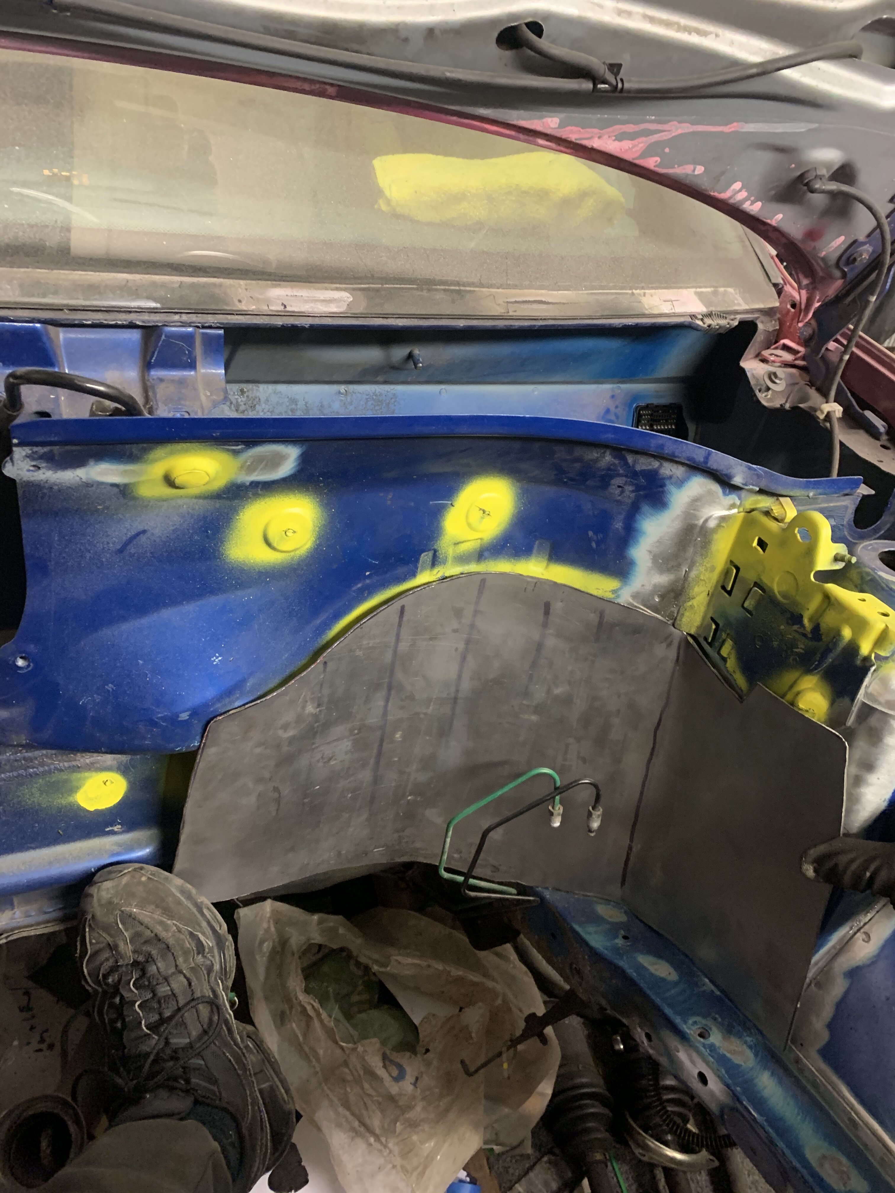

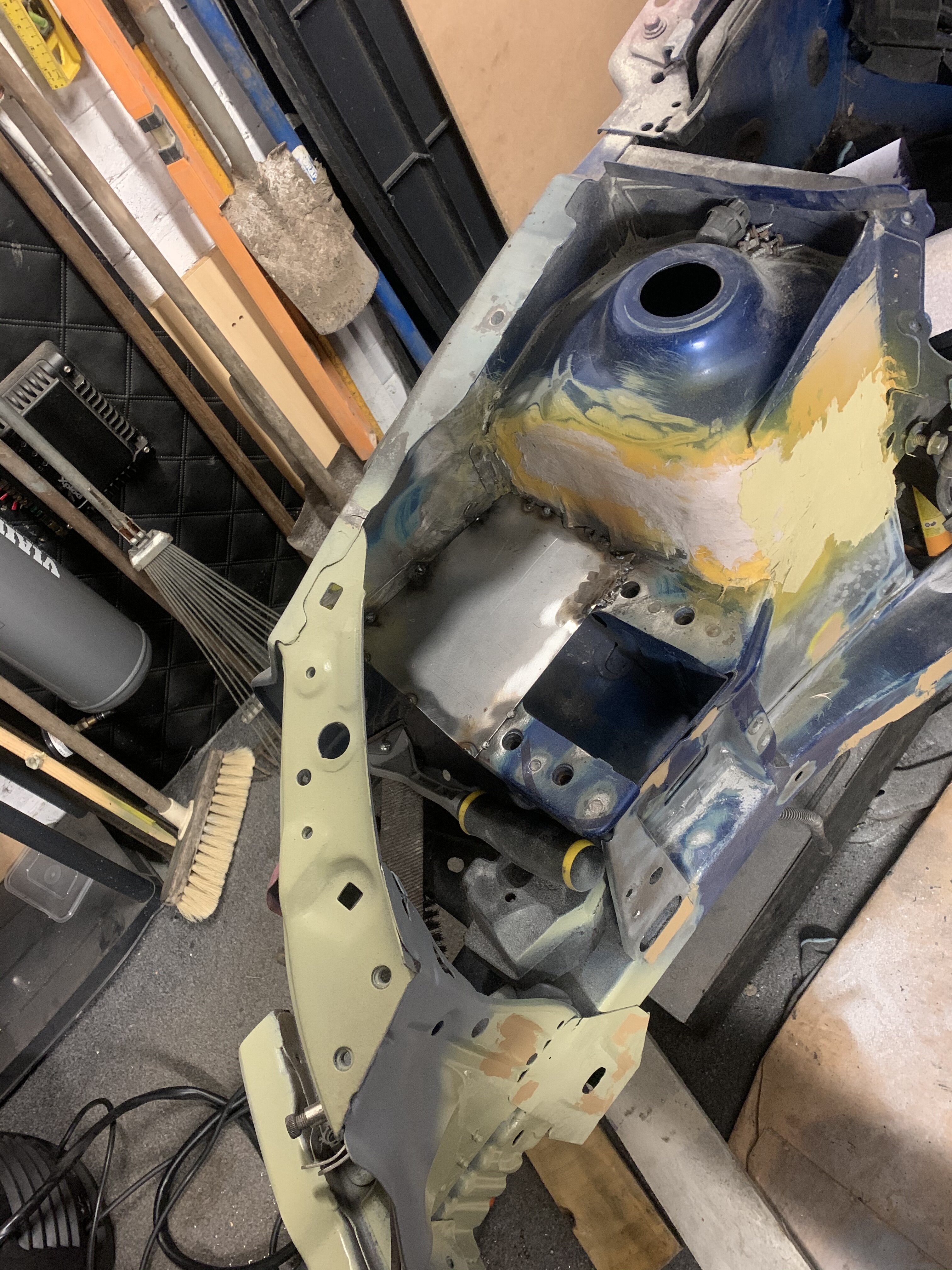

Bit more work done today, another blanking plate made. And a bit more progress done smoothing out the strut tower.
first time welding so still got a lot to learn.
trying to get as much practice in as i can along the way.
plates on strut tower cut down on both sides as im wanting them to be symmetrical on both sides when finished. Still needs a clean up and smooth down so its a even shape and no sharp edges.

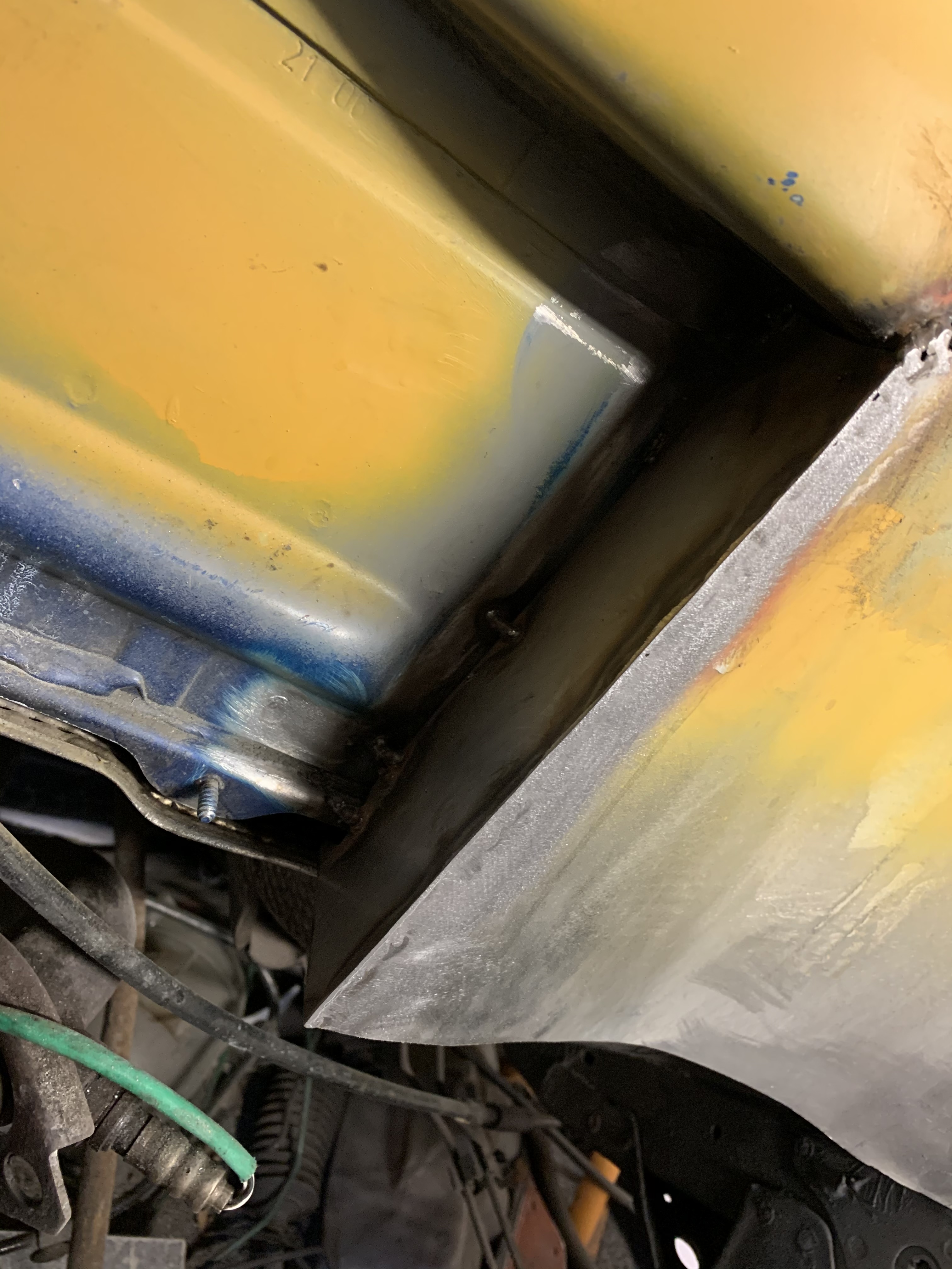

Cut out the raised areas on the scuttle ready for blanks to be welded in so its a neat finish. (The a/c pipes have a temporary blank, its just to stop any s**t going through them before i get round to fully removing and blanking it off)

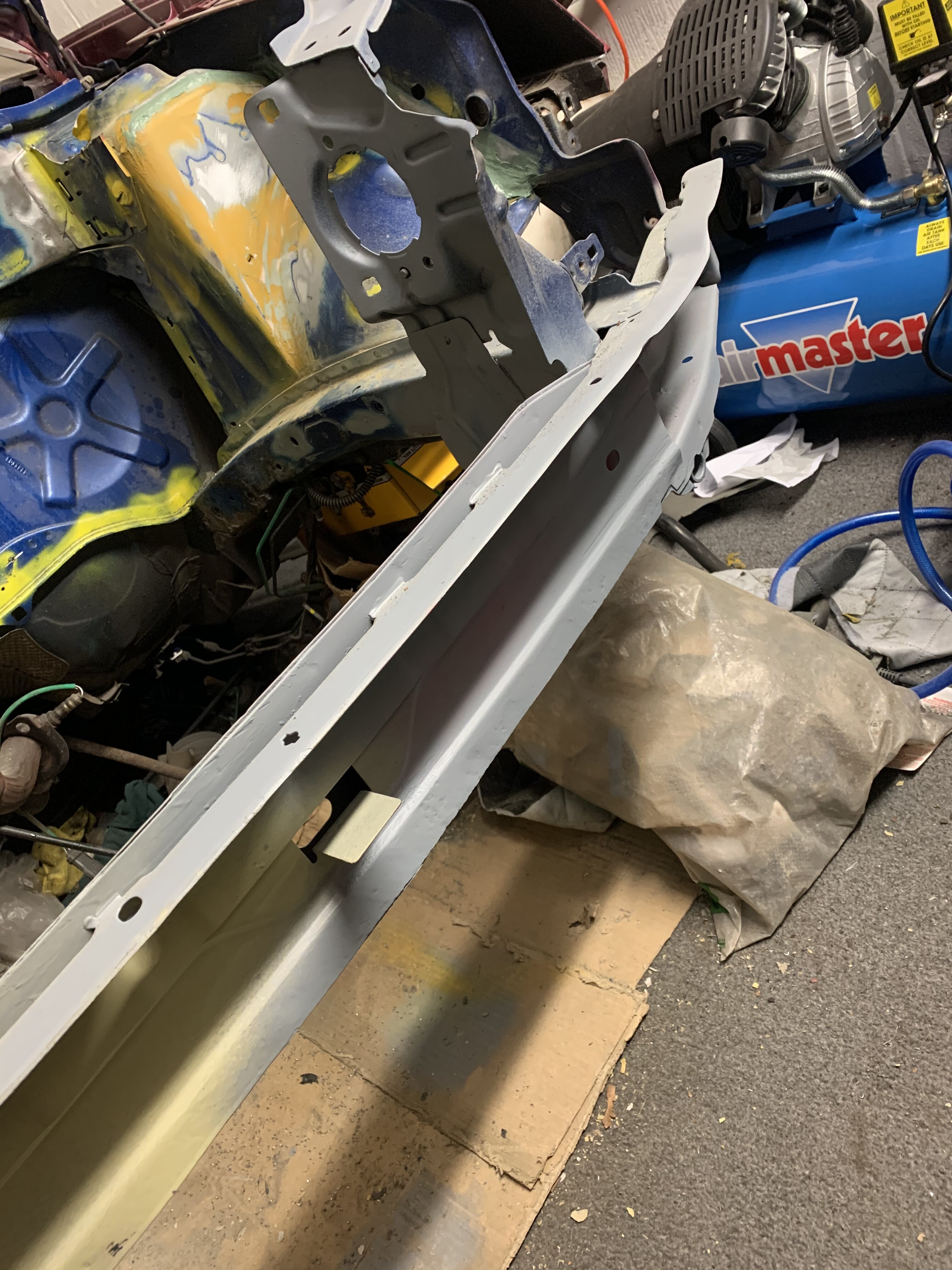

And finally got rid off all the rust that was present in the bay. Mainly on the crash bar.

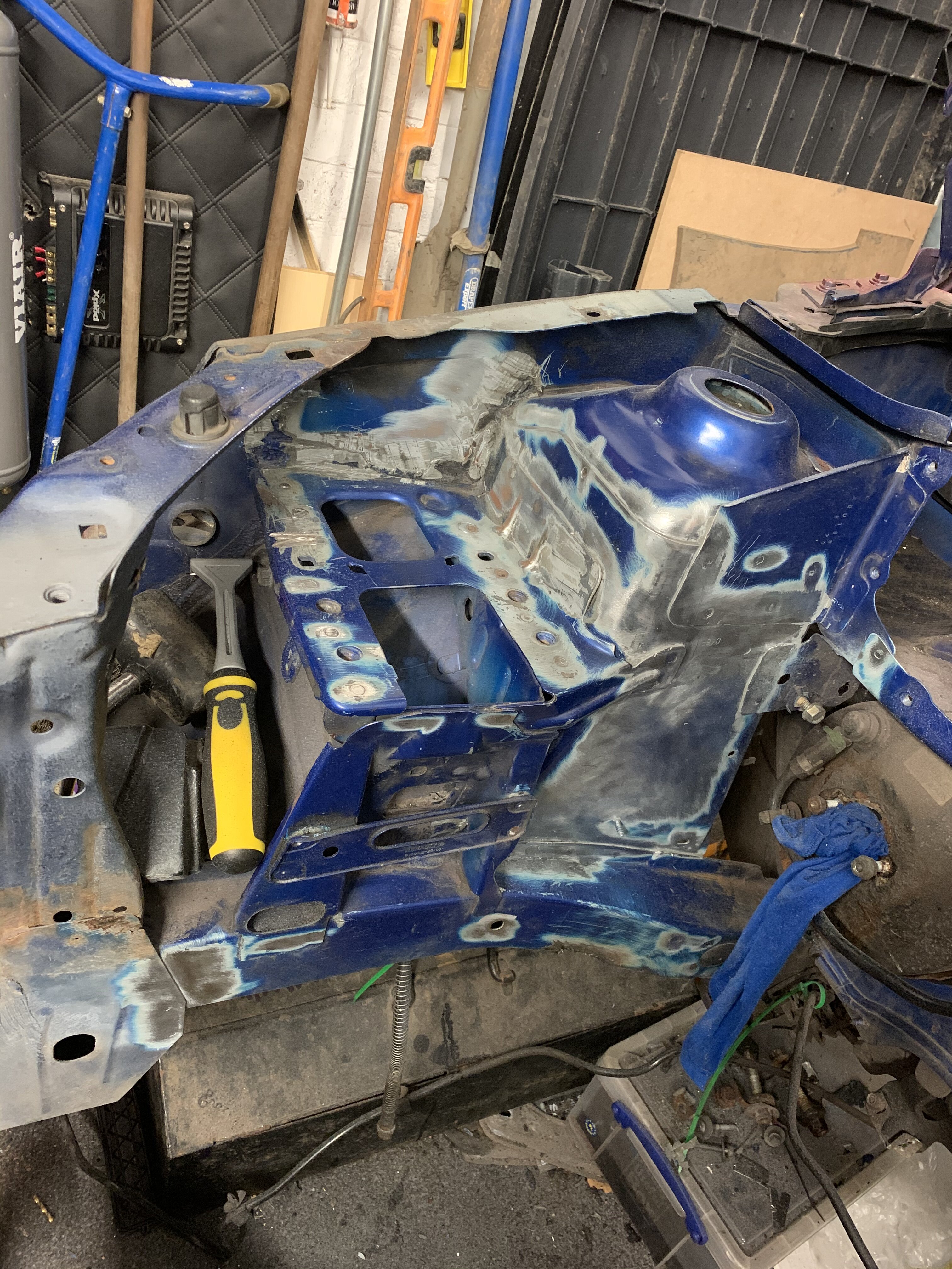

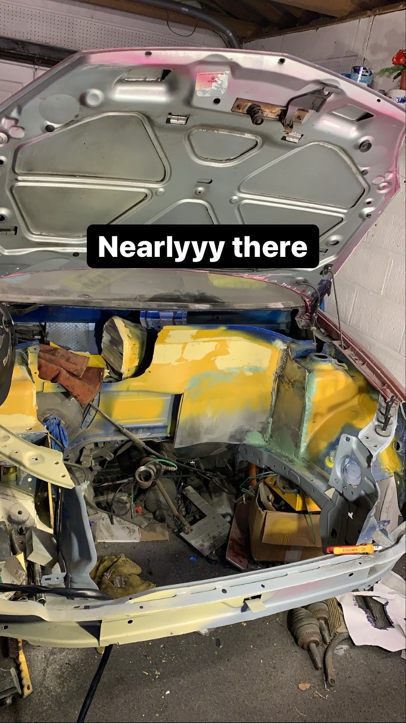

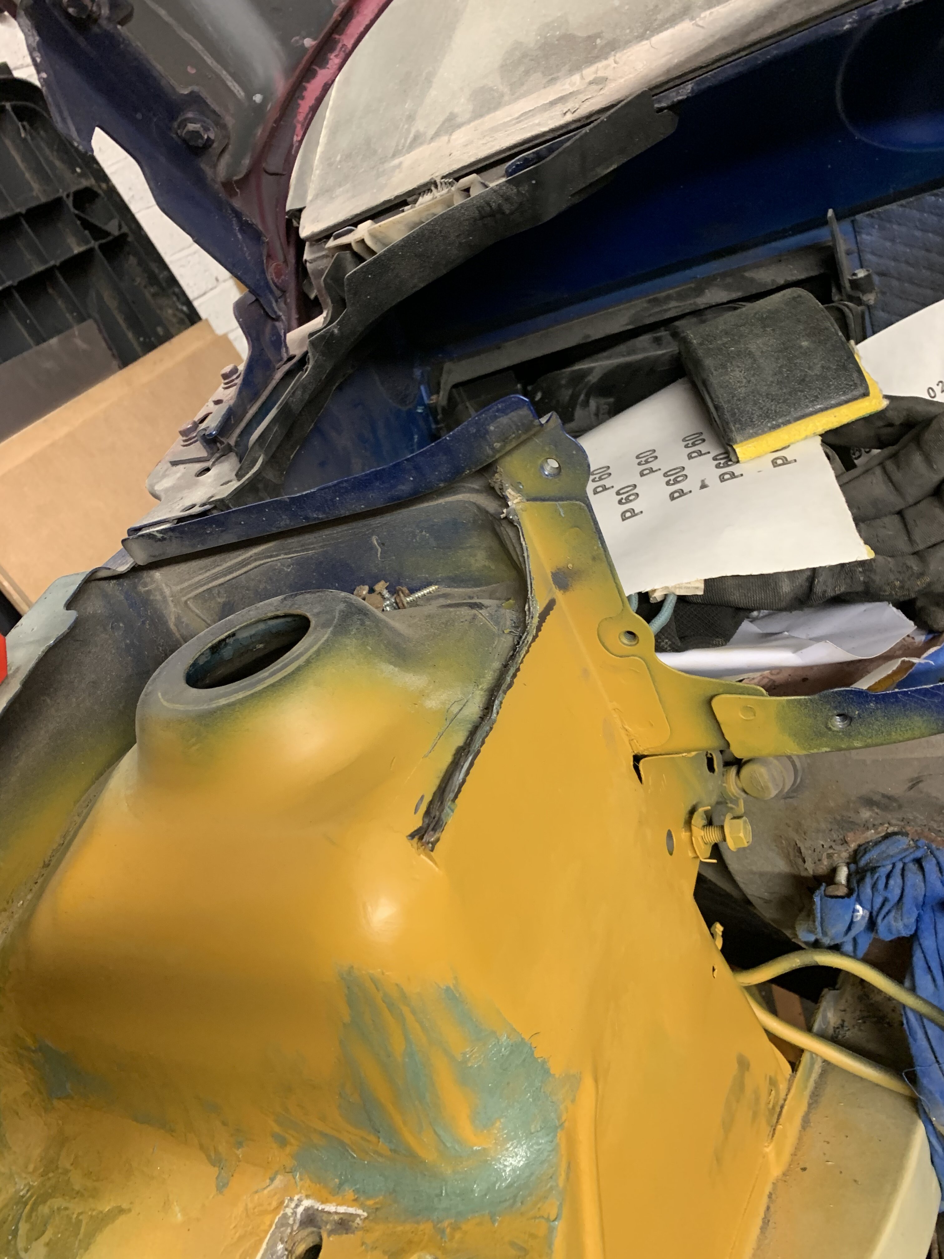

still got a bit more welding, grinding and smoothing to do, but you get the idea.
The bay is 80% done now.

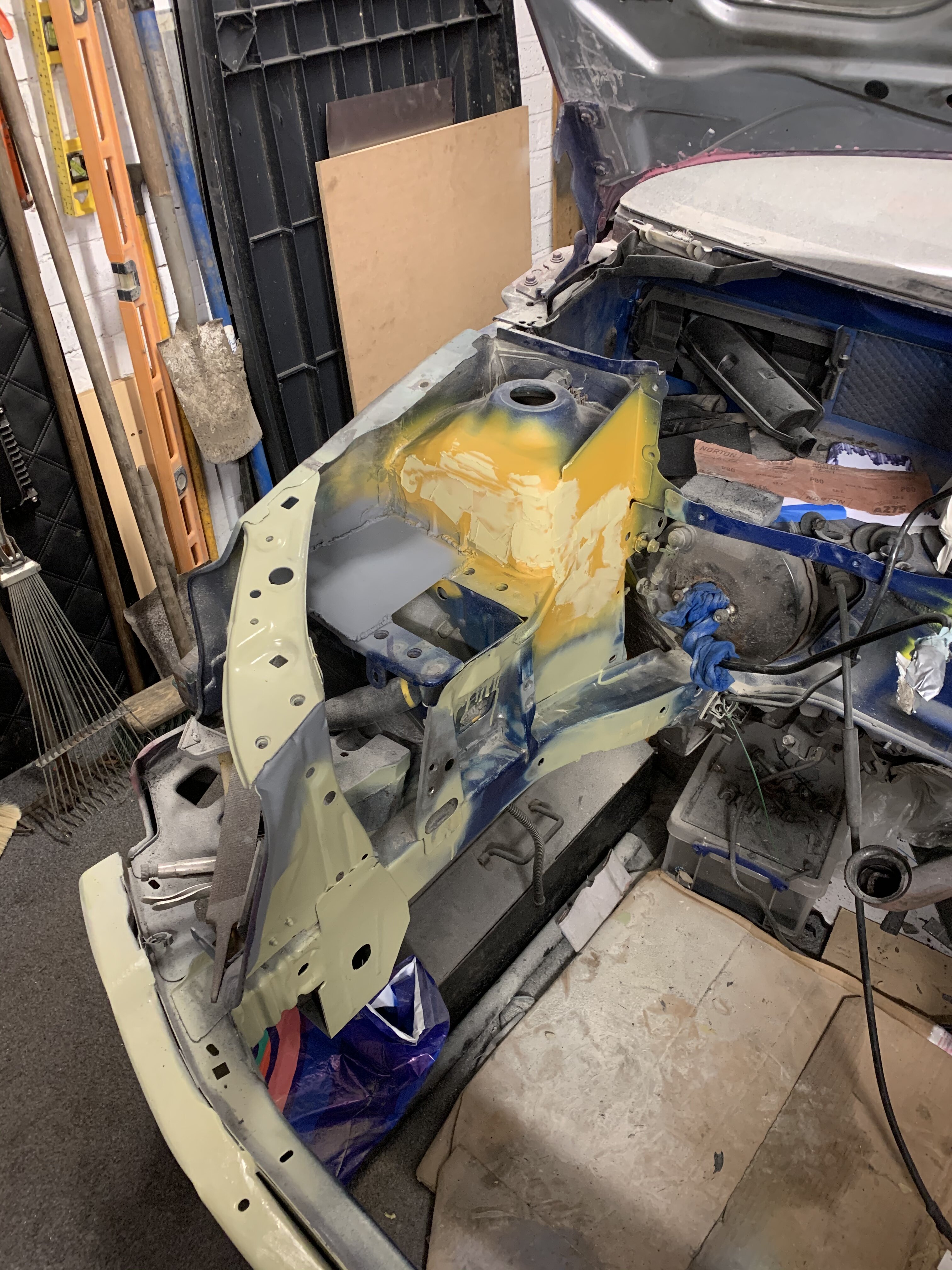

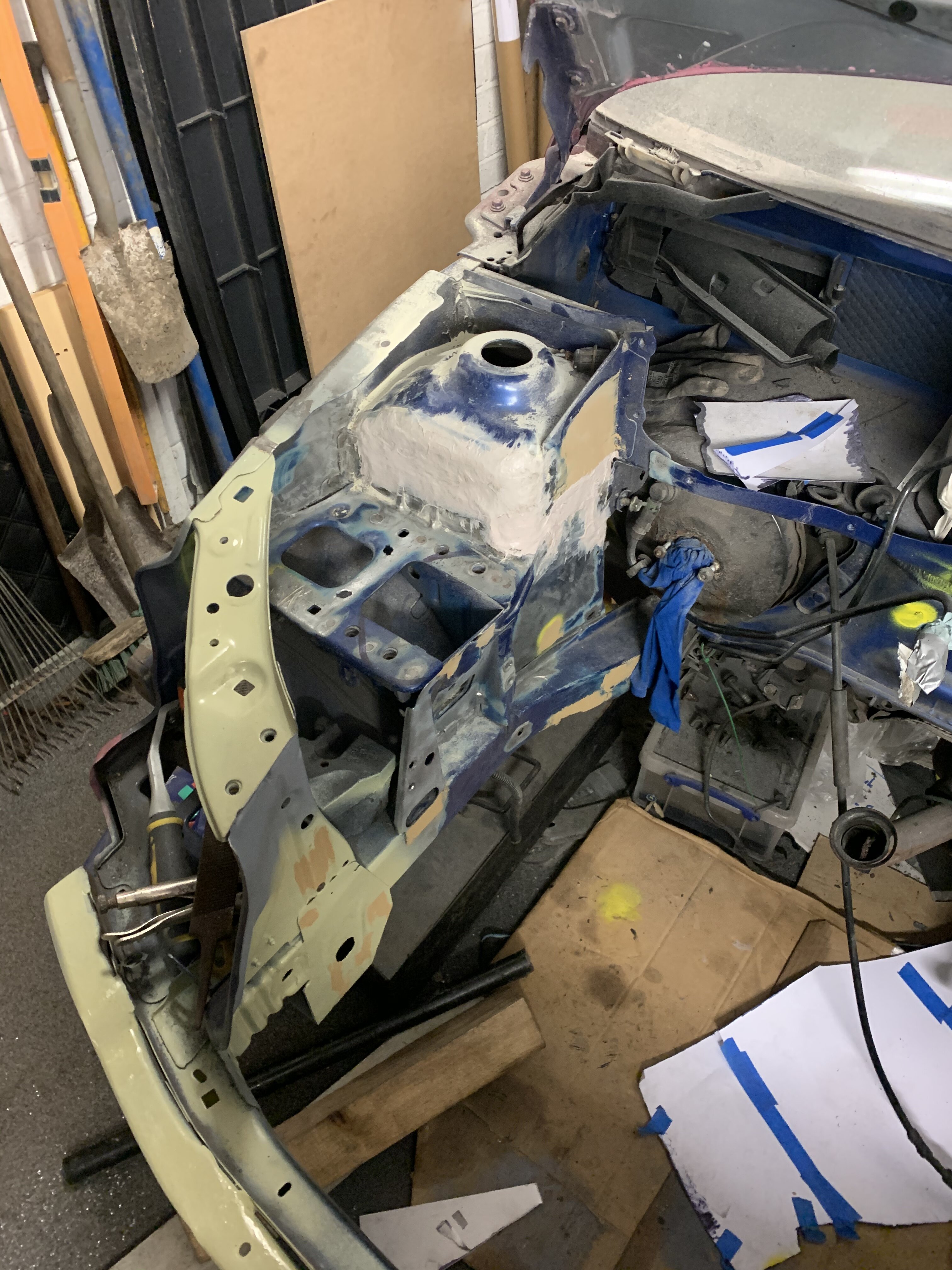

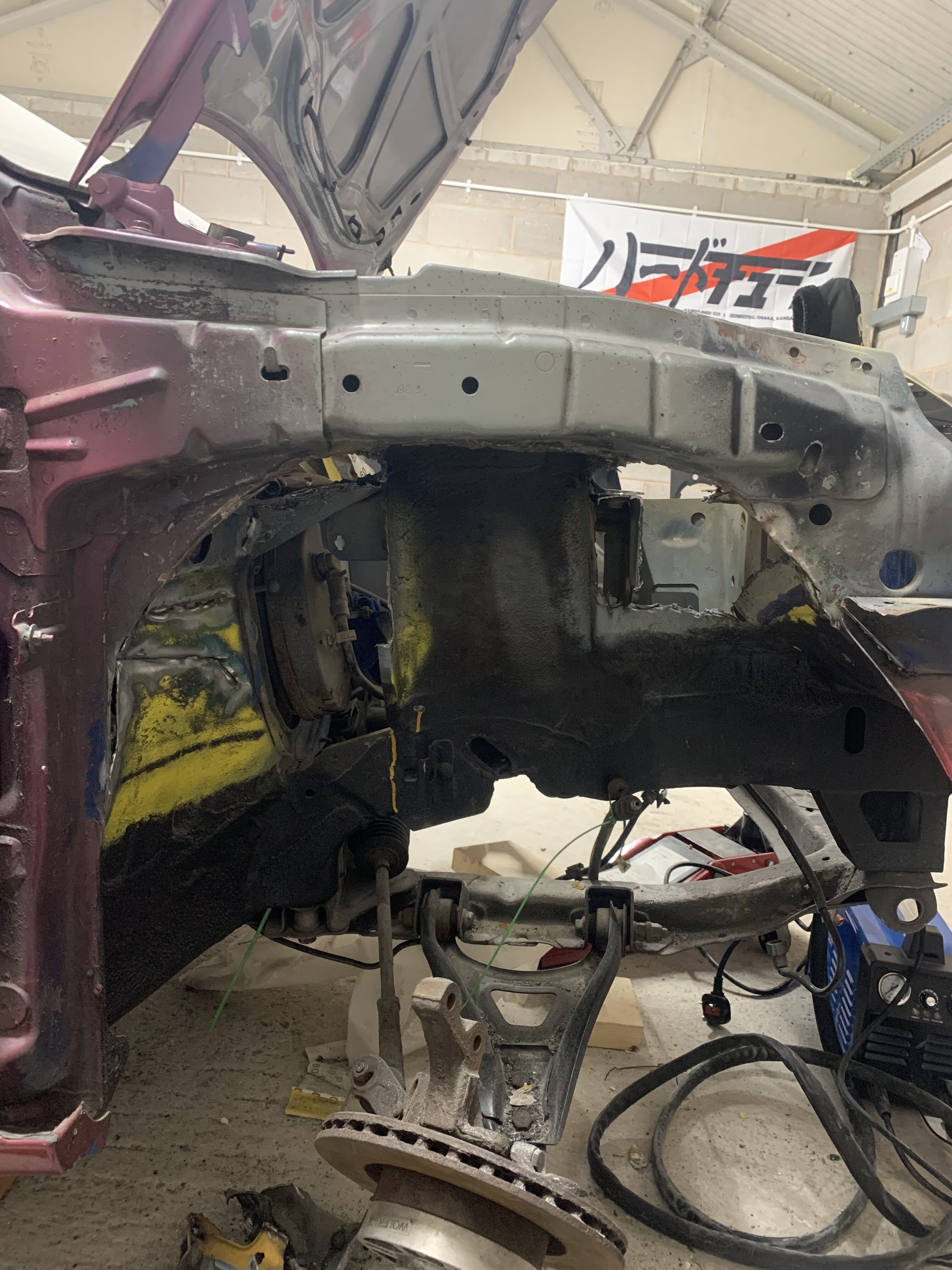

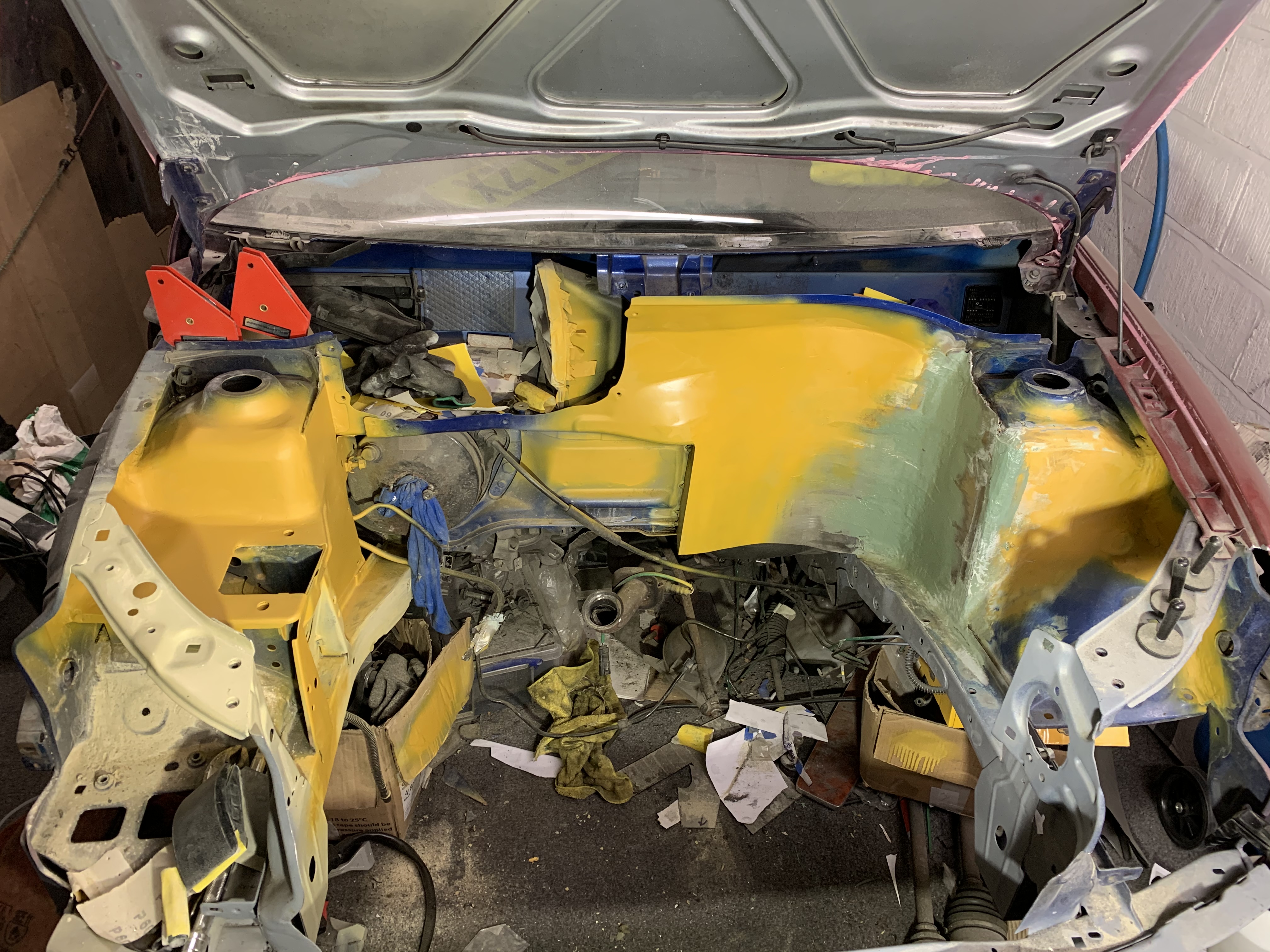

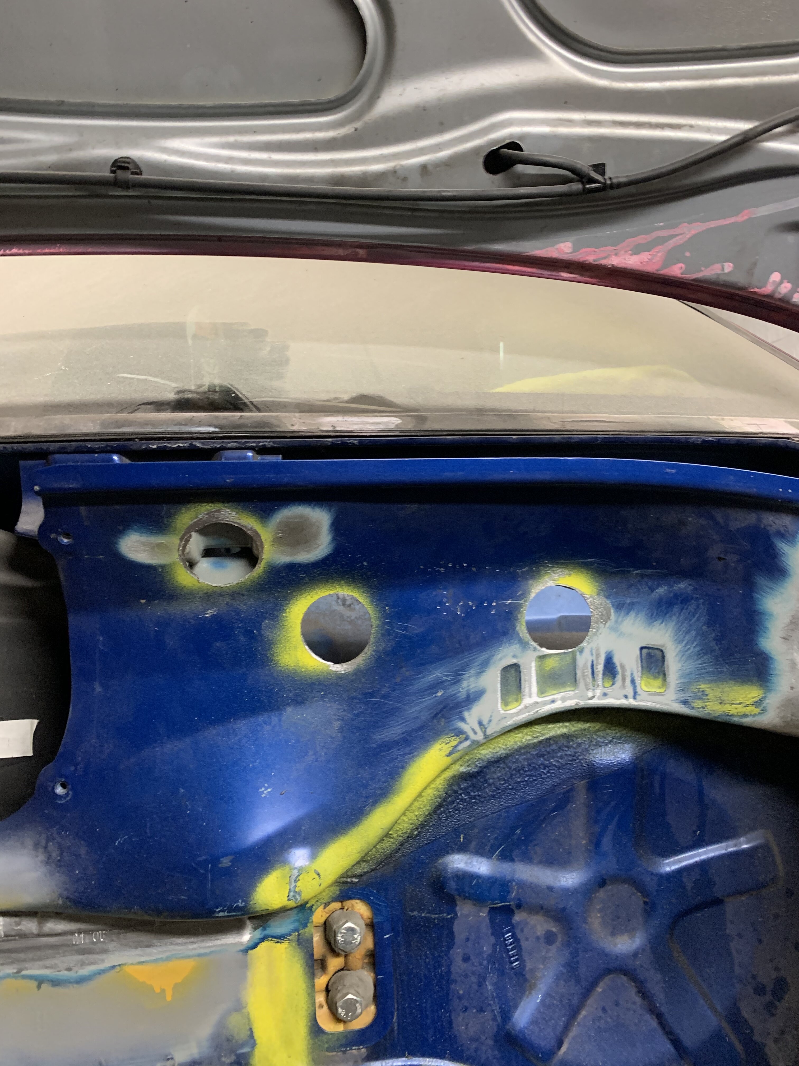

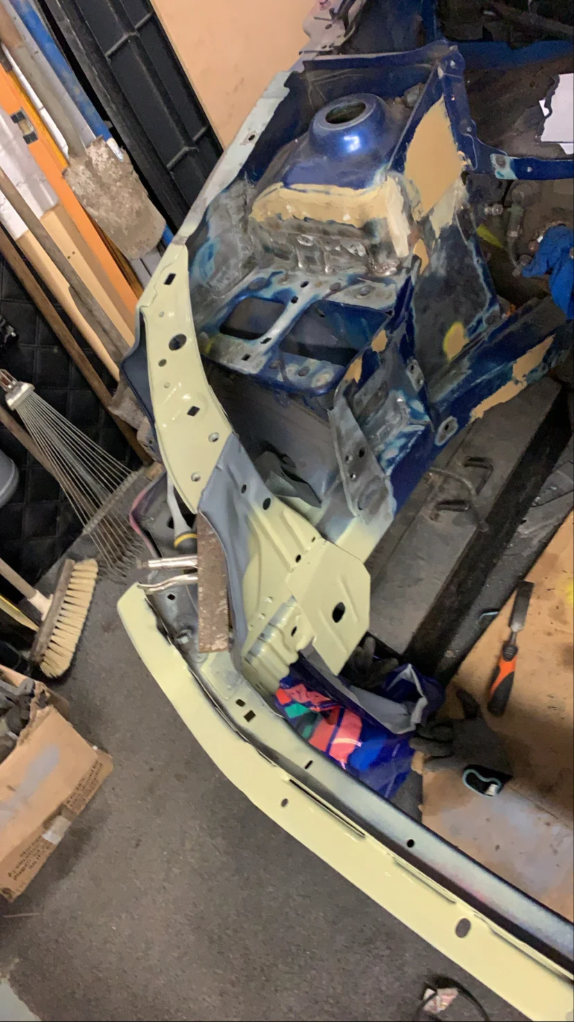

All the welding in the bay is finally done now, few plates needed cutting out and welding in so i could get a form of curvature in the corner. I didnt get round to taking loads of pics as i just wanted to crack on and get everything welded in.
Went on to carry on with the fibreglass filler to skim over the area so i can get a nice flat finish.
Still got a lot more skimming and sanding to do, but the for the time being this is where I'm at.

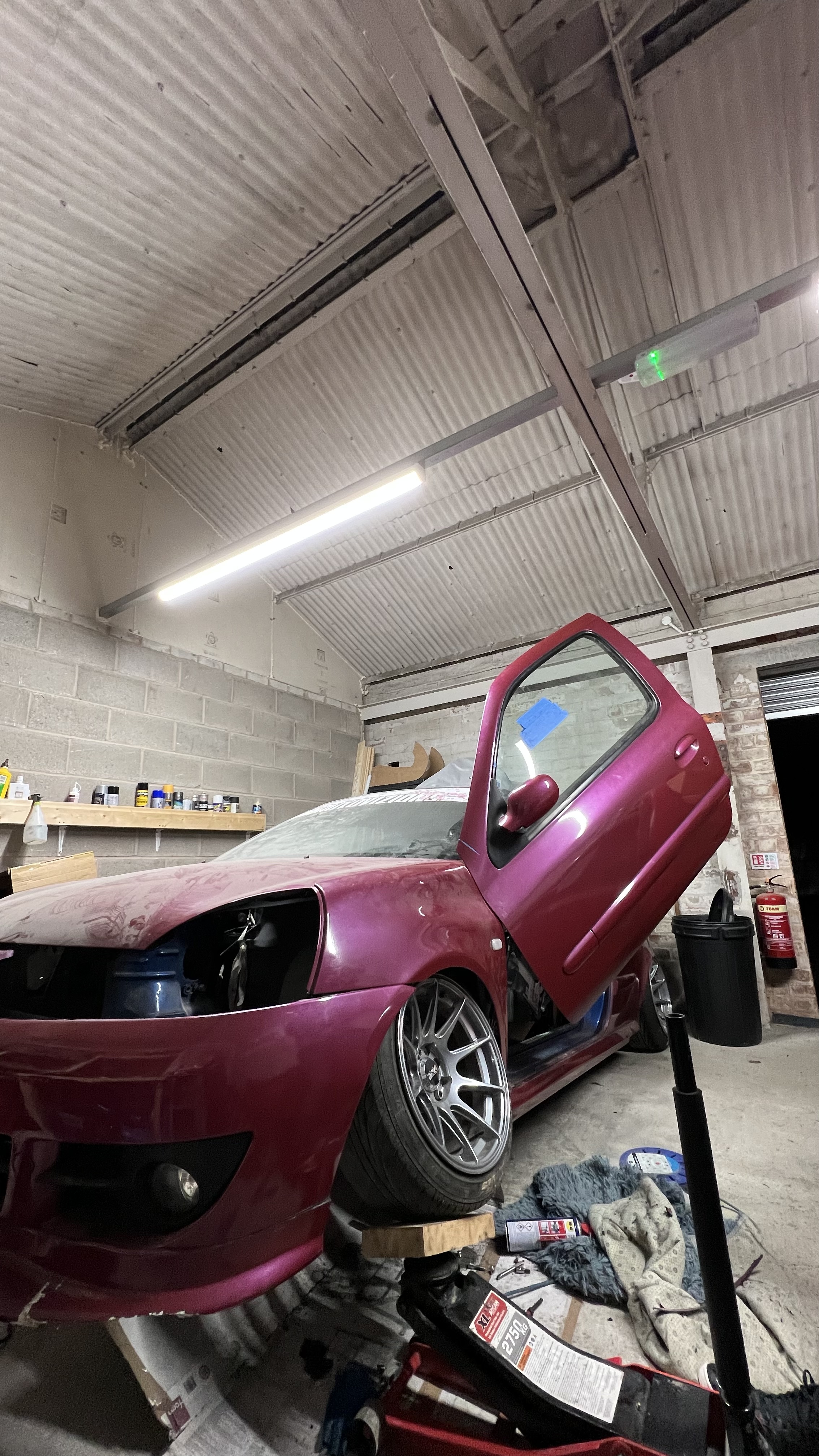

After waiting long enough, ive finally managed to get my hands on a unit. So i can actually have more room to work with on my builds. Before i get the clio ready for the move ive dialled in the rear height which im happy with now.

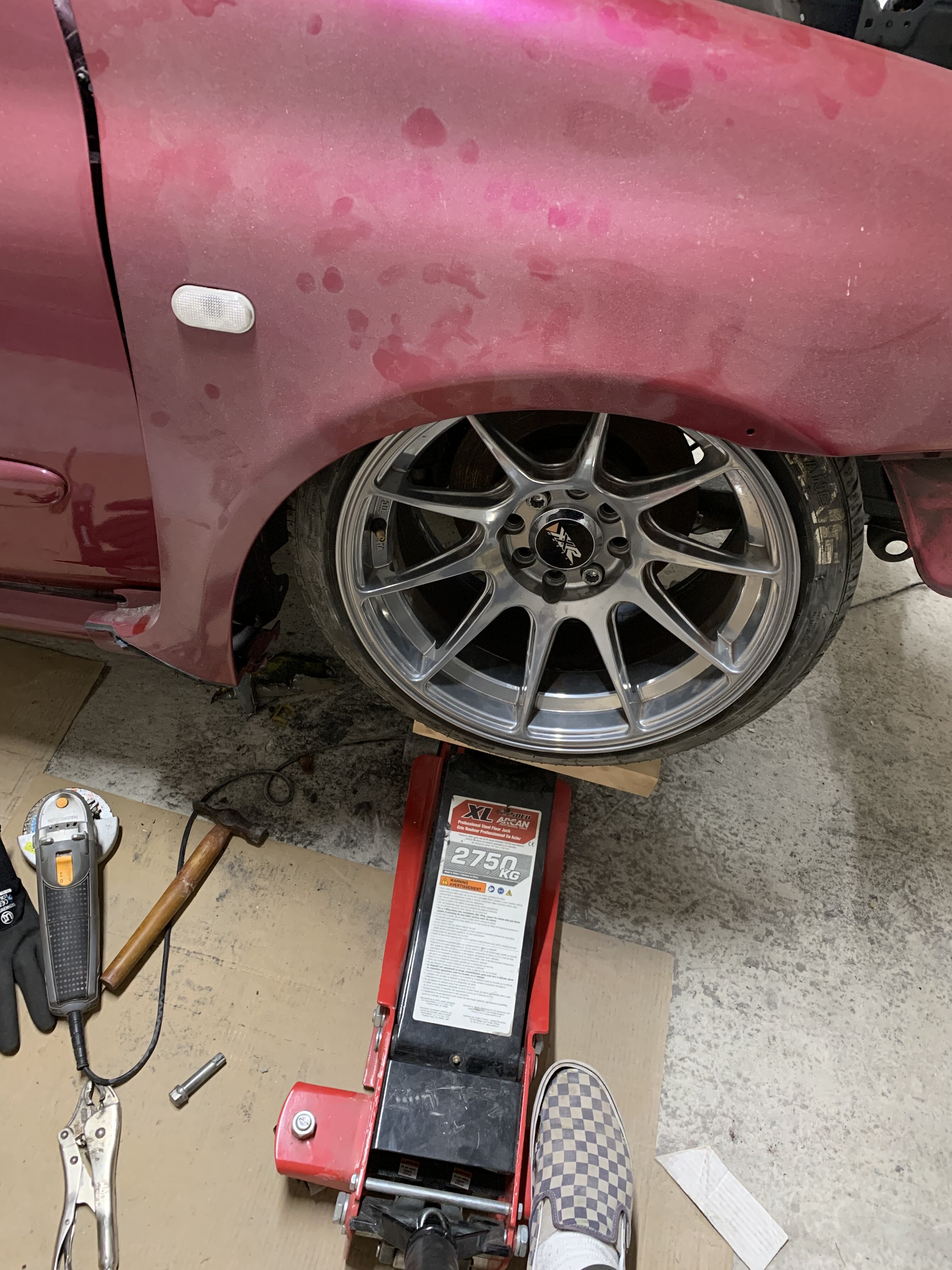

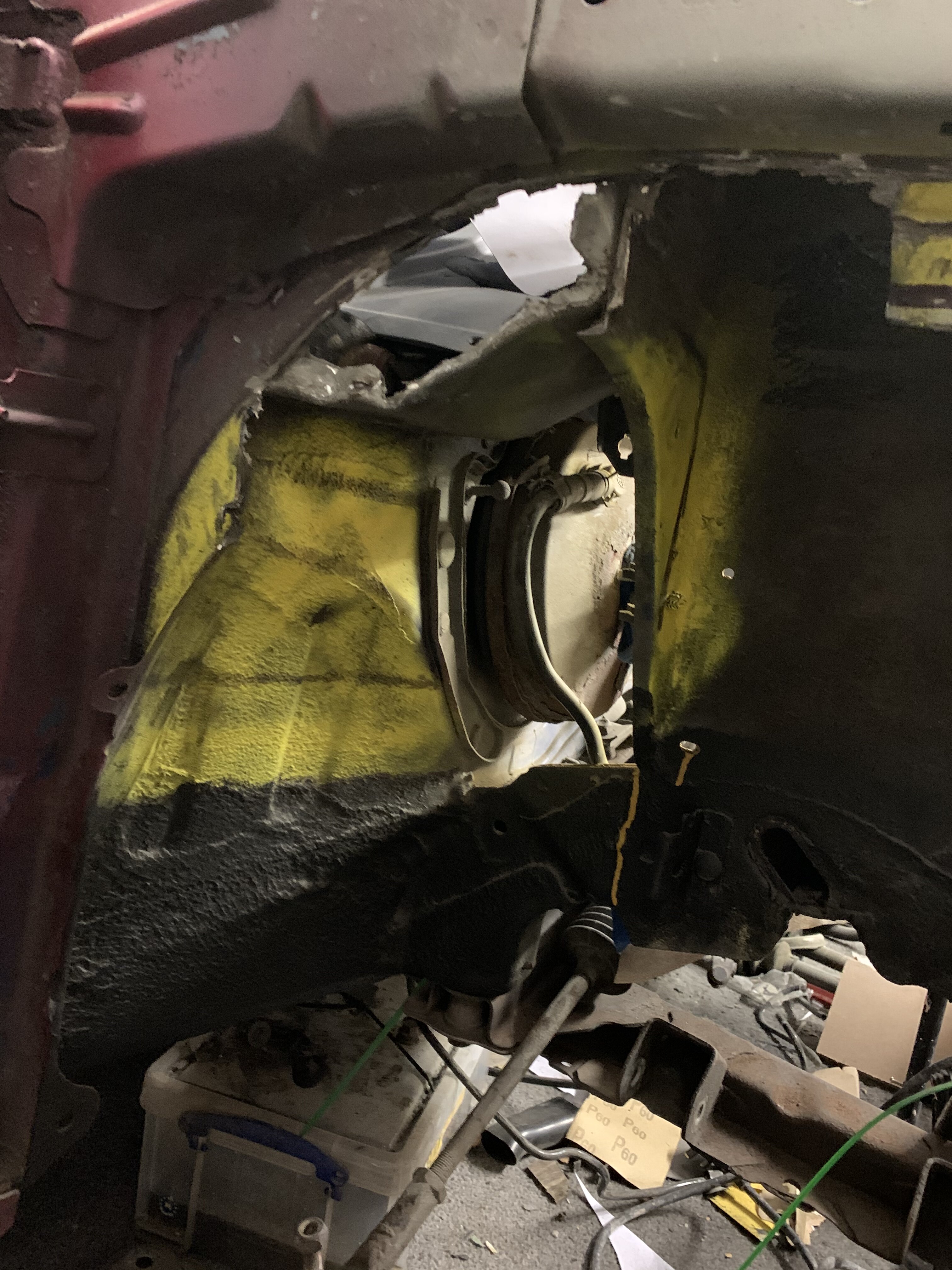

started the chopping on the front arches so i can move onto the fab work.

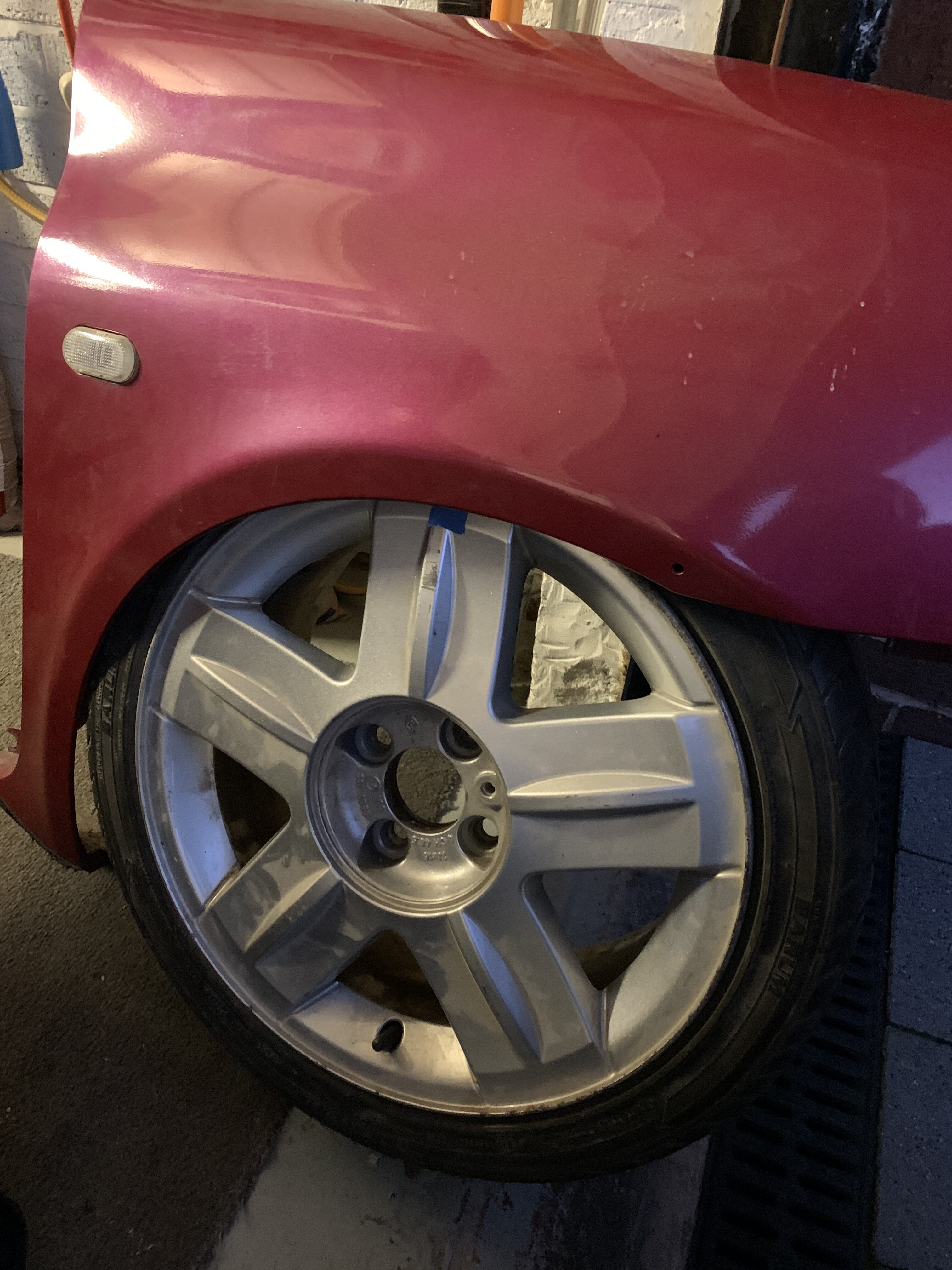

Did some measurements and I’ve mocked up how the fronts should sit on 15’s but im still wanting to run a 16”

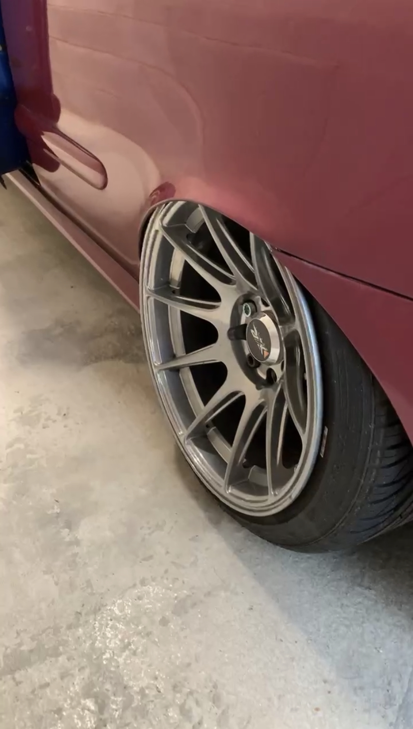

I finally got her on all fours and trailed over.
From there i thought id see how low it would actually sit on the back as its never had the full weight of the car on the rear end.
and i was very happy with the results.
Now it was in the unit i could finally start chopping up the front to get it sitting even with the back.
what a b*****d it is to get these cars low on the front😂.

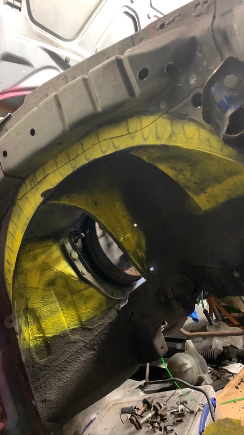

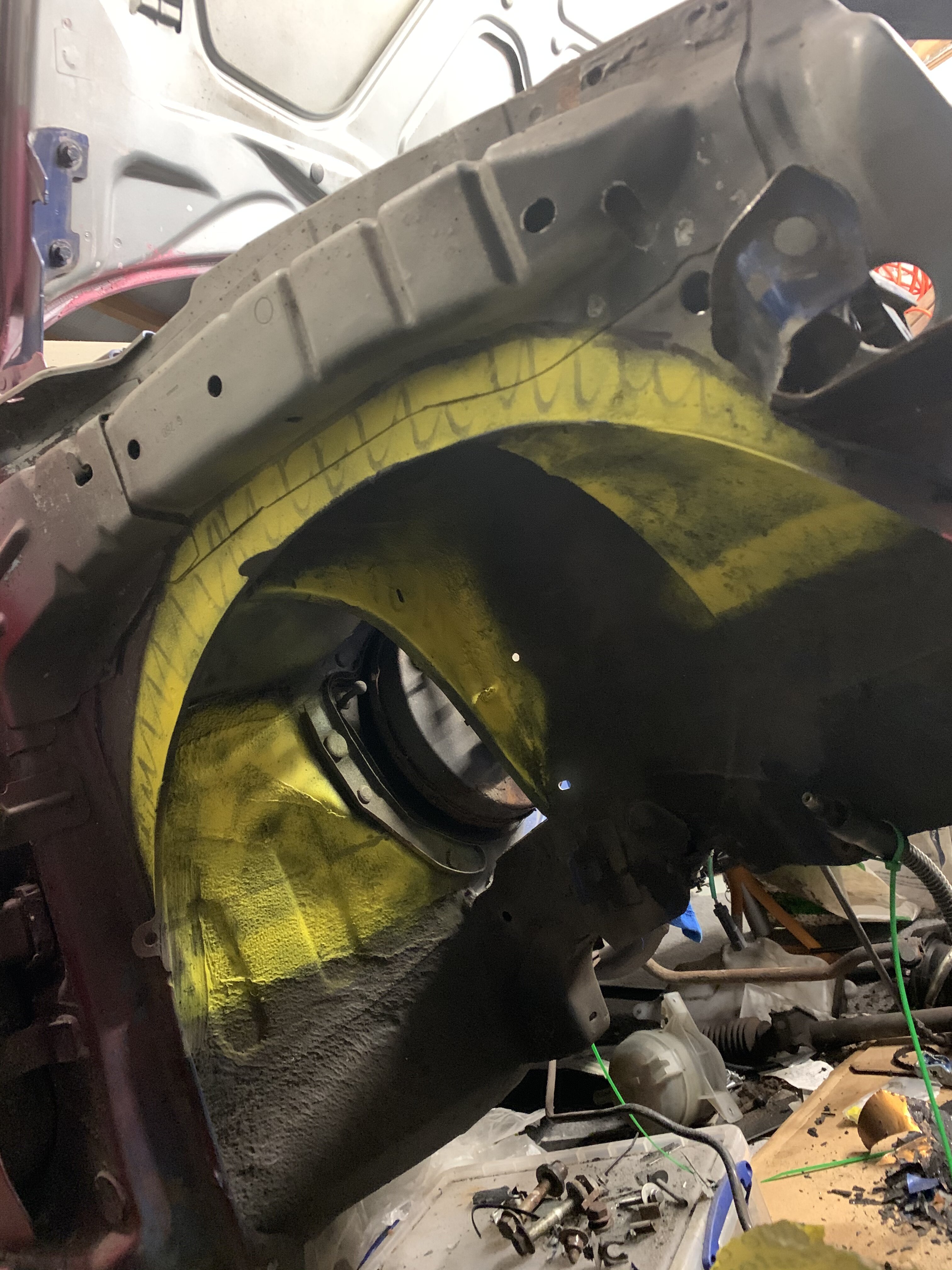

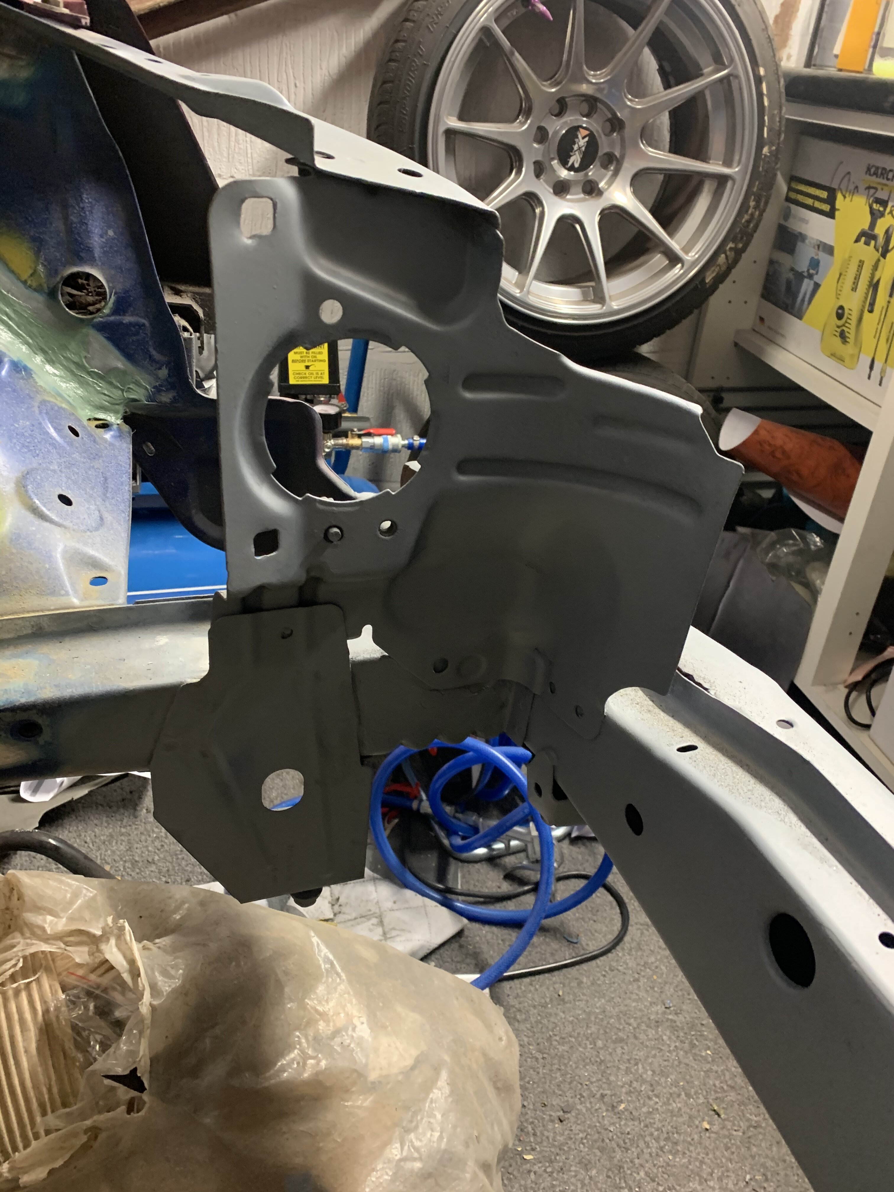

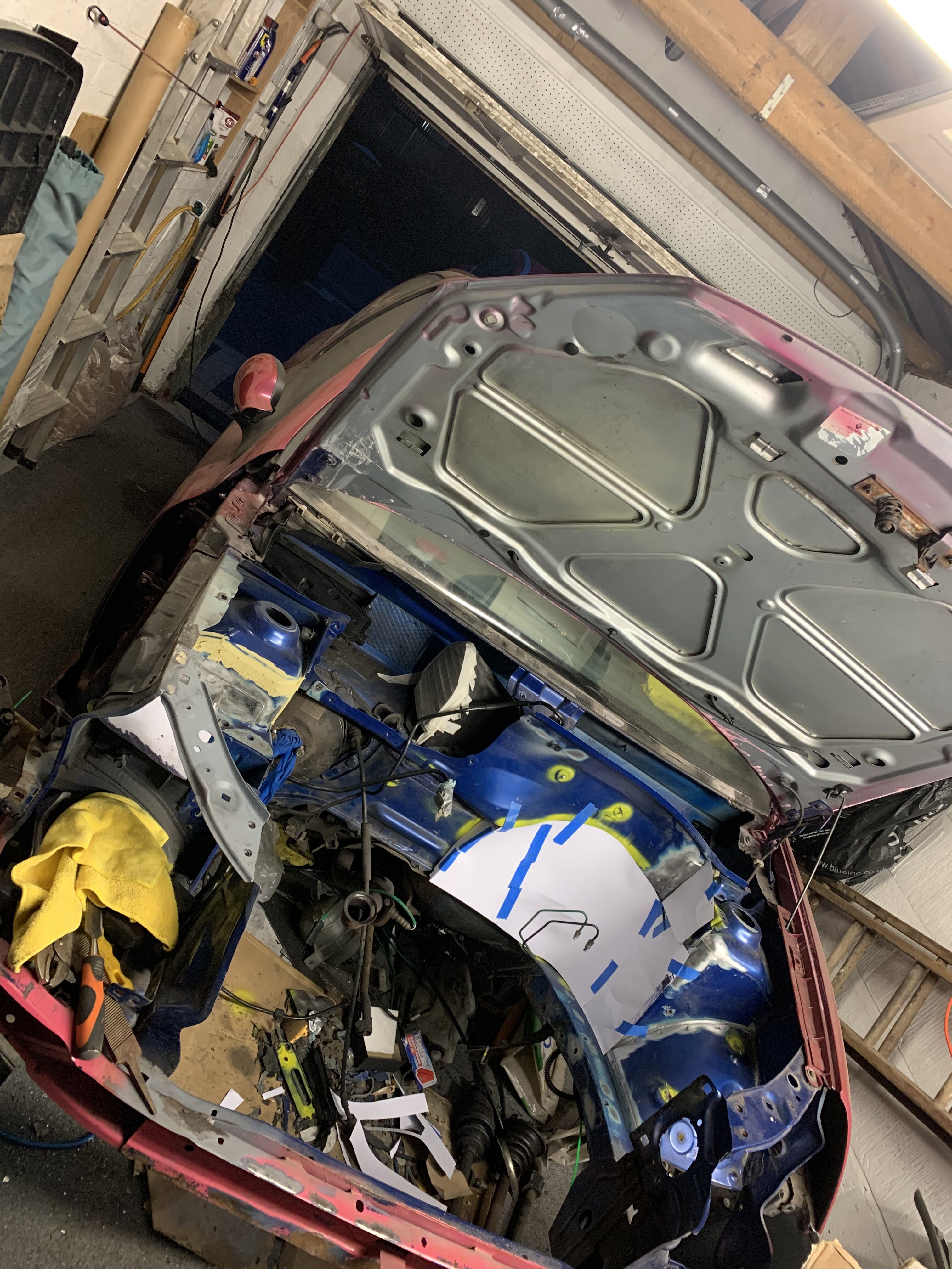

Marked up where i wanted to cut out.

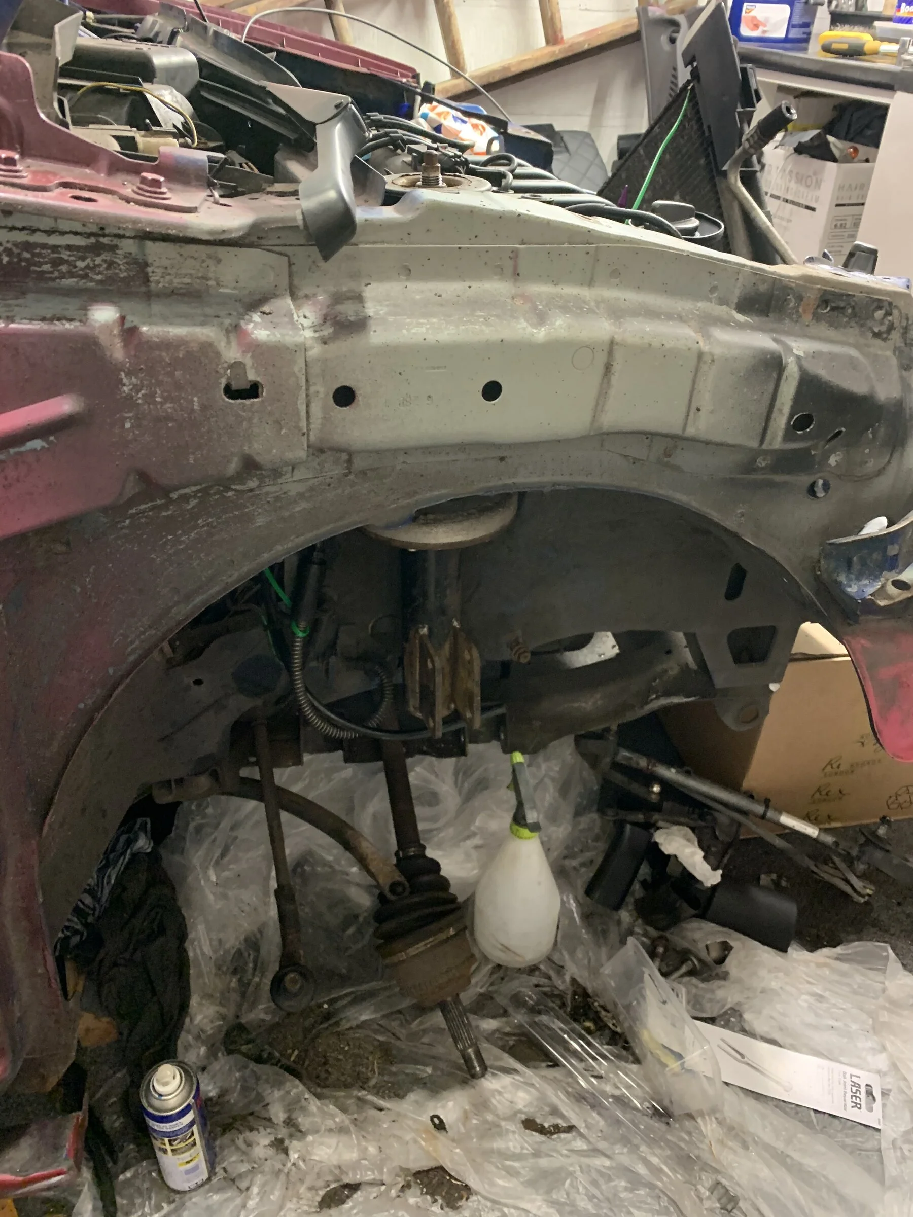

Using a grinder was taking way to long so i treated myself to a draper plasma cutter, everything was x100 easier from here.

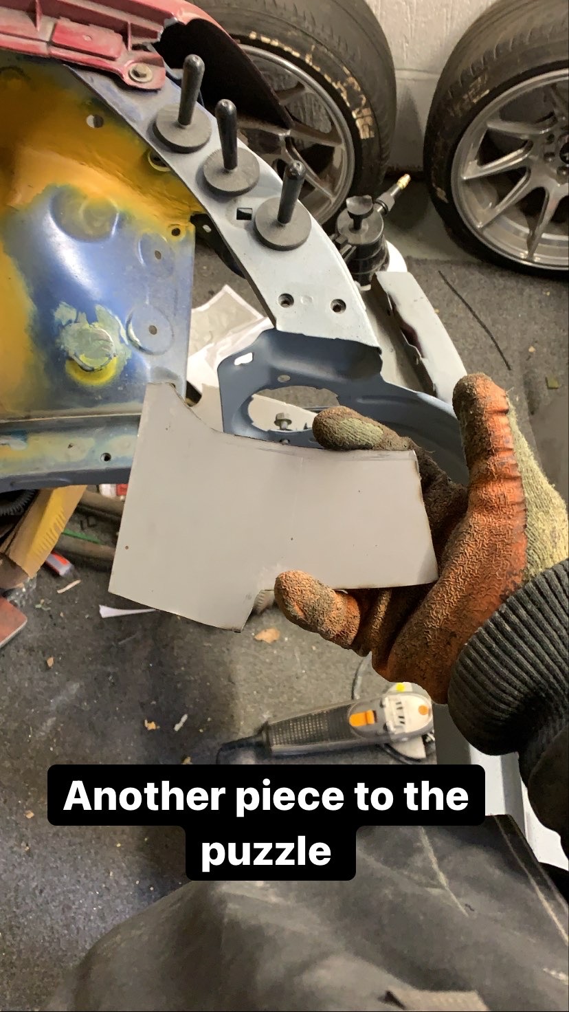

I now have everything cut out, its just a case of cleaning up the edges, making templates and then transferring that over to 2mm mild steel and getting it welded in.
Quick mock up with everything bolted on to get a idea of how it will sit height wise.
Im getting a new wheel set up, so once its all done i can finally start dialling in the fitment and get it sitting nice.

What plasma cutter did you buy? Like it?
Its all getting re enforced where its been cut out dont worry😂
And i got a draper 92454 25A plasma cutter, just under £300 and for the money you really can’t complain.
Its the first time ive ever used one, but it was very easy to use. After a few passes you get a feel for what works better position and amp wise.
