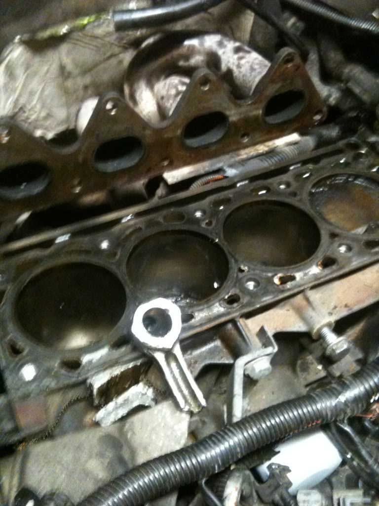

Made a great noise. Had to laugh when I took the
head of and was thinking Errr were has piston number
4 gone.

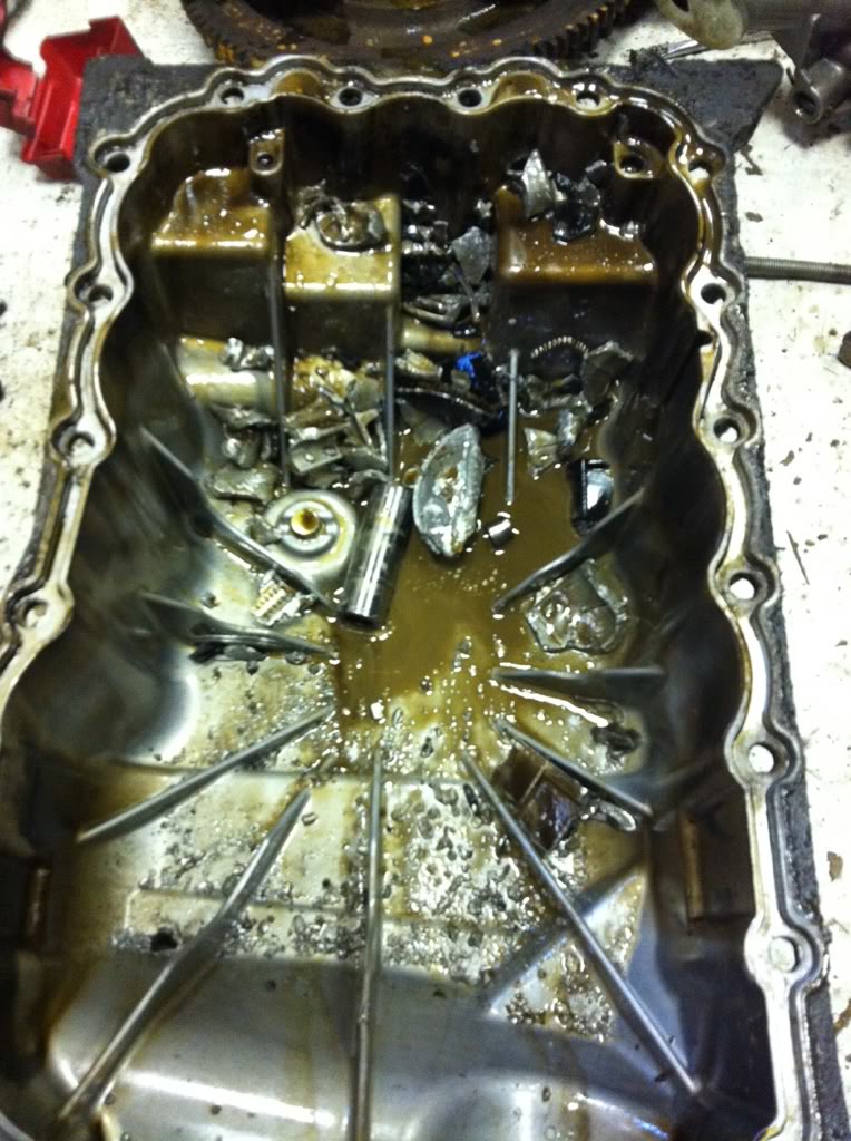

Also known as a gudgeon pin.
The bore is not to bad. Did have to empty some bits out of the
exhaust down pipe and cat though. there is also a hole in the bottom of the block so
may be some parts in the water side.
