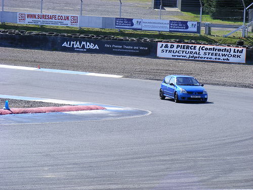

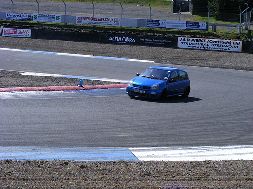

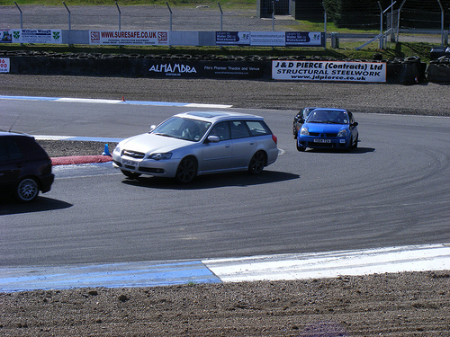

i hadnt done anything to the car since the last update and headed to knockhill last sunday for a trackday
919 by
h3ppy, on Flickr
As you will know i have deleted the power steering, so here is my thoughts on it.
Firstly, people who say its to stiff and hard to turn need to grow a set! :rasp: anything over 3mph is fine!
On the road:- you really need to keep your wits about you when pushing it on a road, the car tracks on every bump and contour and it does feel like it wants to pull you into the ditch! and yes my tracking is fine
 General driving is fine though, took me about 10 miles to get used to it and the only real problem is parking, but as said before i wouldnt let it put you of!
On the track:- well, what can i say! what a difference! feels so much better and you are so much more involved! yes it is alot more work, but it so so worth it! Coming into corners i can literally feel the point its going to start understeering, you could feel it before with the power steering but it so much more obvious now! I was concerned about correcting oversteer as well, being heavier and a longer rack i thought i wouldnt catch it if it went quickly, but the two times the rear decided to slide it was fine, much and such the same lock applied as with the power steering. After about 10-15 laps you can 100% feel it more in your arms, but again nothing average joe couldnt deal with. All in all im so glad i done it, feels sharper and i feel alot more connected to car, a very worthwhile modification in my eyes! All the powerflex bushes would have helped as well i should point out....

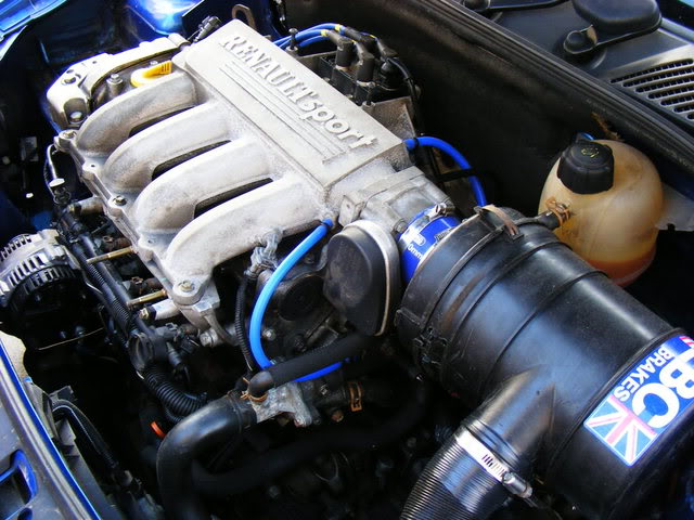

This is turbo'd or supercharged....no idea how it went though as i was always waiting in the pits when it was out, anyone from here?
