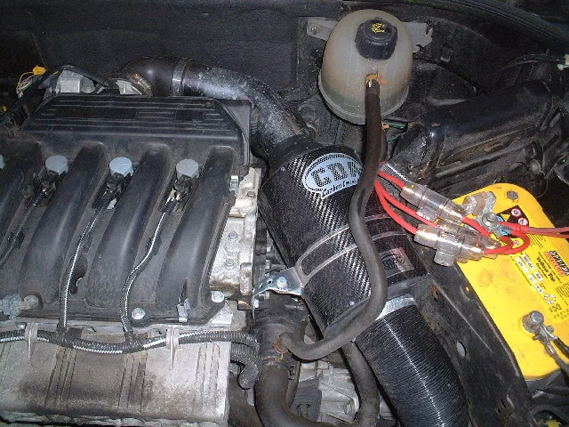

Im lookin at the alternator one now and im a bit confused on what i can do with it What i was woundering is rather then taking all of the wiring out and messin all the tubing up thats been fitted just put the 4awg cable over the top of the tubing from the alternator to the battery + thing is ive noticed theres a block on the + of the battery were the cable comes in what is this? a capicitor? do i need to make sure i go through that block still or can i go direct?
picture below of resistor/capacitor:
http://homepage.ntlworld.com/craig.wood1/resistor.JPG
is it the same a the little block above the bolt on this pic?
if so it does f**k all and can be removed and just run the new cable over the top of the old one but make sure it aint anywhere near touching any metal of the engine
lol. yeh looks just like that i think.
where is the Earth to the engine any idea? i cant find it Although i aint had a hard look just yet
i aint got a clue where the engine earth is but would have to be very flexible to move with the engine(which 4 awg:mad: isnt)

what cables have you upgraded on yours? if any? seems like you got alot of cables running off that one battery how many?
3 x 10mm2 cables running the amp
the only one i did was put and extra 25mm2 earth in over the exsisting
