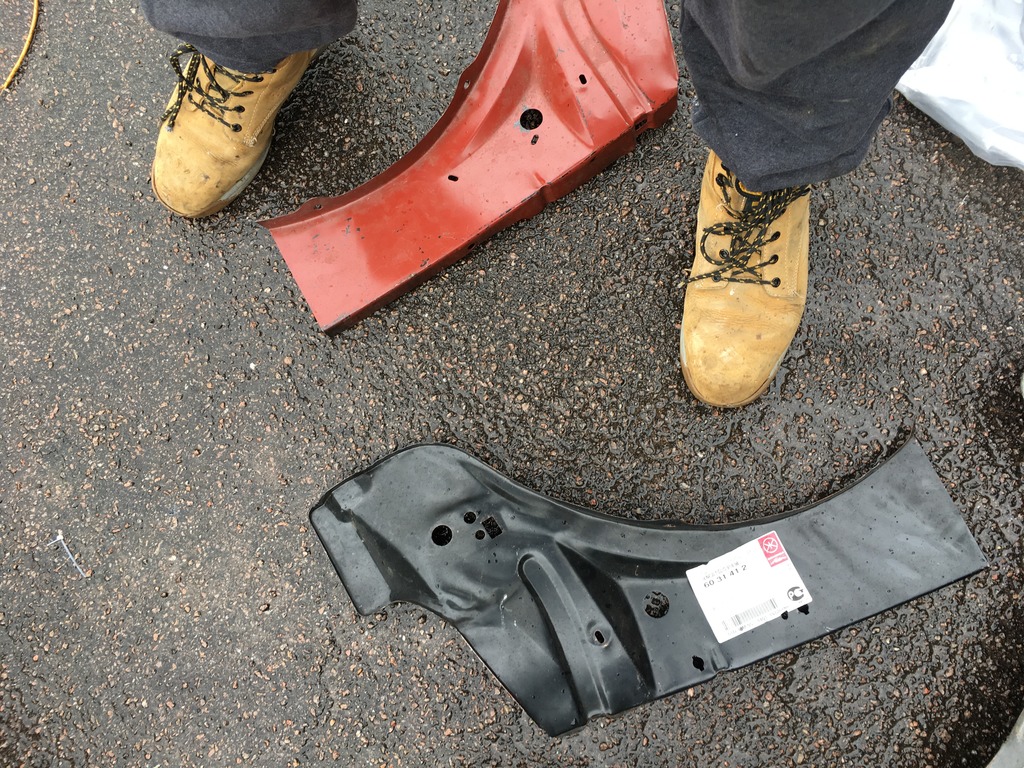

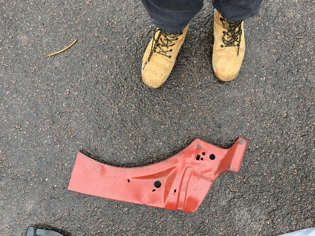

Here are the panels I've got to replace the rotten areas. I have 2 sets of new sills but they're buried in two different garages so no photos of them. Also 2 sets of new front inner wing panels, i couldn't reach the other set but you get the idea. With these panels I'm assuming they will probably need dipping before they get welded in going on what the bloke said about not putting any sort of protection on the shell before it goes back to them otherwise it need a complete re dip process. Which i would like to avoid as it wasn't the cheapest thing ever!
Here are some pics

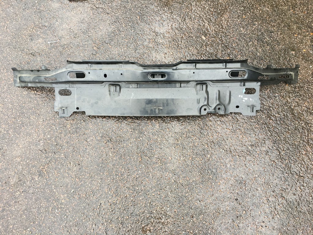

New rear bumper mounting panel, not sure of its official name but the bumper bolts to it so that will do.

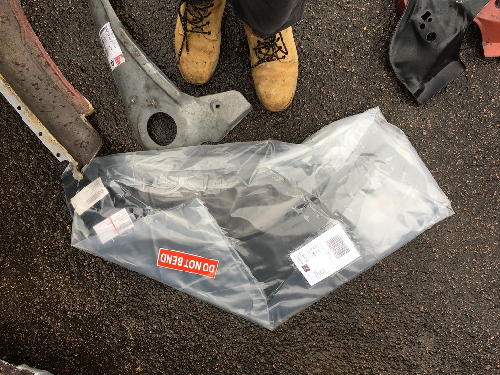

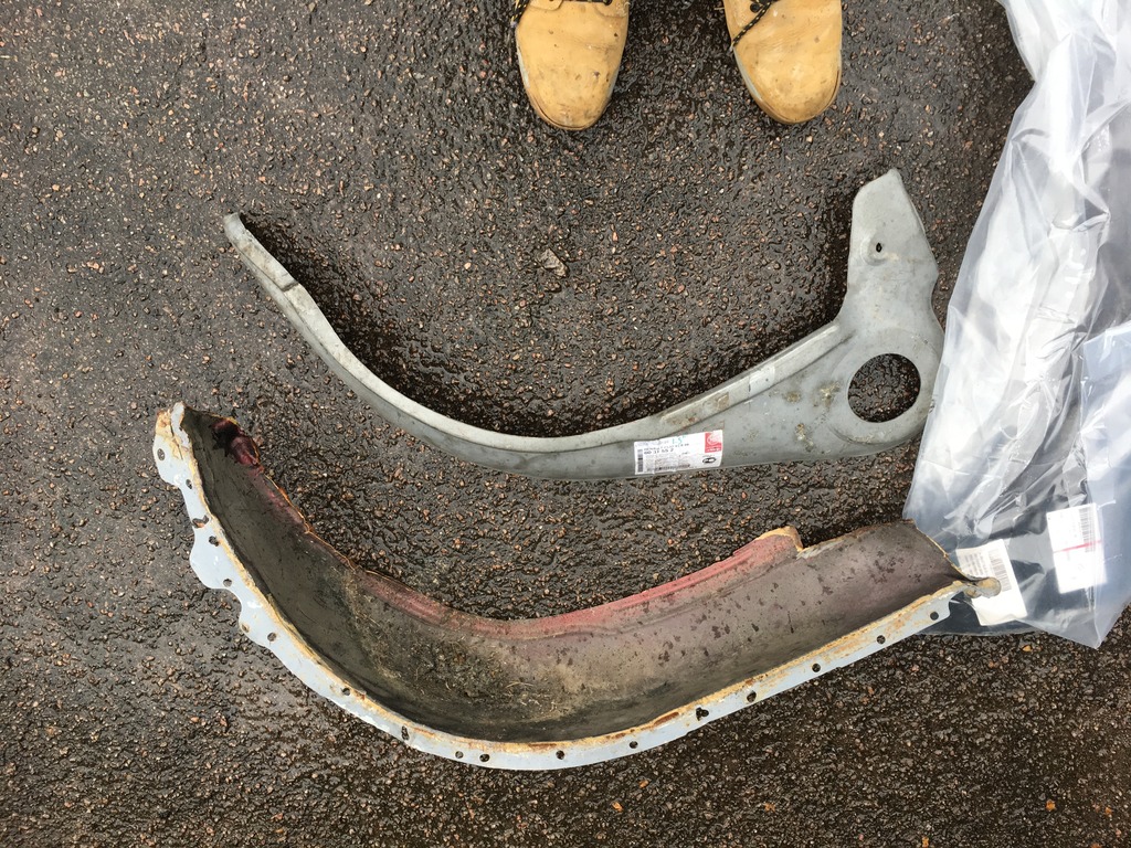

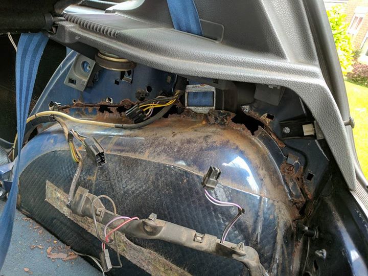

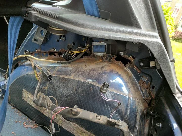

One new inner drivers rear arch where the fuel neck goes, & a rear 'tub' thats ok conditions i won't be using the hole thing but saves me having to beat a panel to get the radius's where parts might need replacing in the previous photos.
New drivers side rear arch poverty spec, so not flared. This should work ok for the bits i need it for.
Drivers new front inner wing panel
Passenger side new front inner wing panel, someone had decided to paint this one?!

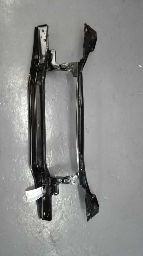

Brand new genuine Renault front slam panel section. This is a poverty spec one as the actual slam panel part is in one & there is no central mount for the front bumper that bolts on behind the numberplate area.

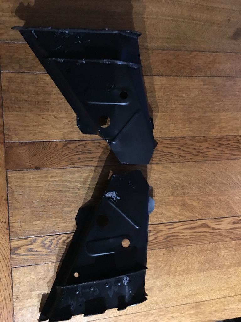

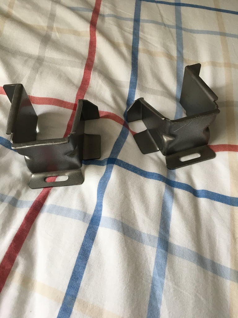

New front jacking point panels made front thicker material so should be a lot stronger.
New rear jacking point panels.

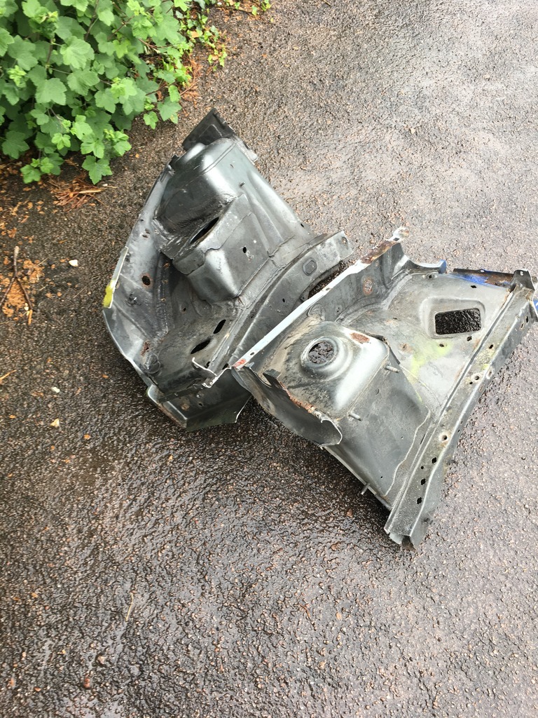

These front legs i cut off a car just on the off chance i needed anything. My other idea is to get the panels replicated if i can to help others when restoring theres. If you've got a mk1 and have ever tried to get replacement sheet metal parts you'll know that its near impossible to get anything.

The only panel in the above thats from Renault is the front slam panel, the rest are aftermarket items. Most of them could be found on Carz2 but even there they are running out of stock i think they are stopping making some items too. The jacking points are from a guy in france that i found on Facebook he makes replacement parts for 205's & started to make them for the renault 5's which share the same jacking points as the mk1 clio. Also believe that the front jacking points off a mk2 clio can be adapted to fit.

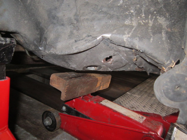

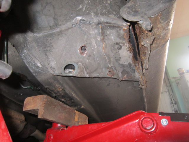

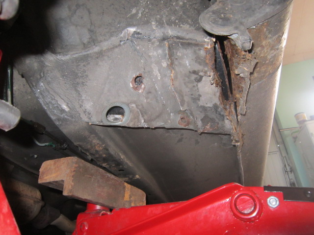

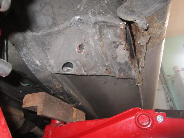

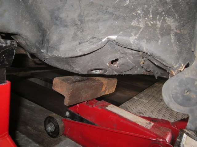

Did you buy or make the new front jacking point panels? I need a new left-hand fjp panel.
someone is selling sets for around £150 on the clio16v facebook page
Thanks. My fjp isn't so much rusted out but heavily damaged after I ran over an object on my drive way in the dark.
I'll be trying something else first: I'll cut the piece out and try to reshape it. I'd also weld some reinforcement on it.
Then weld the whole thing back in. I'll combine this with a new sill which I already had planned to do.

Where did you get the inner rear tub / arch panels mate ? Need to sort my drivers one out but I'm loosing patience with trying to ' roll ' a new tub section
