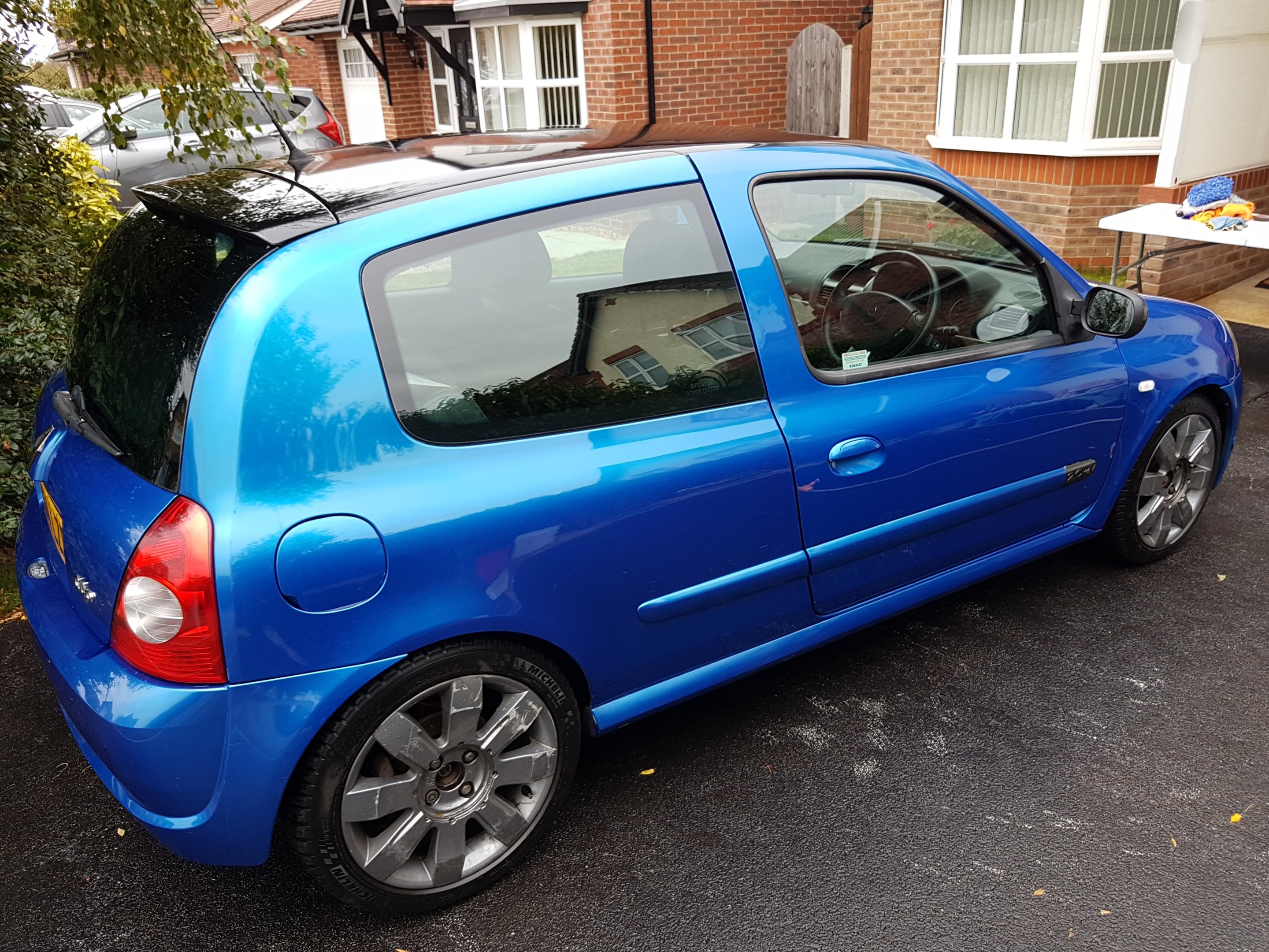

Thought I'd start a project thread to keep track of the work done to my Arctic Blue Clio 182 non cup.
Been on the hunt for a Clio for a while and decided I'd probably get bored of a fully sorted one rather quickly so bought a bit of a banger in need of some TLC!
I have little experience with working on cars except the occasional oil change but usually learn quickly so with a bit of swearing, brute force and a couple of beers I hope I'll be able to make a nice road/track car out of it.
Still making a list of all the things I want to do, but first stop was to book the car in at Birchdown to sort the timing, oil leak and low hanging exhaust.
Picking it up today and then start on the following list:

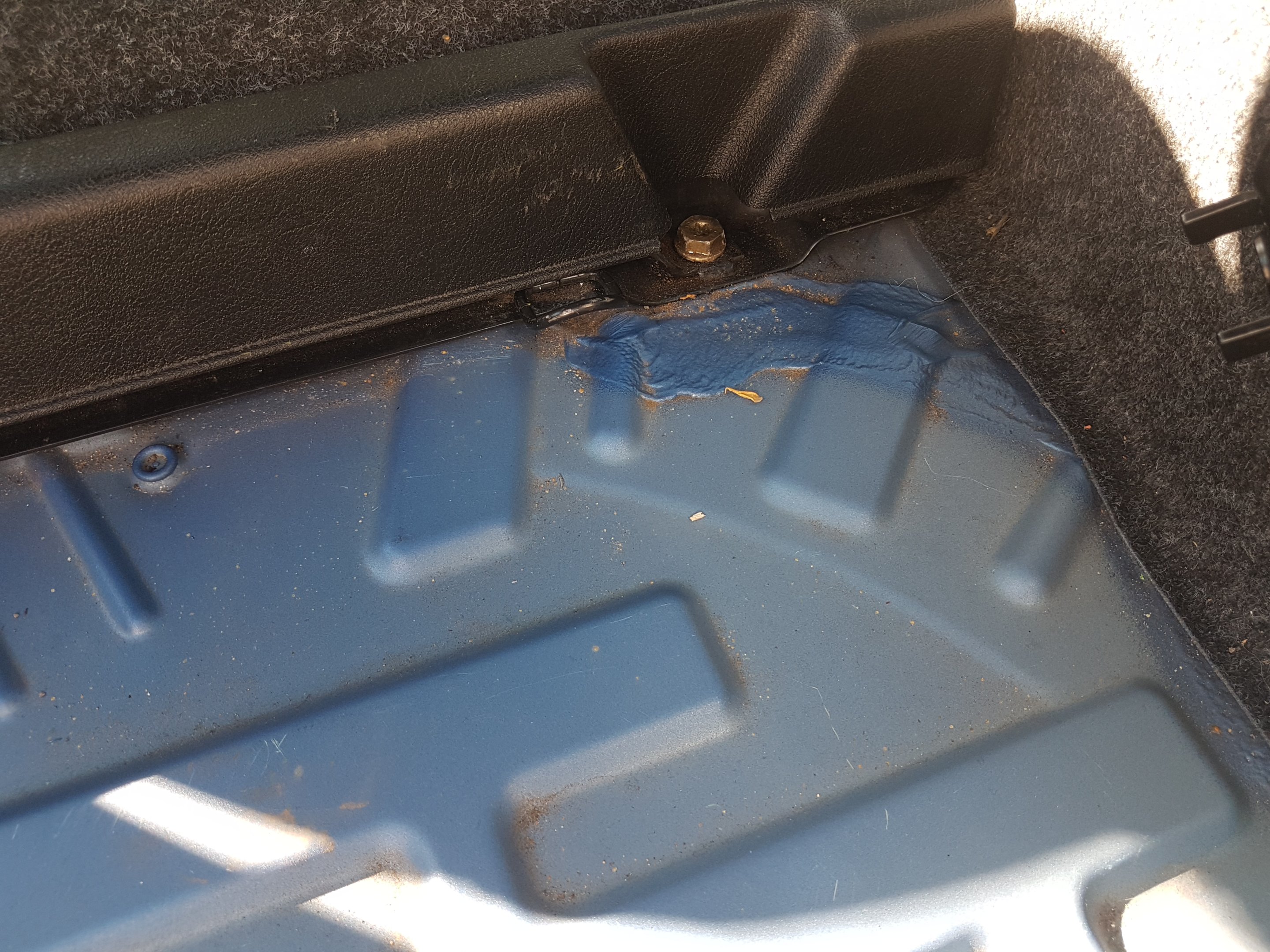

  • Find and stop water leak

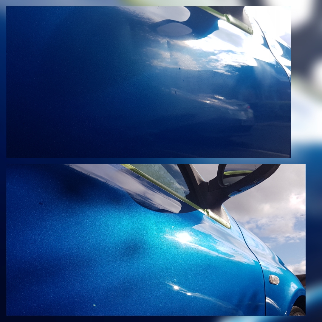

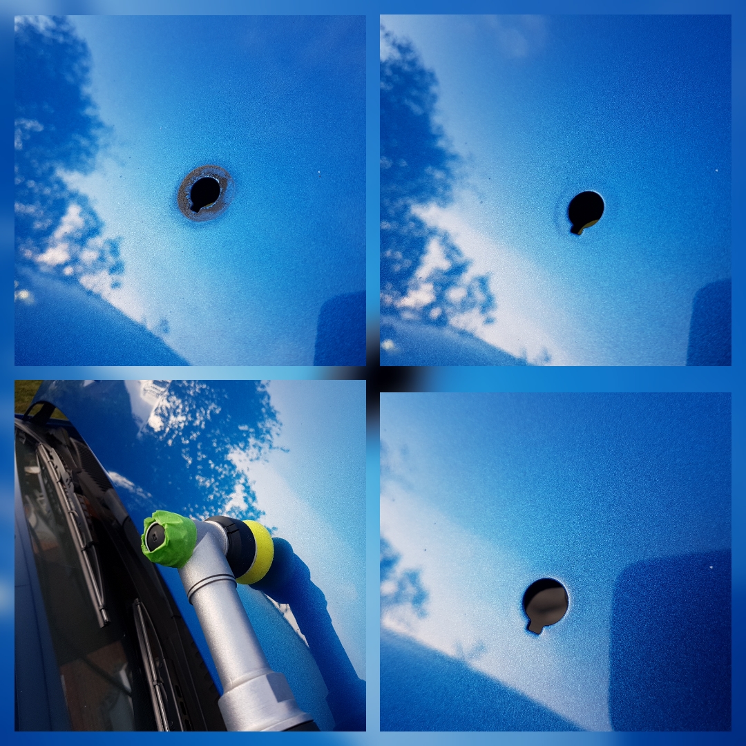

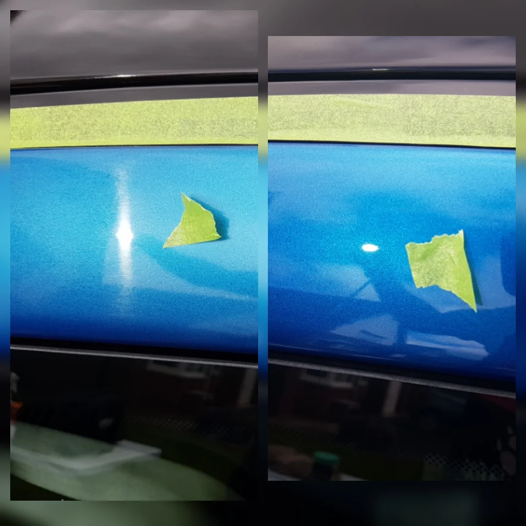

Before and after of the wetsanding marks
Some swirls removed

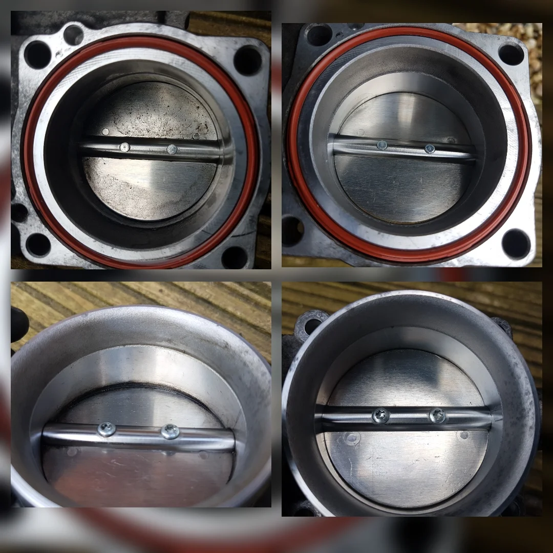

Obligatory throttle body clean pic:

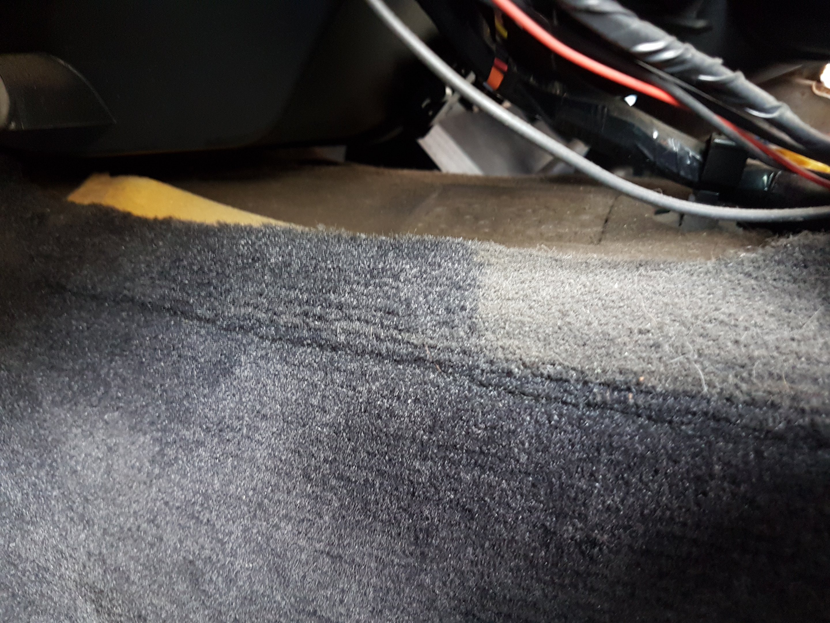

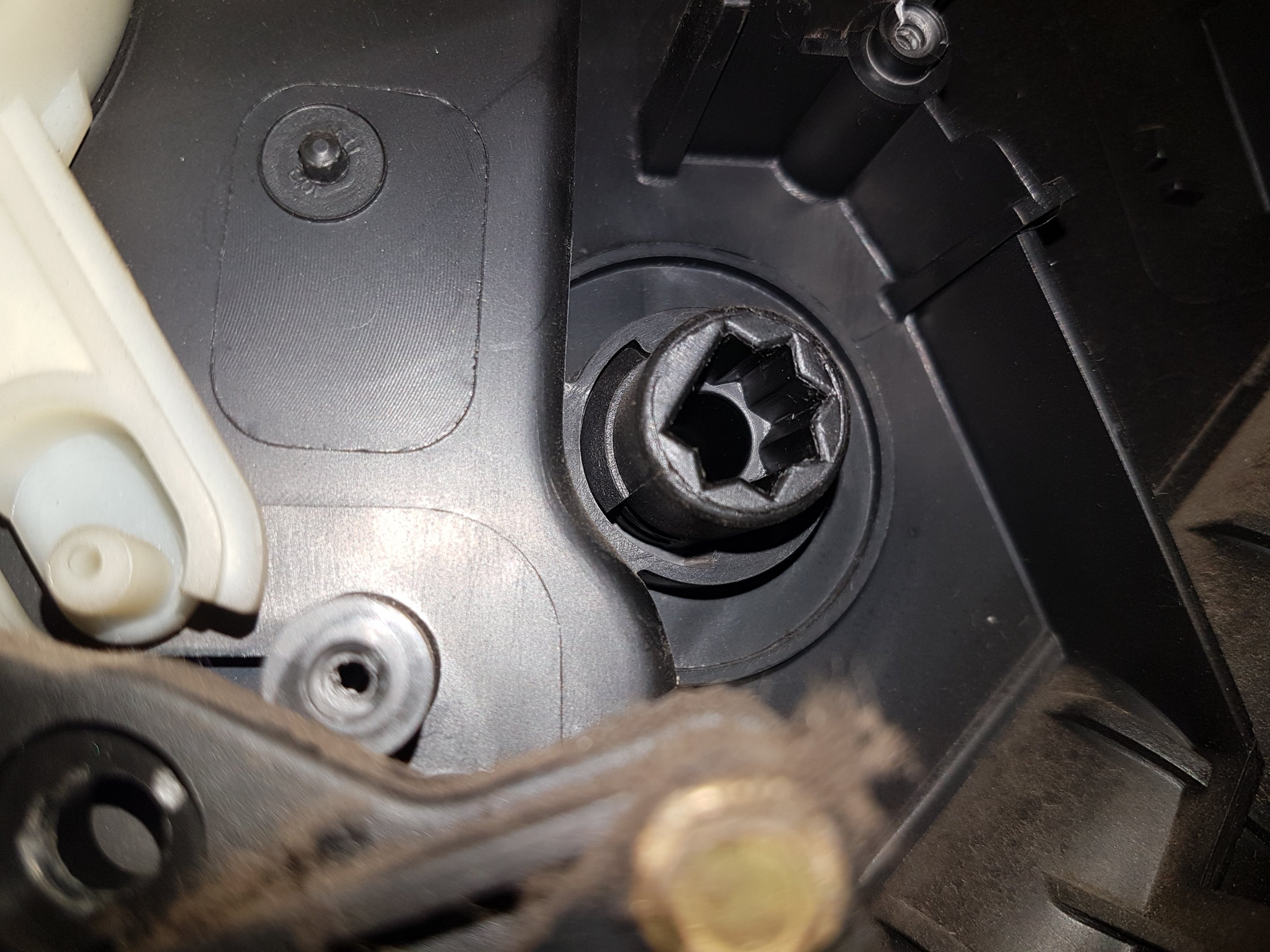

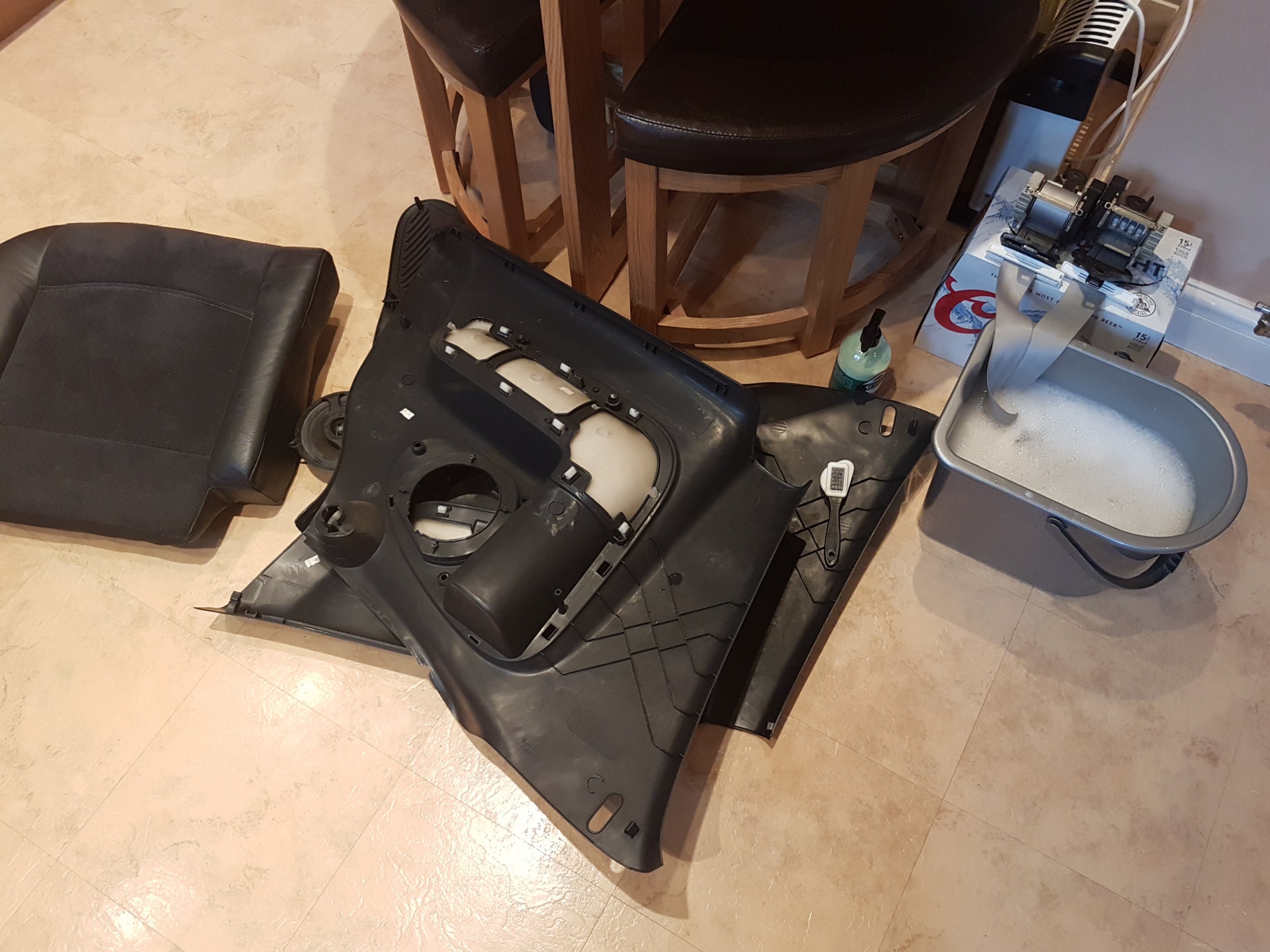

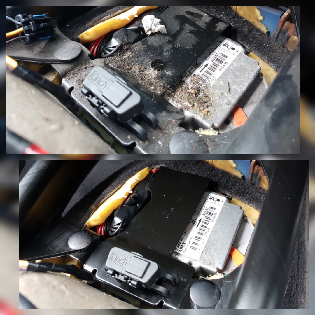

As the Eibach Sportlines haven't arrived yet I thought I'd take the driver seat out to clean and dry the carpet and sort the airbag light.
Well guess again, bolts in inaccessible place under car = easy, stupid plastic clip under seat = stops me.. Ran out of time and didn't want to force it, but how does one open this clip??
Got George out anyway and just dried the carpet as well as I could, definitely need a bit of a scrub next time!

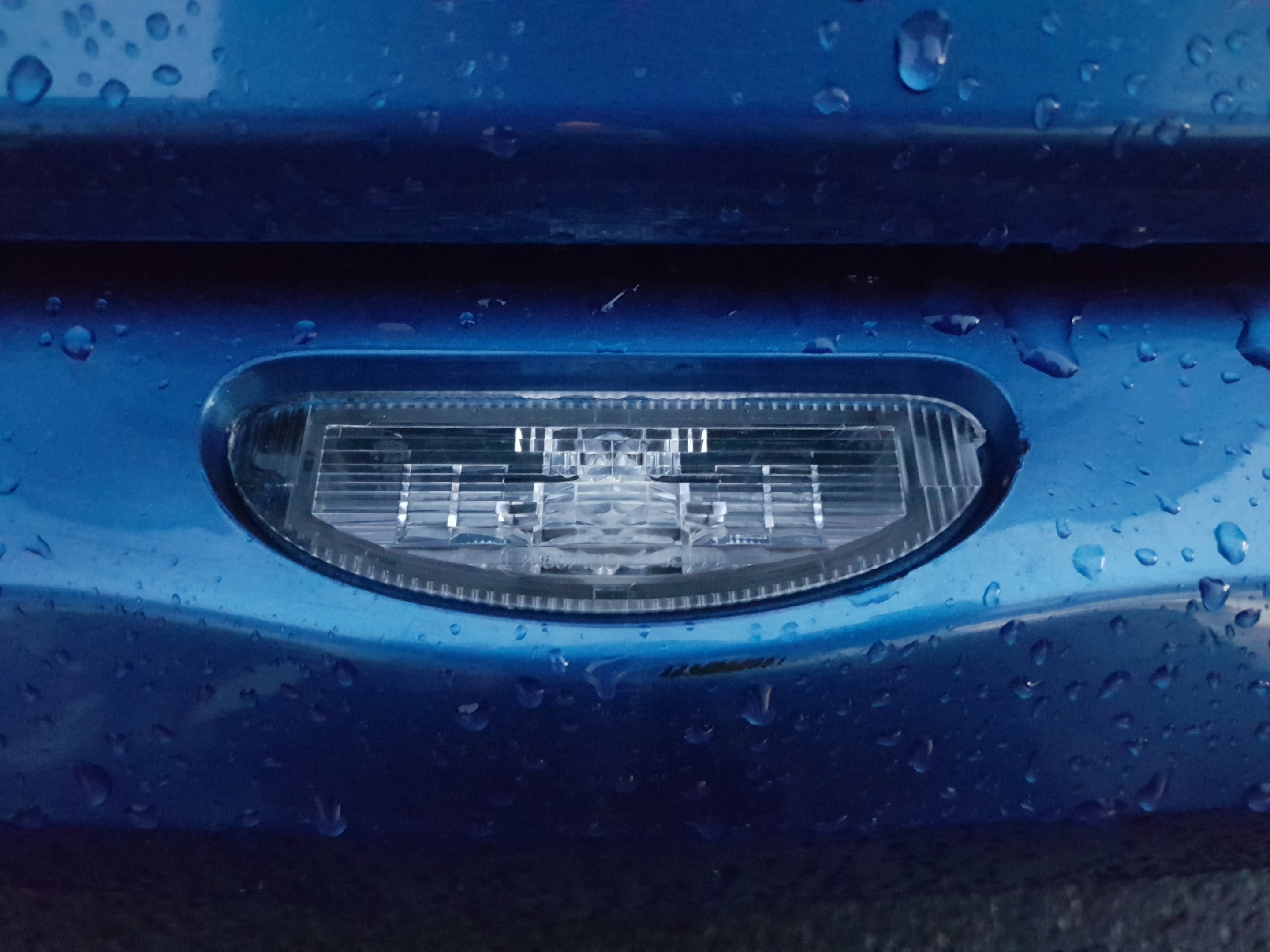

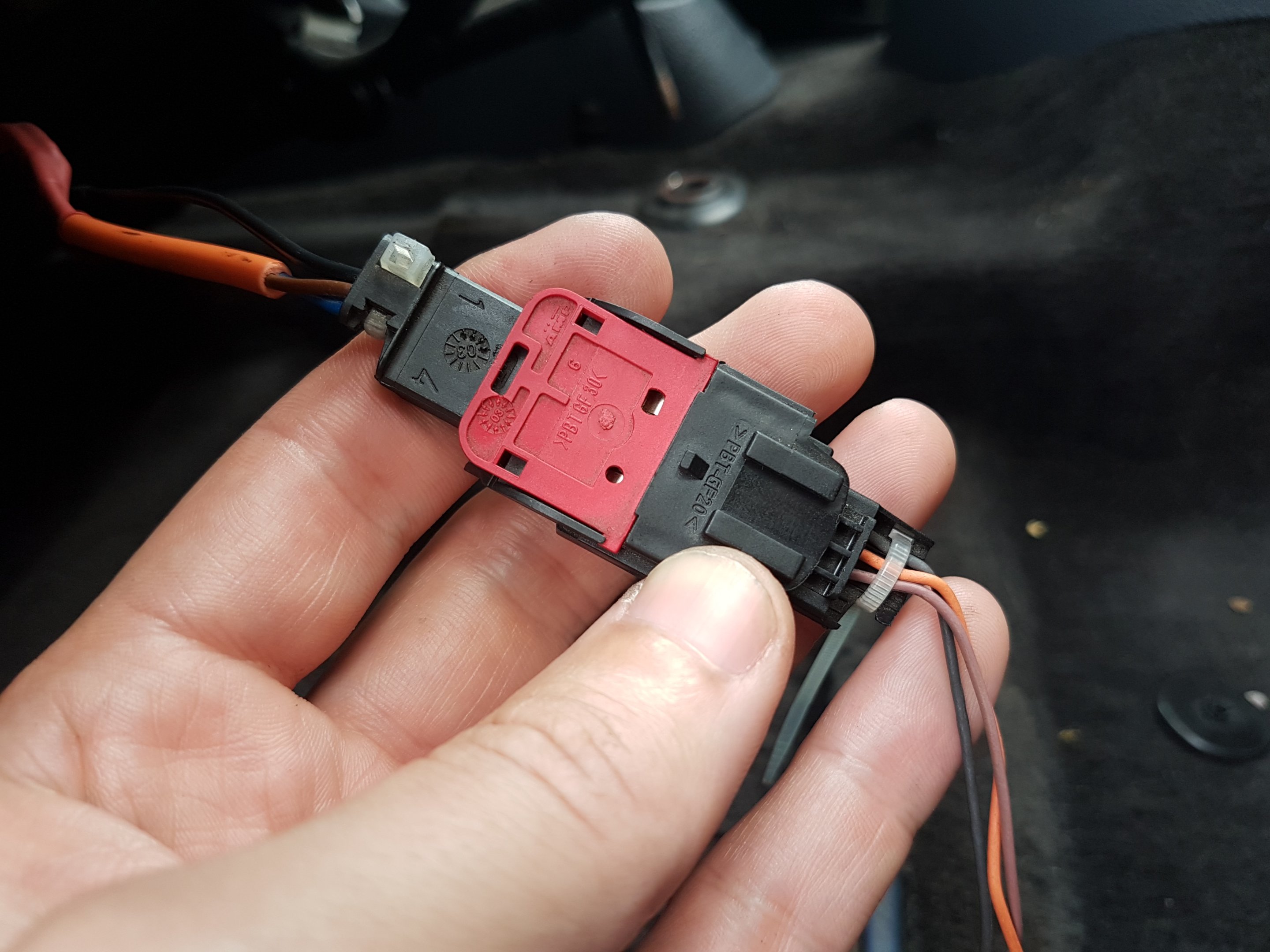

And lastly popped out the number plate light, it's plastic is faded and yellow but it was just a loose connection so at least it's working now.
MLB
I'll have a look, thanks! It was a faulty connection so at least it's working now but the plastic look yellow and faded. Another thing on the order list!

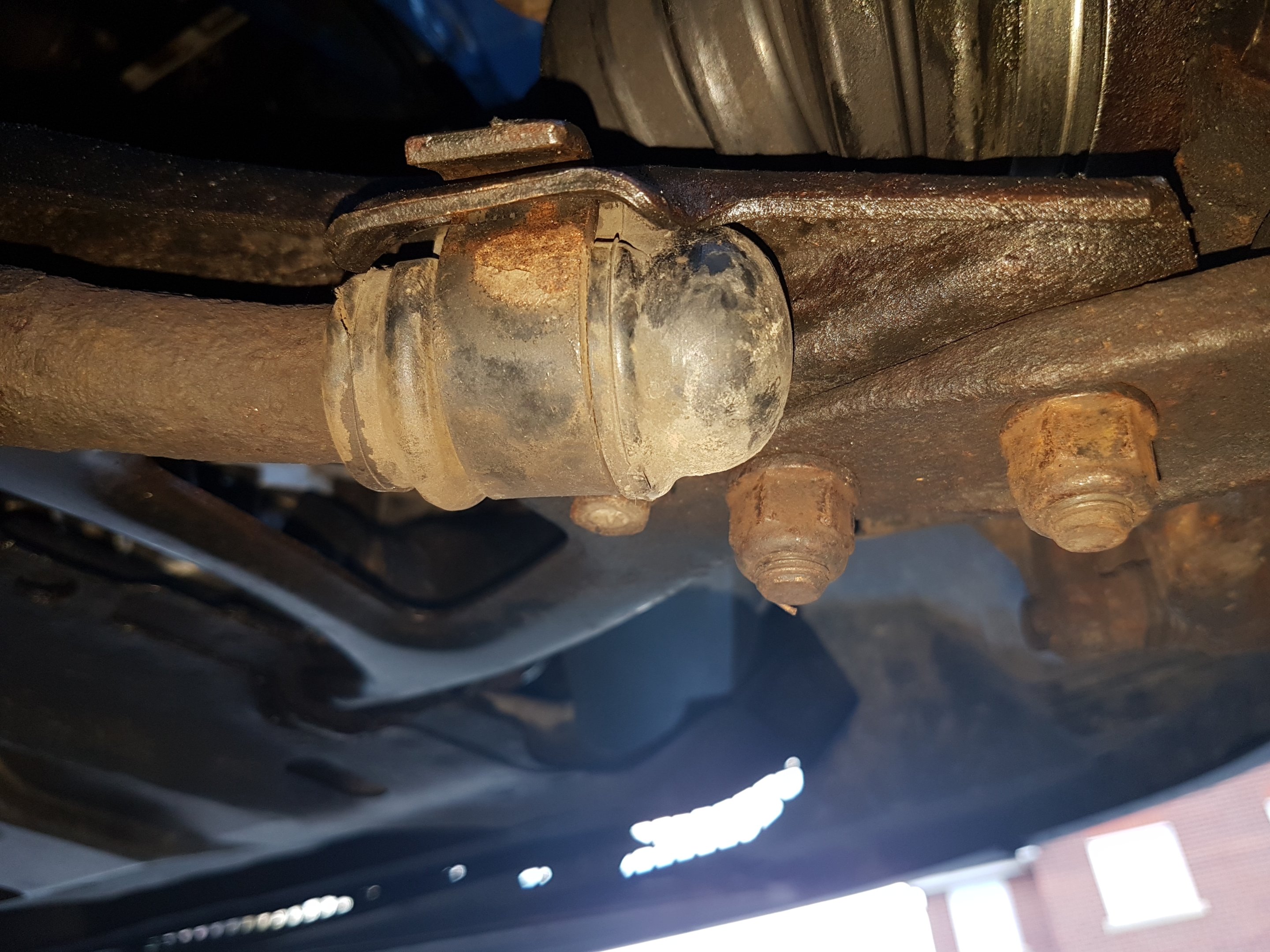

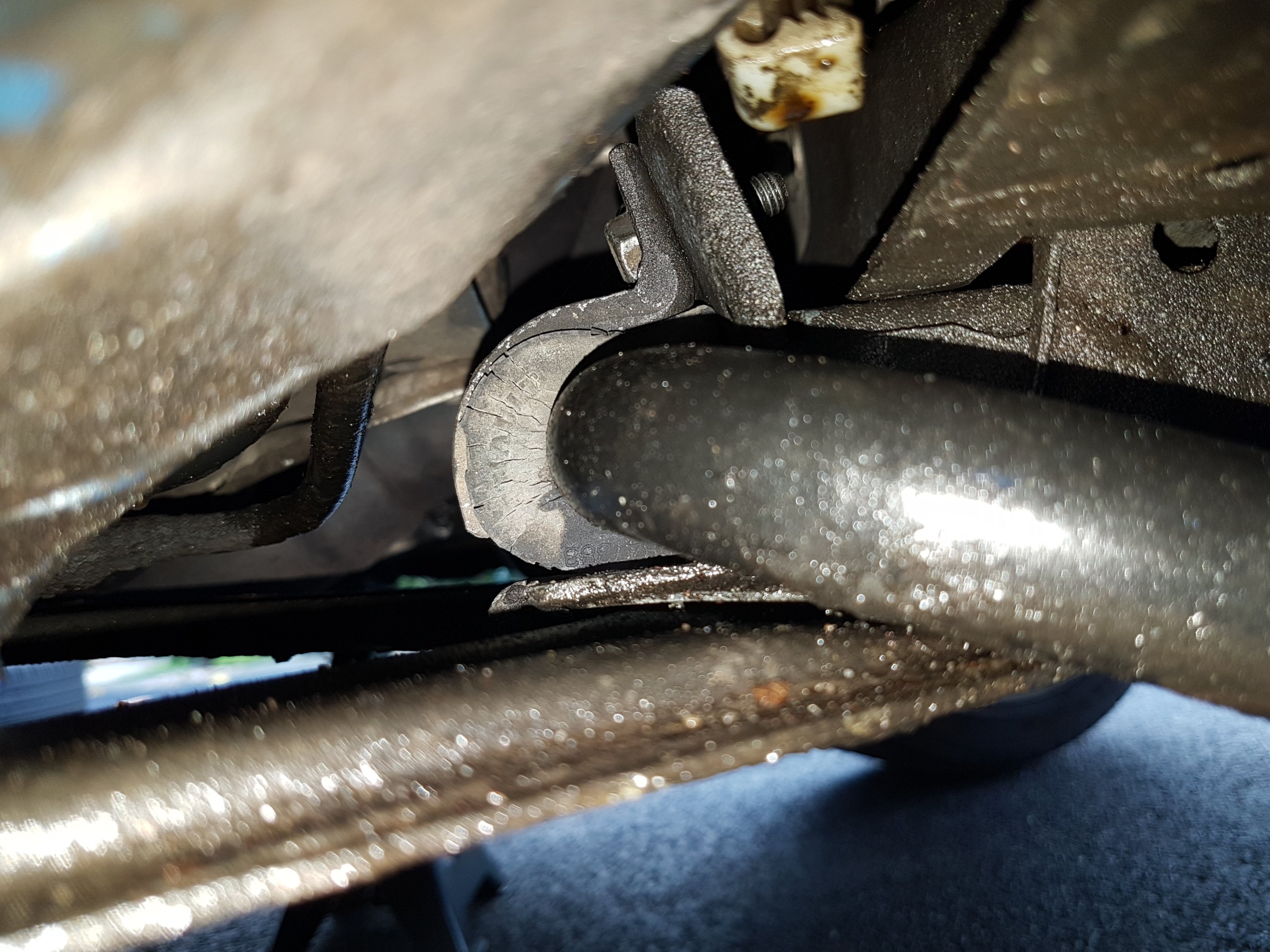

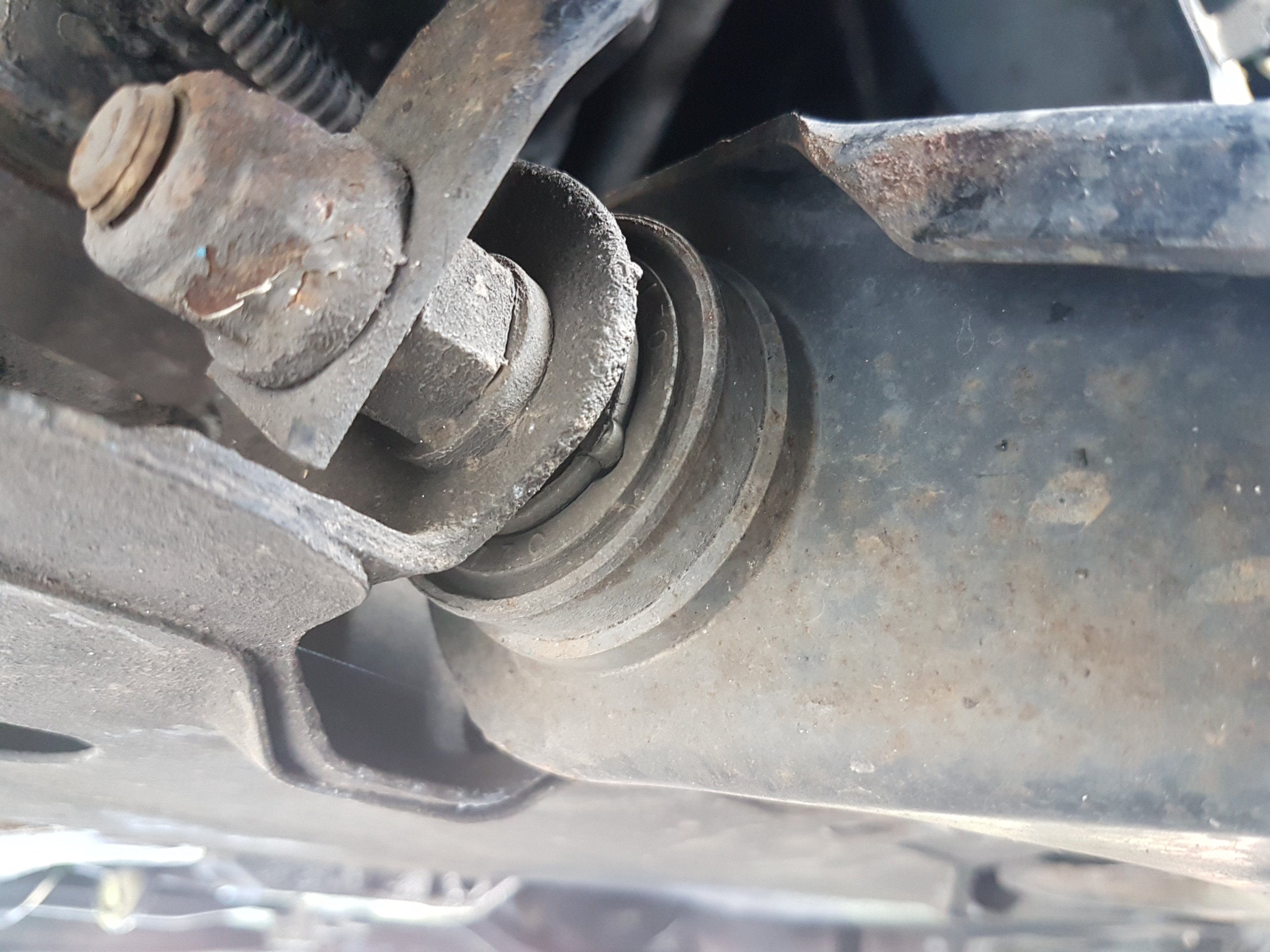

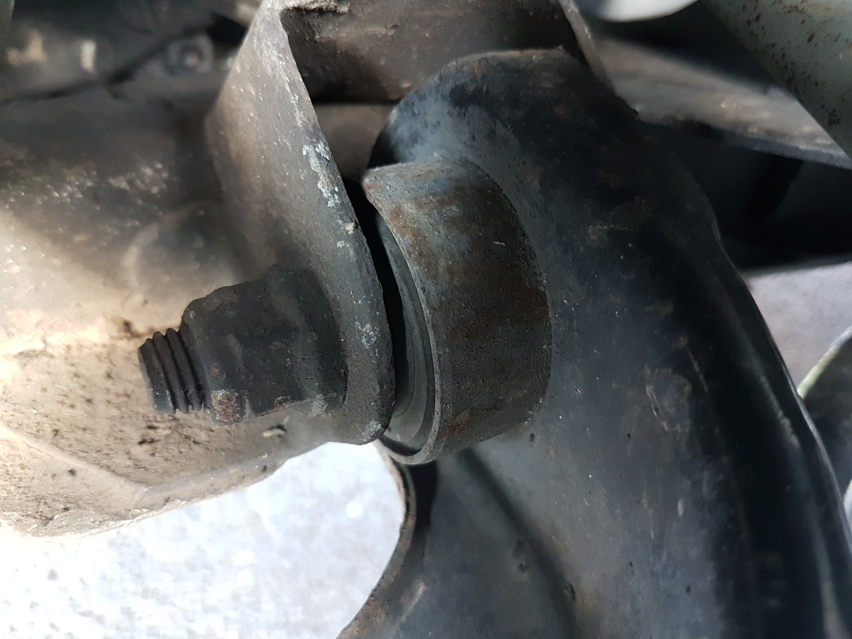

My main goal was to check bushes and brakes but getting underneath the car I realised that I have no idea when something is worn and has to be replaced.. So I'll just be posting pictures and hope the nice people who do know anything about cars can help!

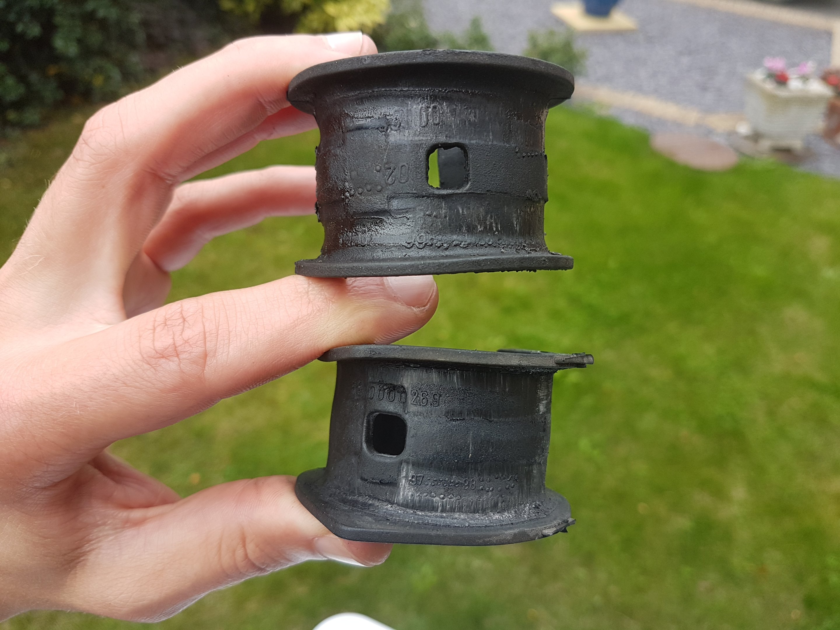

ARB bushes, my guess: replace!

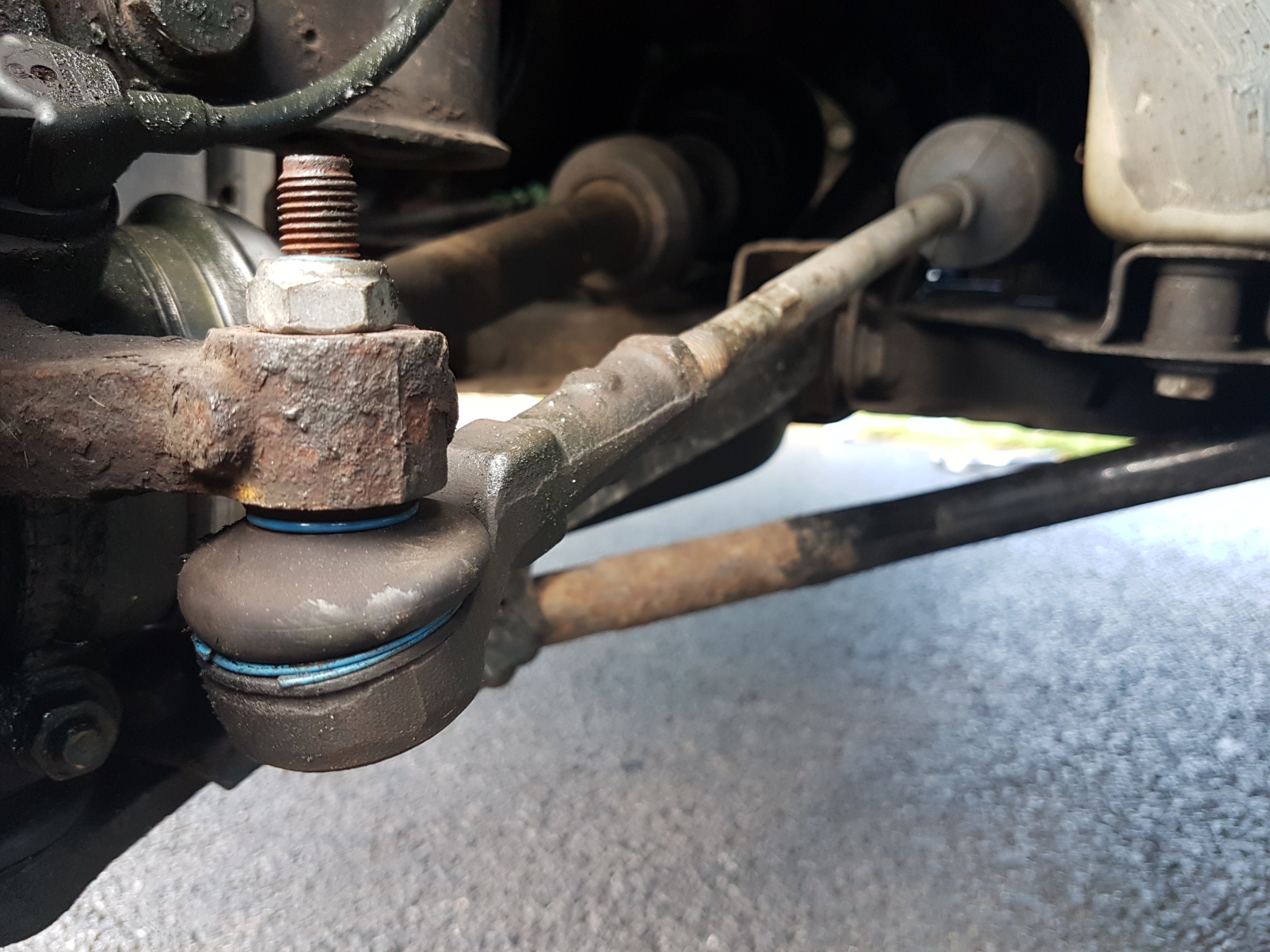

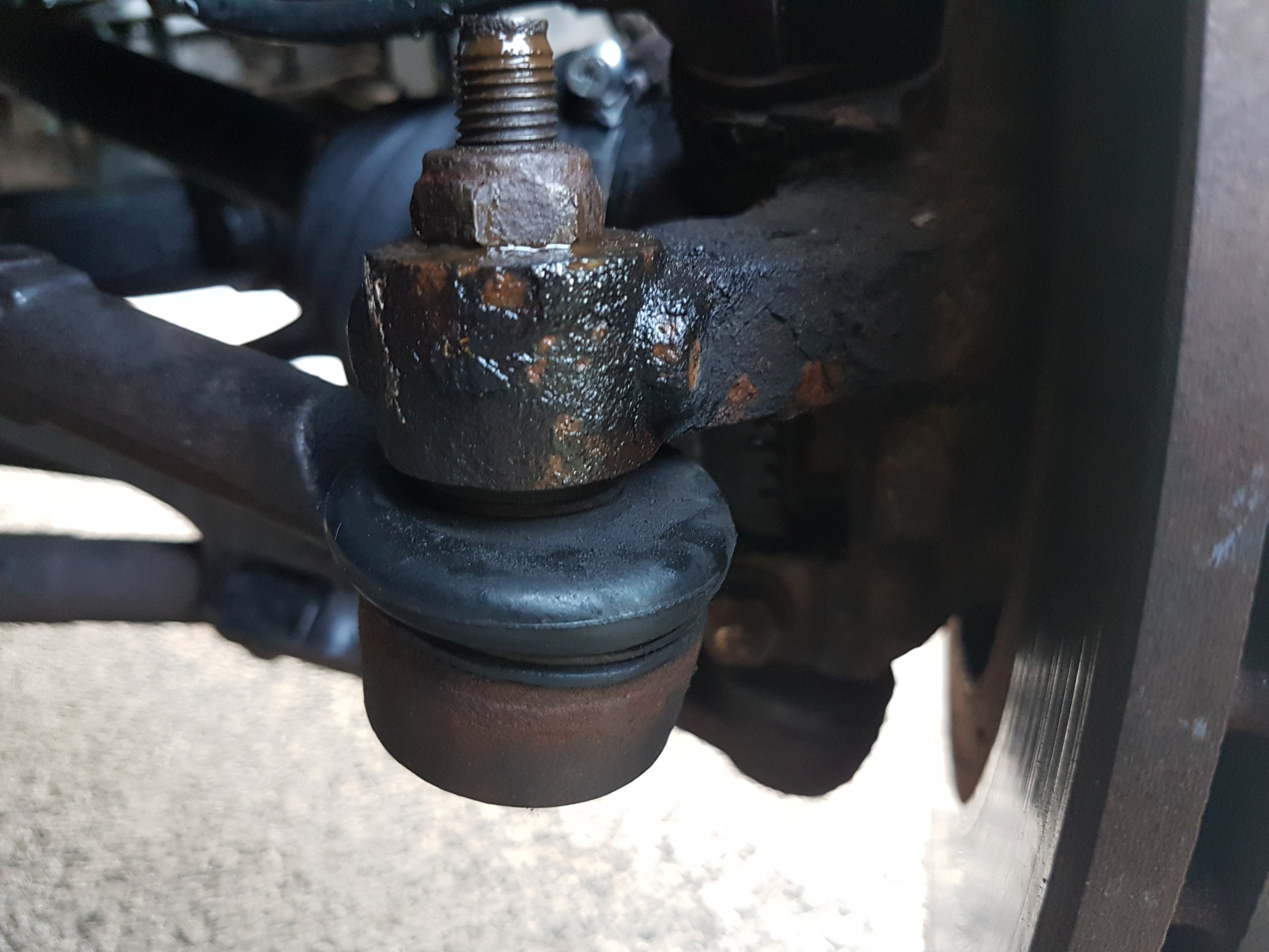

Seems like two different track rod ends, is this bad? They still ok? Seems not to have a lot of play in them.
Wishbone bushes, seem OK.

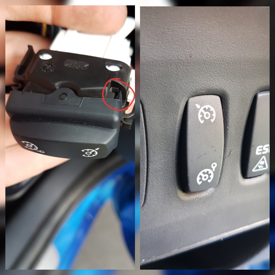

First off, the cruise control button wasn't staying in place so bent the metal pin in the switch a bit so it now works again, my kind of job this!

ARB bushes are a pain to change unless you have a ramp in my experience.

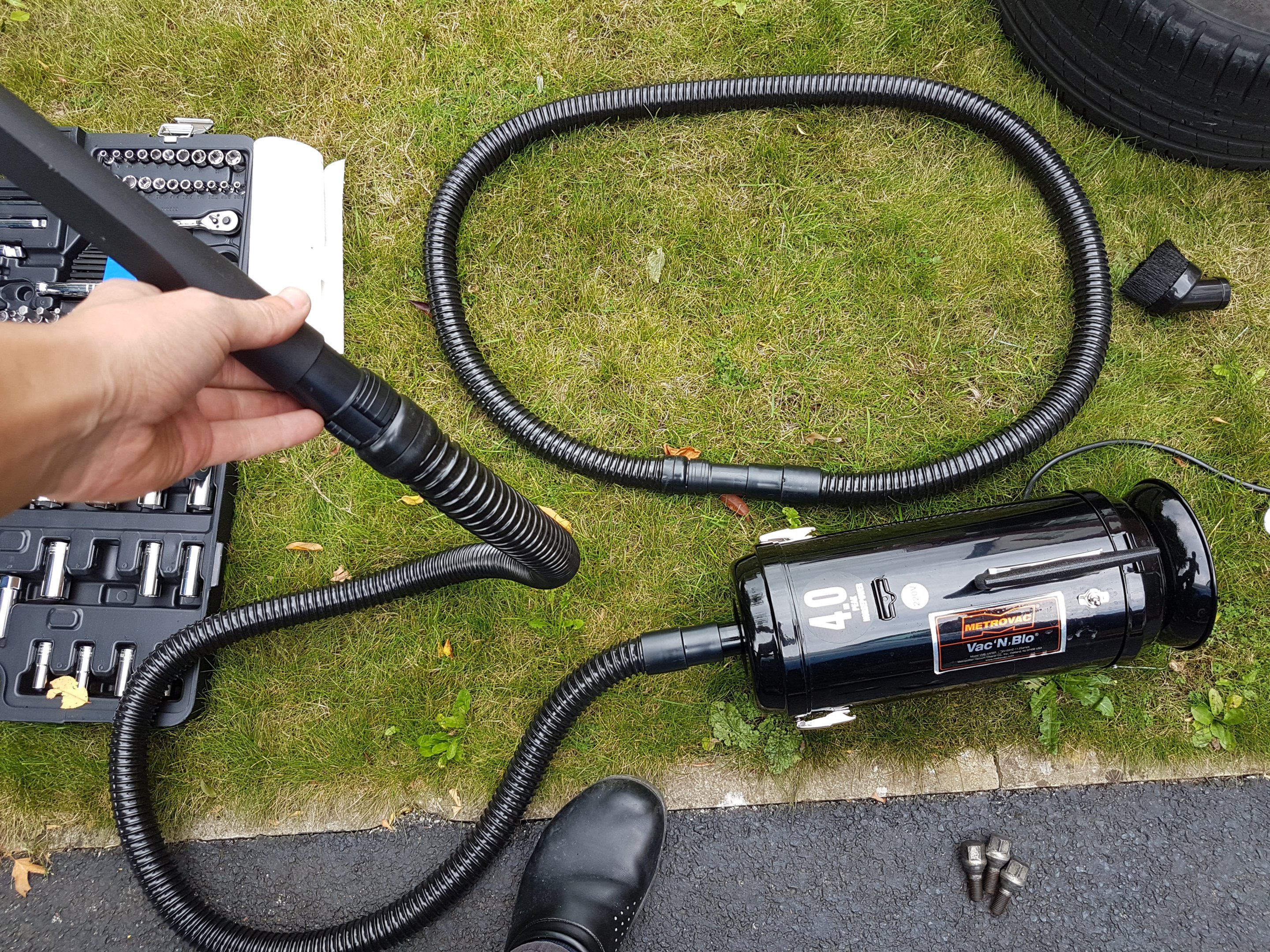

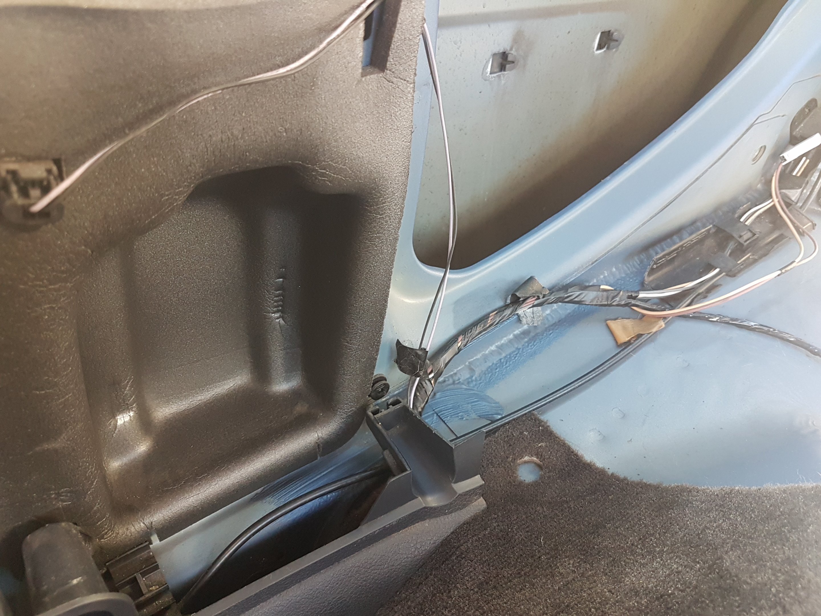

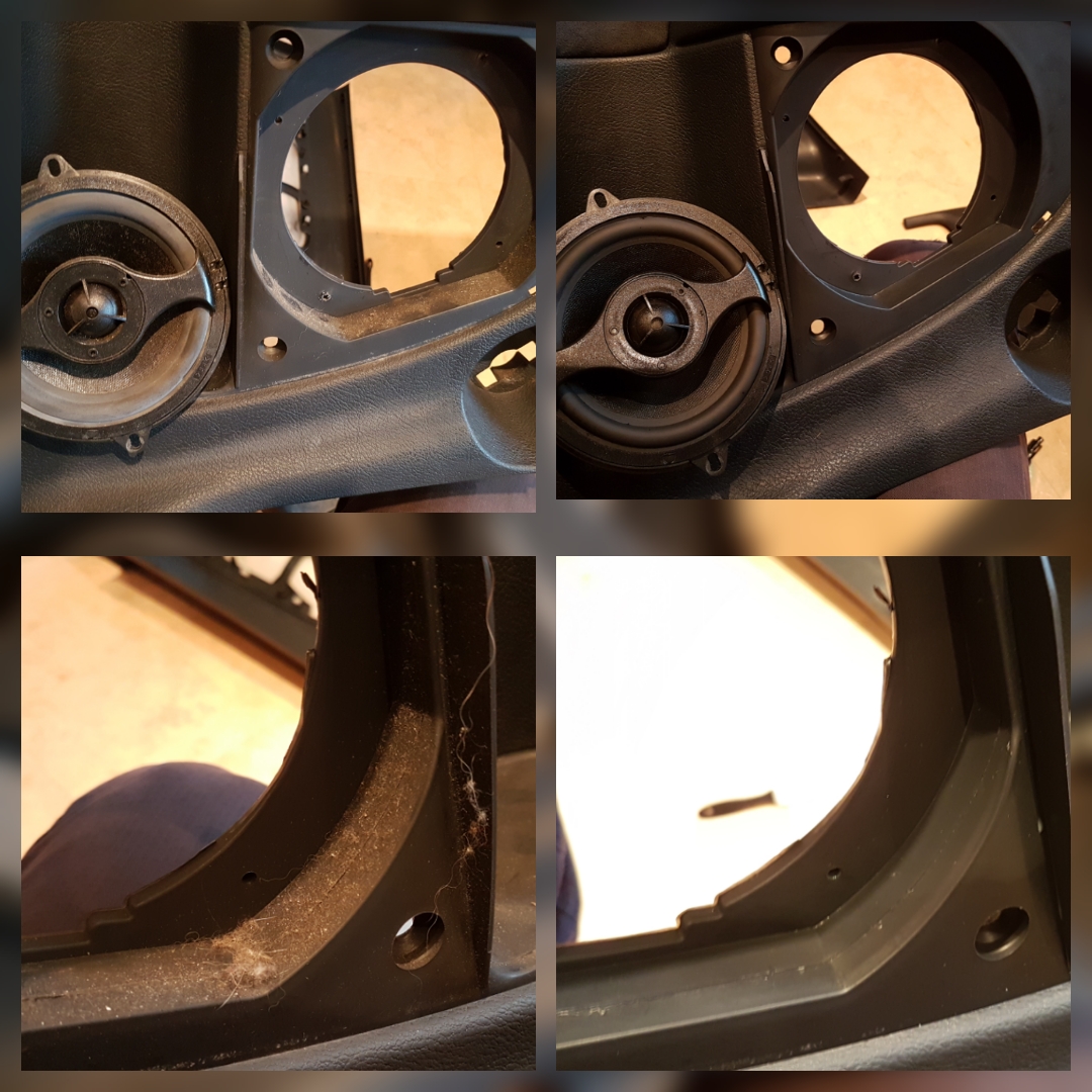

While working on some things in the car I couldn't resist getting a couple of my detailing products out, it's just plain filthy inside..
First off, hoover! It's actually a really nice pice of kit once you've figured out how to attach the hoses..

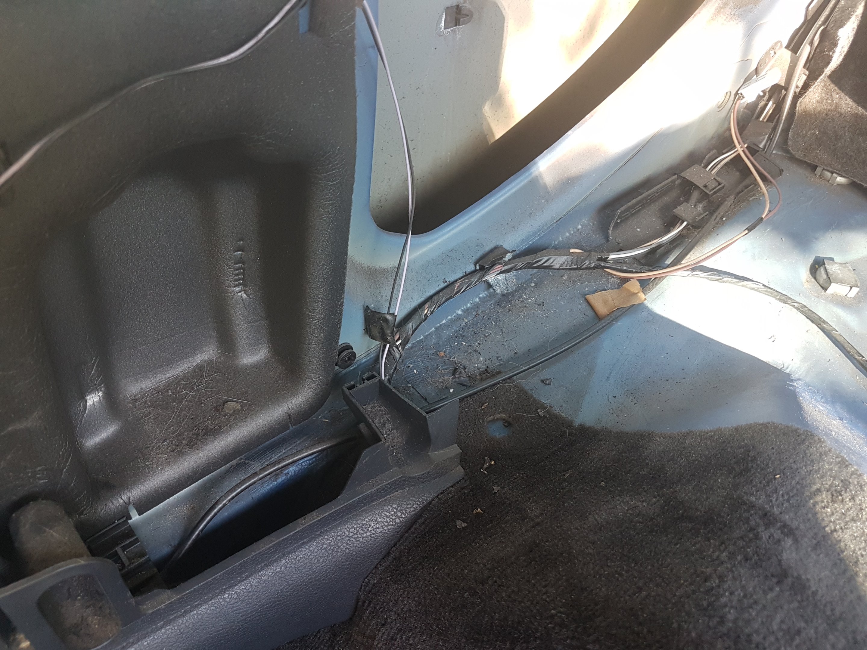

Couple of before and afters to give an indication of what happens when you don't care about cleaning once in a while :
50/50 with 14 year old dust behind the panels
My wife loves it when I clean, it means there's not only half a car on the drive but also half a car in the kitchen

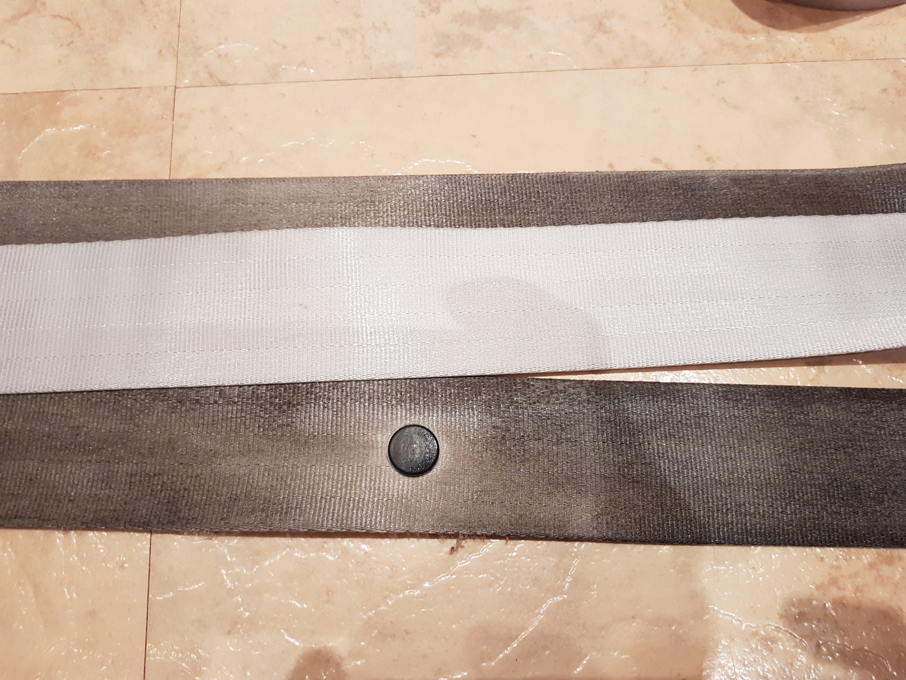

Beer helping with the truly horrendous seat belts:
Want to know what they looked like? Enjoy:
And last but not least a parcel arrived with the number plate light, thanks @Dr Jekyll !

@Dr Jekyll I have found a couple of threads regarding the ARB bushes being a pain to change.. So that'll be a lovely couple of hours on my back under the car. I can't wait..

So put the interior back together again, car smells nice and clean inside now and has silver seat belts again.

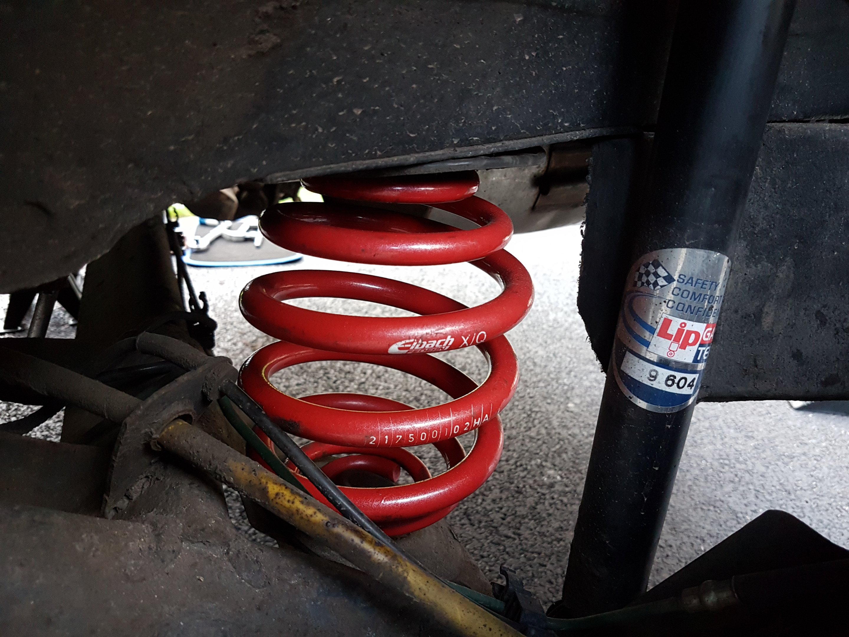

Got the rear Eibach Sportlines fitted:

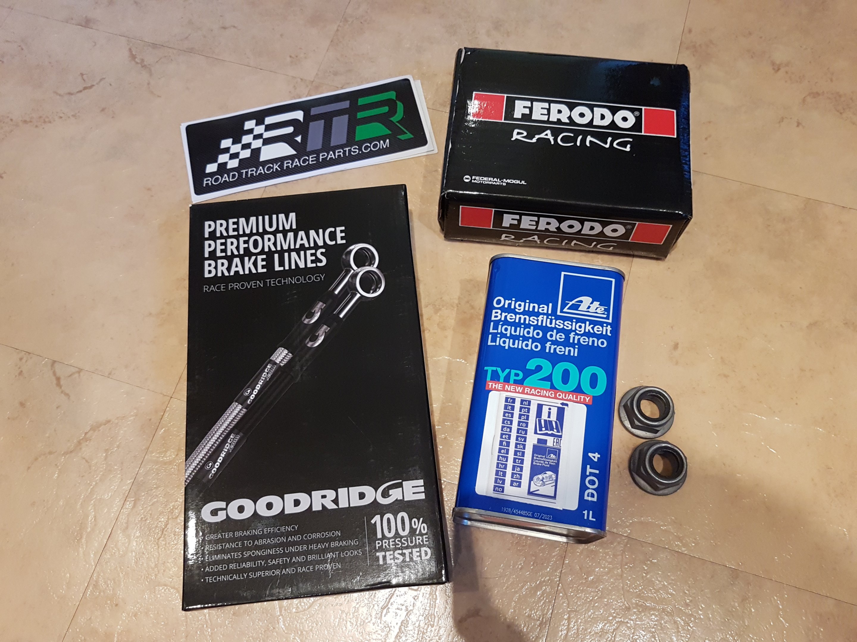

Fronts to go on next week, but waiting for the new top mounts and bearings and eibach camber bolts to arrive. Saves me getting everything off the car twice.
And next week I'll be installing all this goodness. Big thumbs up for @George@RTR_Parts for being so patient with me and my many questions. Great service and quick delivery, can't wait to see what difference it makes compared to the standard brake lines and pads!

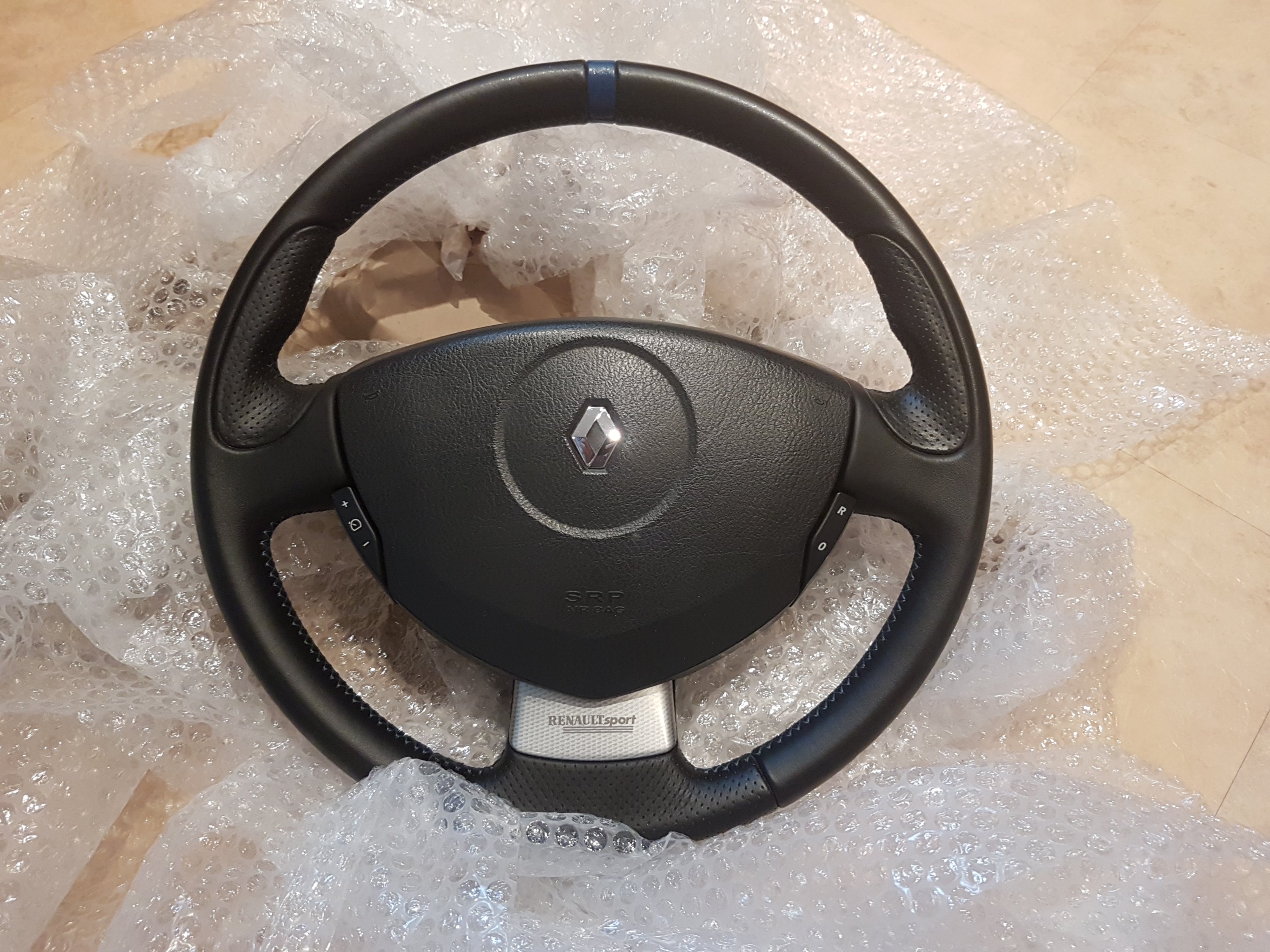

Now time for a cup of tea and then put this gem in, many thanks to @182_steve for the quality product and swift delivery!
I looove bubble wrap!
No problem at all Mike, glad you like it...……. and glad it got there in one piece!!

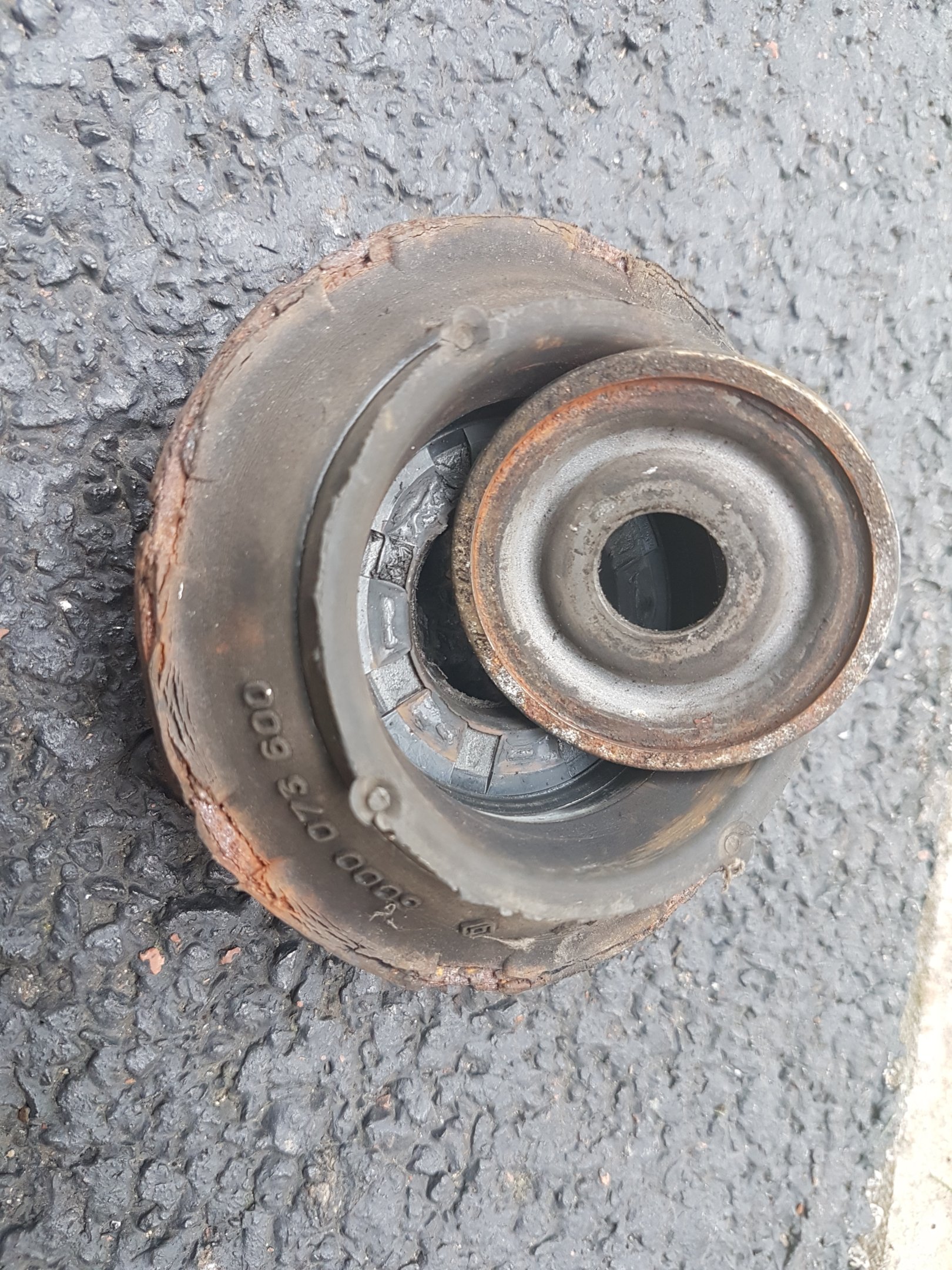

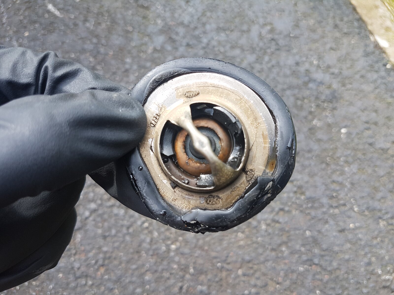

More work done, replaced the top mounts and put Eibach camber bolts in while putting the front Eibach Sportlines on.
Think I'll replace the track rod ends next, they seem to have quite a bit of play in them but got an alignment done so first drive and enjoy the Clio for a bit!

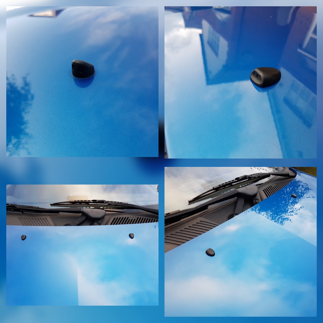

It was looking a bit sorry for itself so gave it a quick wash. Finished with Gyeon wet coat. Not too bad I think!

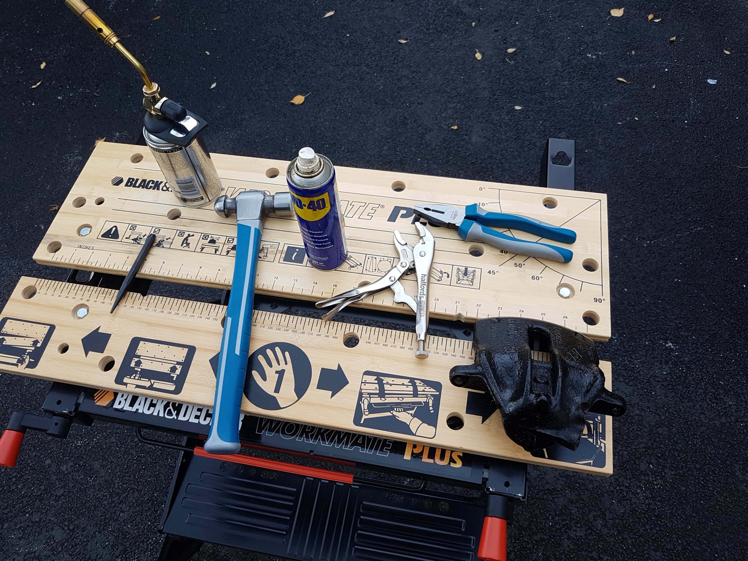

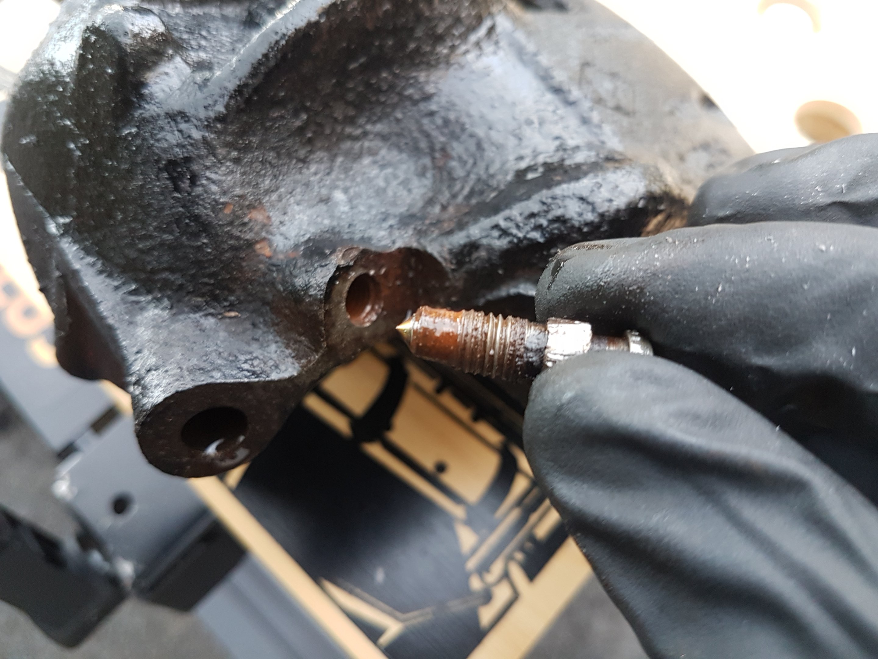

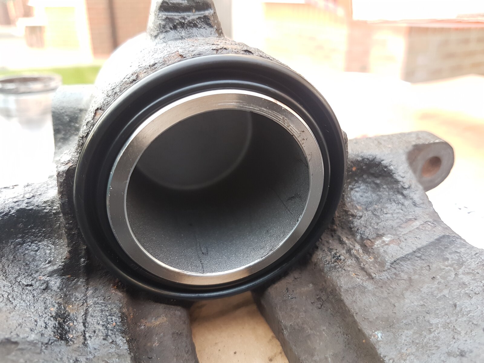

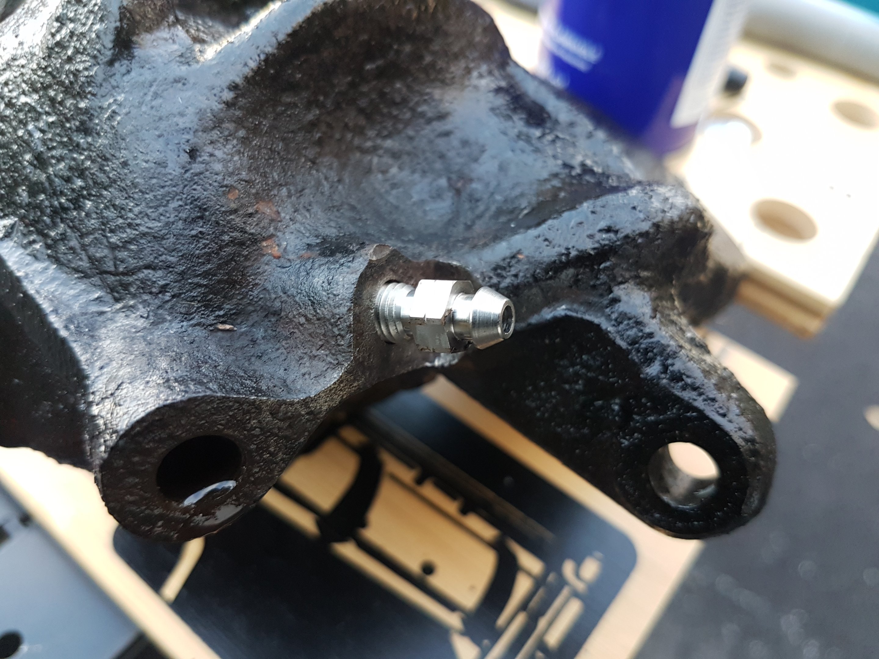

One step closer to the Clio having brakes again. Took everything off, first bleed screw came out instantly, one rounded off and two sheared off so my suspicion of no recent system bleed has been confirmed.
No proper tools didn't help either so after a couple of hours struggling with cheap stuff I gave up and ordered some Halfords advanced tools.
Shiny new tools!
No wonder it didn't want to come out..
More shinyness!
Expecting my left turning drill bits to turn up this weeks and hopefully replace the rear bleed screws next week.

Decided to replace the rear brake calipers instead of sorting the damaged seals and rotten bleed nipples.

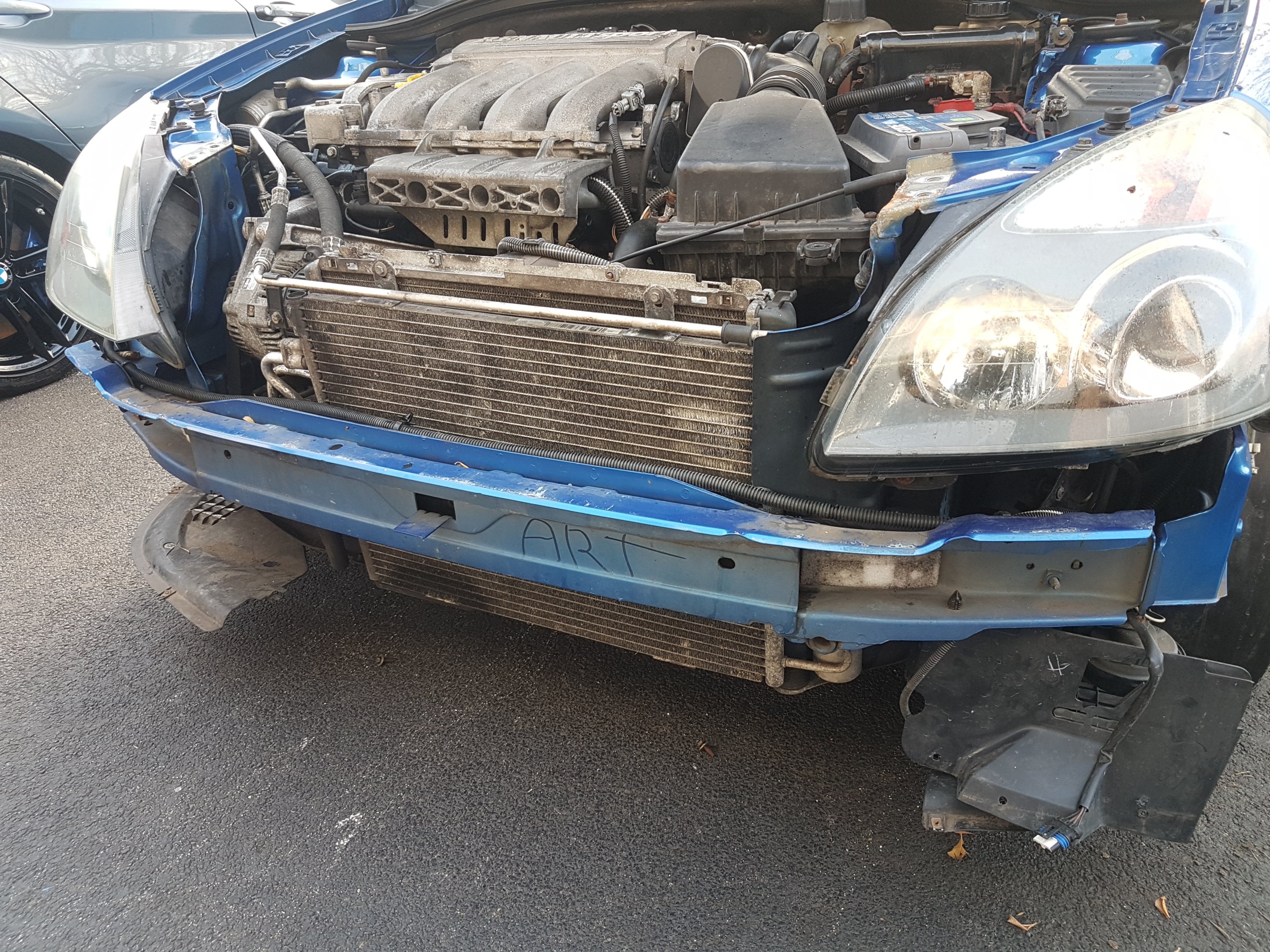

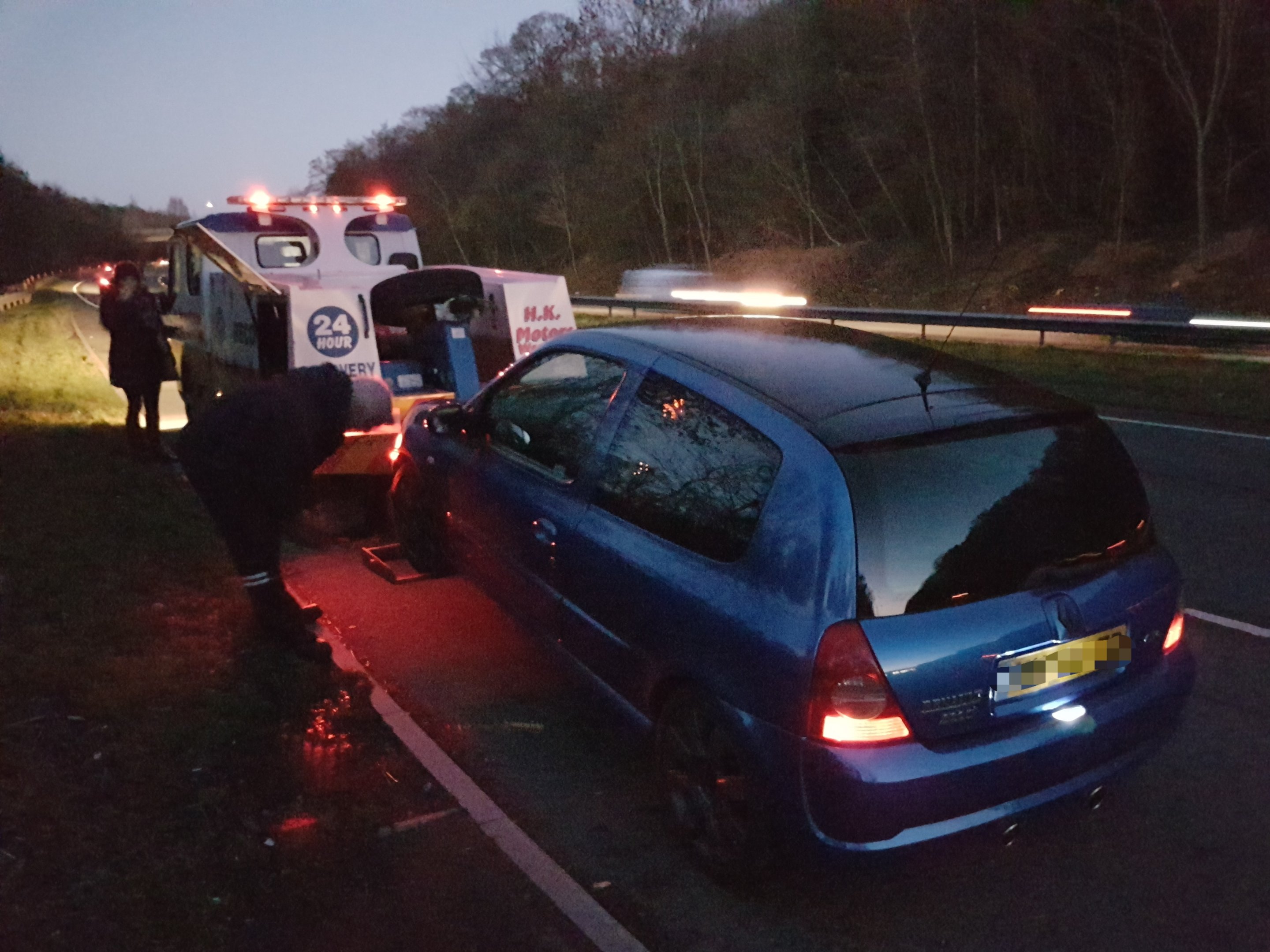

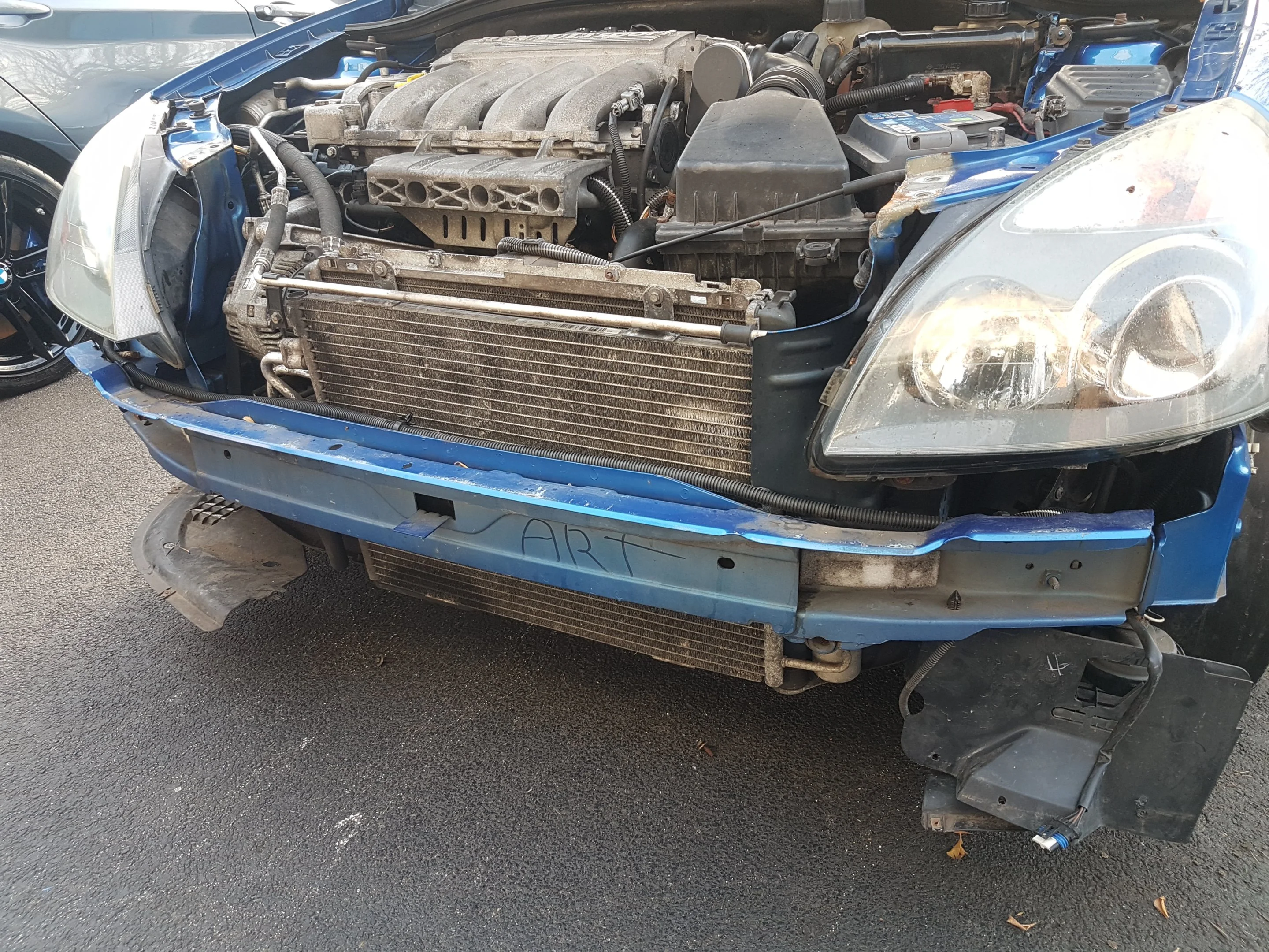

Ordered a new alternator and took half the car apart but found the main retaining bolt missing.. The whole thing had been held in by one bolt and the tension of the aux belt.. New bolt ordered but snow and work meant the Clio (kindly renamed 'the shed' by my wife) sat on the drive in parts for a couple of weeks.
Told her it's not a shed, it's Art!
1409520
So, Art needed an MOT end of February. Fitted the new alternator, replaced both washer fluid pumps and fitted new wiper blades.

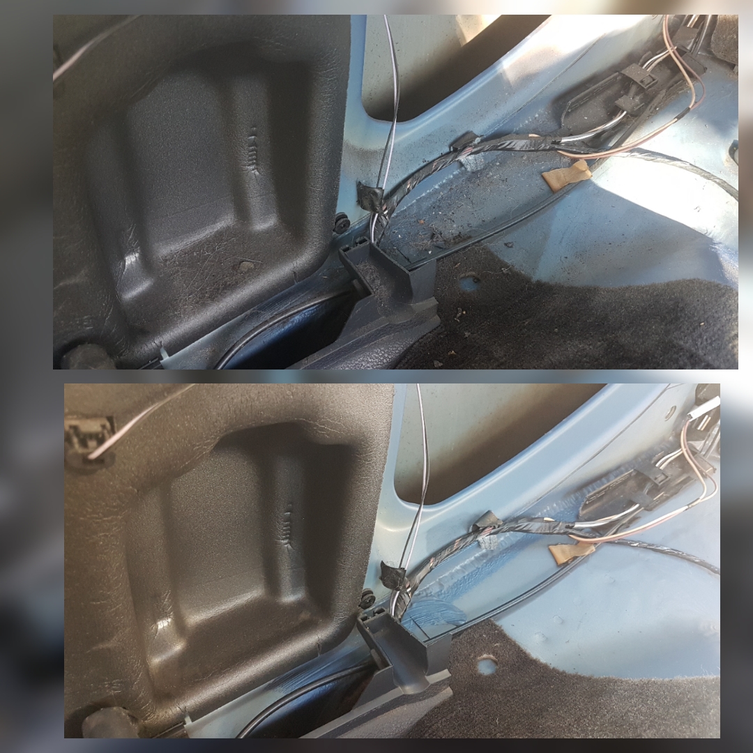

Thanks! Don't have any pictures of the whole interior really. Most of the cleaning was behind panels to get the car to smell fresh again. Still need to get an alcantara cleaner for the little bits in the doorcards. Waiting for some warmer weather to take the seats out and redo the carpets with the extractor as it won't dry in the current weather.. To give an idea of what I've cleaned:
Before
1409663
And after
1409664
Just keep at it with a couple of brushes and cheap cloths and you collect a couple of buckets of black water from cleaning behind seats, under carpets etc.
1409666
Didn't remove the rear belts as they were fairly clean but the fronts were quite easy. Just remove a couple of bolts, twist and turn the bottom rail out of the plastic sill and they're out if I recall correctly. Pretty straightforward anyway!
One thing which took me a while to figure out is that when you have the seatbelts out, they don't pull out if not held upright as they lock when upside down.

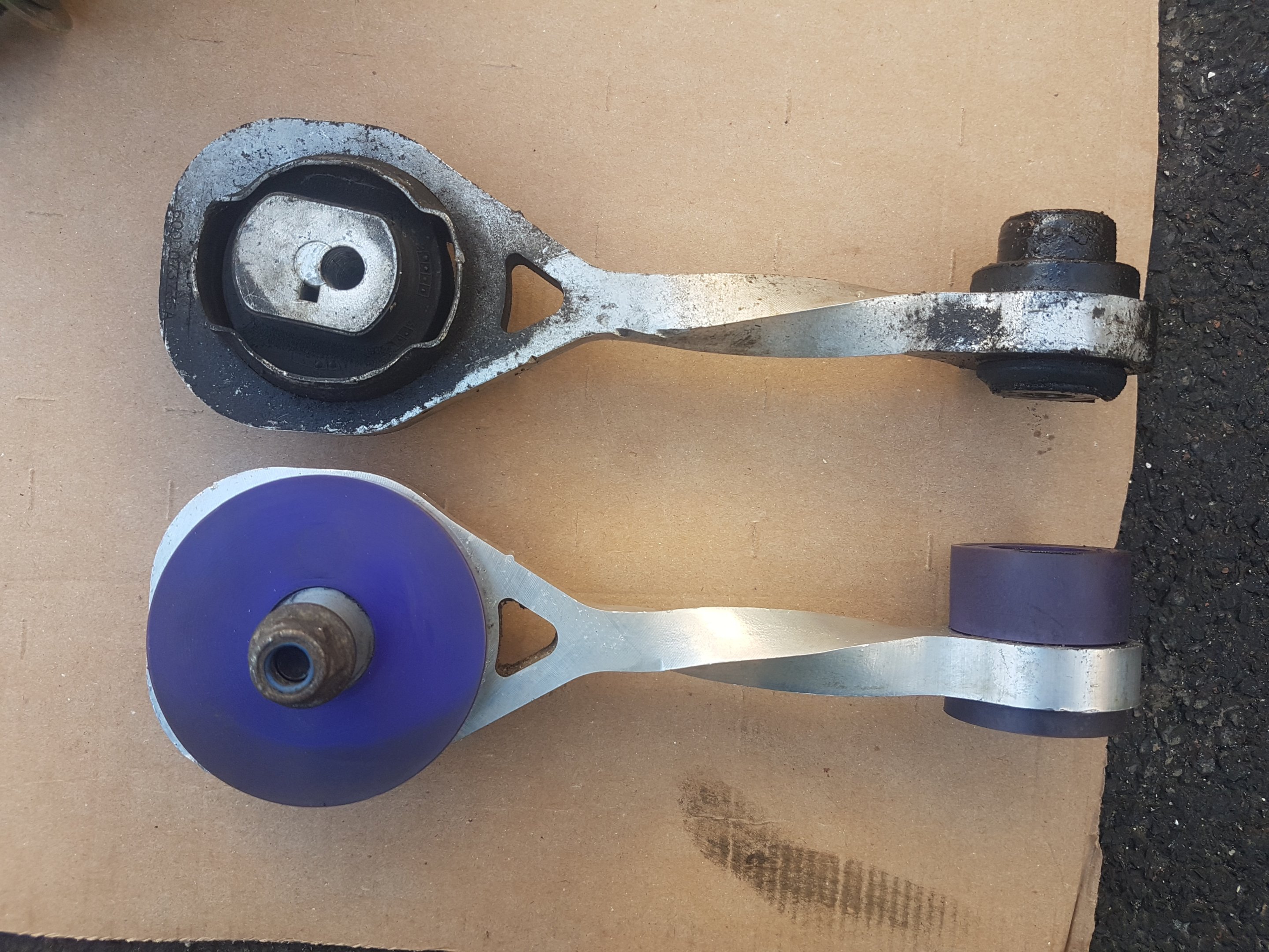

As the weather was finally calm and dry this morning I fitted the polybushed dogbone and changed the pas fluid.
Used the hose and sealant tube trick for the pas fluid, worked a treat!
1409730
Didn't notice a great difference, suppose the old one wasn't too worn after all but with the yanoo kit next at least I'm happy it's all done.

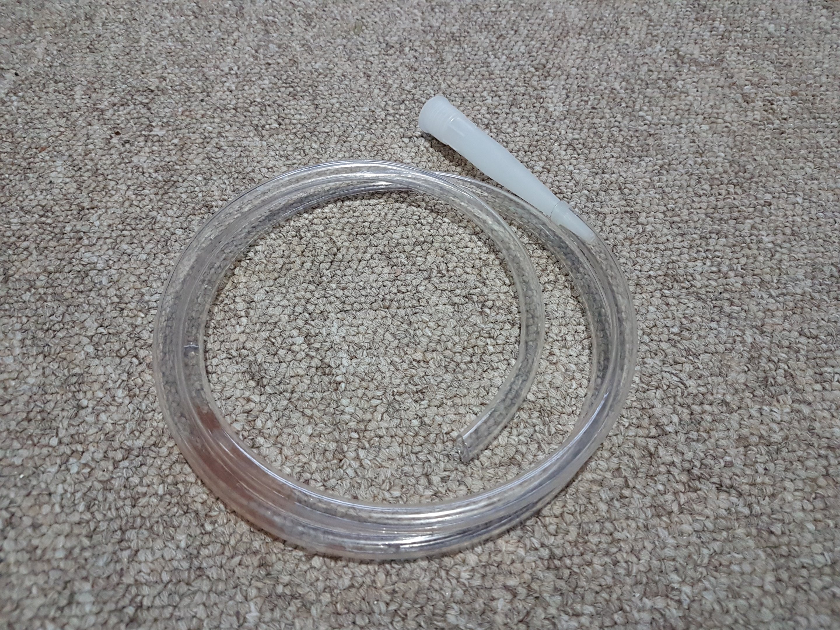

Basically stick a tube down the pas fluid reservoir over the return hole and it drains itself.
1409776
I've ordered some 7x9mm tubing and silicon sealant spare nozzles, five minute job.

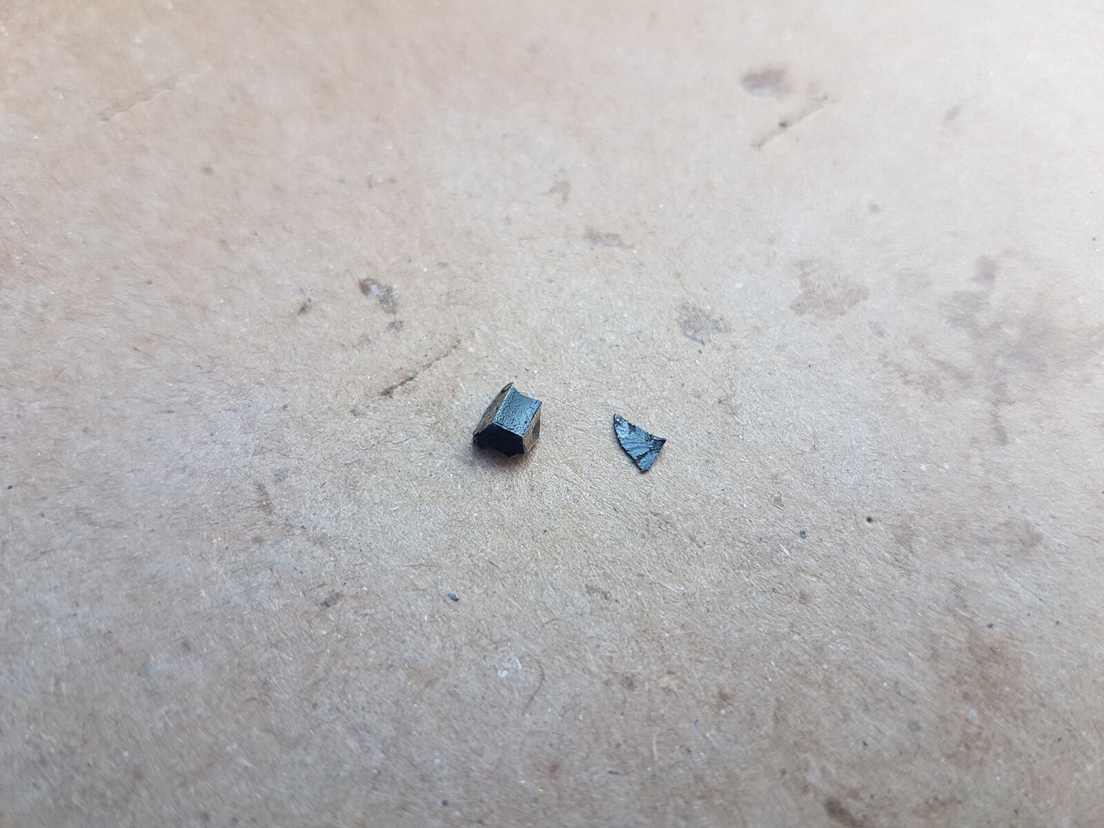

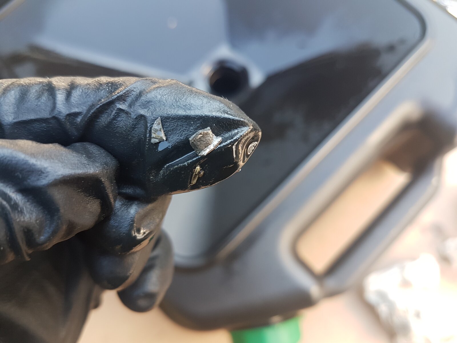

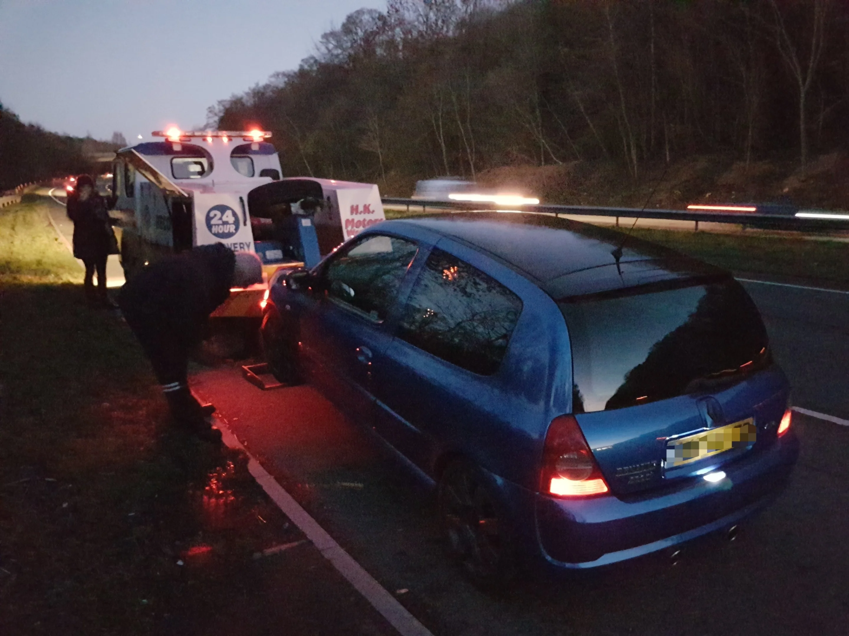

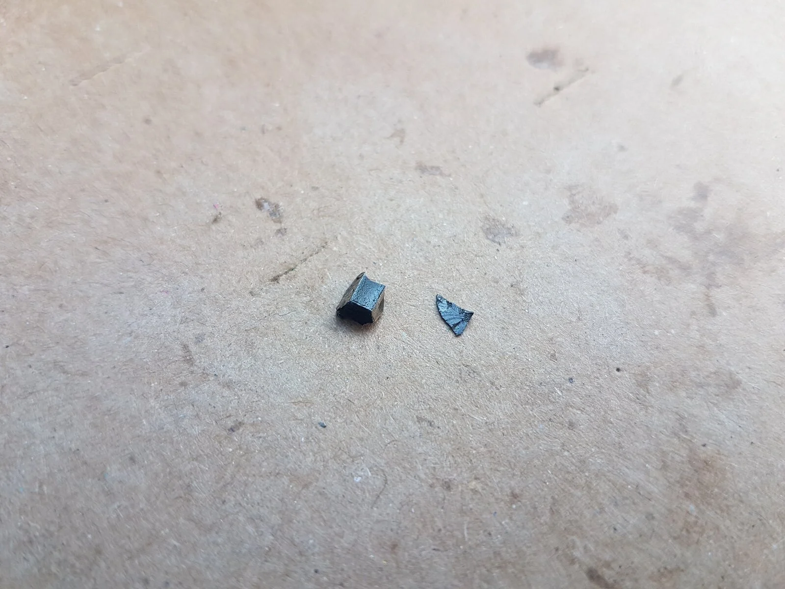

Dropped the gearbox oil a couple of months ago and was in for a nasty surprise..
Couple of nasty bits of metal came out so glad I replaced the oil, but I'll need to get it rebuilt. Will get the arb bushes and wishbones replaced at the same time.

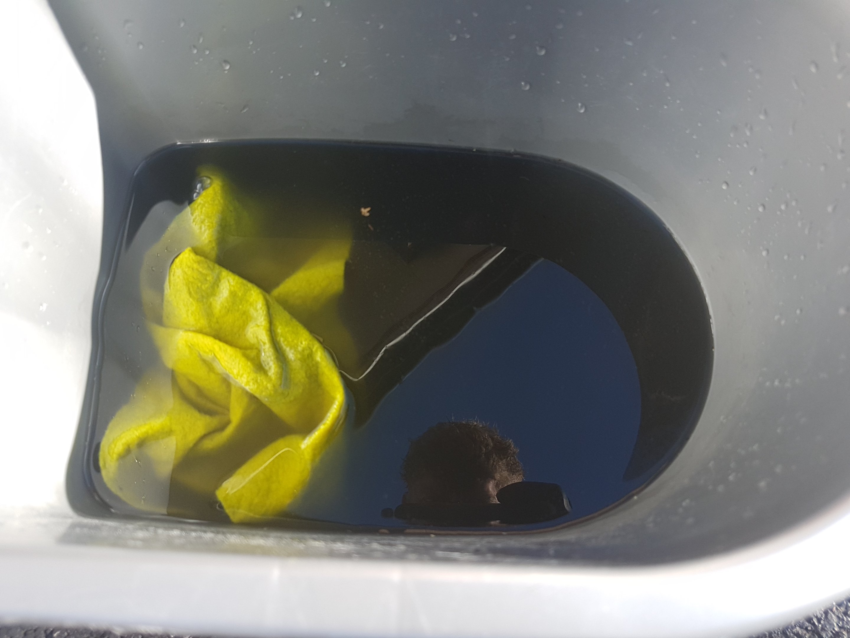

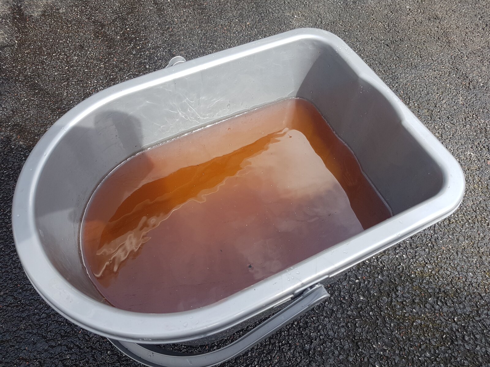

Because of work and the gearbox being knackered I've not driven Art much, but finally got round to doing a full coolant flush and replacing the thermostat yesterday. While it was up I did an oil and filter change as well.
No wonder the engine temperature fluctuated while driving!
Crappy red stuff replaced by the proper green stuff now!

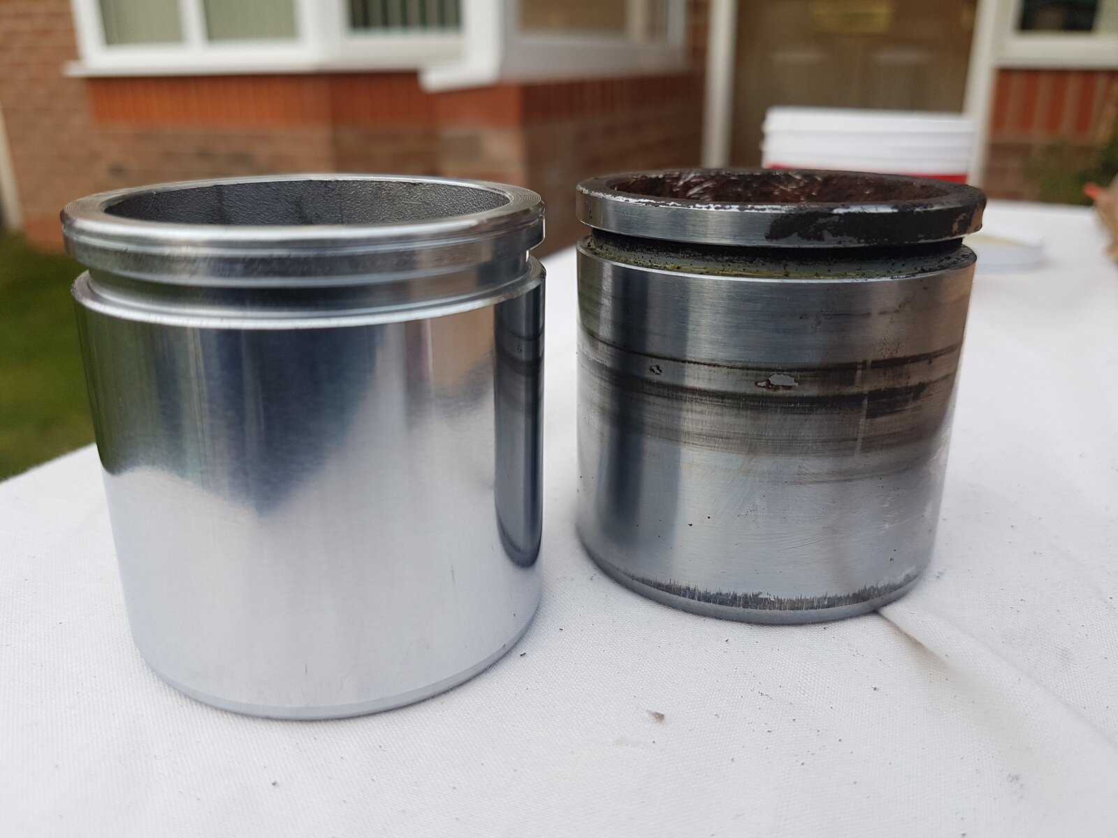

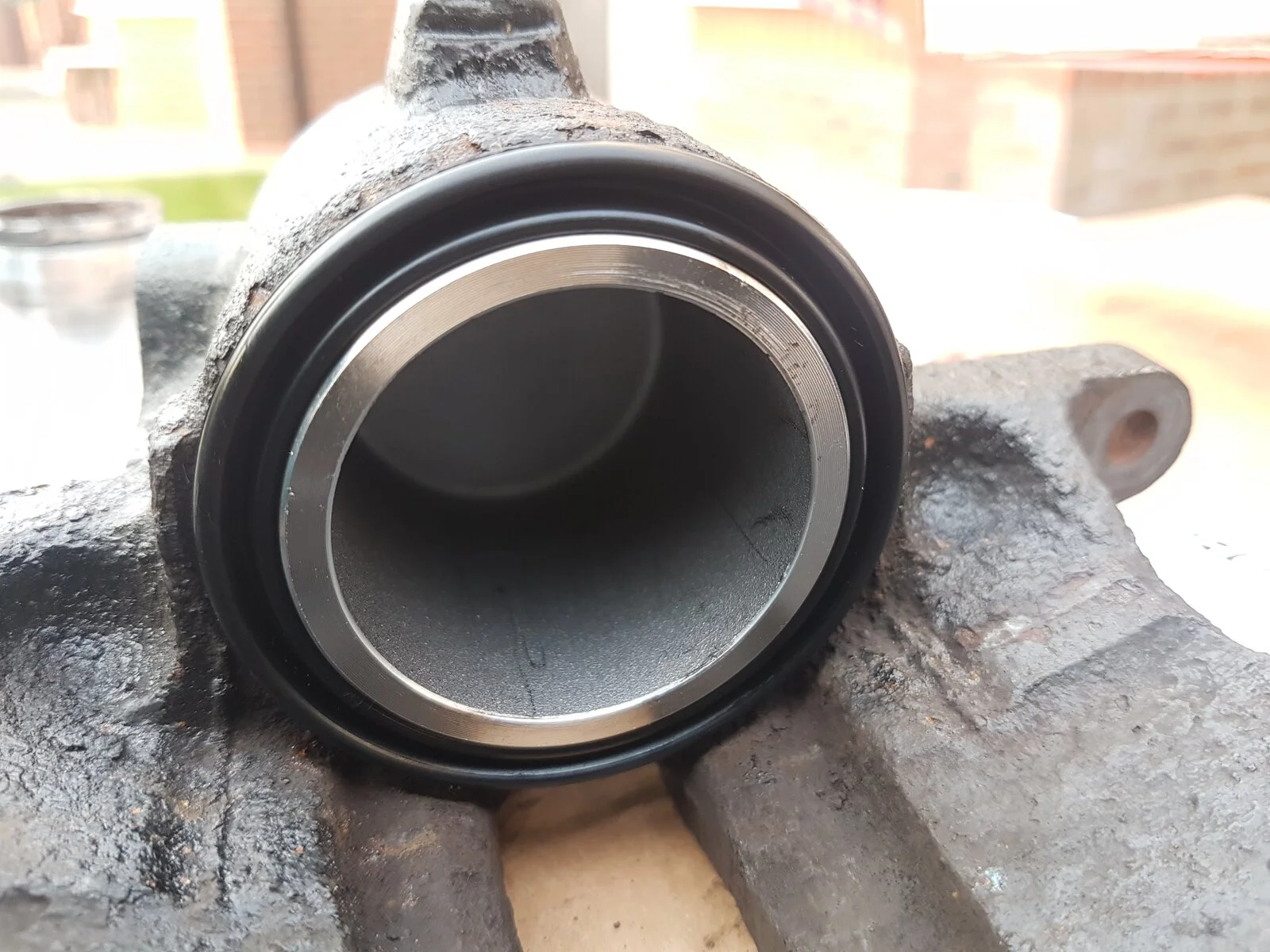

Had lots of noise coming from the brakes and found the left front disc and wheel were way hotter than the right side.
Got a refurb kit and slider pins from Biggred and took the caliper off, don't know why I didn't refurb the calipers when they were off earlier this year for the cost of it but done now anyway, hope it's sorted it and it's not a bearing on its way out!
