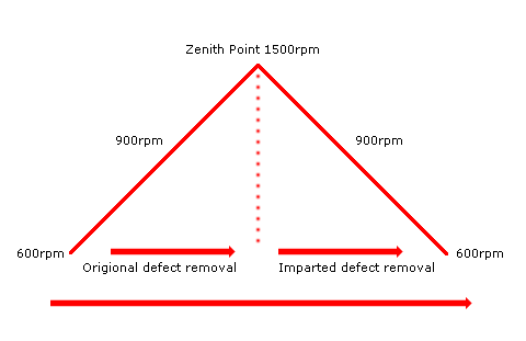

If there is marring there, try looking into something called the Zenith Technique. This involves several speeds and going up then down the scale, the idea being the high speed takes the marks out and the lower speeds take the marring (left by the rotary) out.

The best checker is to see the polish go very silky and easy to wipe off. If you're overloading your pad or not working the panel for a long enough period of time then you will just be left with marring from rotary use.
The Zenith Technique is something you need to learn;
