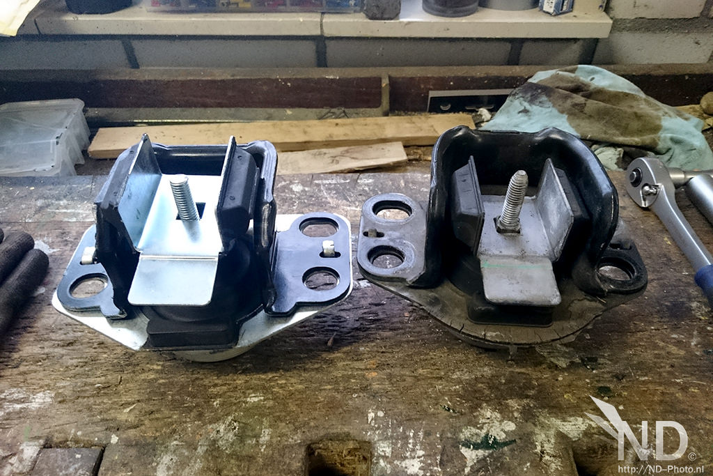

The cause of my problem?
lee M4RSH
Is this what is causing the a big clunking noise when I'm coming to a stop or turning sometimes?
I also get a lot of judder in the car on tickover. I'm guessing this is why...

I do get a lot of judder inside the car which you can visibly see from outside. Don't know if that is normal?
This is what made me check the mounts in the first place.
That, aswell as this clunk I'm getting sometimes when turning at low speeds or slowing down under load.
The clunk seems more ball joint relates to me although it did pass mot with nothing advised.
on a serious note mate,i 172 i had years ago had this and was an engine mount,might as well change them all,the uprated gearbox dogbone puts more stress on other mounts,esp if their weak.

If there is room between the rubber and the steel part, there is room for movement. This will most likely be the cause of the issue (it was in my case). Right side the old shot one.
Top Engine Mount by Andy Ramdin, on Flickr
