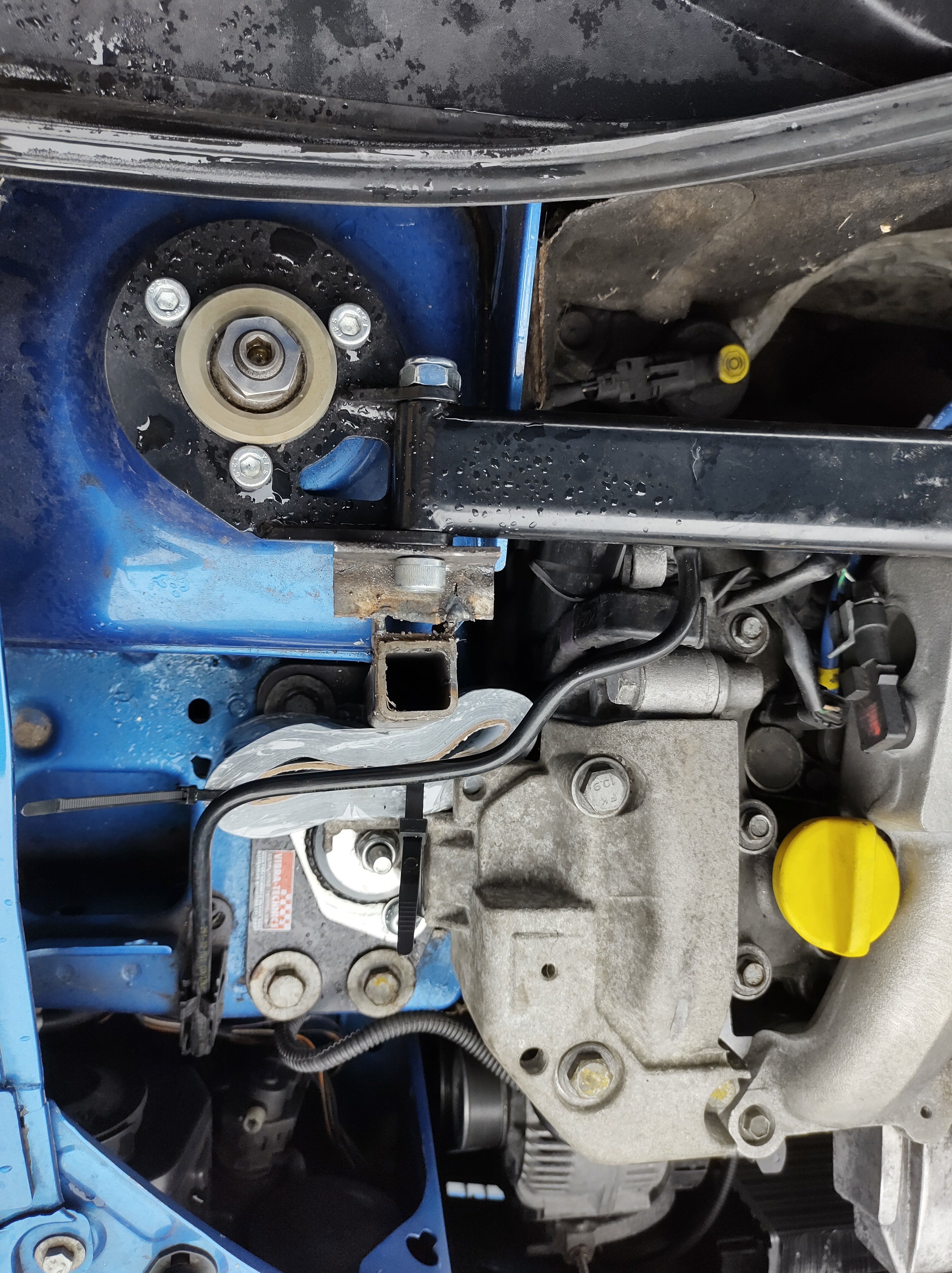

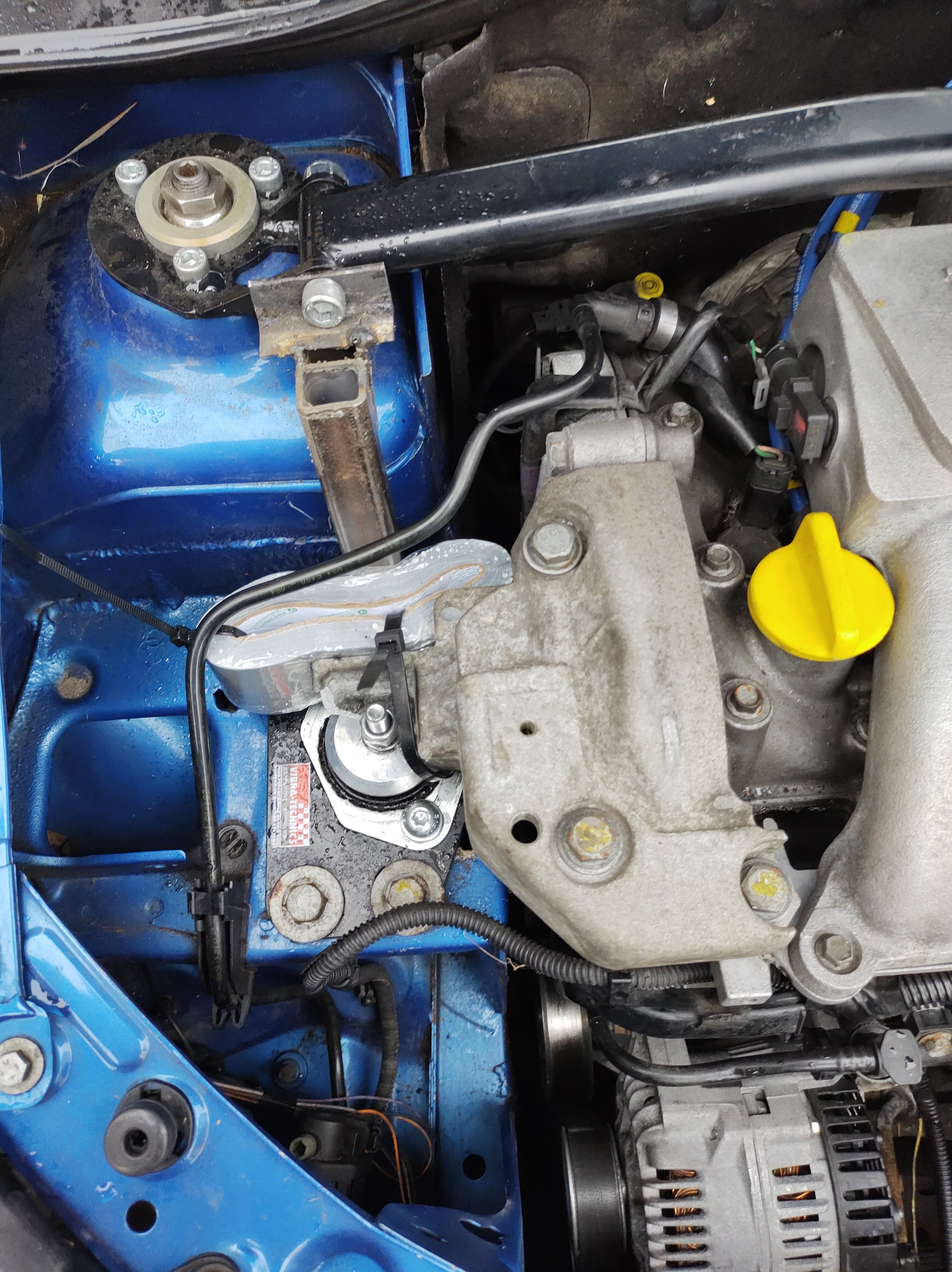

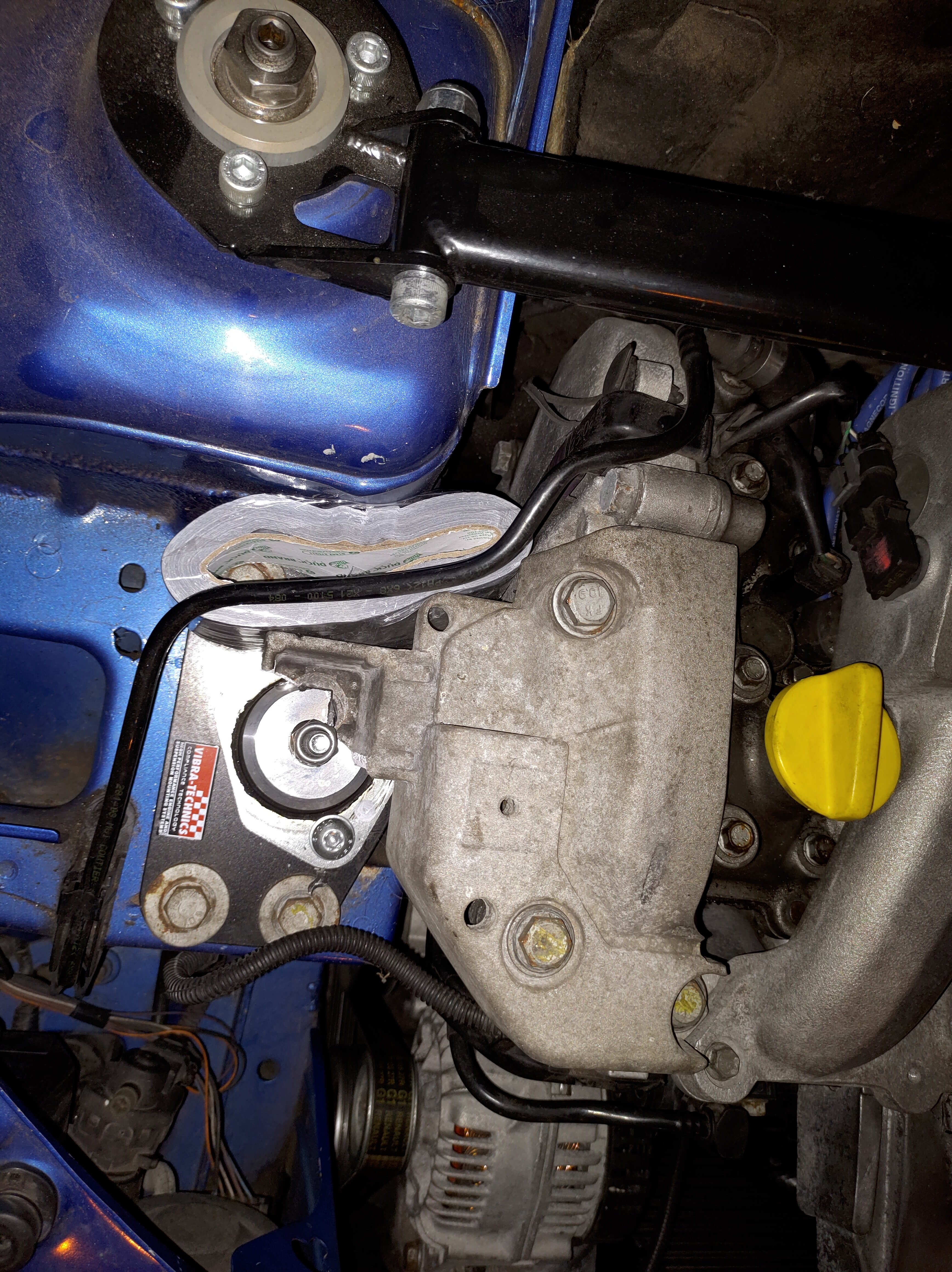

I've seen a couple of posts of this in happening recently. I wonder if it's due to the solid engine mount. I run one as well so thinking of changing to the pure Motorsport upper engine mount as it replaces that casting as well.
Where abouts in the Midlands? I think I have a spare here if you're stranded.

Many years ago, on my original Ph1, I had a crack in my mount. I thought it was normal. 😂
@Christopher duly educated me however.

@Luke_Exc - see if any 24h petrol stations (or similar) have those little ratchet straps for suitcases. I have been known to use one of those on a gearbox mount before. We only moved it around the yard but if you’re gentle it may do the trick to get you home.

Piece of box section from the strut brace to the back of the broken mount seems to have it held fairly steady. Not looking forward to the drive home later
Just outside Stafford.
The evol comes with an insert that spreads the load, tbh the quality of PMS stuff lately has been shite.
Brigsy
  T.Turbo
I reckon thats failed due to the wrong nut fitted which has crushed into the mount when tightnened up. Oem usually have a massive washer under the nut to spread the load when torqued, but the problem is im sure its a different thread to the vibratechnics mount. I fitted a large heavy duty washer under the nut when fitting mine and had no issues.

I also did the above. Evol engineering provide square thick washers with their engine mounts now after I recommended it being an issue with the vibra/ktec ones.
Totally agree with that. Going to make a washer when I fit a new piece.
As said above, the Evol is a better design.
