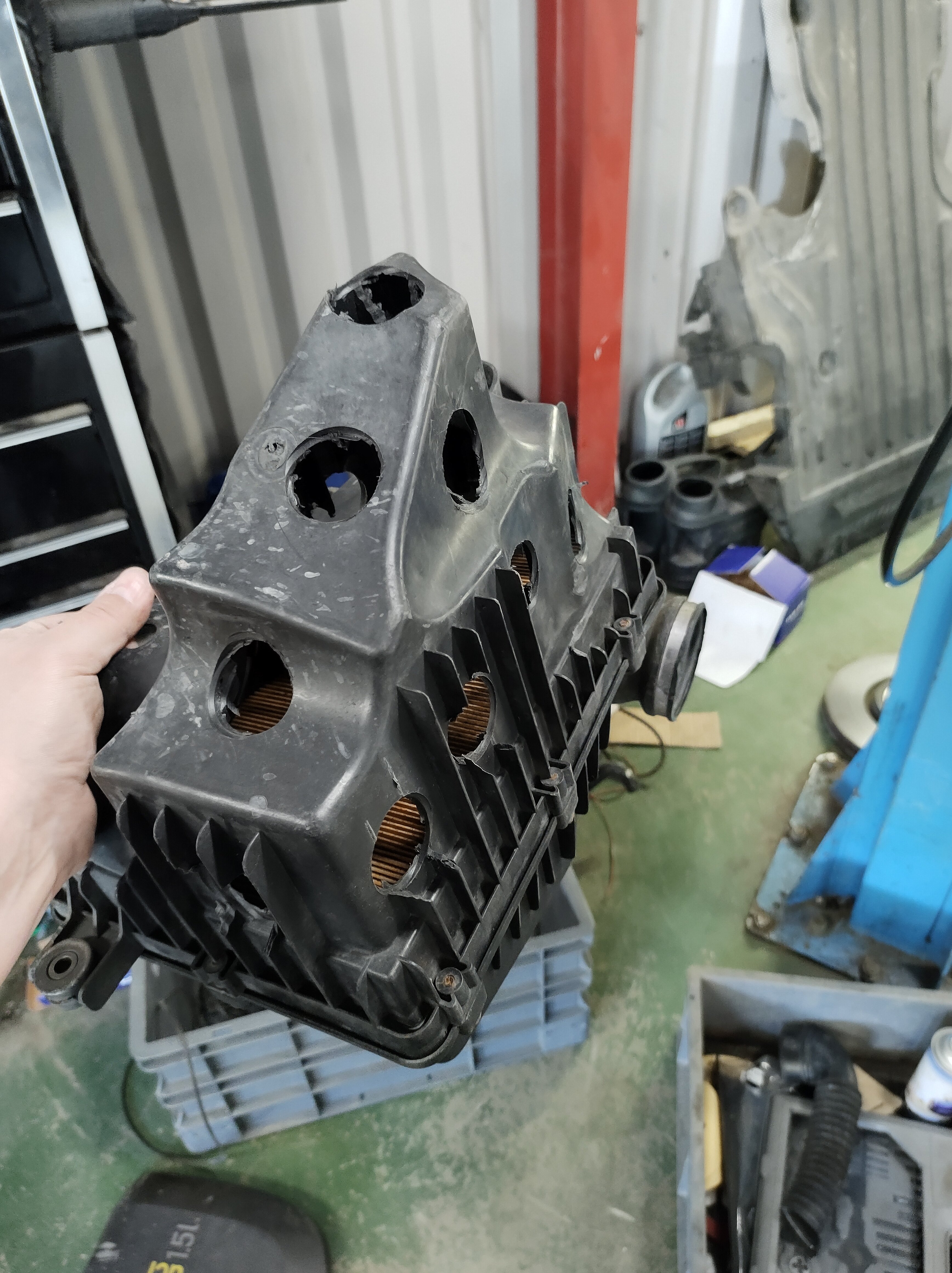

A couple of months ago I started putting the ph1 together with the new angled DCOE setup to replace my current OBX bodies and I happened upon a problem. With a filter I was just outside the car! Unfortunately the space at the front just wasn't going to work so I needed a way to get more. Phase 2 time then!

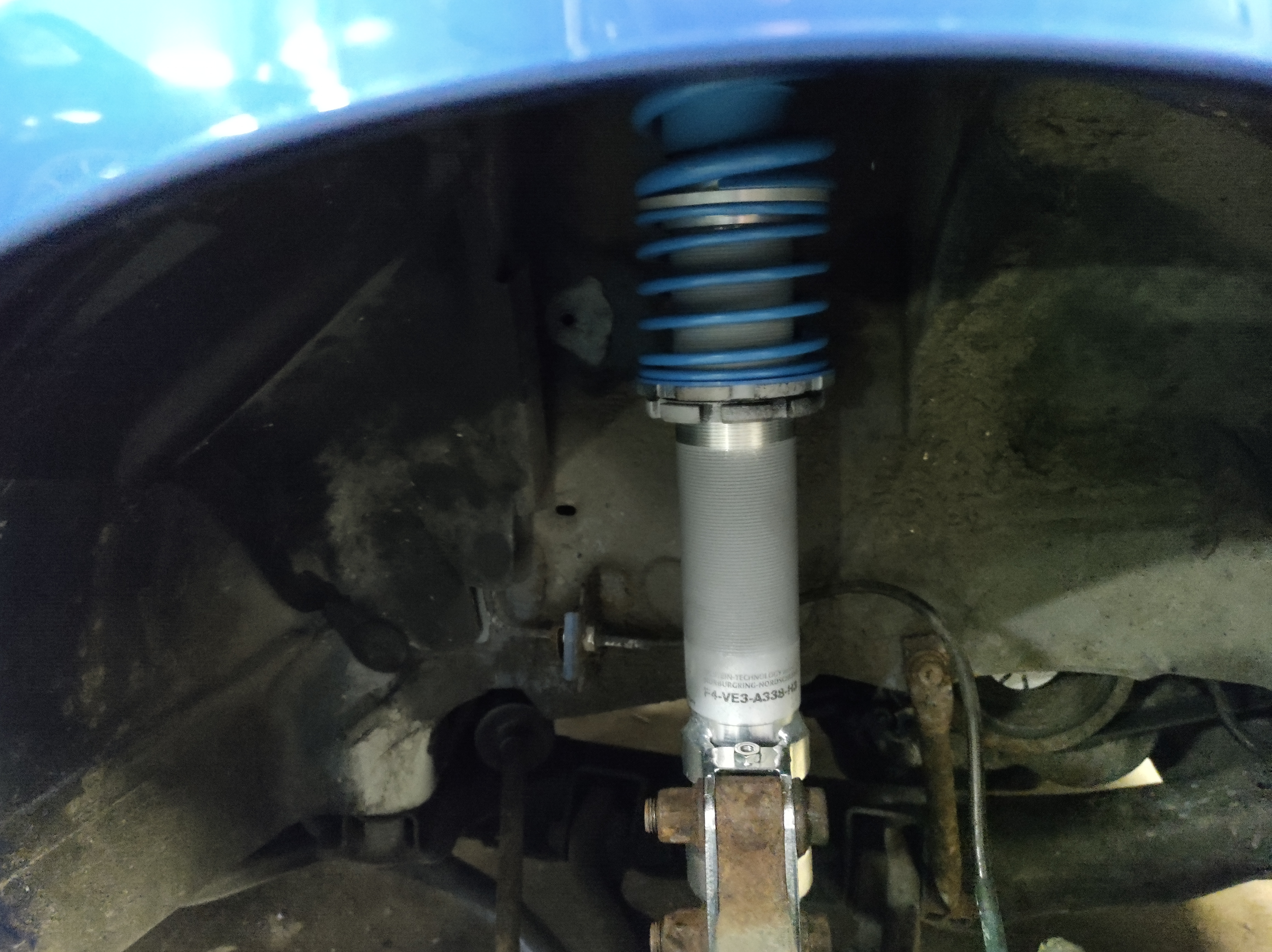

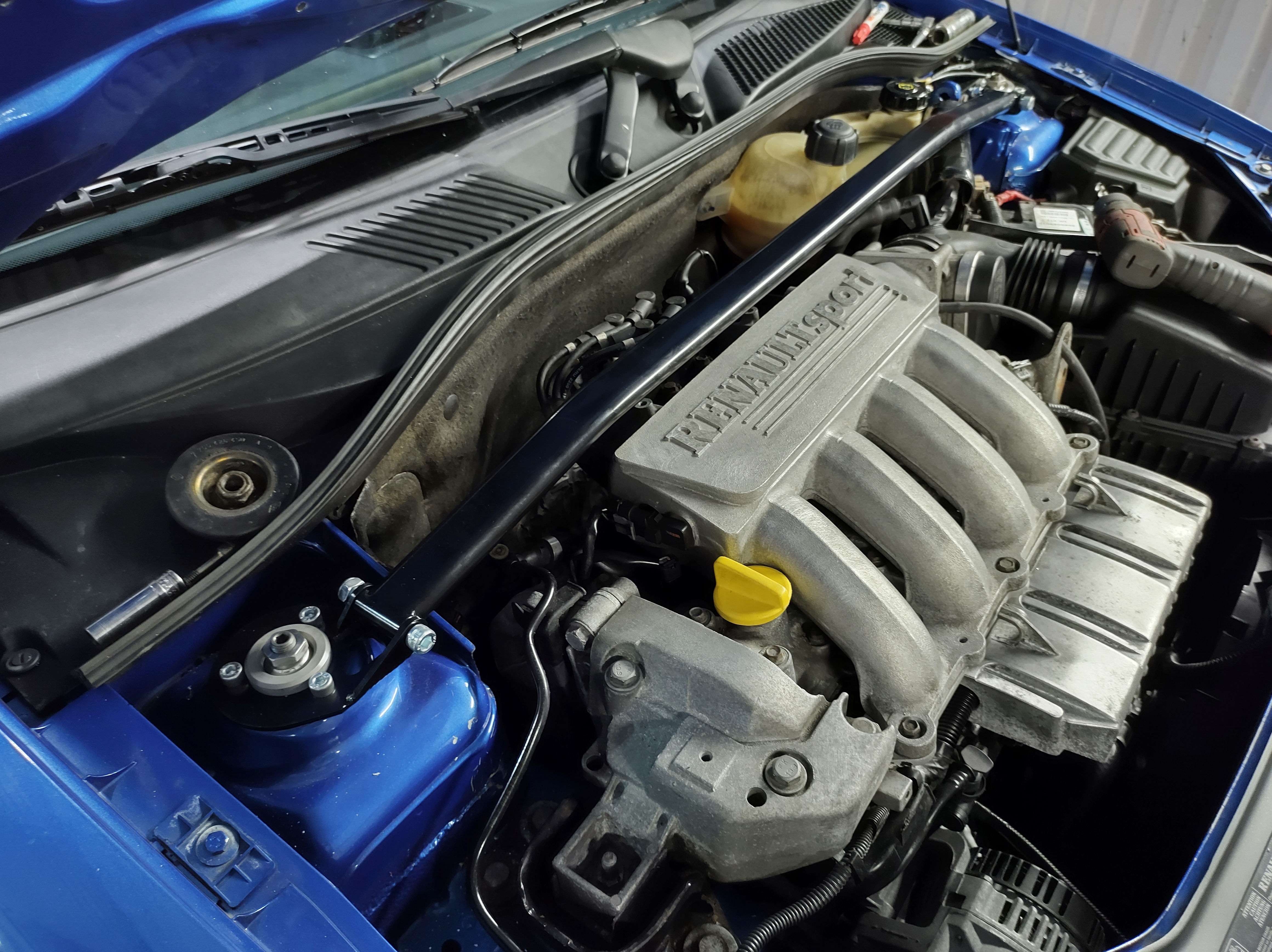

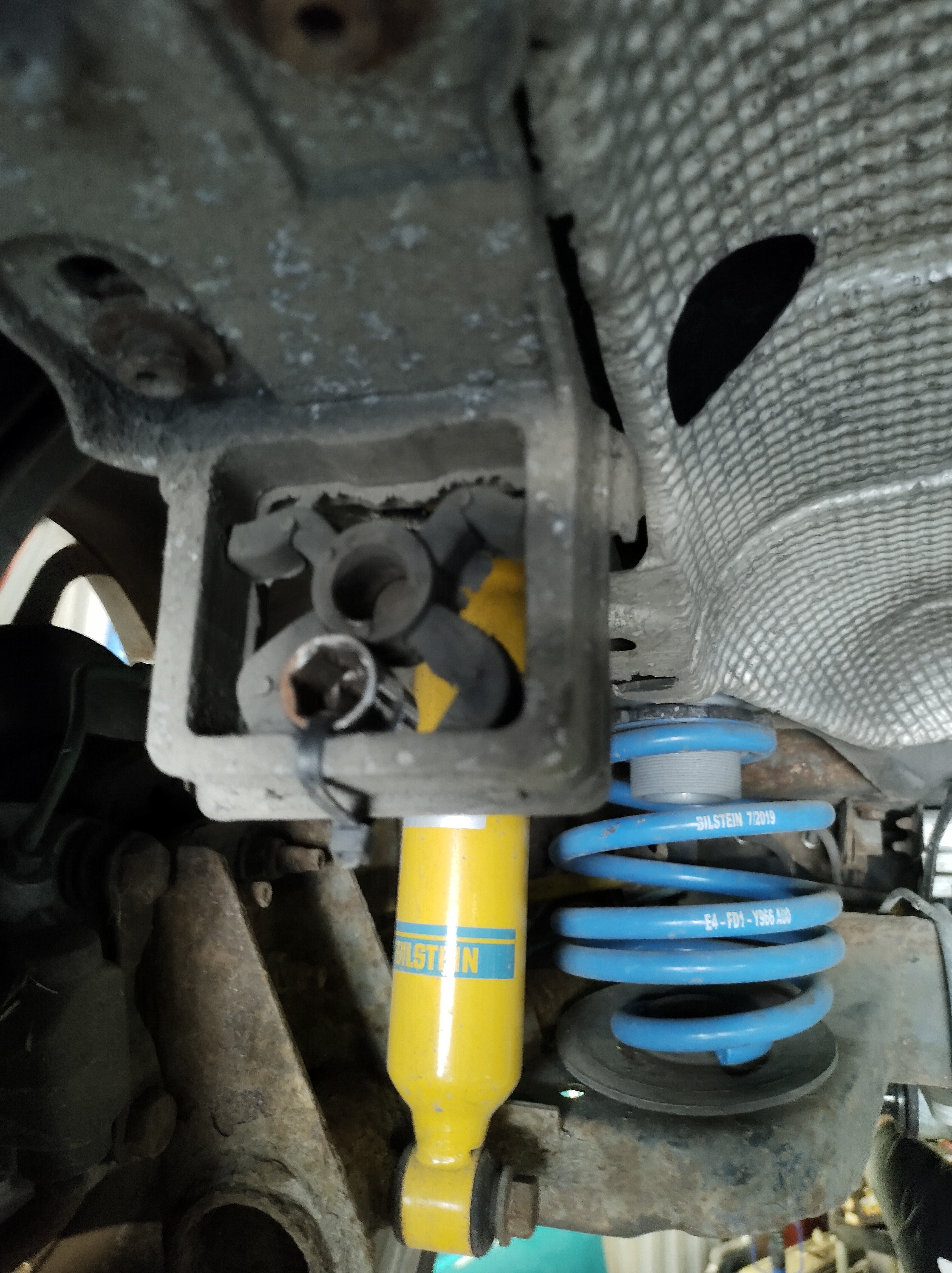

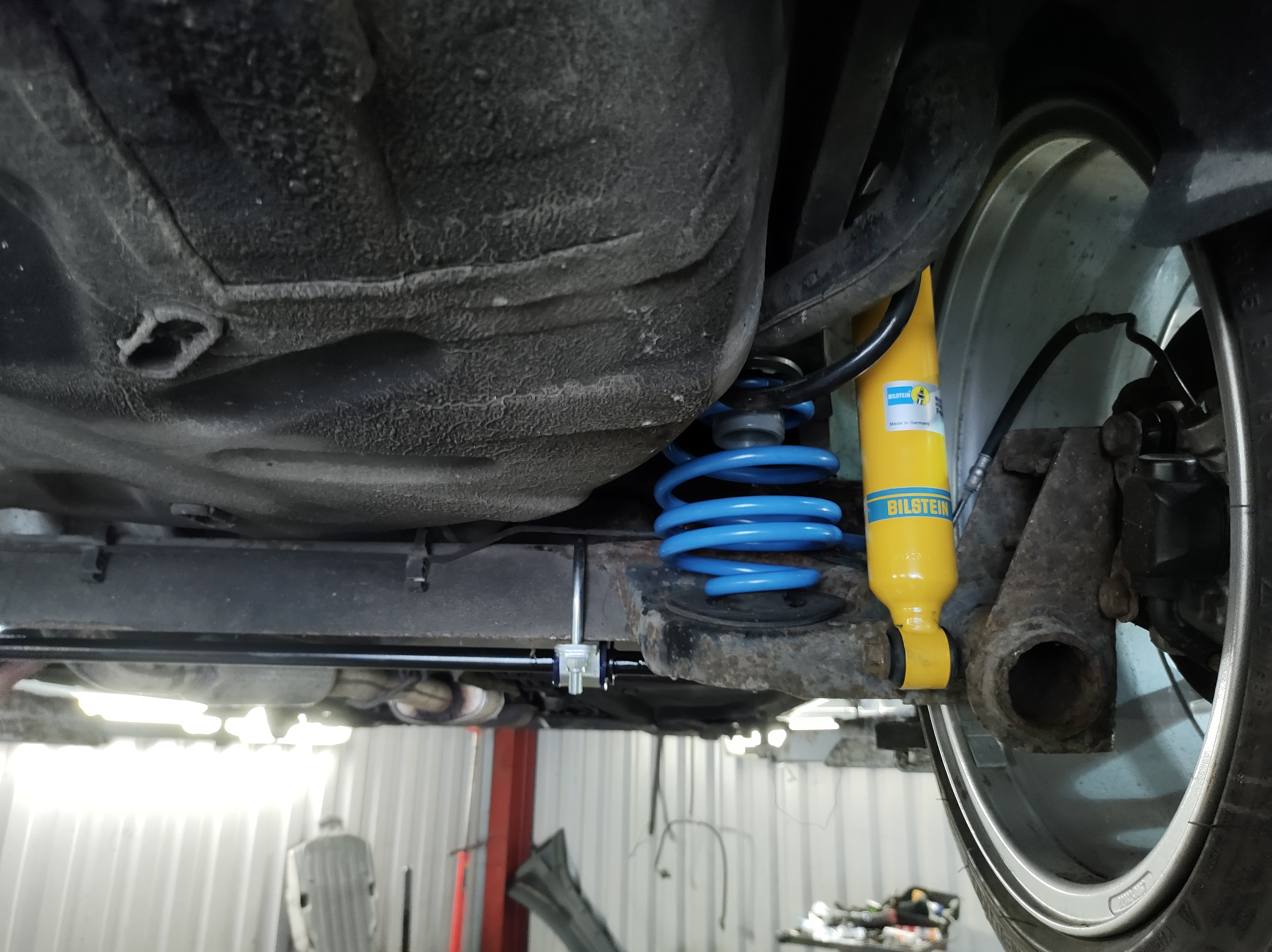

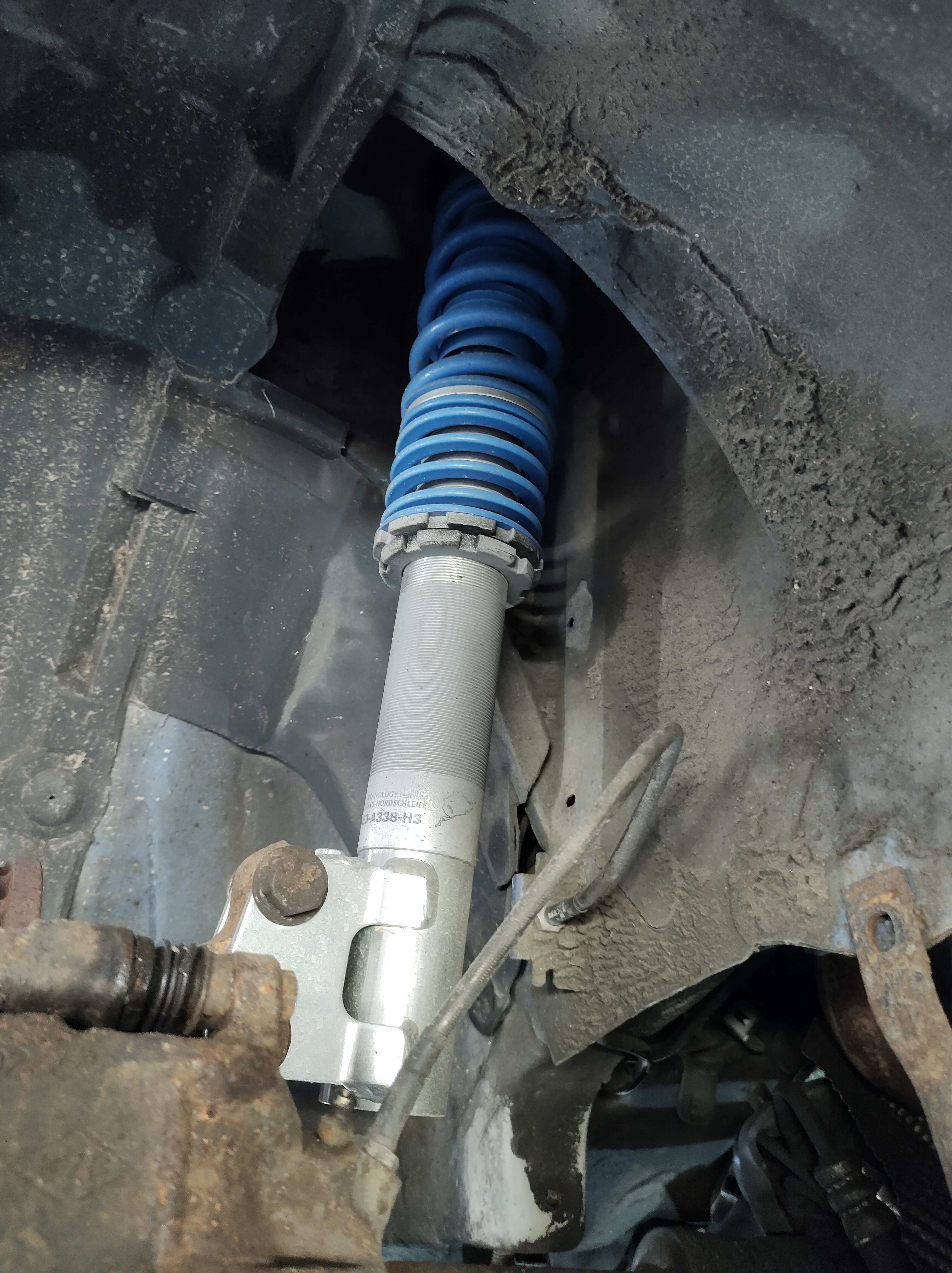

Yesterday it had B14s installed, PMS rear anti roll bar (19mm) and a PMS front strut brace and solid top mounts.
Chucked it all in the car to take to a mate's workshop.

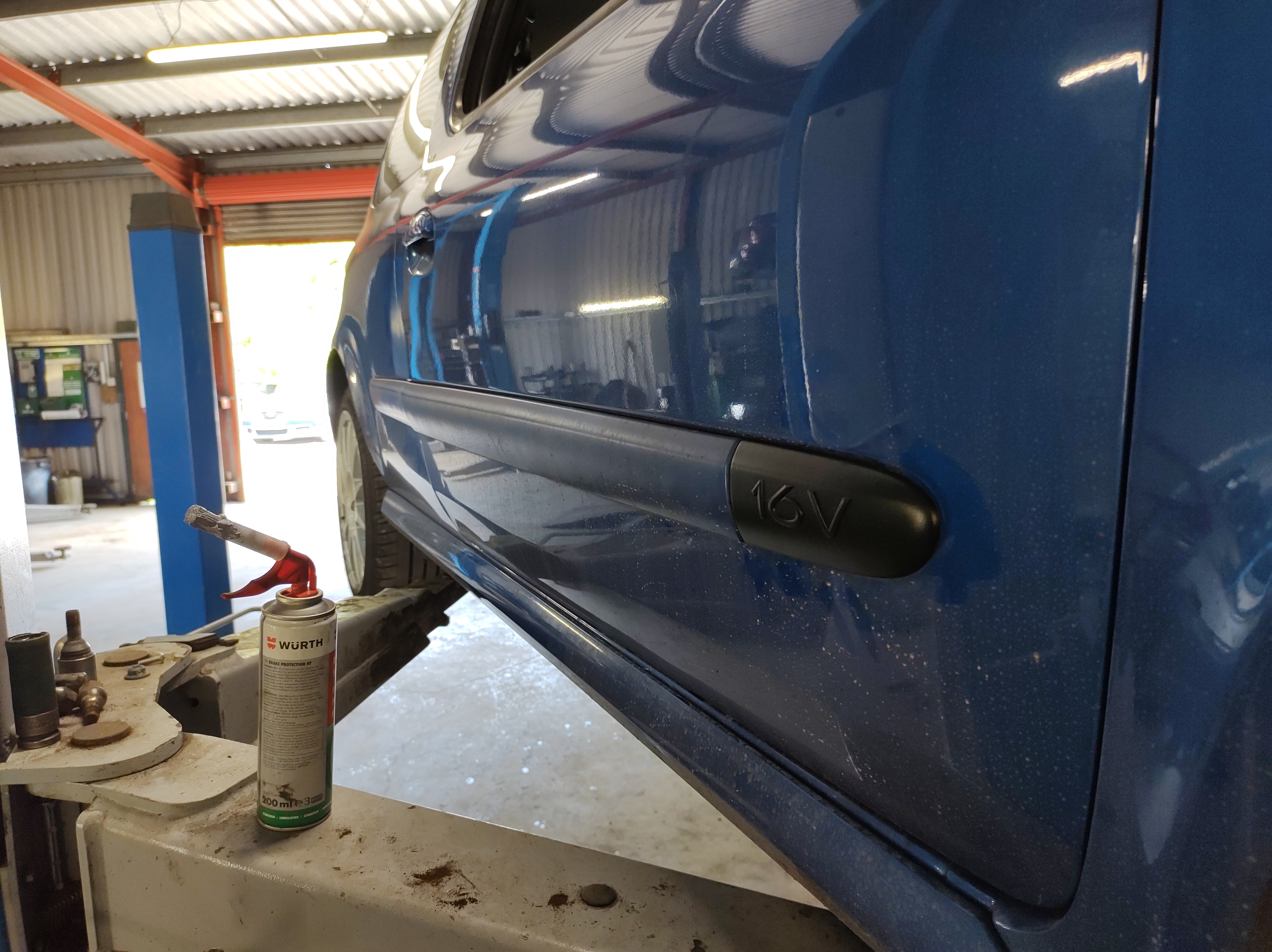

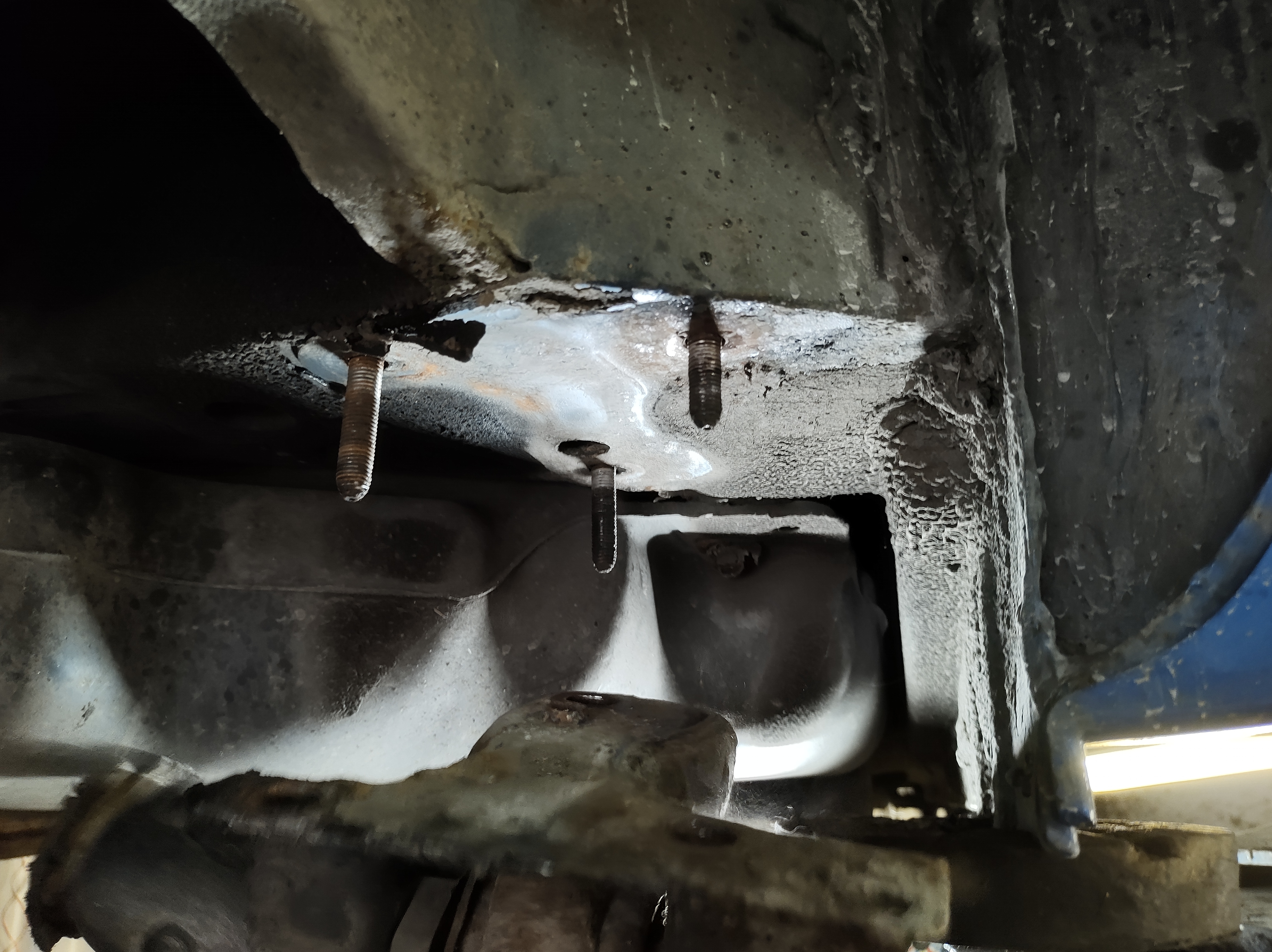

The PMS RARB needs the rear beam to come down on one side, apparently this has become a hot spot for rust on these cars. Not this one! The captive bolts were an absolute pain but we got it done along with the rear B14 springs and shocks, I know some remove the adjuster for the lows
but mine are set about 3/4 down it for the ride height I wanted.
Did find a little rust, I'll get it sorted when it goes in for the other bodywork, inside the rear arches is mint however.
Fronts and the front brace went on easy, I'm trying out a proprietary coilover anti corrosion spray to see if it's worth a friend marketing it.

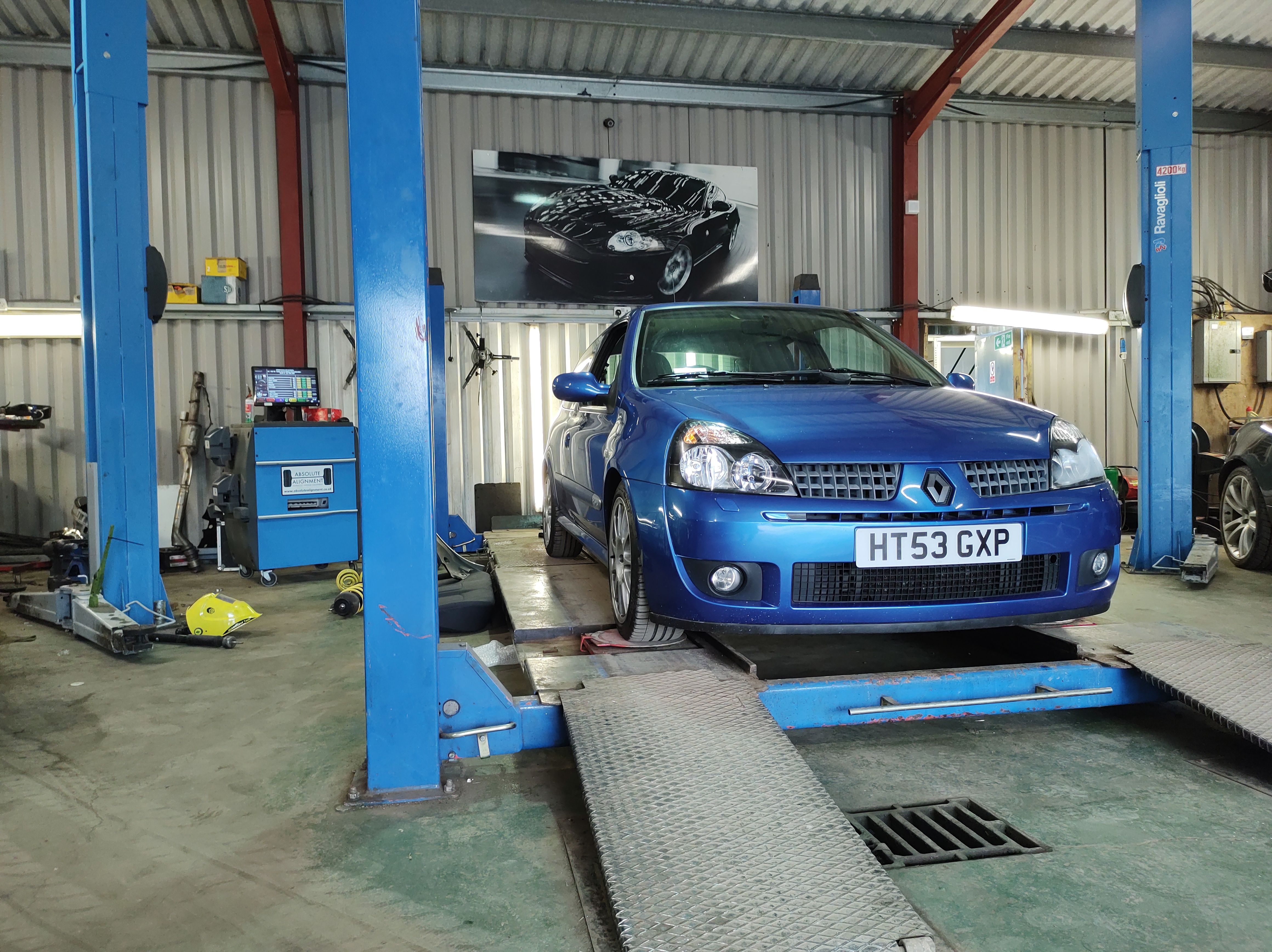

Put it on the tracking setup, it'll need re-doing because I forgot to buy camber bolts (now ordered). The rear beam on this one is superb, the sides are within a minute of each-other, one of the best I've ever seen and crazy on a 92k hot hatch!
Not a huge change in ride height over the apex springs but the way it drives is night and day, supple and perfect for the road. It's a little tramliney but I'm hoping we can sort that next it goes in for tracking.

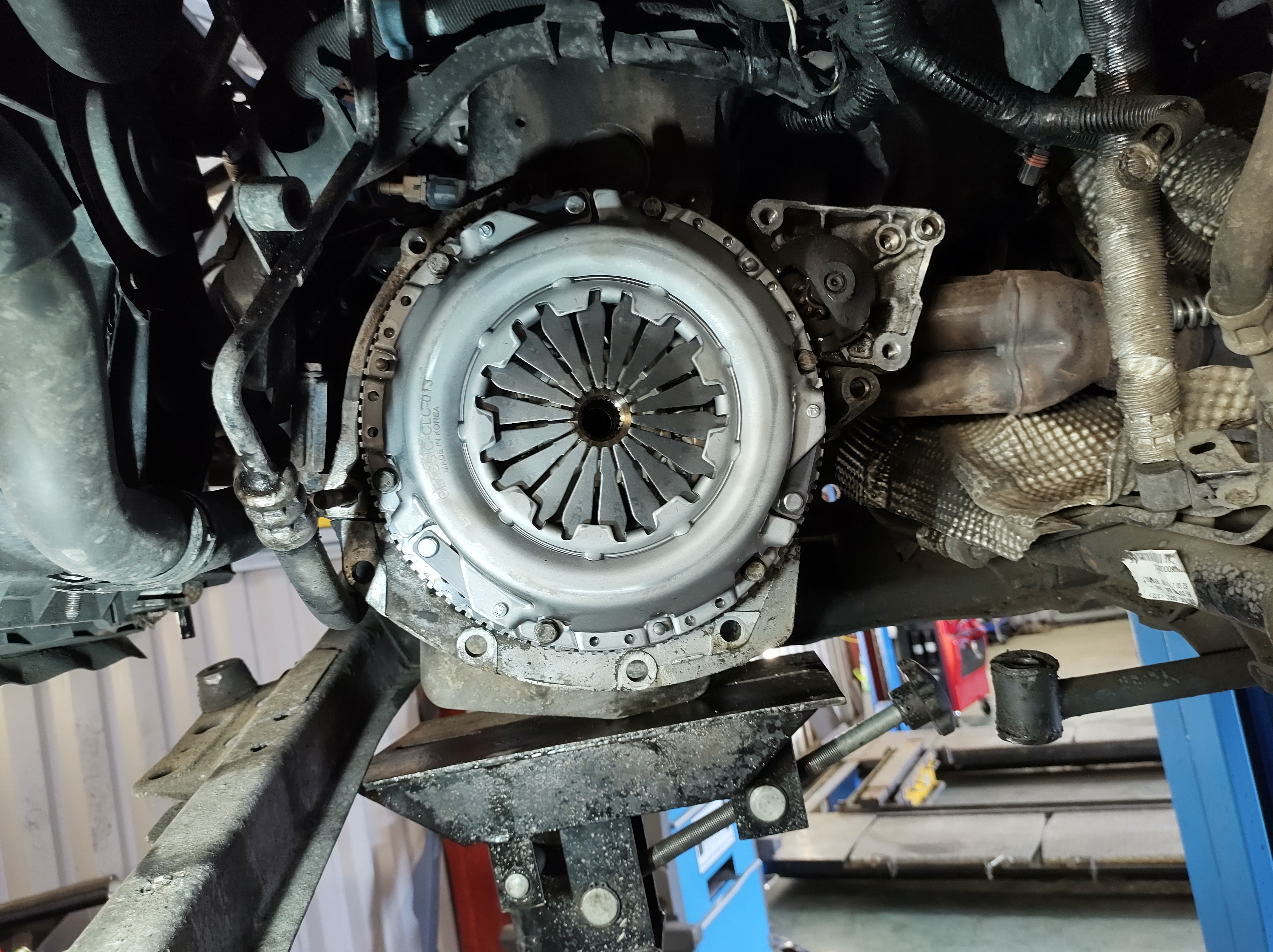

Disaster struck yesterday! Did you know the AA don't take you in the van now? PITA.

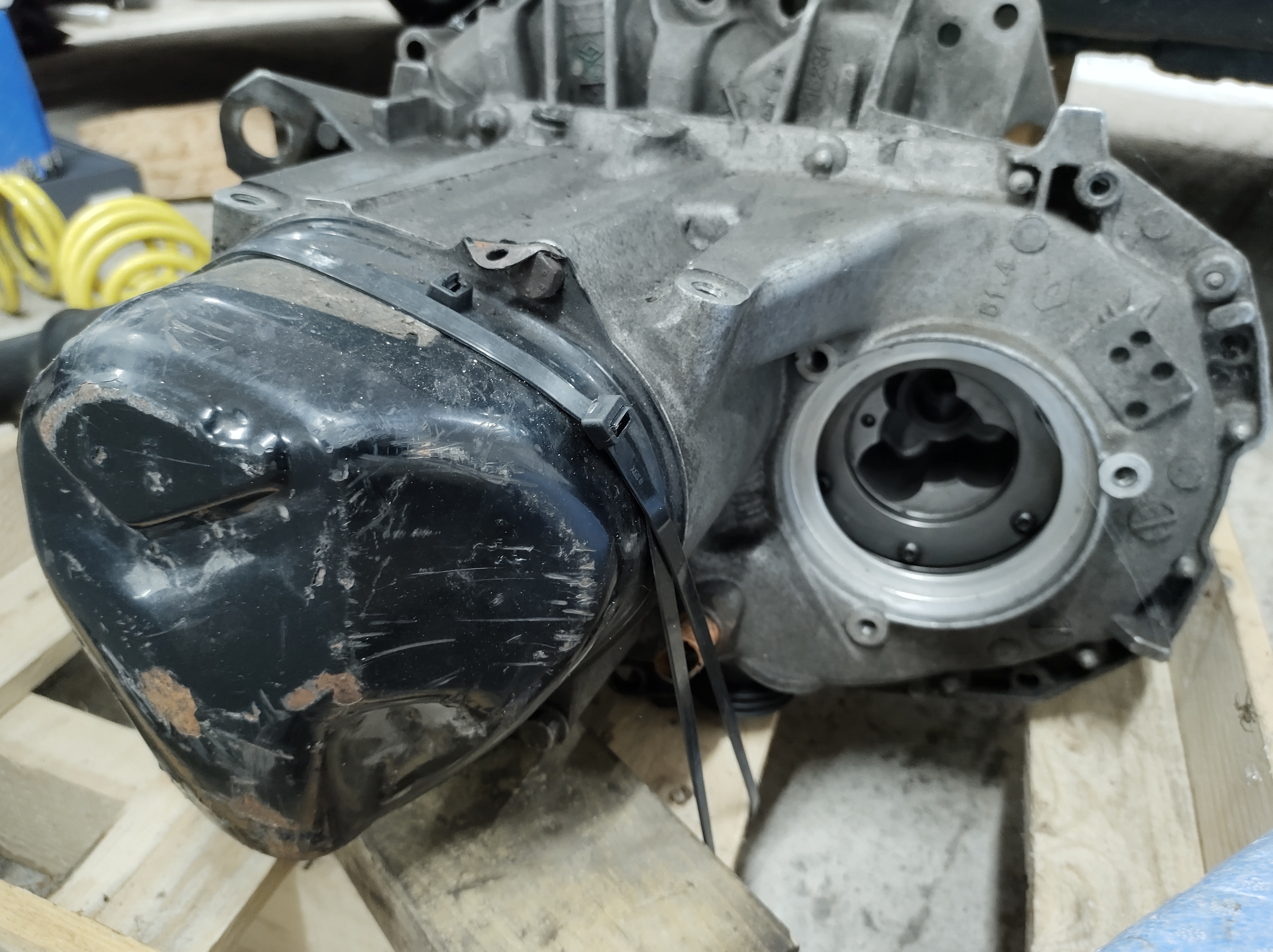

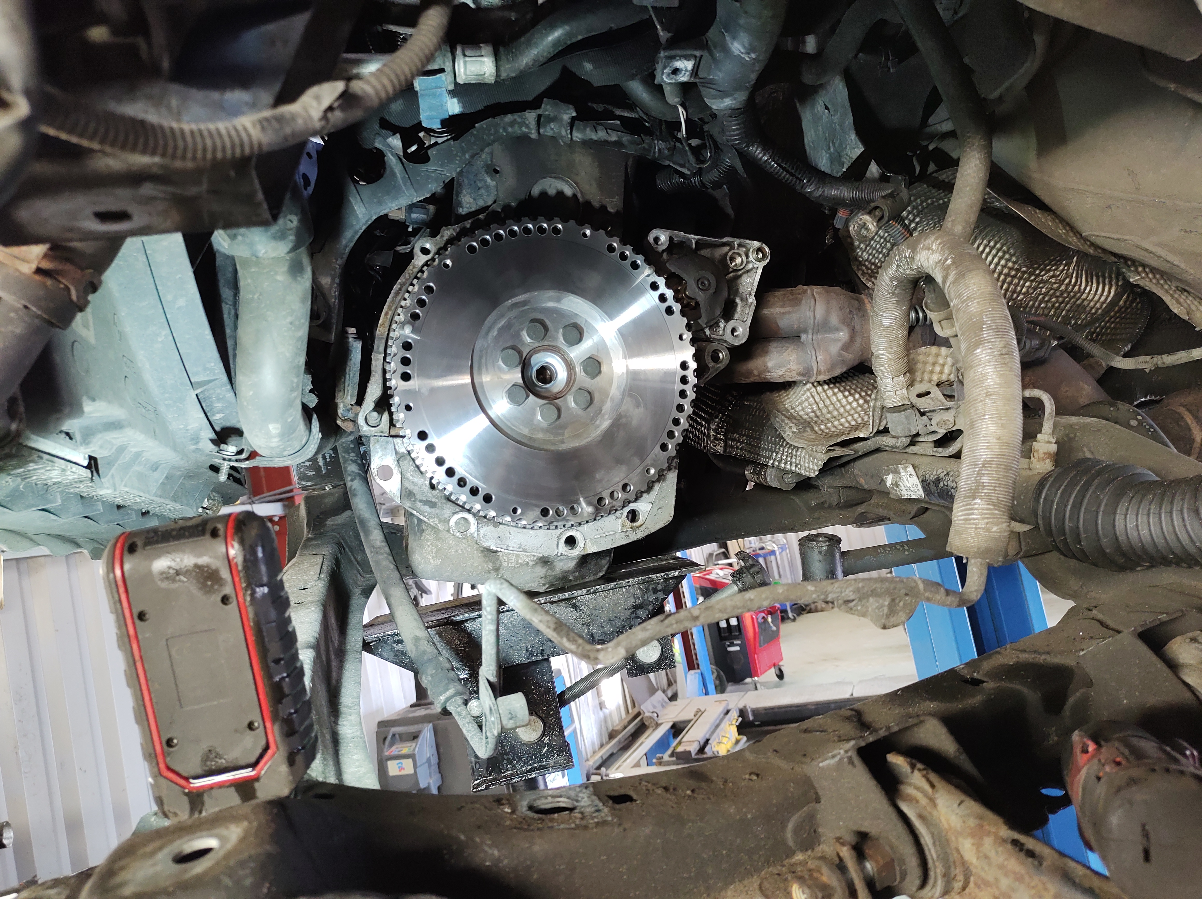

Dragged back to a mate's workshop, diff circlip, my bad :)
Could just fit a new circlip but I had a few bits lying around so I guess they'll get thrown on tomorrow....

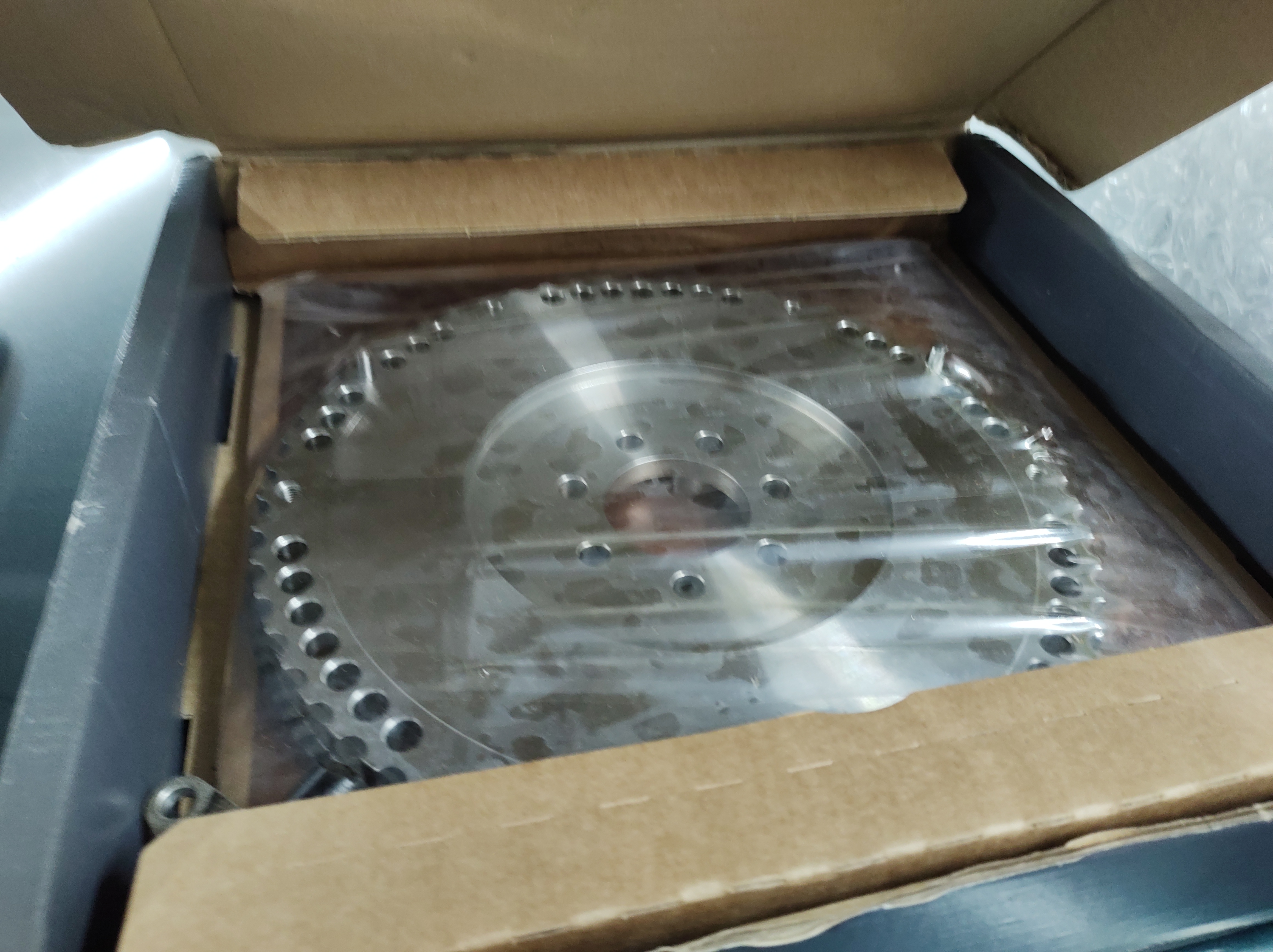

Ex Sharky gearbox with a quaife in it, freshly rebuilt by Frank Rizutti of Avanti Motorsport, TTV flywheel, standard clutch and flywheel bolts and 5L of Titan gearbox oil.
They way the car revs with a lightened flywheel is awsome. Some excellent mods you have already done too. Bilstein B14'S are excellent too, would like to get a set for my recently acquired Cup.

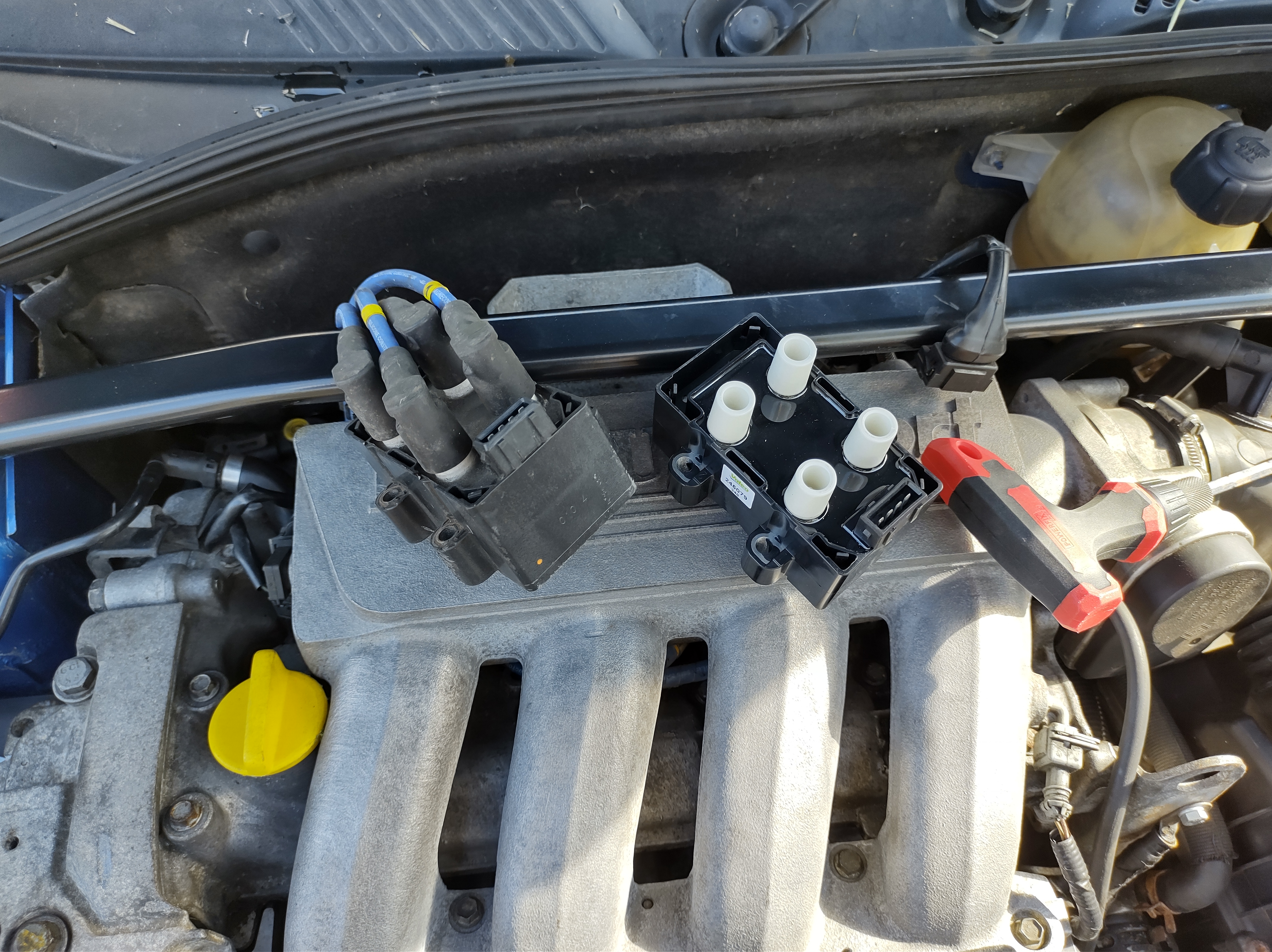

Today fitted magnecors, spare coil, fresh plugs (ones that came out were grim) a vibratechnics top engine mount and a walbro 255lph pump (had a non sport pump fitted bizarrely)
Made it worse. Much worse. Joy.
Is it still on the original injectors? If so probably a good chance it is one of those!
Apparently done in the last thousand miles. If it was injectors that'd be ideal, already have 225 ones in the bodies.
Injectors fitted were the ones that were in my van.
I acquired a set of brand new ones so fitted them to my van last year and the ones that were already on it went in my mates toolbox for spares. They then went in your Cup when the original ones started playing silly buggers.
Now whilst they were working perfectly just before they were removed, they weren’t ‘new’. So entirely possible they’re your culprit.

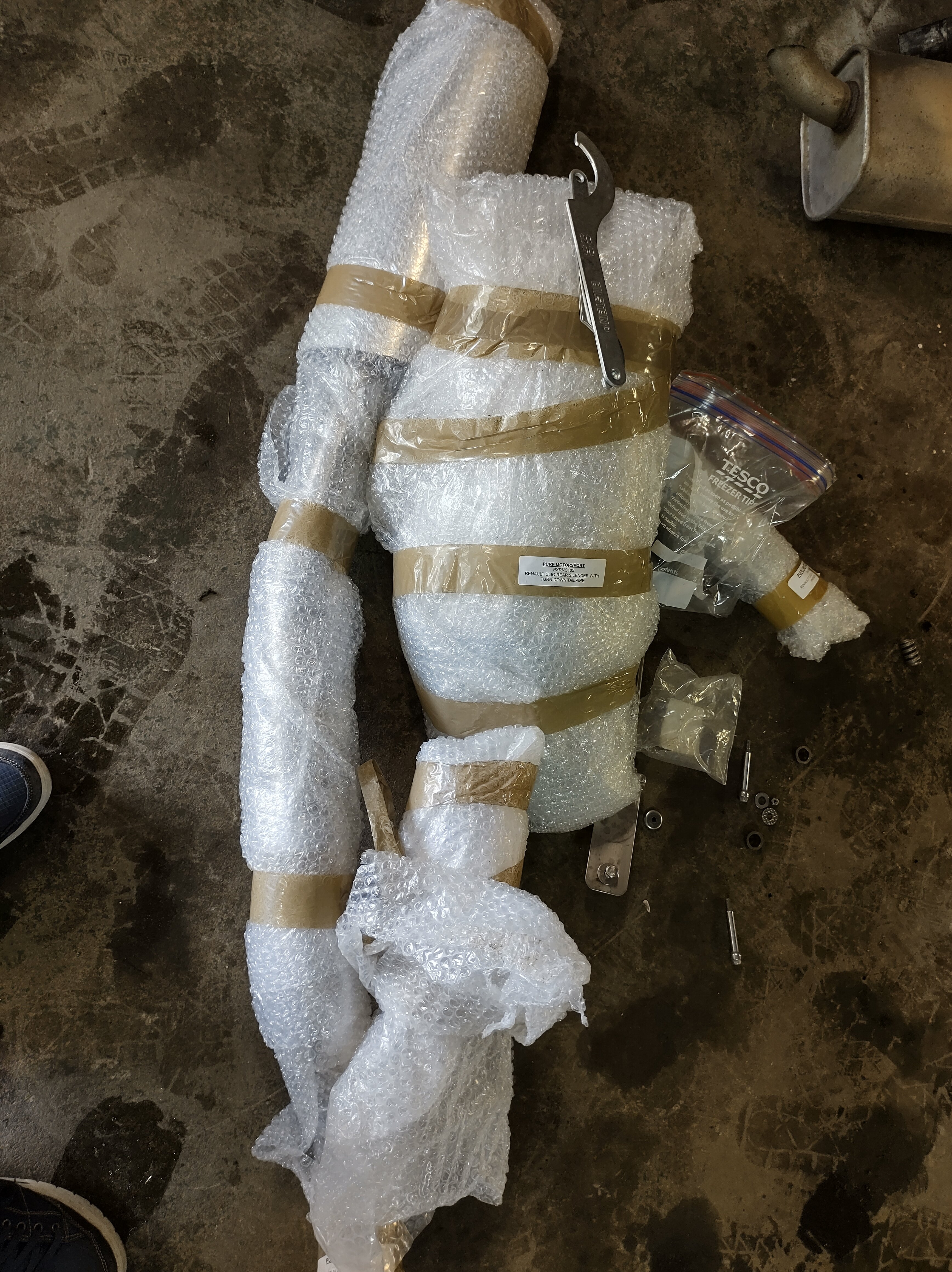

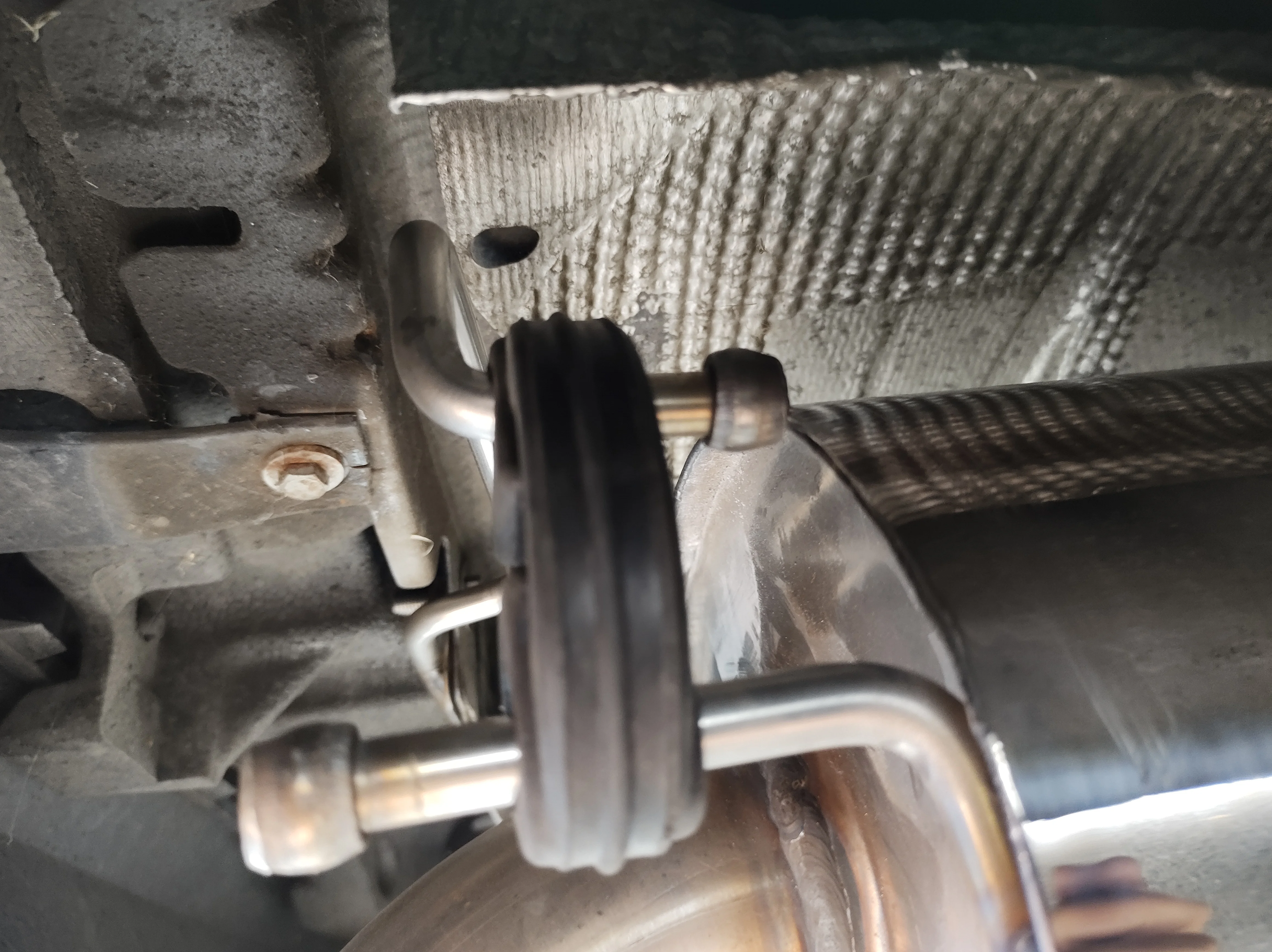

Fitted the pms exhaust today. They've changed a fair bit since I last had one, quality has gone down imo.
Took some great pictures definitely wasn't annoyed with the cat to manifold being a pain in the bum on these and forgot 🙄🙄
Pms stuff really isn't what it was. The welds look gash . It's nice and quiet but the build quality is shocking compared to what it was a few years ago.

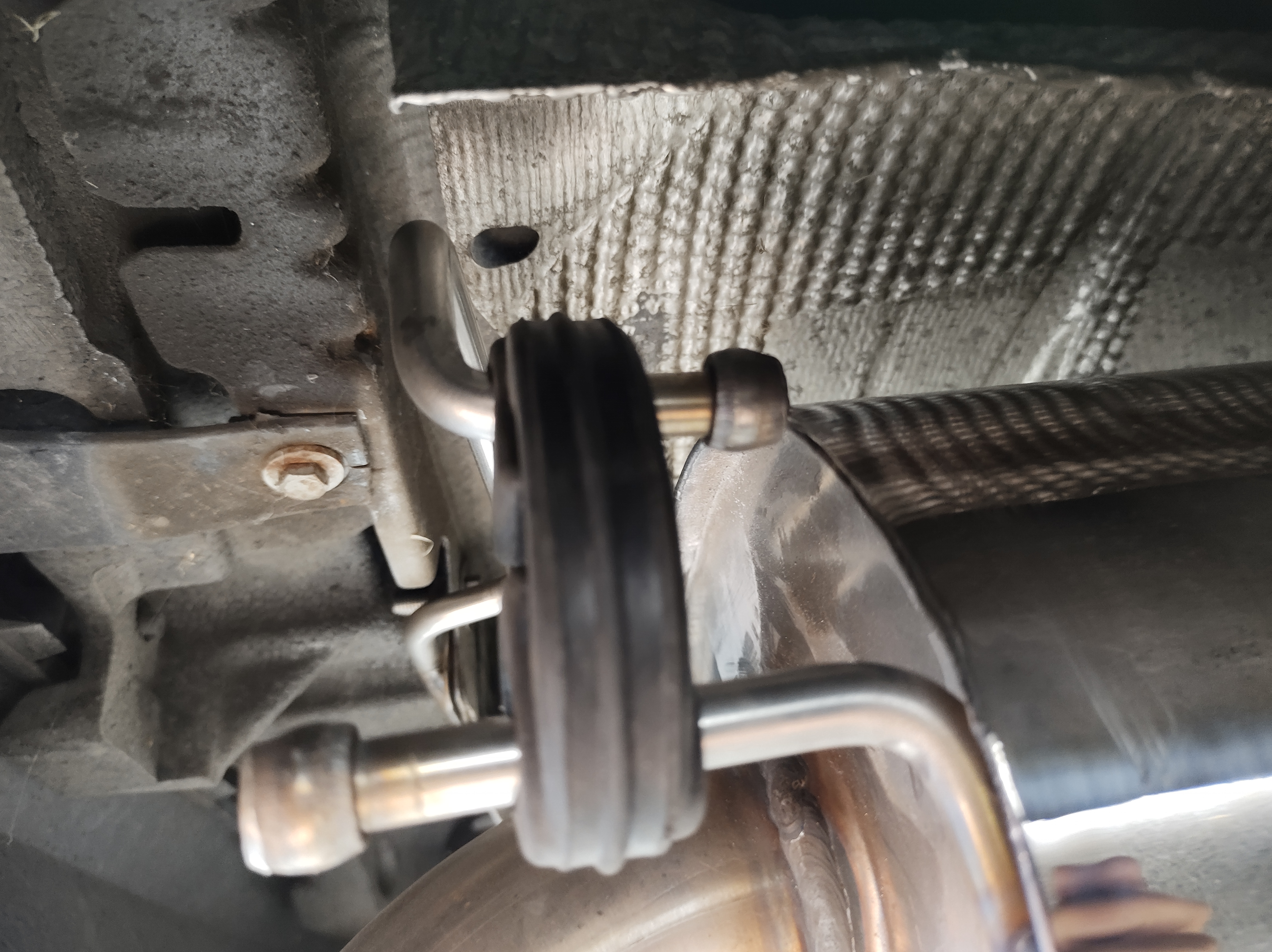

Went off to the shop today and the exhaust was rattling and squeaking badly enough I couldn't hear myself think.
Looked under and the mount touches the exhaust, wtf pms, when you cheapened up the build you didn't check it would all work still?
A sweaty/sweary half hour under the car on the driveway later I made a spacer stack of oversized nuts and washers and put it between the hanger and the body to space it out. Yes I buy monster by the case, no I do not wear a snapback.
thats piss poor from pms tbf. i would let them know.
On that
I had to bend that mount on mine too. The rattle against the back box is very irritating
I thought about doing the same but mine was quite springy, have had to tighten it up once but it's now loctited, seems to have done the job.
It does sound good but tbh if you'd put it on front of me and asked the manufacturer I would have said £250 eBay random.

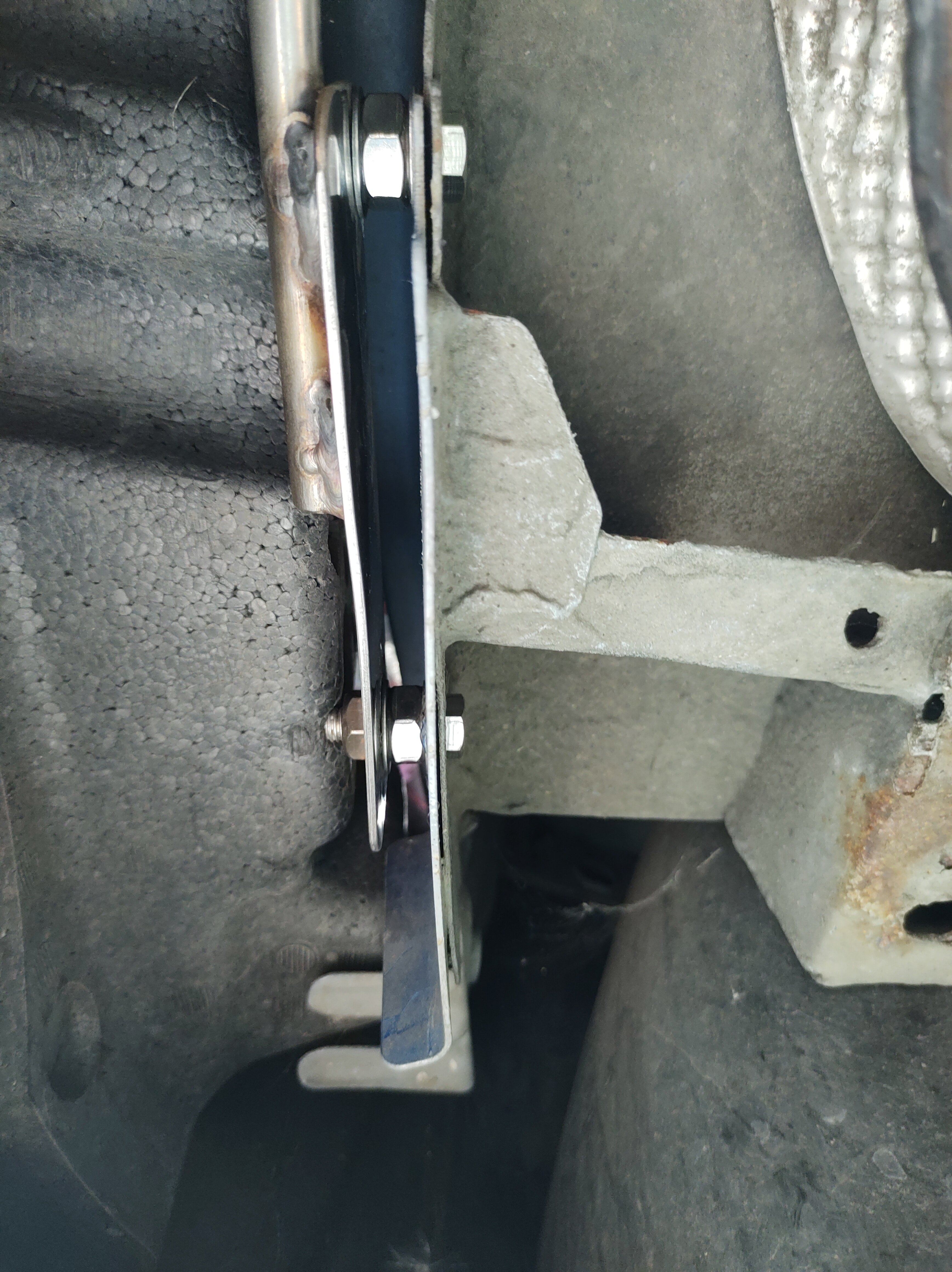

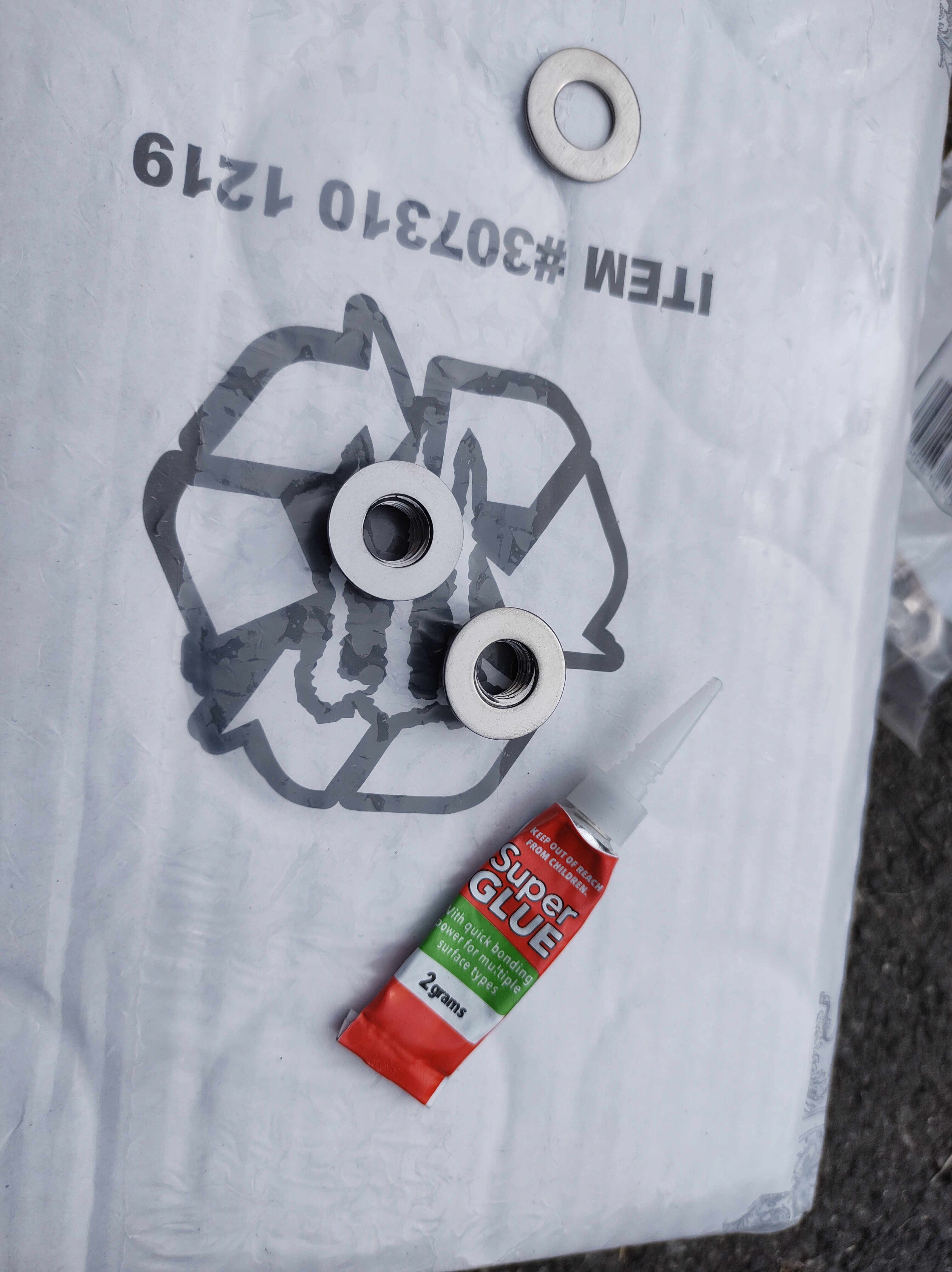

A sweaty/sweary half hour under the car on the driveway later I made a spacer stack of oversized nuts and washers and put it between the hanger and the body to space it out. Yes I buy monster by the case, no I do not wear a snapback.View attachment 1556139View attachment 1556140View attachment 1556141
Agree. I have two PMS systems. The rubber mounts are shocking. I use the genuine VW/Audi ones now. I've complained but now't gets done.
