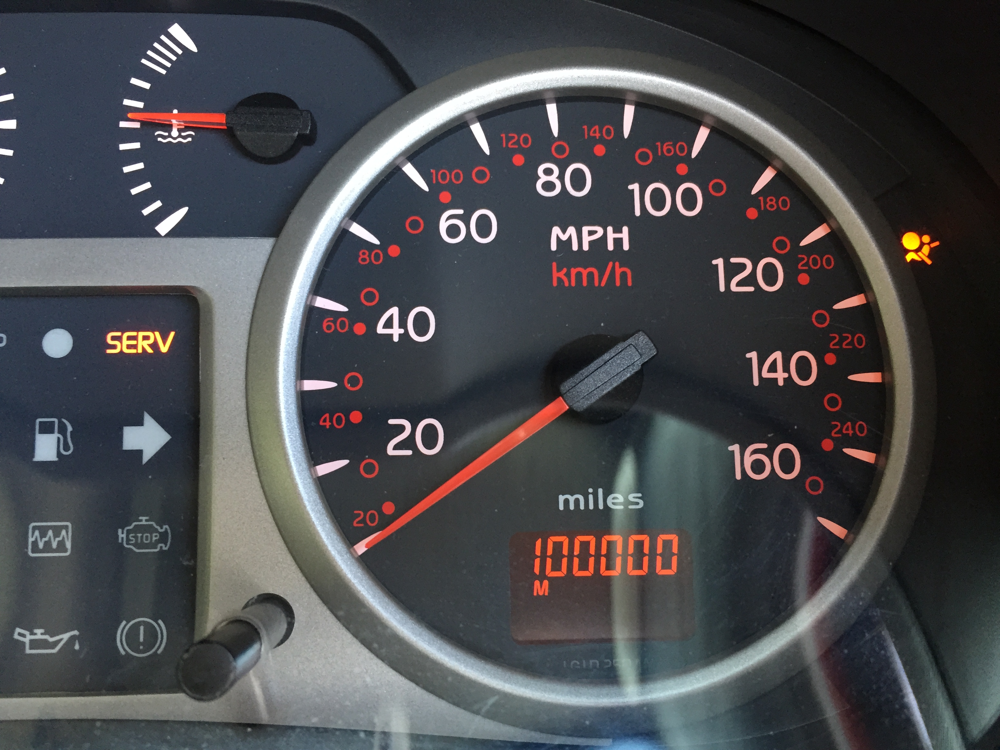

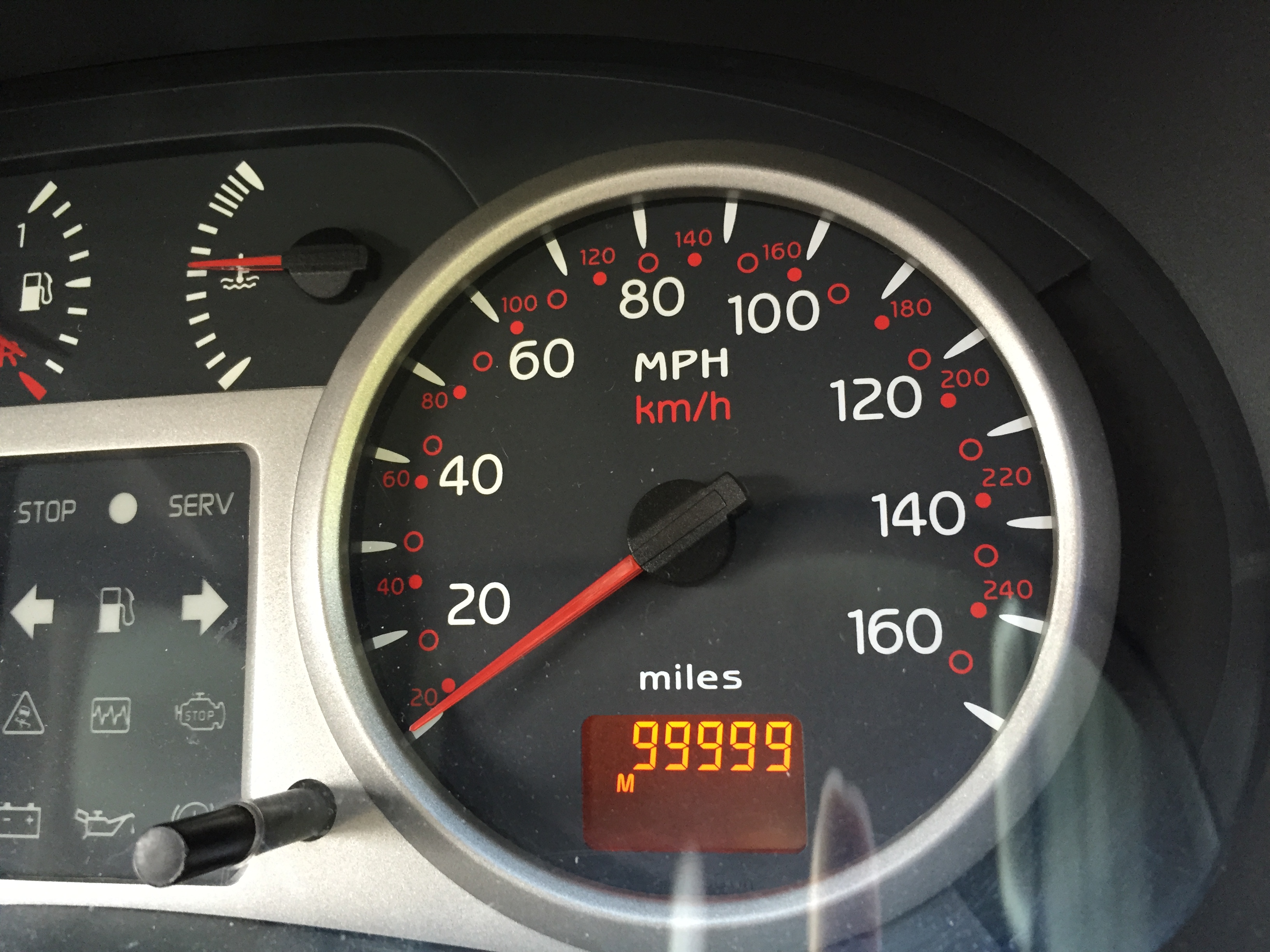

The curse of 100k...
You couldn't make this up...
