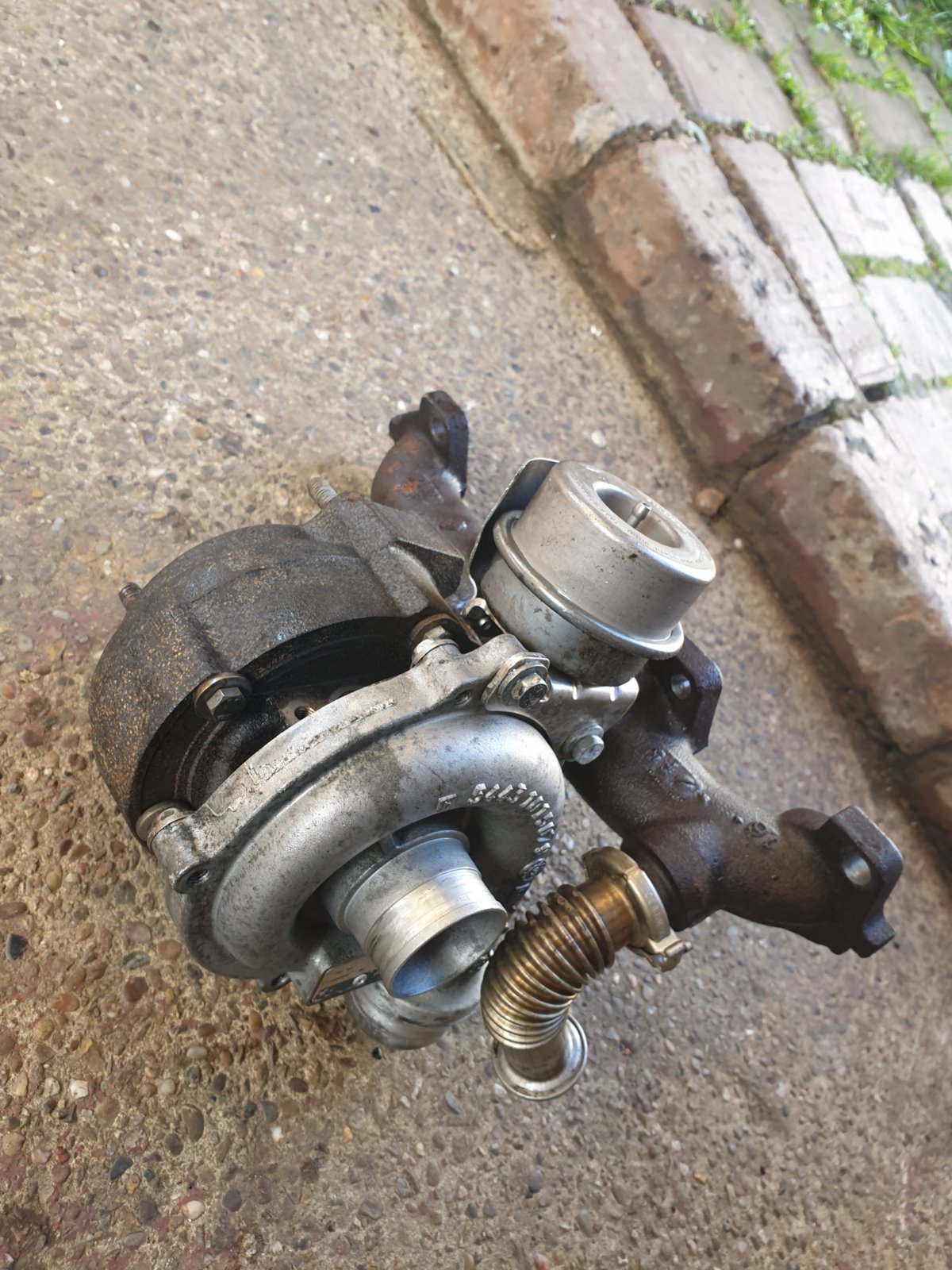

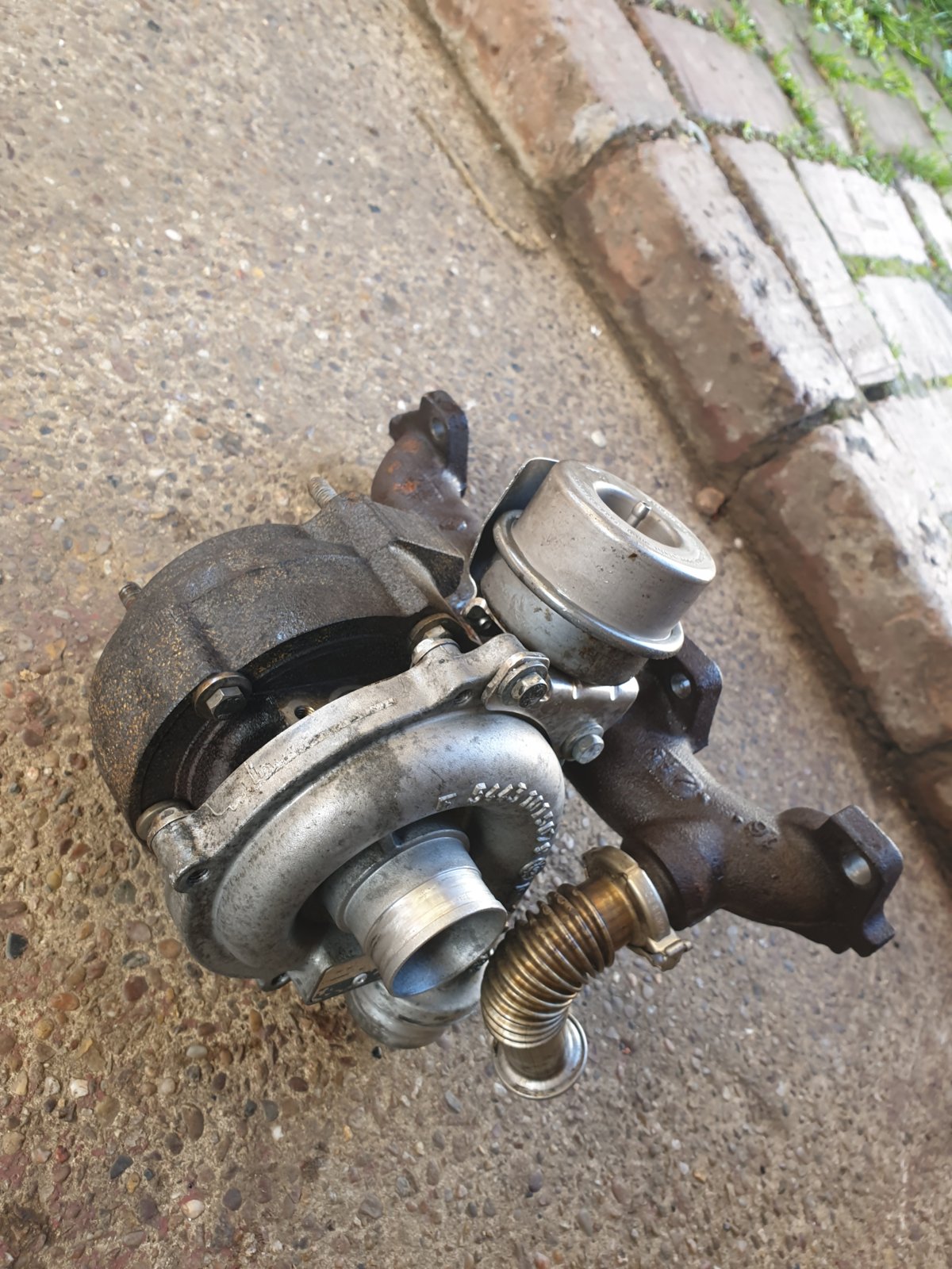

I've got a dCi 100 turbo here too if you fancy that you want a turbo that wont blow up of you look at it with a weird glance?
1418208
Krarl
What condition is it in? How much?
I’ve got a 68 campus, which I think has the 100 turbo on it? It is intercooled.
@YorkshireKyle
Yeah same turbo mate, blue tag KK variant. Decent condition, only had 80k on it, if anything it has a smidge of lateral play but nothing too much to lose sleep over
I've got it on eBay for £65 + £15 postage but I'd do it for £60 posted on here

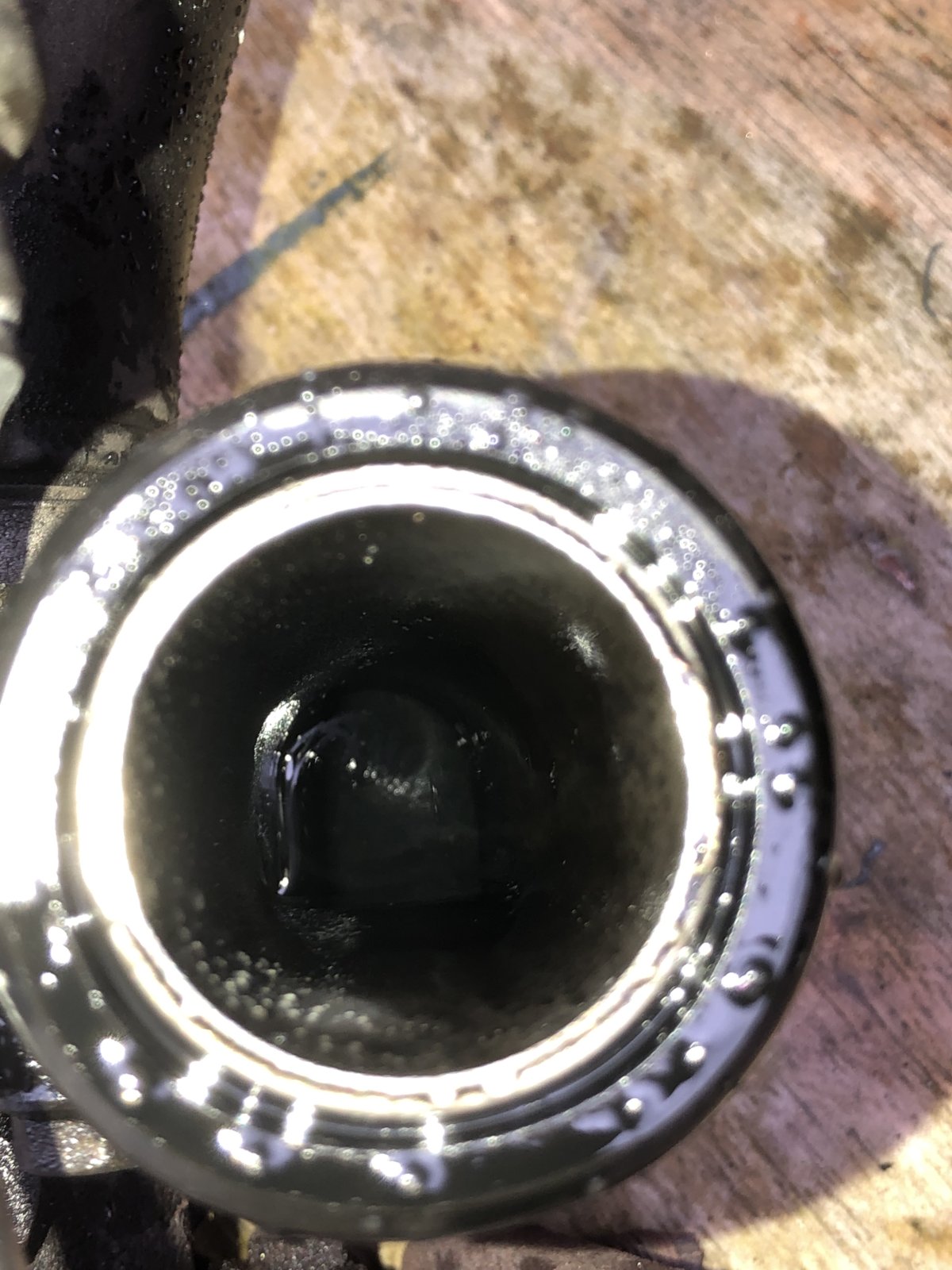

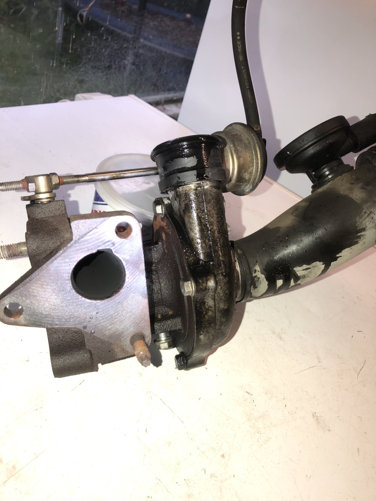

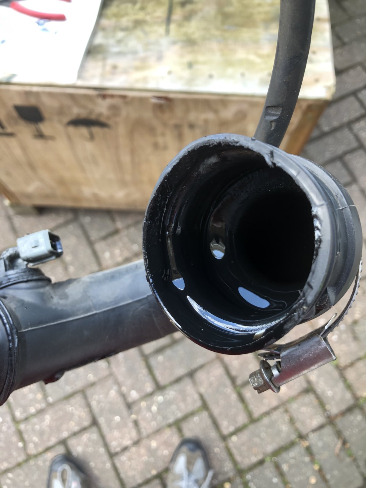

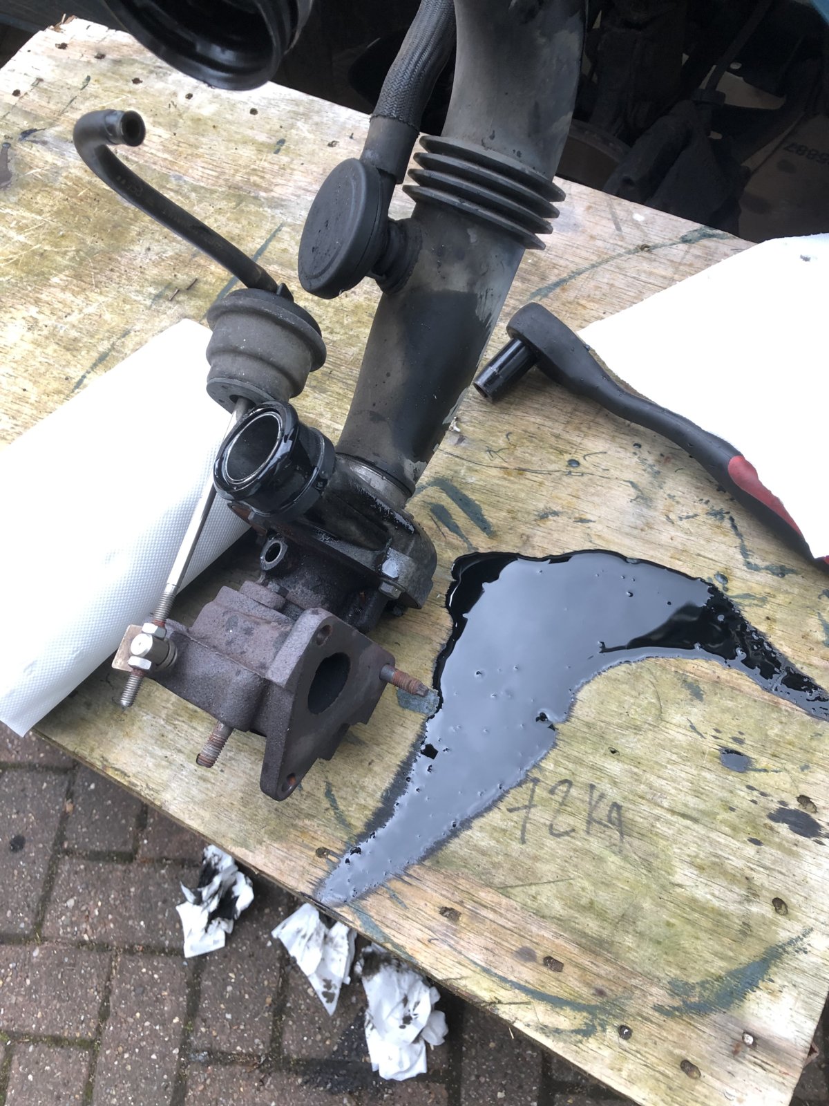

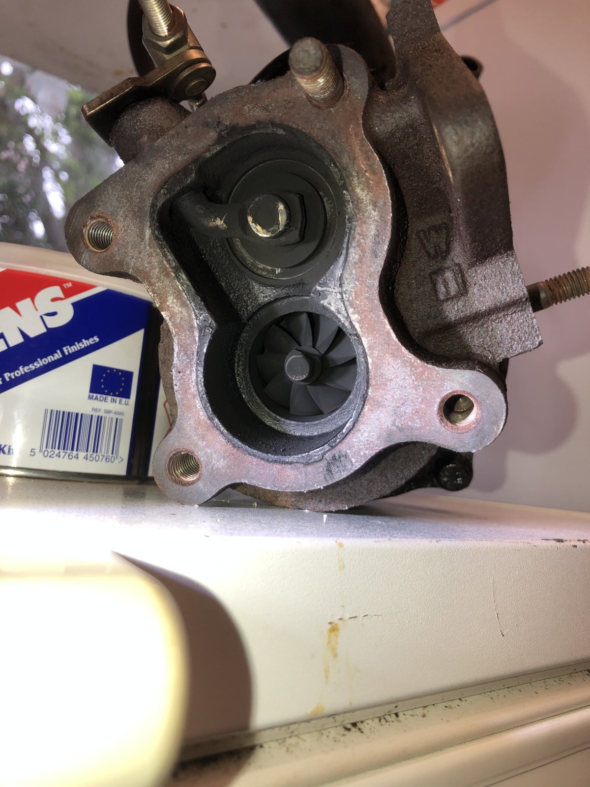

Turbocharger finally removed. It wasn’t the easiest of jobs, but I didn’t expect anything else with a Renault.
The snail / turbo casing was completly filled with oil. I’m wondering if my catalytic converter will be the same ?
  Kangoo, XJ, Jeep GC

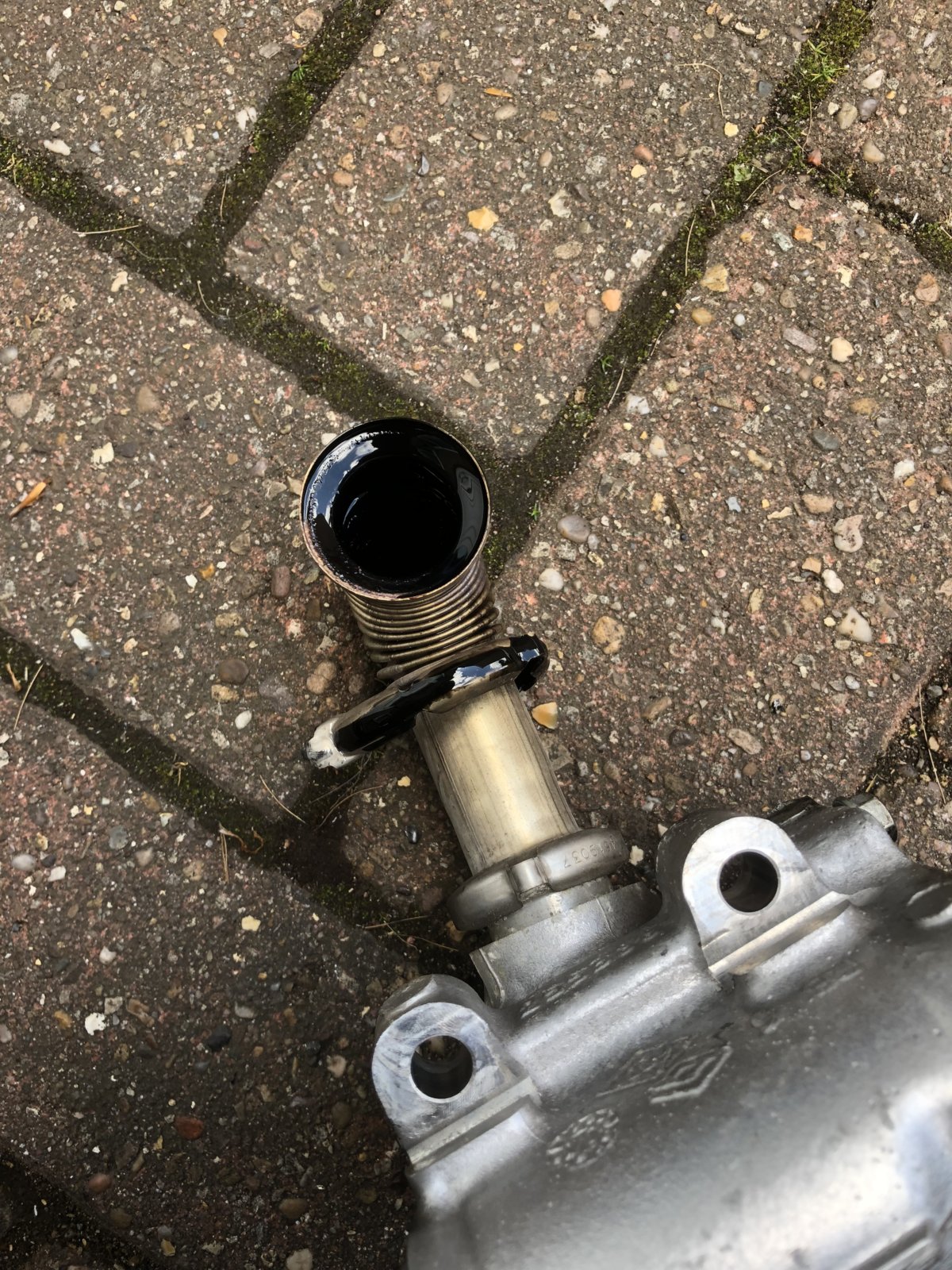

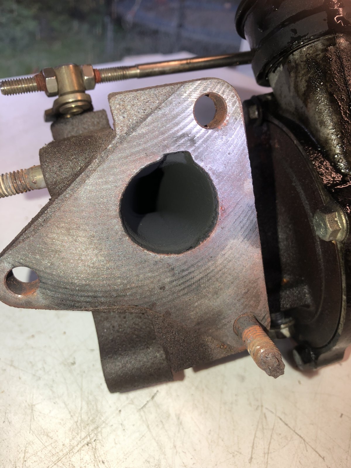

Regards my comments on the state of the Cat, the exhaust side of the turbo looks oil free, although where my cat met my downpipe it was oily.
Any thoughts fellas?

Cat will be fine, as the exhaust side is dry. Must have been on its way for a while and good hard rev has pushed it over the edge

The seal on the compressor housing has probably been worn for a while and oil spraying into the inlet on boost. It will probably have been smoking a little on boost which can go un noticed unless yor constantly looking in the rear view mirror, my clio dci was the same - smokey on throttle but OK when driving steady prompting a turbo swap recently. I only really noticed it was smoking quite a bit on acceleration when the mrs took it to work one day and was following down the street.

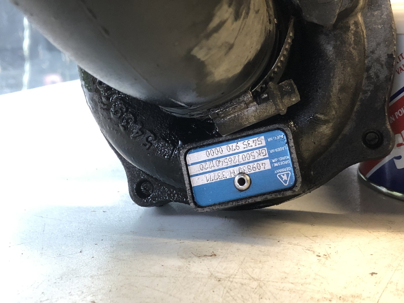

that's the same part number as a dci 65 turbo, 5435 970 0000 Borg warner K series.
not a VNT turbo as we thought when you messaged

the 65 and 80hp turbos are compatible but not the 100. I've just sold my 80hp turbo too I done a price drop on eBay after you said yours was blue label and it sold! they must have done them in both yellow and blue label depending on the supplier or something!

Check the exhaust wheel is dry and no oil on it, any oil will indicate a smoker. Can only check play in the shaft and hope the inlet seal is ok.
  Kangoo, XJ, Jeep GC
Zero fore & aft or lateral play on the compressor shaft, but the casing is full of oil.
The part number on my casing is;
5439 101 5080 (inside the diamond at the far end of the part numbers is ‘A85’) and this turbo has a blue tag.
