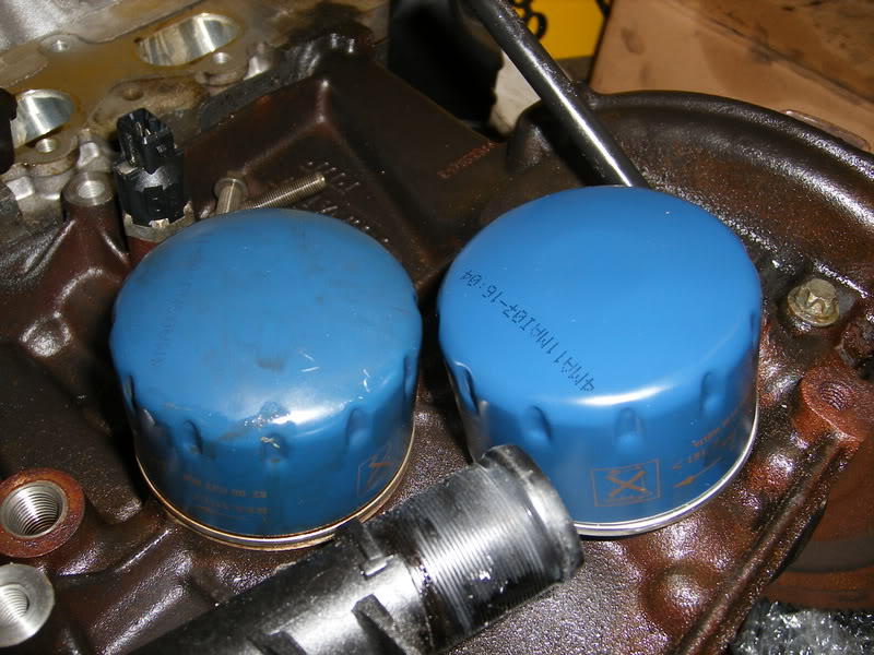

Ile pop a picture up of the engine oil filter a bit later so you can see how swolen it is.

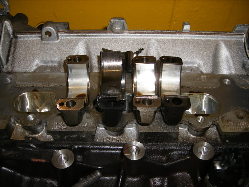

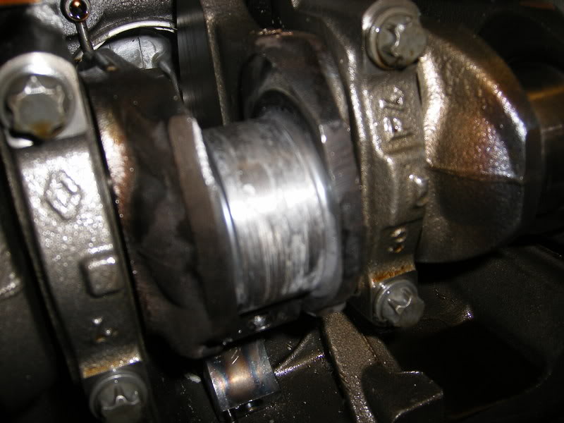

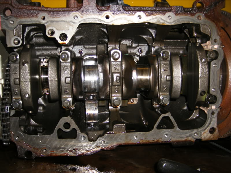

Pictures as promised....
Damaged bottom end....

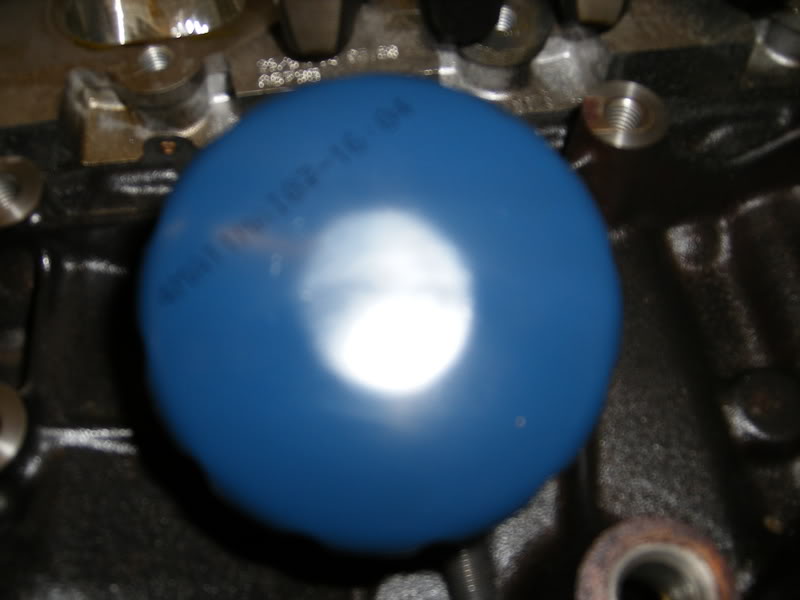

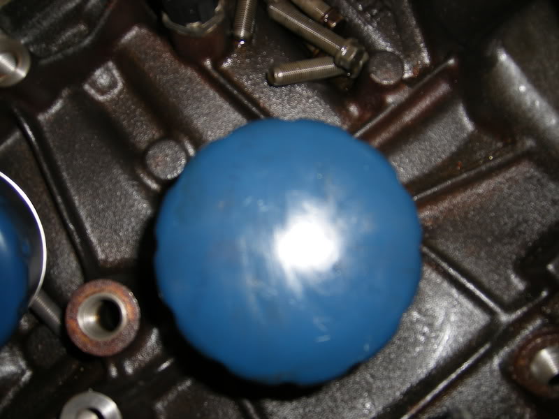

Swollen filter....
New filter not used....
and side by side...
The filter that has blown has an inch long peice of seal missing that I found when taking the engine out.
