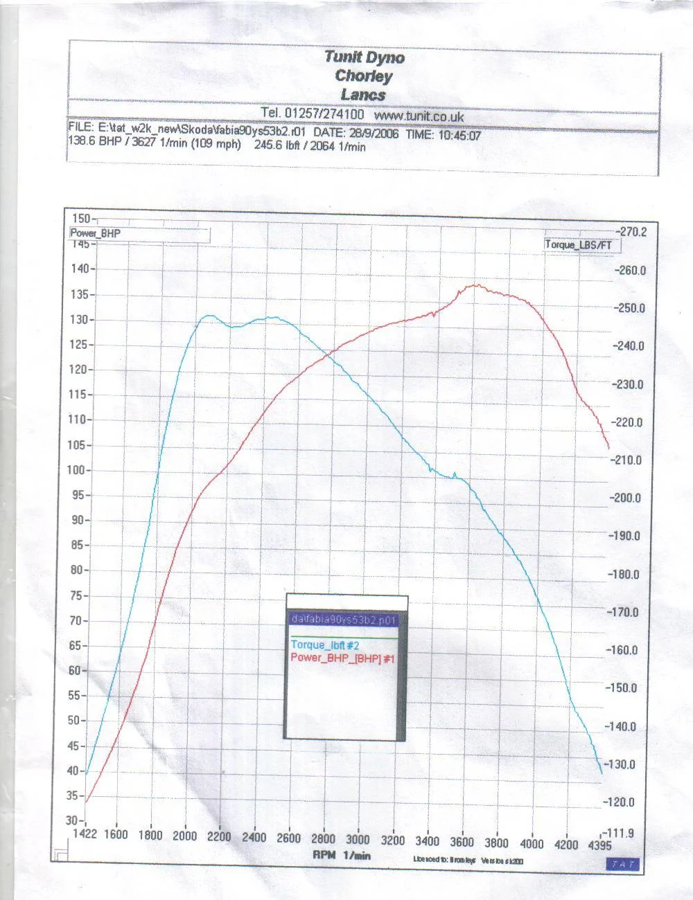

Dyno one before is what it read with faulty fuel temp sensor, which made ecu think engine flat cold aparantly, and with 9k miles on seemingly slightly over filled 5w-30 oil.

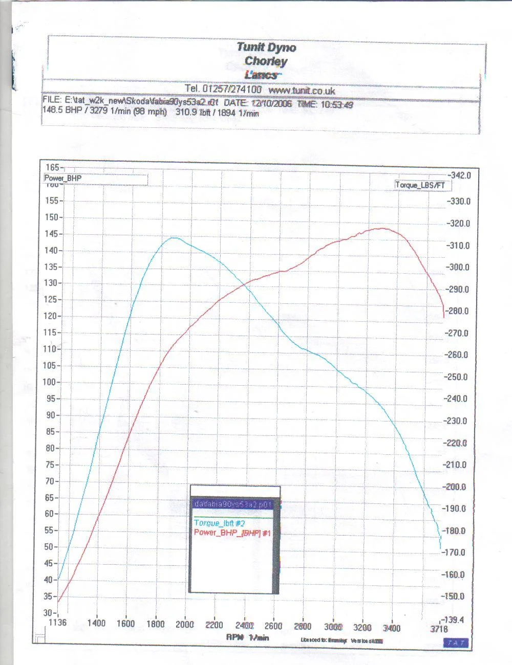

Dyno two after is what it read after fuel temp sensor fixed, fresh 0w-30 oil and oil filter, with my re-working of the air intake/box setup.

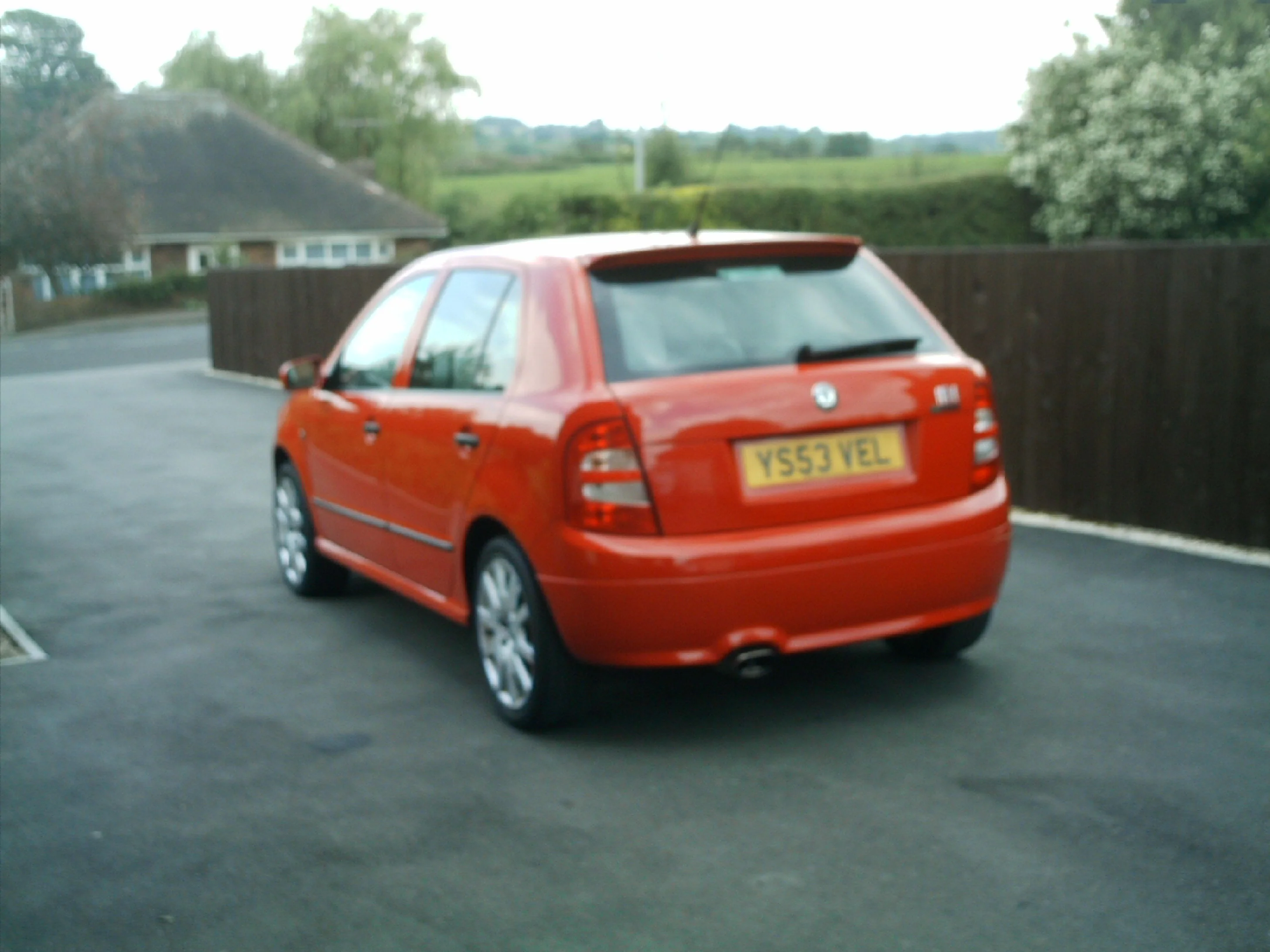

The other pictures are the baby hereself. Fully insured of course with custom intake, means too much to me driving and the car to take risks.

Would be interesting to see how that torque figure translates into outright performance. What is the MPG like now?
  Volvo S60 T5 asap
on my usual trip from just off J36 m1, to ccl off a650 (from J41) I get around 60mpg @ 75-80mph. Normal spirited driving on local twisty roads etc, 45mpg ish, had upto 80mpg out of it at 60mph ish.
Its getting custom ecu-tuned 1 week today. No more peak torque, or no more than another 5lb-ft or so, but tuned in a way that it lasts longer, so I still get max bhp gain (looking at around 180-185bhp a bit further up rev range) will still get same mpg then driven at same speeds, maybe even more, as it need less throttle etc etc.
