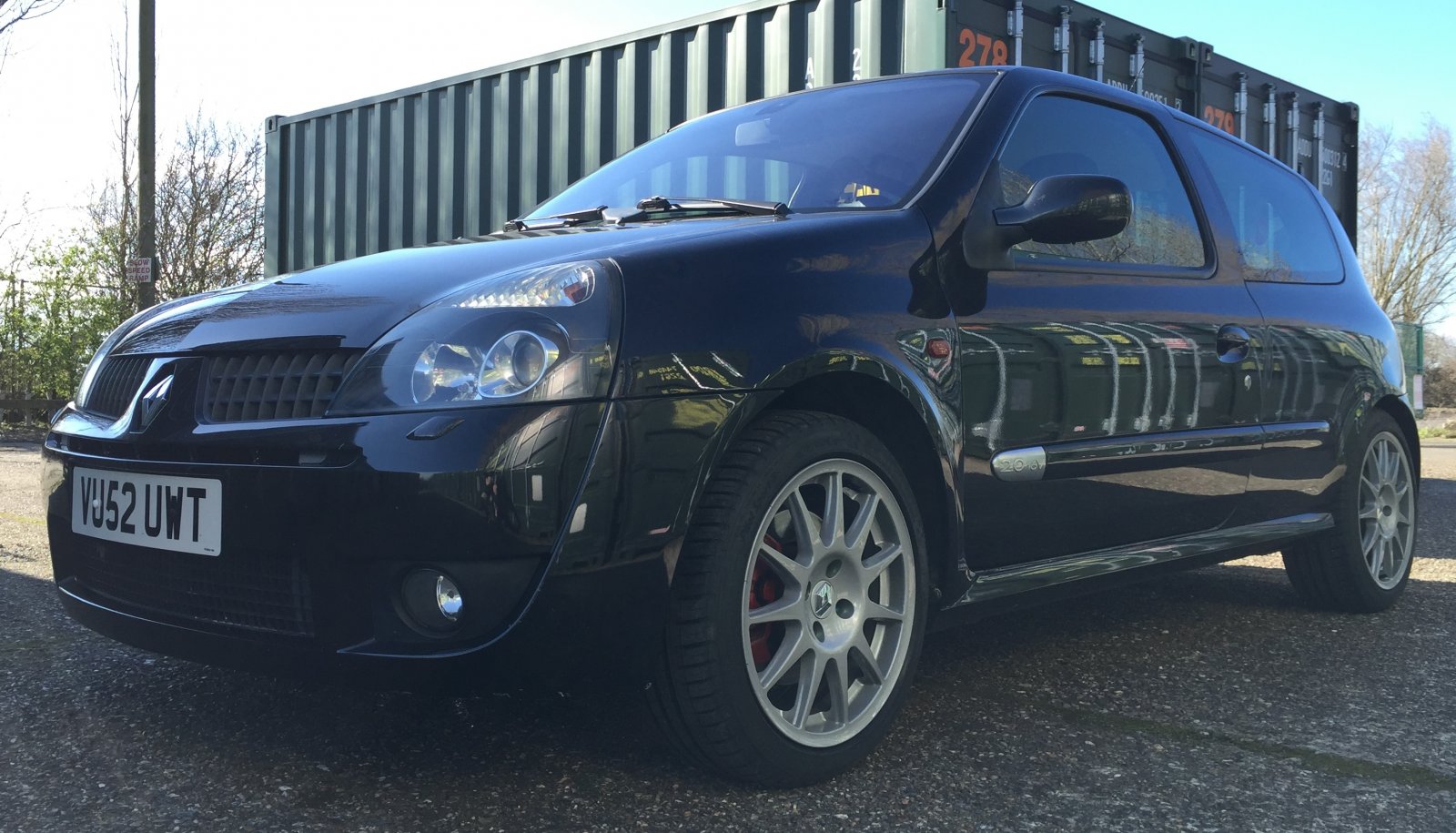

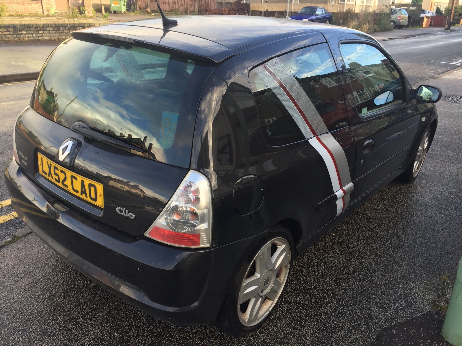

"The Good" Clio 172 Pearl Black

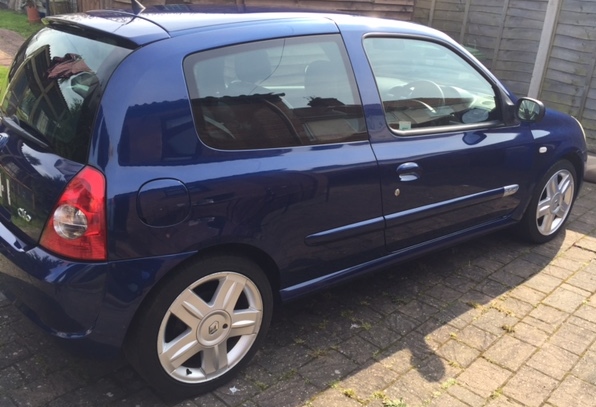

"The Best" Clio 172 Monaco

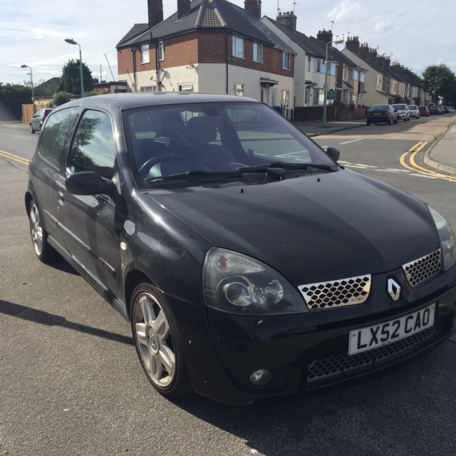

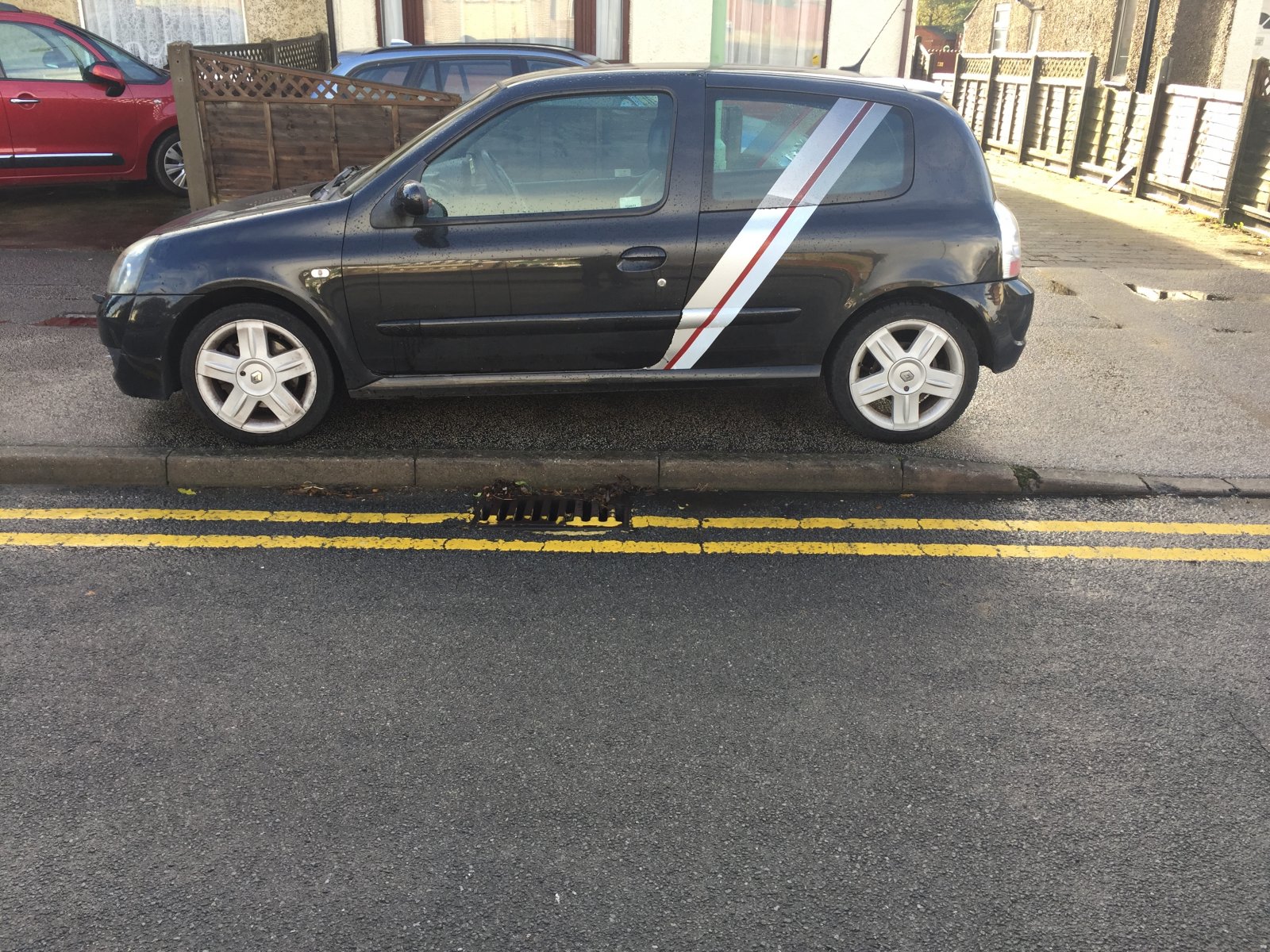

And wait for it............ THE UGLY
So currently, I am on a mission to make "The Good" and "The Best" kinda perfect, sometimes with the help of "The Ugly". Just so you know, Ugly is just a spares car, so don't get overwhelmed with rage and hatred at the Ktec Grill! The original grill is having a black refurb.

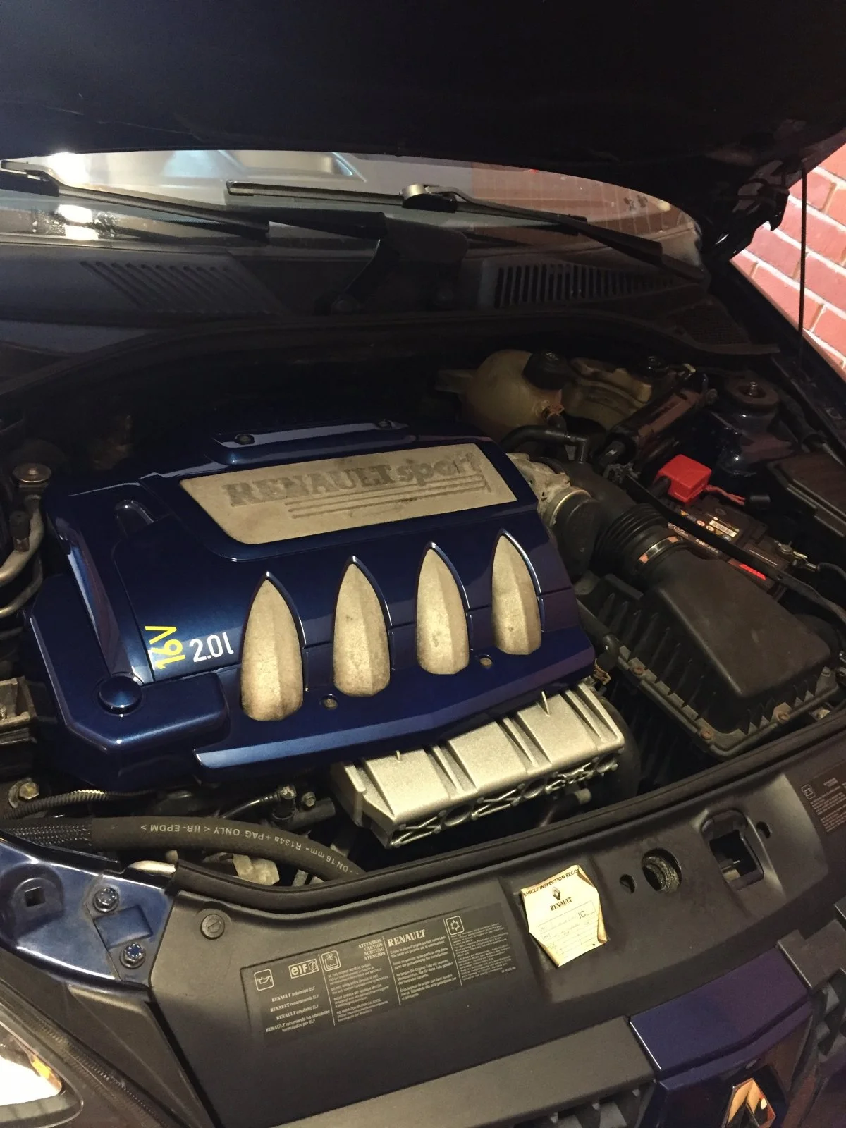

My main focus right now, is the Monaco 172, purchased in April with 60,000 on clock and the only mod, a 182 exhaust manifold. First job, a trip to Engine Dynamics for Major Service, Cambelt Kit, Dephaser, Aux Belt Kit and Water Pump. Also fitted a Ktec Sports Cat (one that fits the 182 manifold, but fits 172 exhaust) and added Ktec Stealth Exhaust. Clean bill of health given and its said to be "a good one"... phew!! Whilst safe in the knowledge the car is mechanically sound, the bodywork needs improvement. I had all the car parking dents removed, but future plans include a new bonnet, and a visit to the spray booth! But I do have some goodies ready for this car...

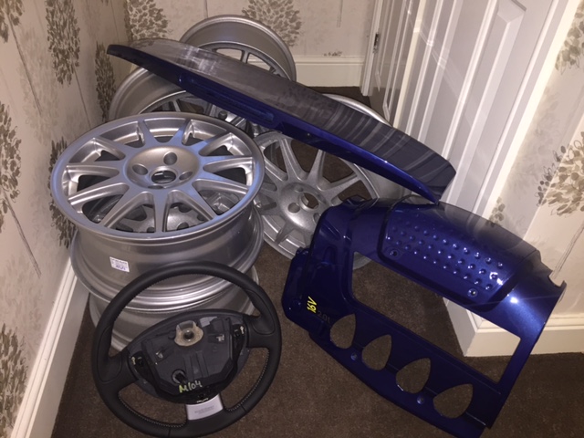

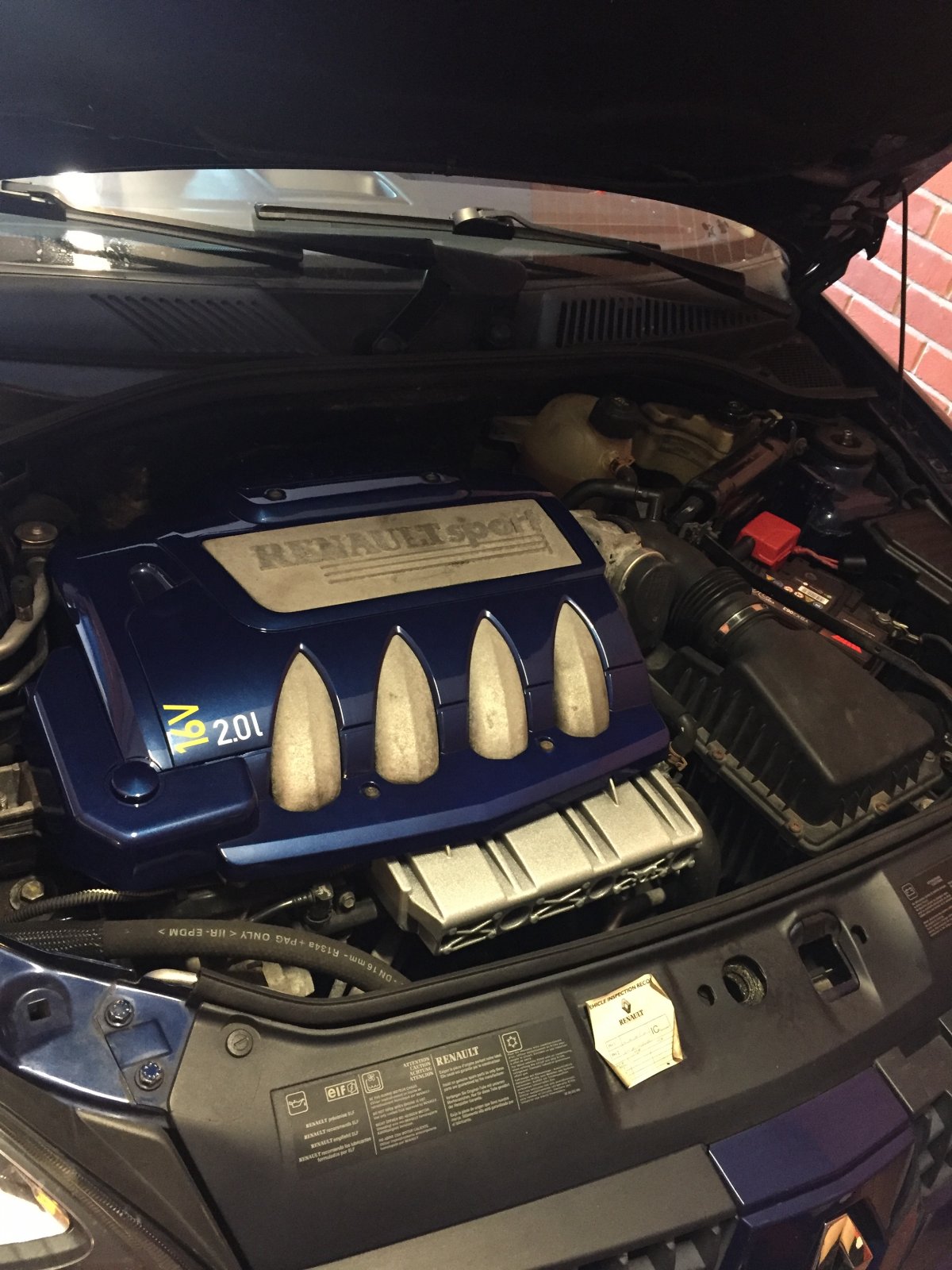

Five newly refurbished Silver Turinis, Snappy Wheel and newly sprayed Cup spoiler and Engine Cover.... Currently saving for Michelin PS3's!

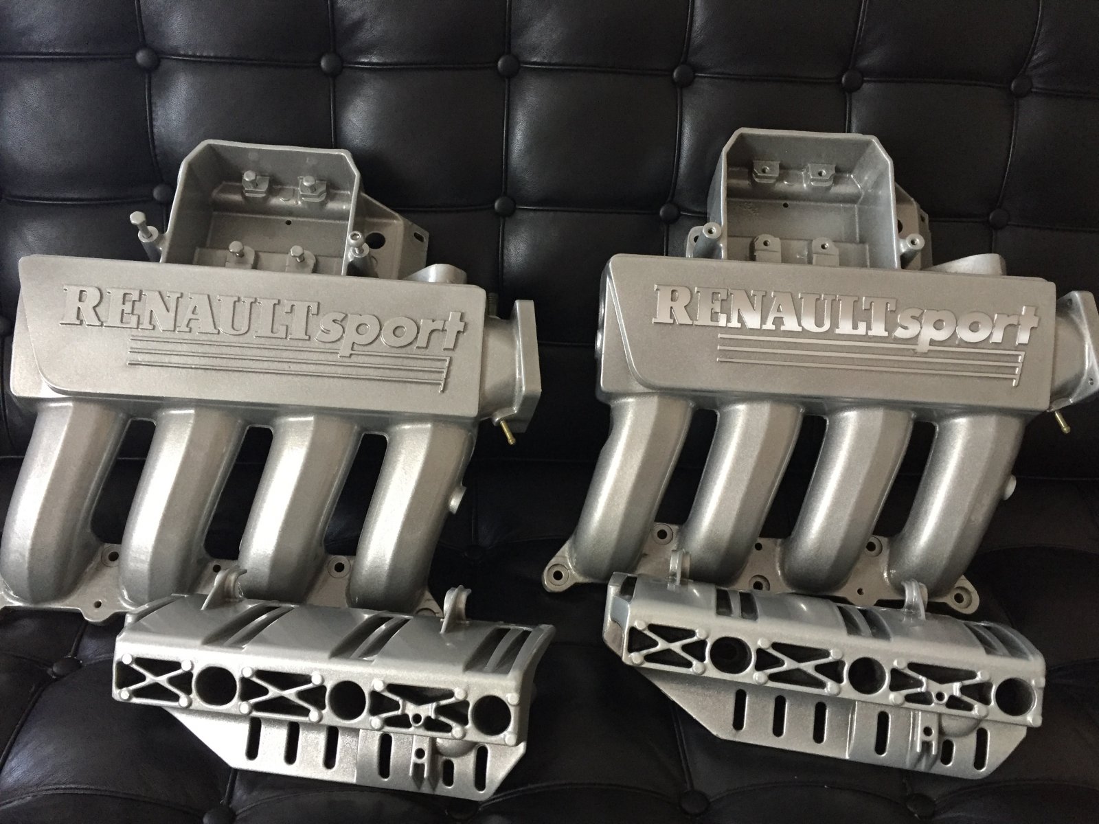

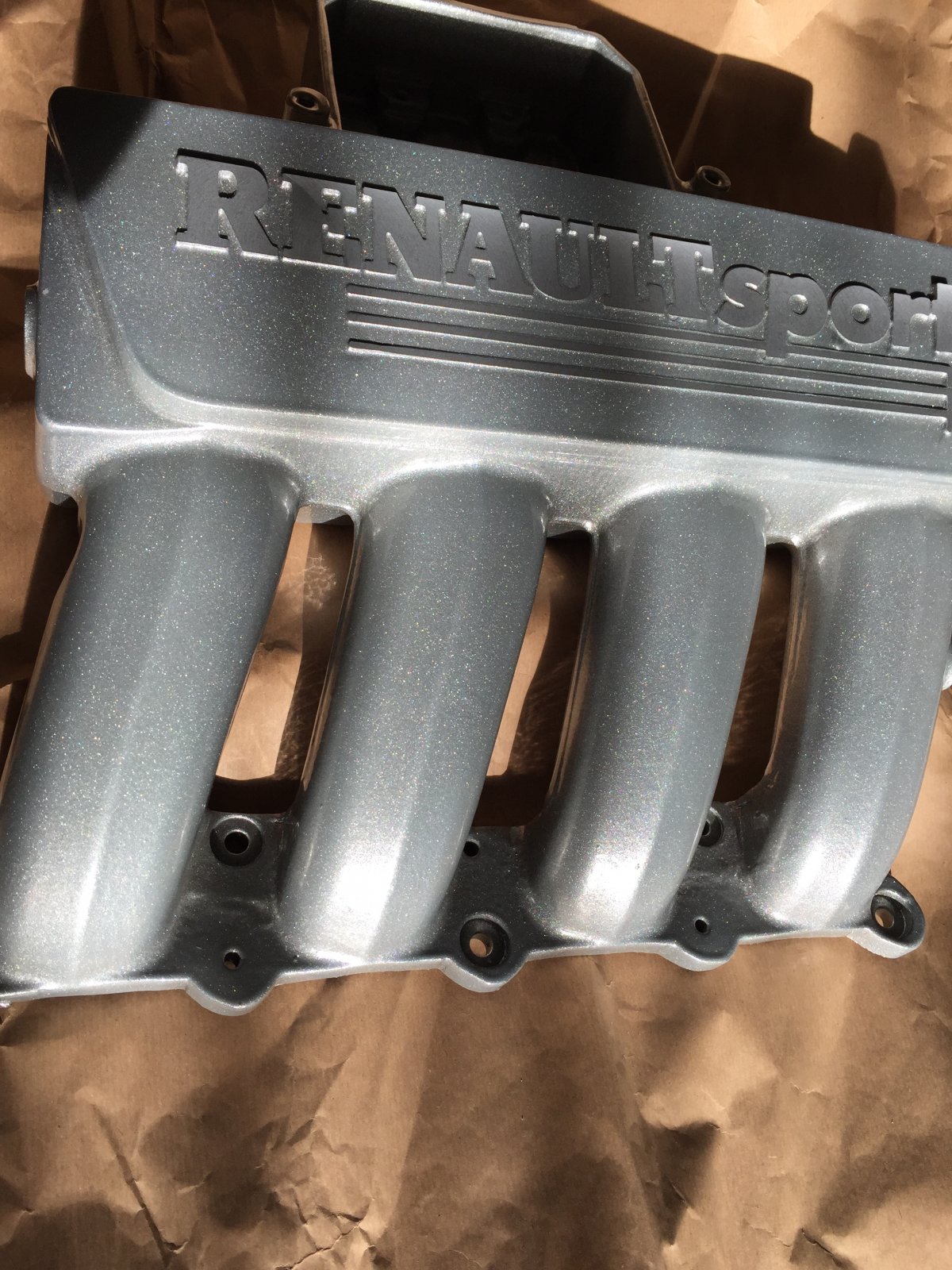

I got me some sparkly powder coating...

One inlet with one fuel guard was £35.
I've since had the wording on one manifold metal/machine polished to reveal the shiny lettering again.

So last week the "good" black 172 had a trip to Engine Dynamics for Cambelt, dephaser, waterpump and alt belt kit. Plus oil and filter change and vehicle inspection. I also had fitted, a new dog bone, gearbox mount, engine mount and goodridge braided brake hoses. It came back also having had the engine mount bracket, top inlet manifold and fuel rail guard swapped for the freshly powder coated silver ones. Overwhelmed by its fresh look, I forgot to take a photo... doh! Will get one next time.

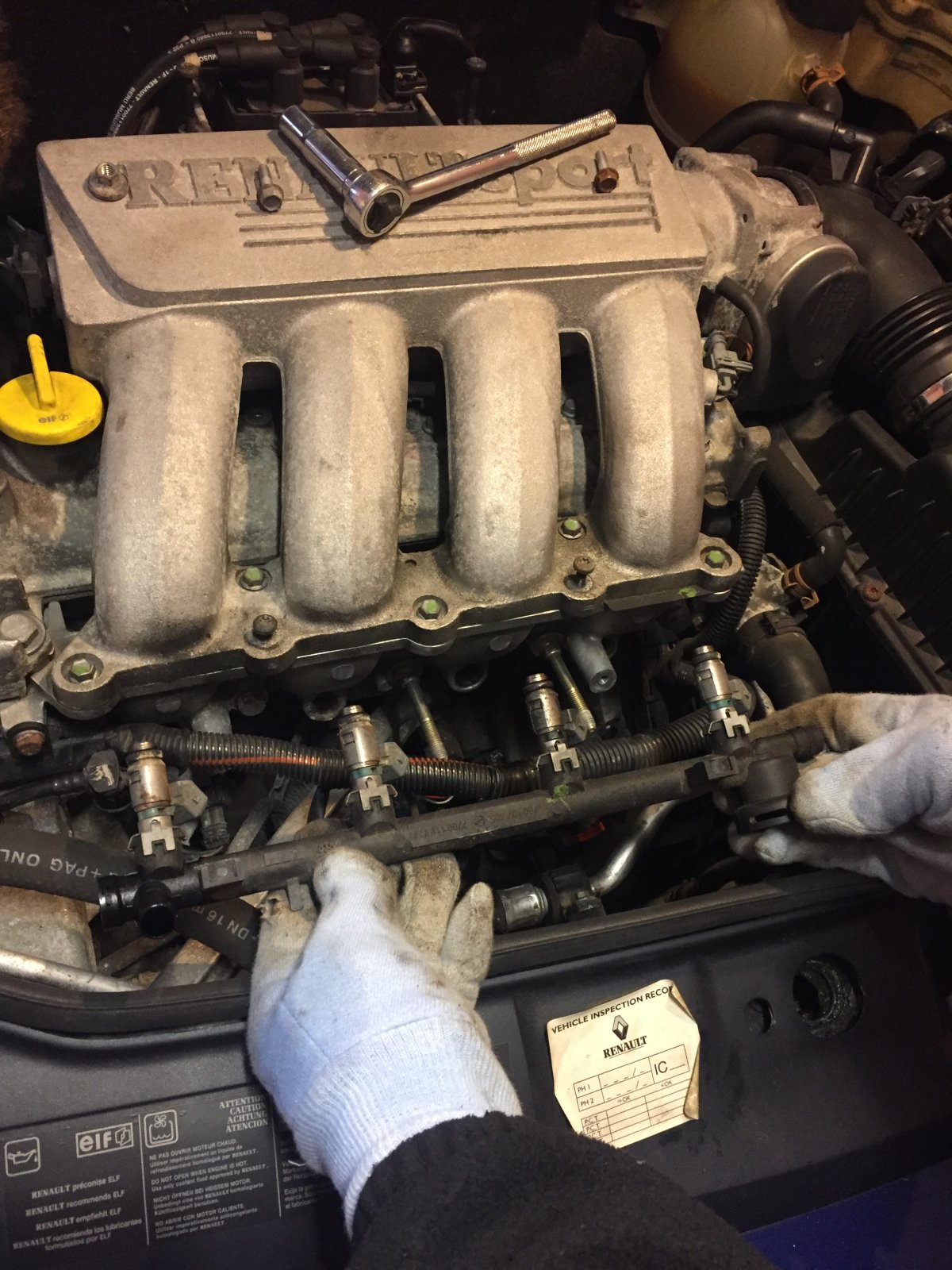

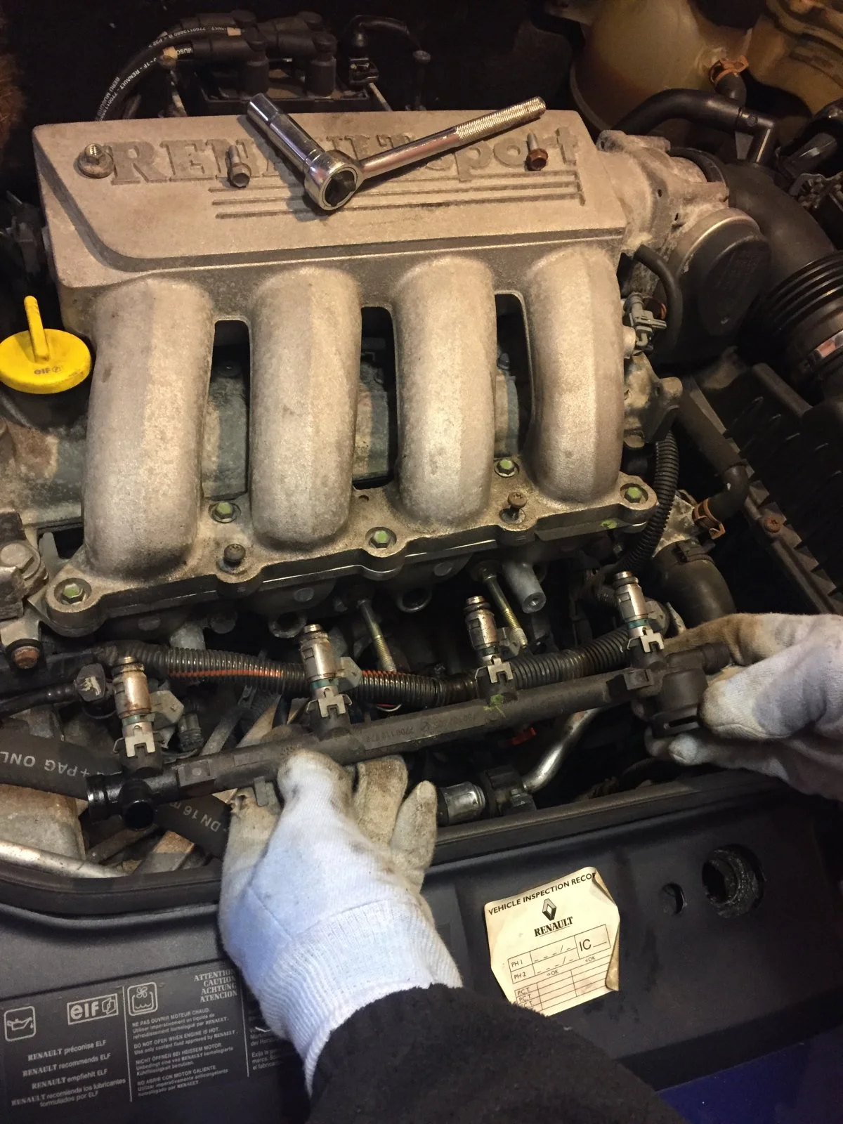

Today, time for alittle car DIY... The Monaco had started to use copious amounts of fuel, smelled strong of petrol and not running quite as well. Today we fitted four new injectors and both oxygen sensors. It's rectified the overfueling and now is running spot on. It's booked in for an MOT Monday, and I'm hoping it sails through as already spent £1000 in 2 weeks on clios!
