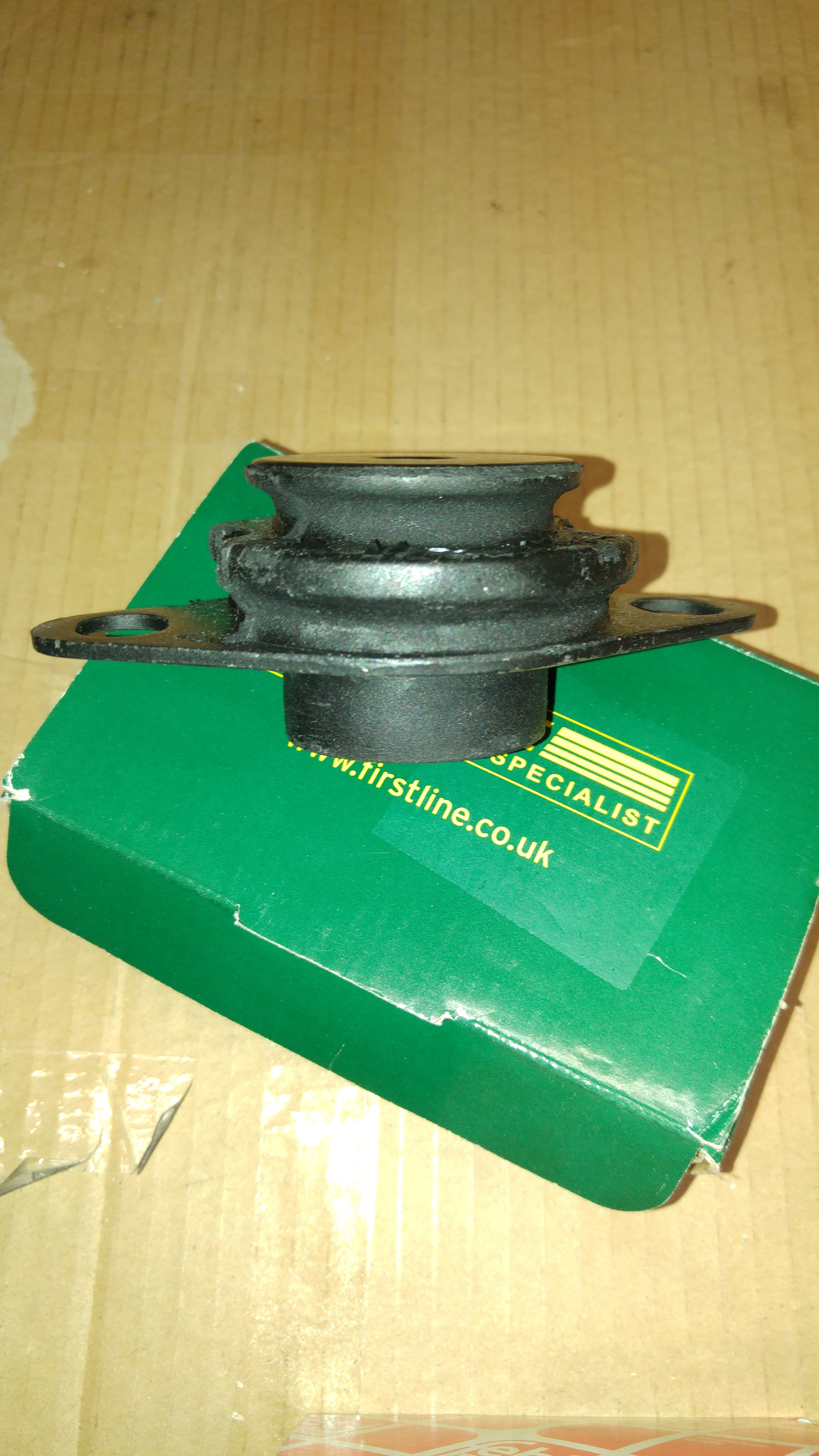

Finally have the engine running happy, and now i am able to drive the car i notice it handles like a pig and struggles to get in to gear

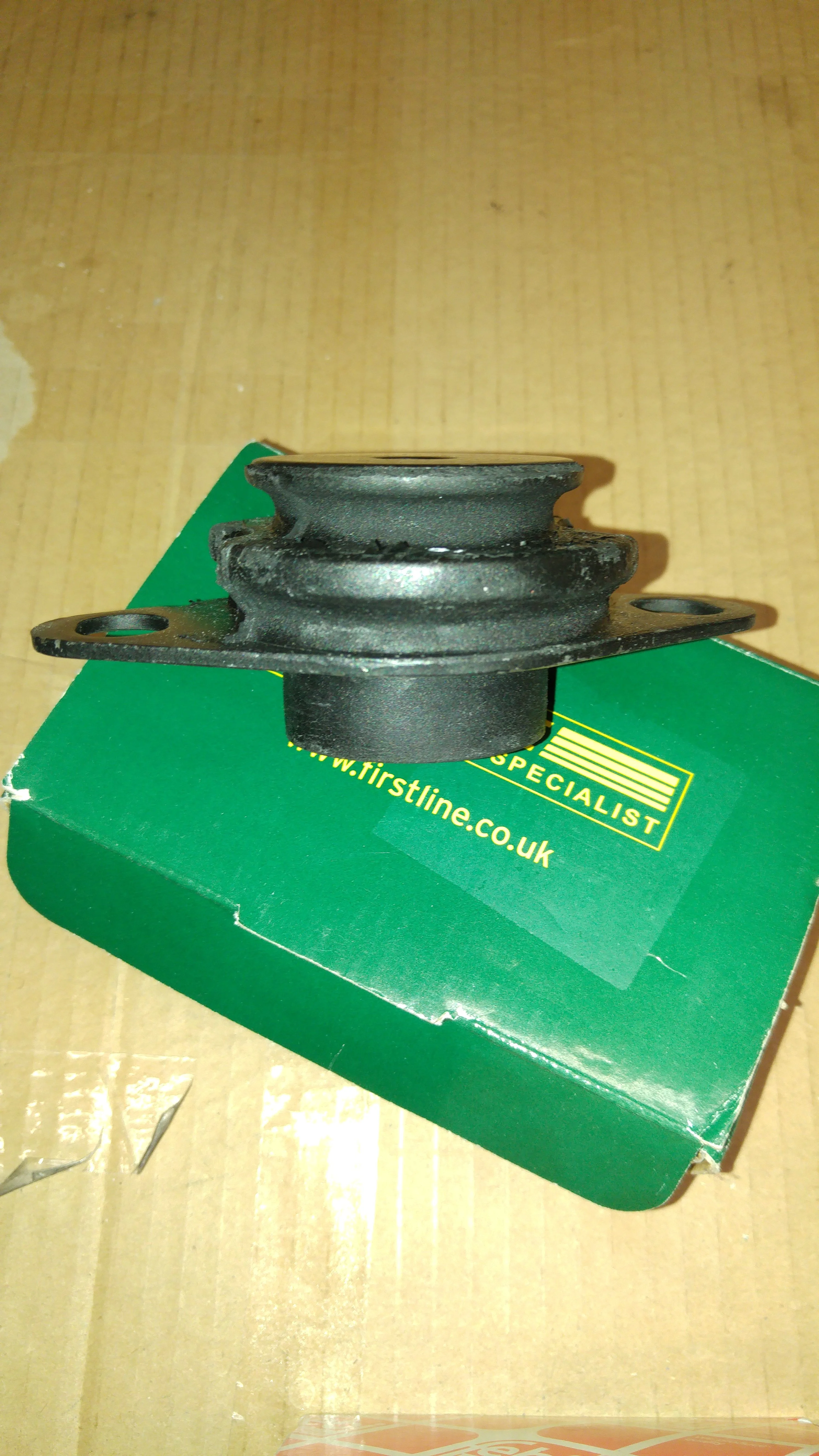

So first point of call is Powerflex bushes for the twisted engine mount (car finds gears beautifully now)

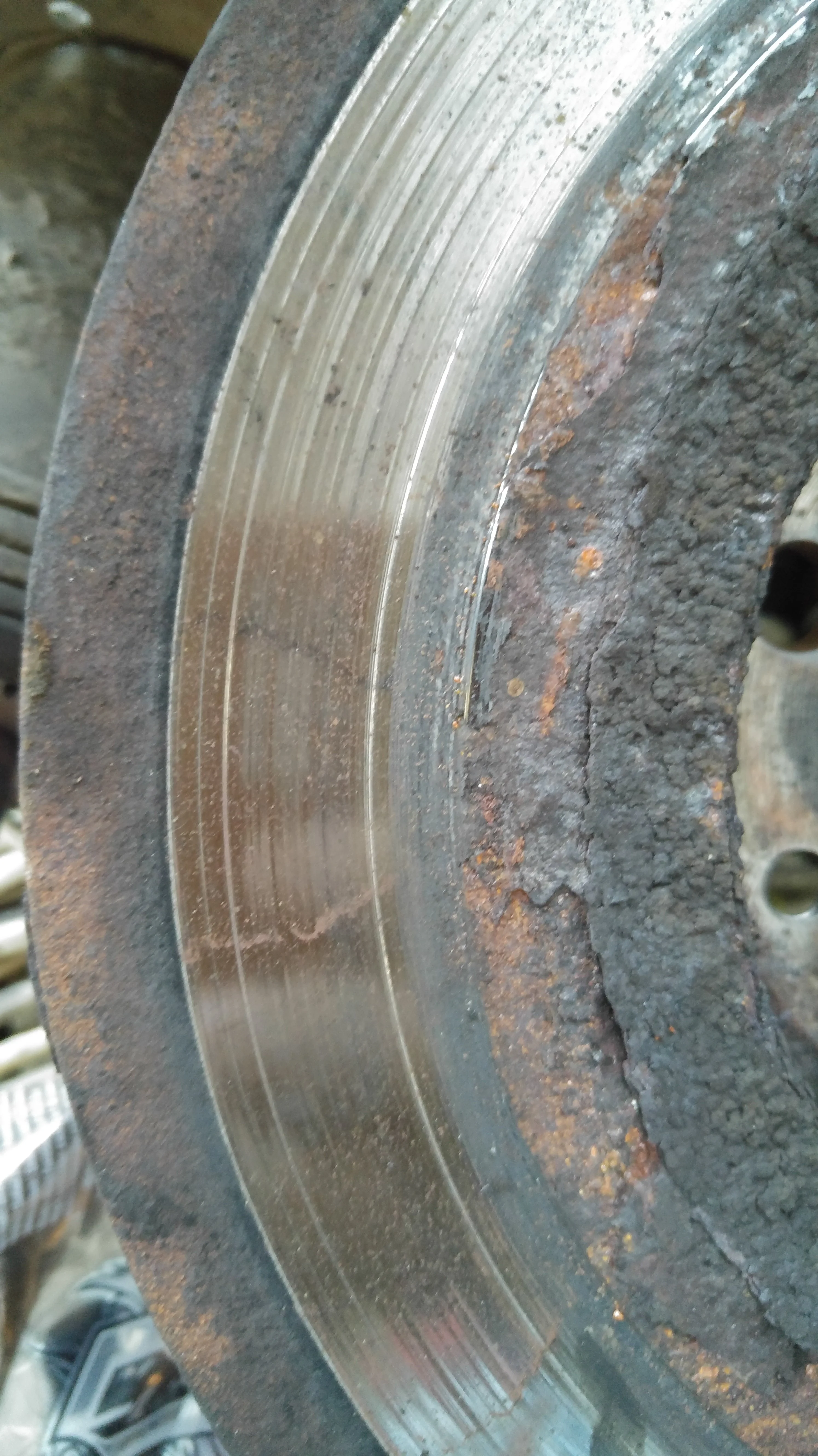

Coilovers, Powerflex bushes for arm, new discs and pads (front and rear), track rod ends, inner tie rods, ball joints, ARB bushes/droplink fitted and tracking done (Still pulling to the left but the camber is -2 on left side -4 on right side and there is a strange single clonk sound when braking at slow speeds/ accelerating at slow speeds)

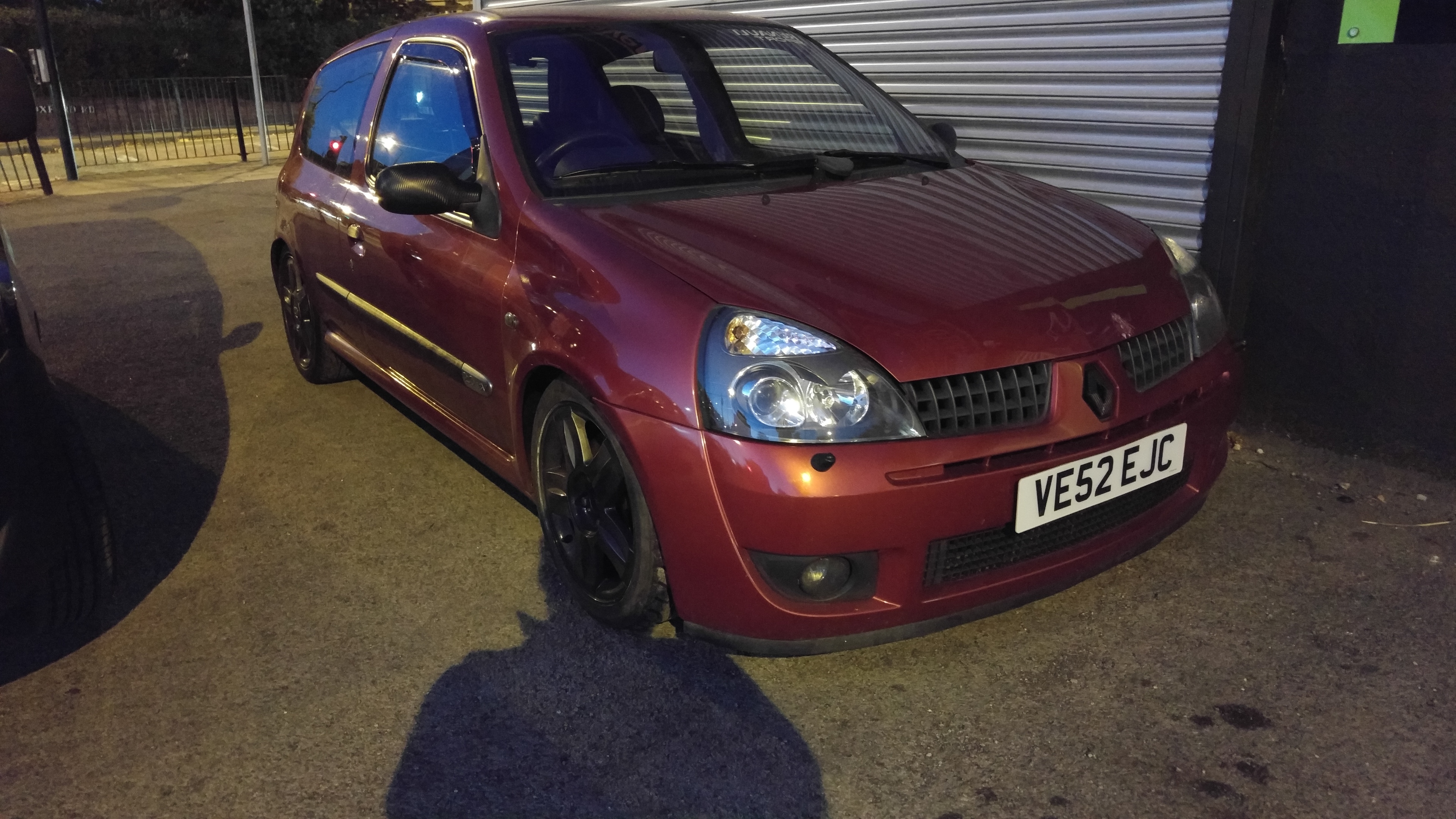

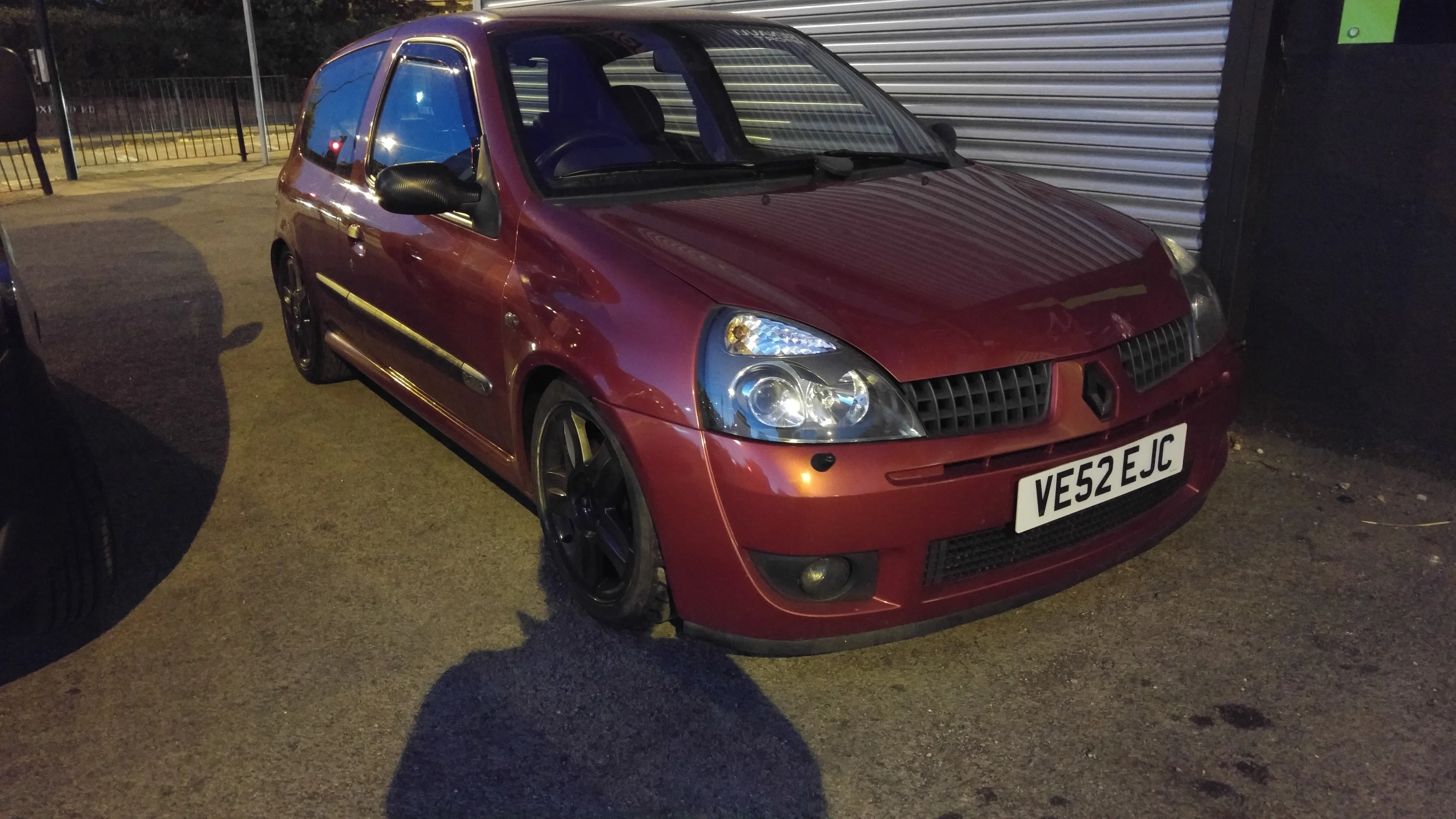

Picture is how the car stands now.

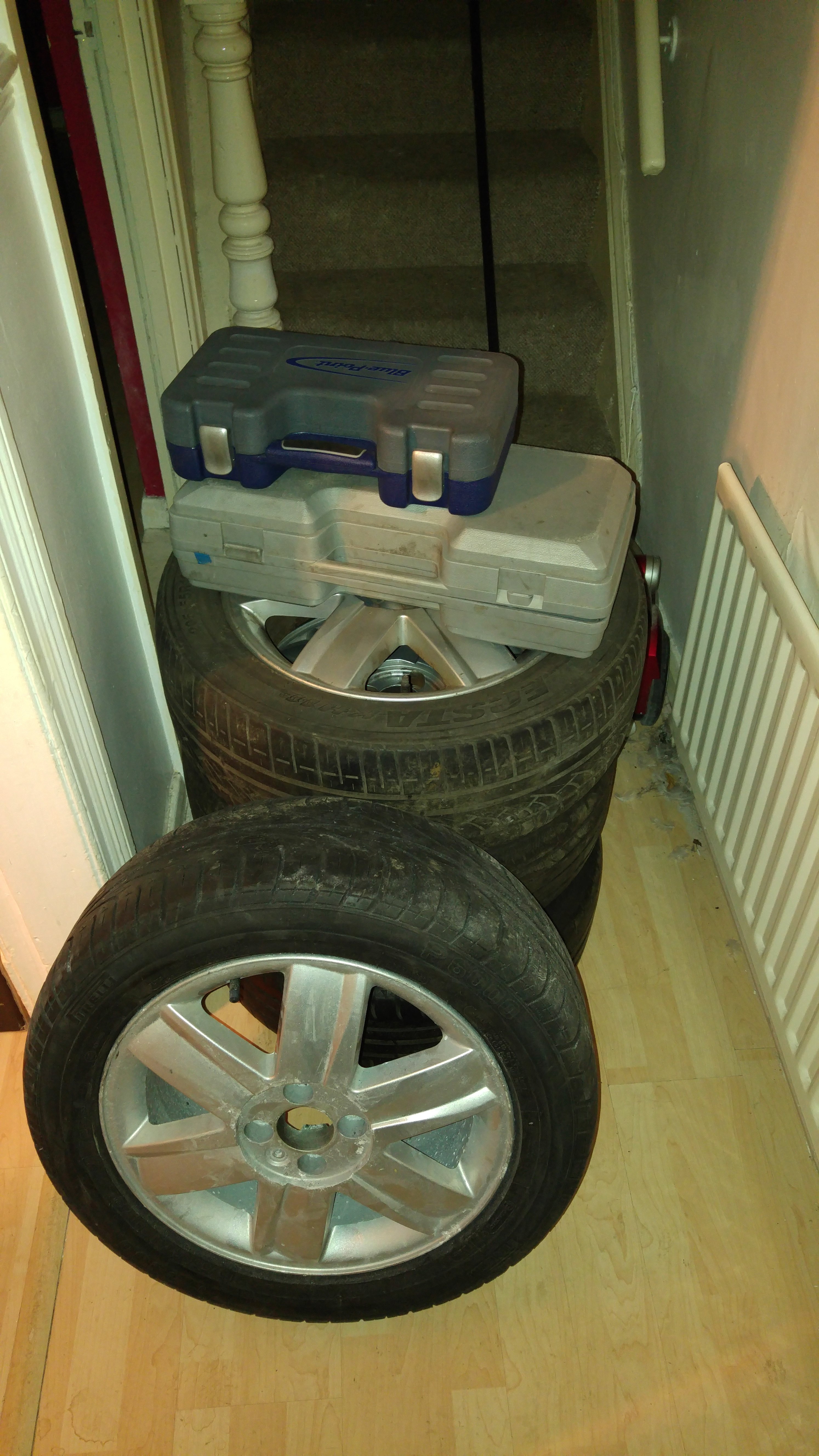

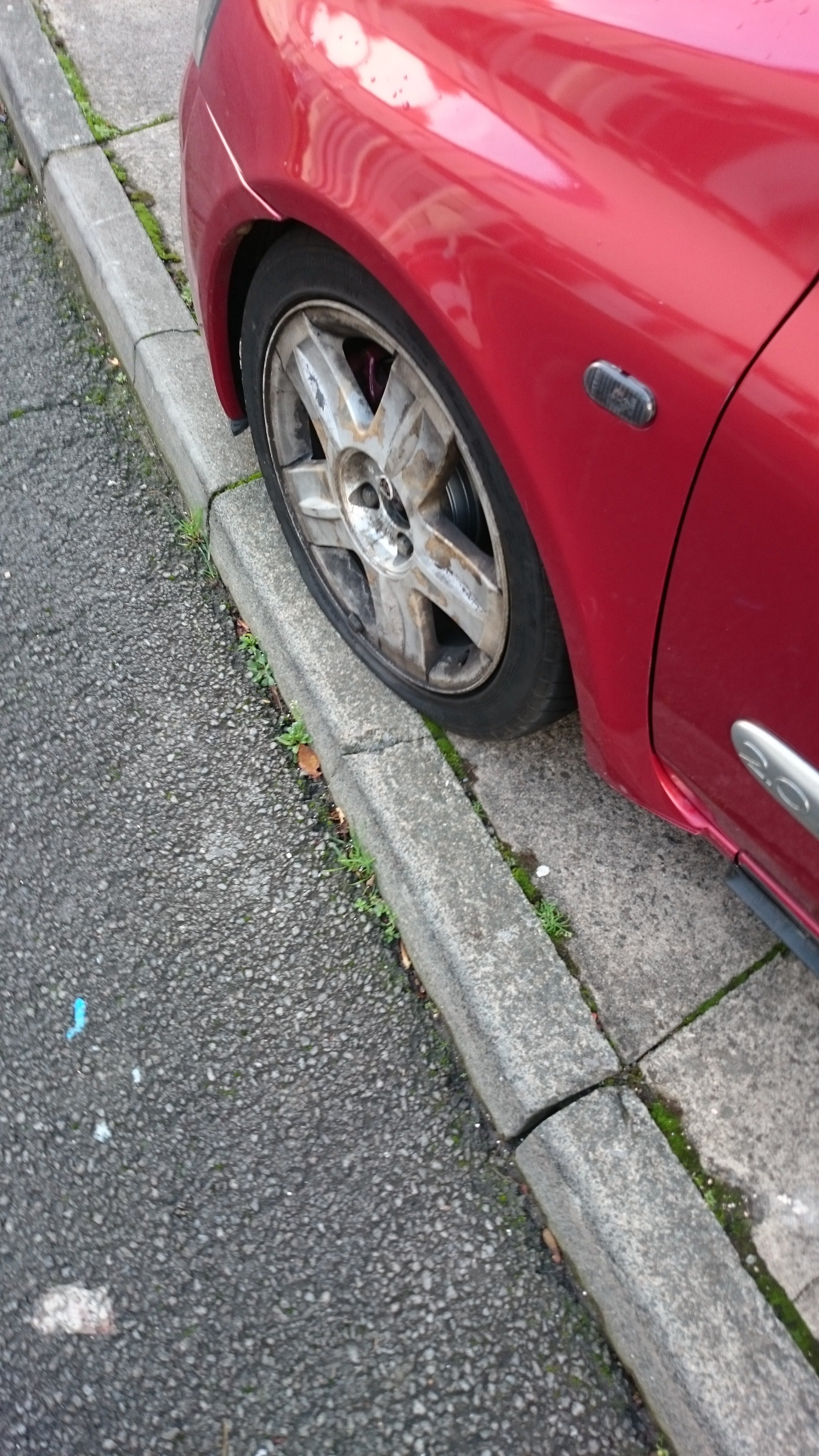

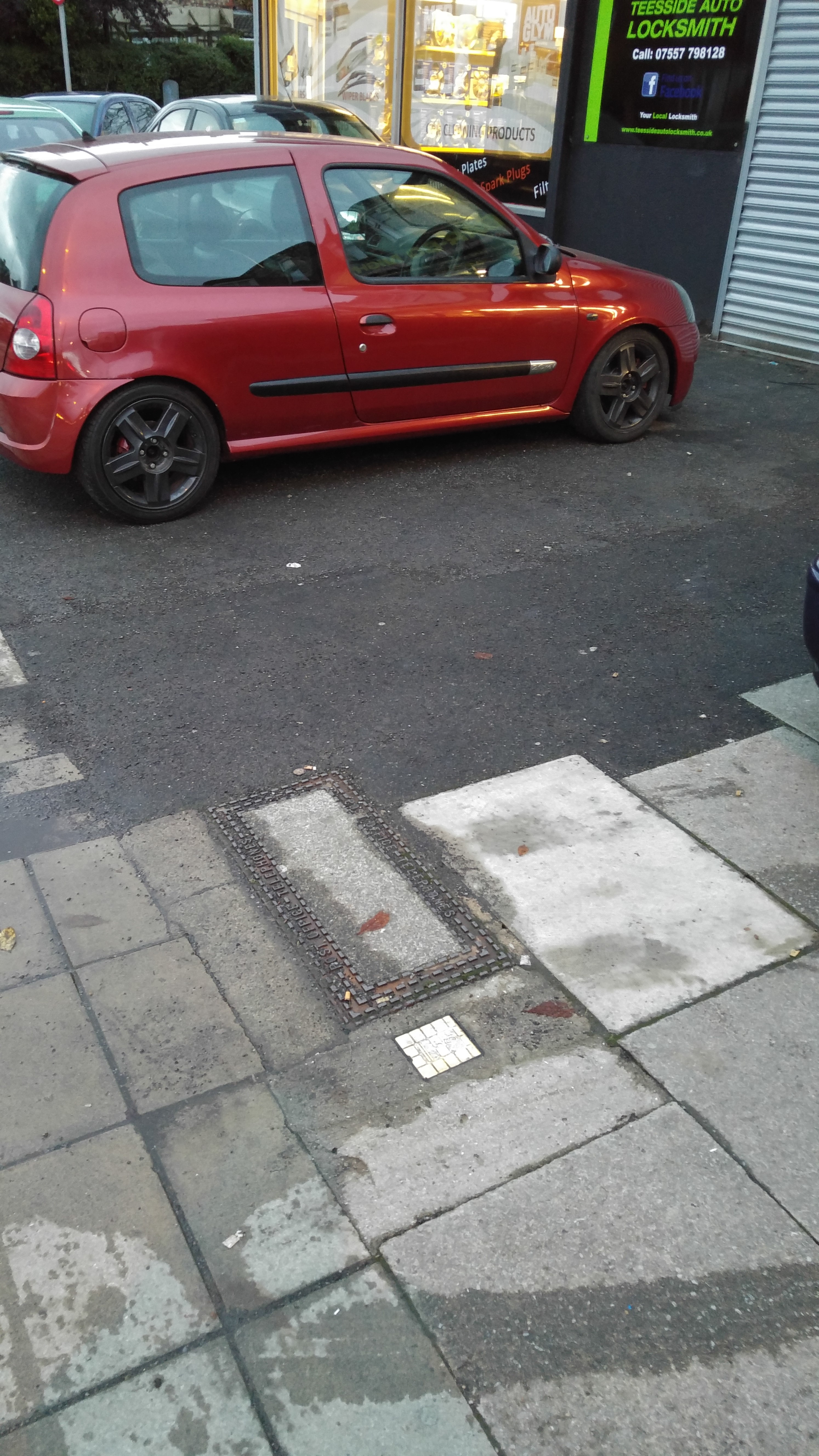

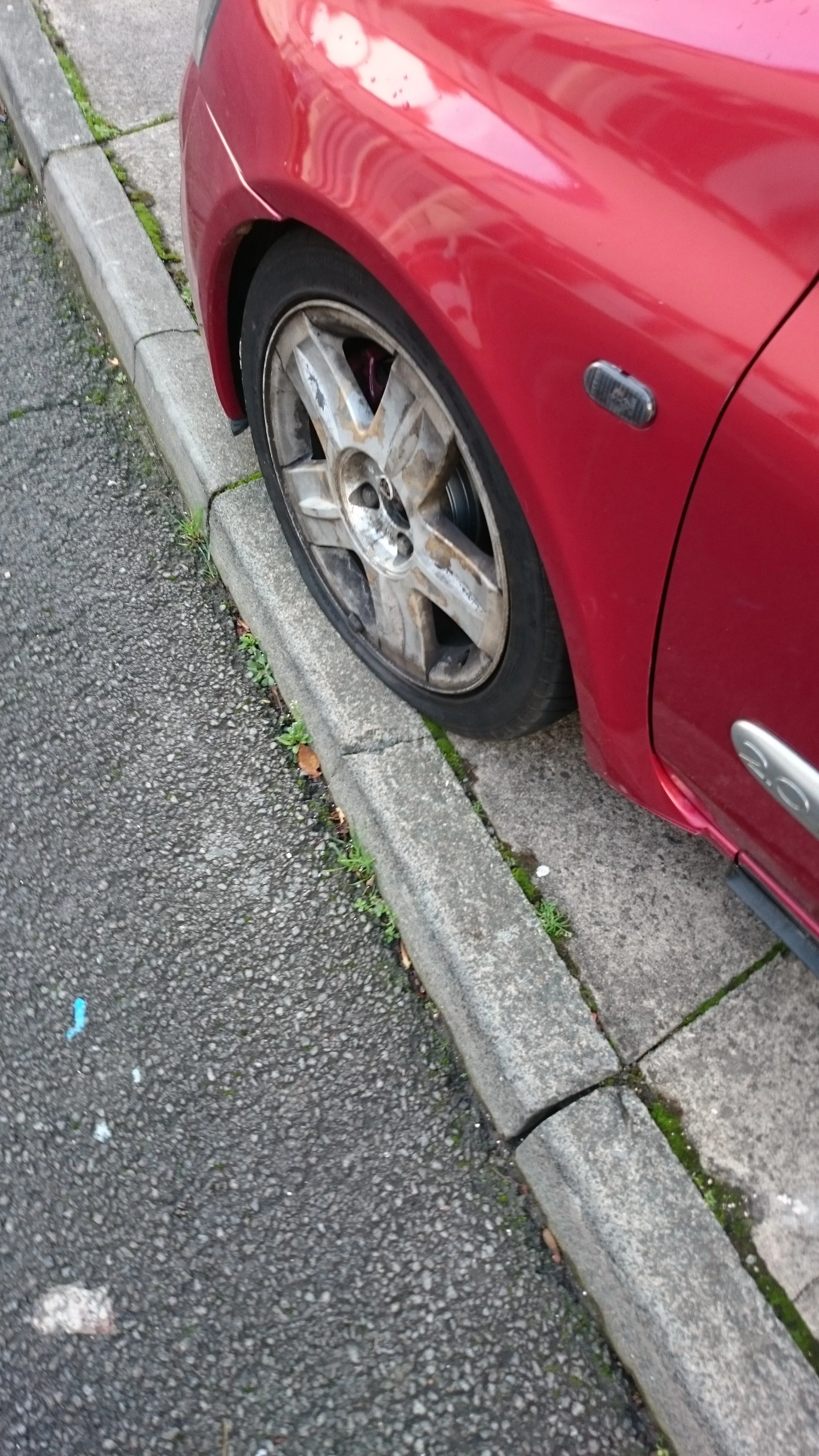

So in the epic battle of my Wallet VS the Clio i was coming out ahead, i had a small knocking sound from somewhere in the suspension but that was nothing that had me worried, a quick visit to my local Northeastern Tyres had my tracking sorted out to an extent, things where looking up. Feeling relaxed and confident i would be able to finally enjoy this little wonder, i decided that i would treat my self to a lovely new gear knob (get rid of the RumKish momo one) and some new suspension bits (to cure the knock).

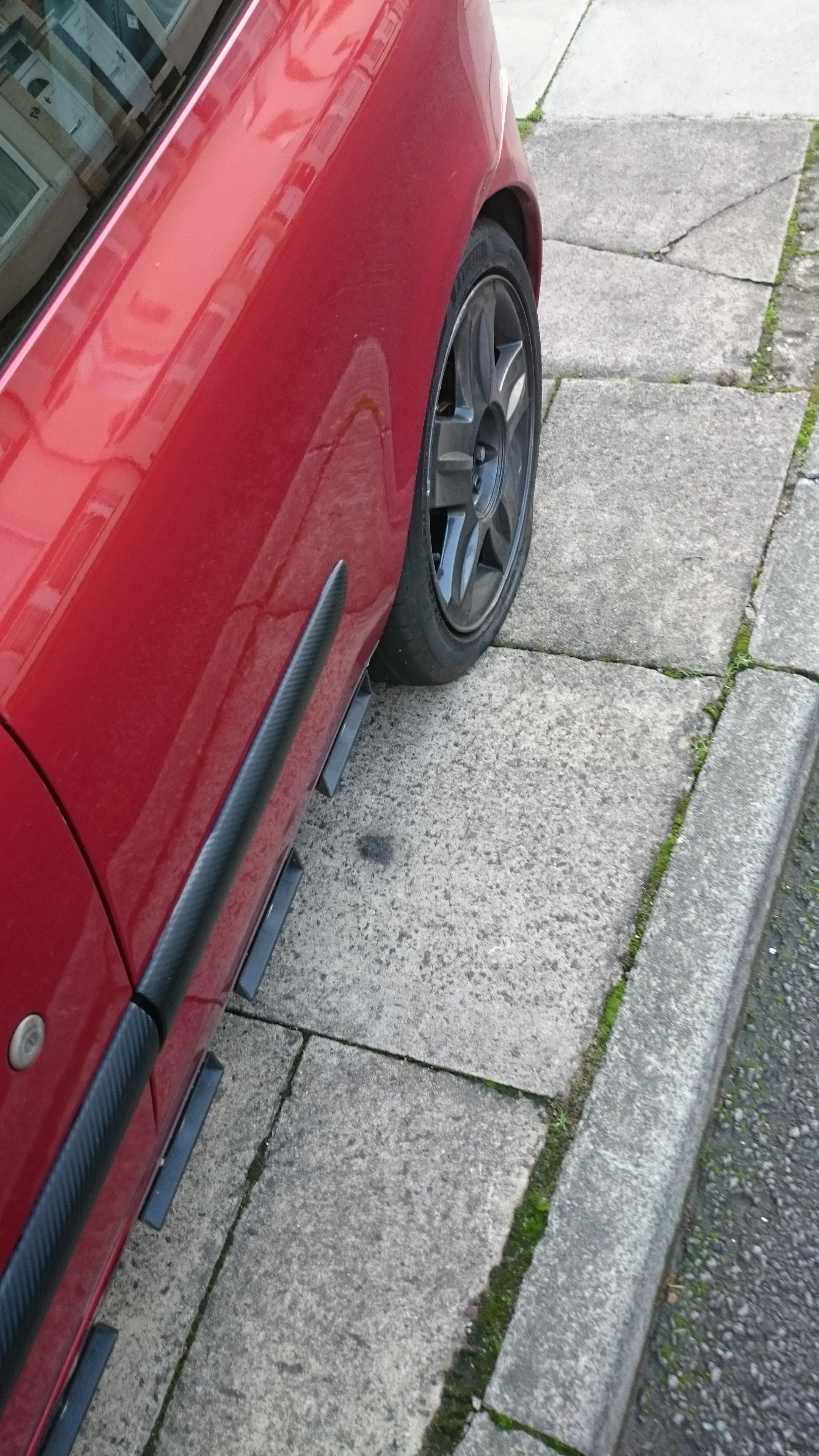

So i wake bright and early ready to take my car in to the shop for a little suspension love (cure the knock) and to my utmost surprise i find that some little f**king scrote has decided to stab my tyre's, to be fair i do live in the ghetto but still tears where shed :'( then i pulled my self together and purchased a ugly set of 16" Megane rims for the princly sum of £50 so i could at least move my car to the shop (still not actually put them on the car yet), and went to camskill to order a new set of Uniroyal RS3 in 205/55/15 then realized my mistake the moment i received an email saying they had dispatched the tyres :/ but on the plus side my gear knob is awsome :)
A few pictures to go with this wall of text.

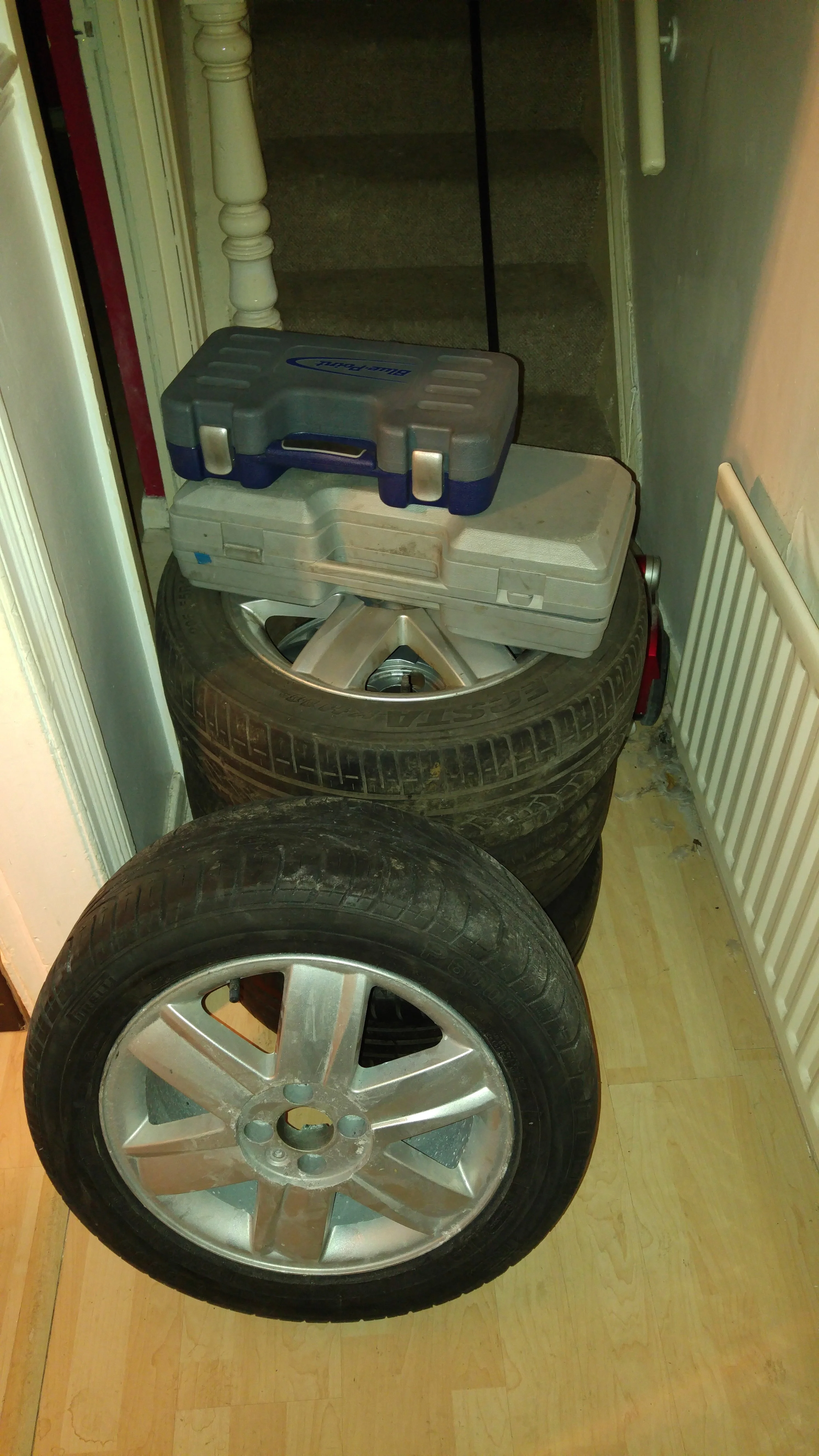

So this morning i go outside before work and change the wheels over in the snow :), eager to drive to work and get out the cold i start her up and i am greeted with the revs hovering at 2K and the limp home light coming on. quick diagnostic check is throwing up TPS issues :( quick call and £159+VAT i will have a new throttle body for Monday.

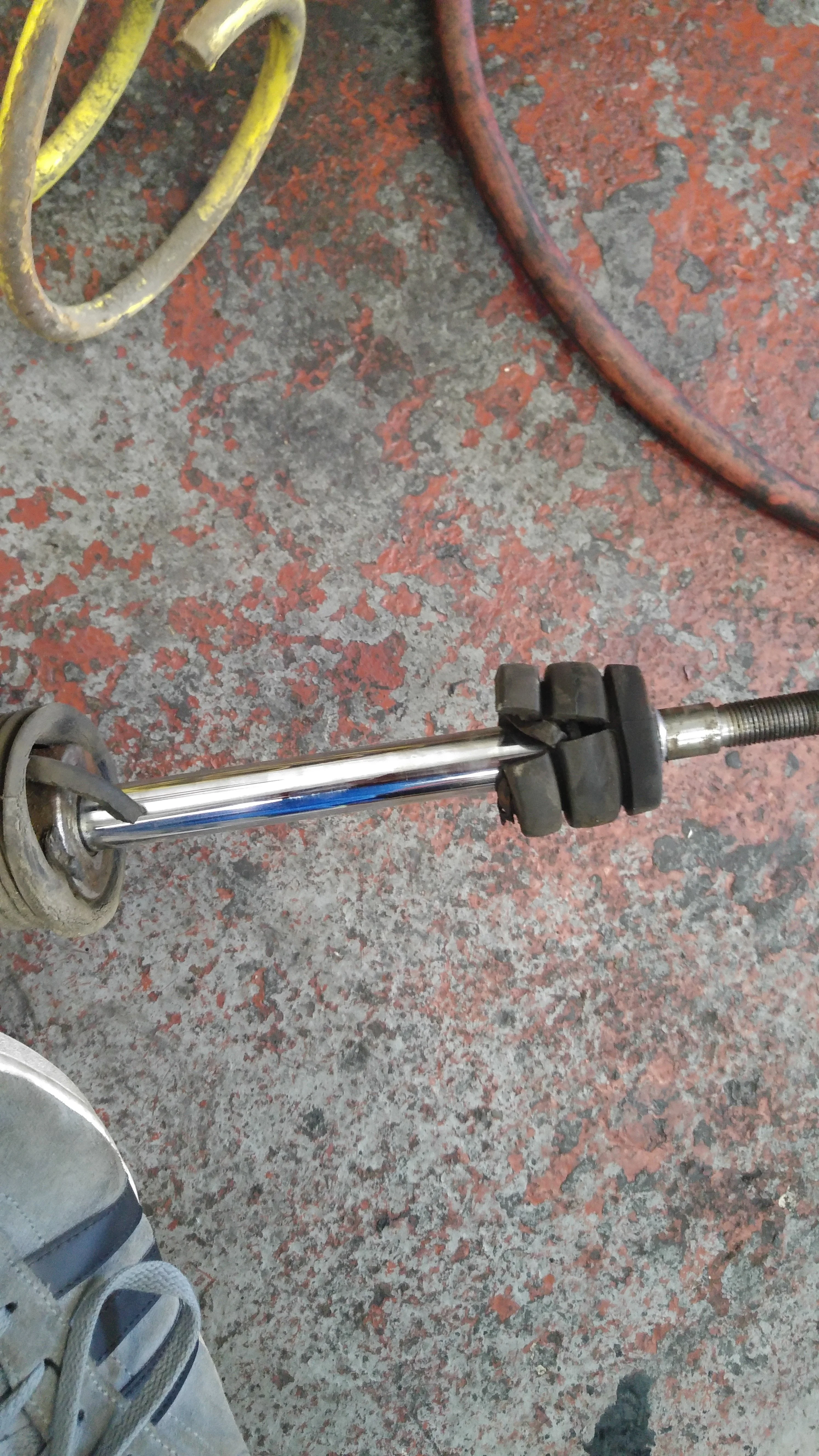

With the storms that have been bringing ungodly amounts of rain to the north east i found my car had started trying to collect as much water as possible in the foot wells, so removed the front scuttle panel and cleaned out the drain holes, there was a lot of standing water in this thing :/ (the wipers where a pig to remove even with the tool)

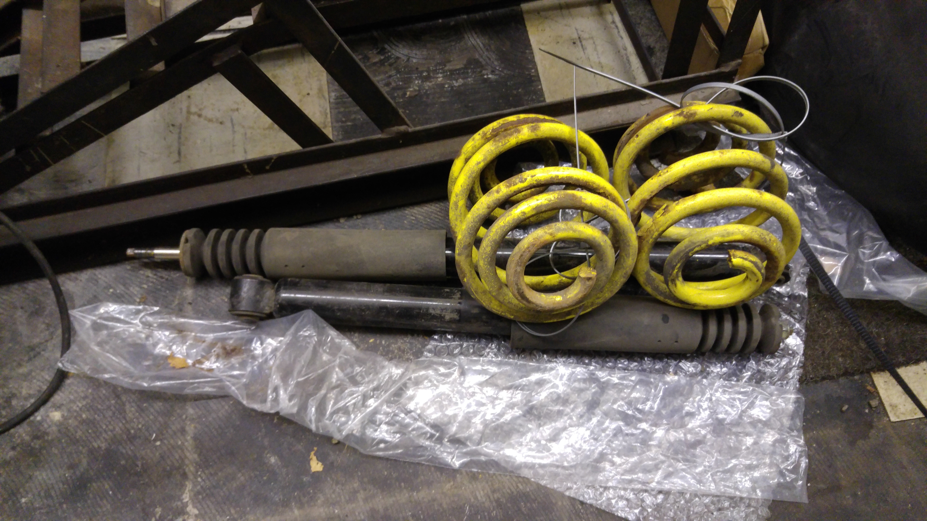

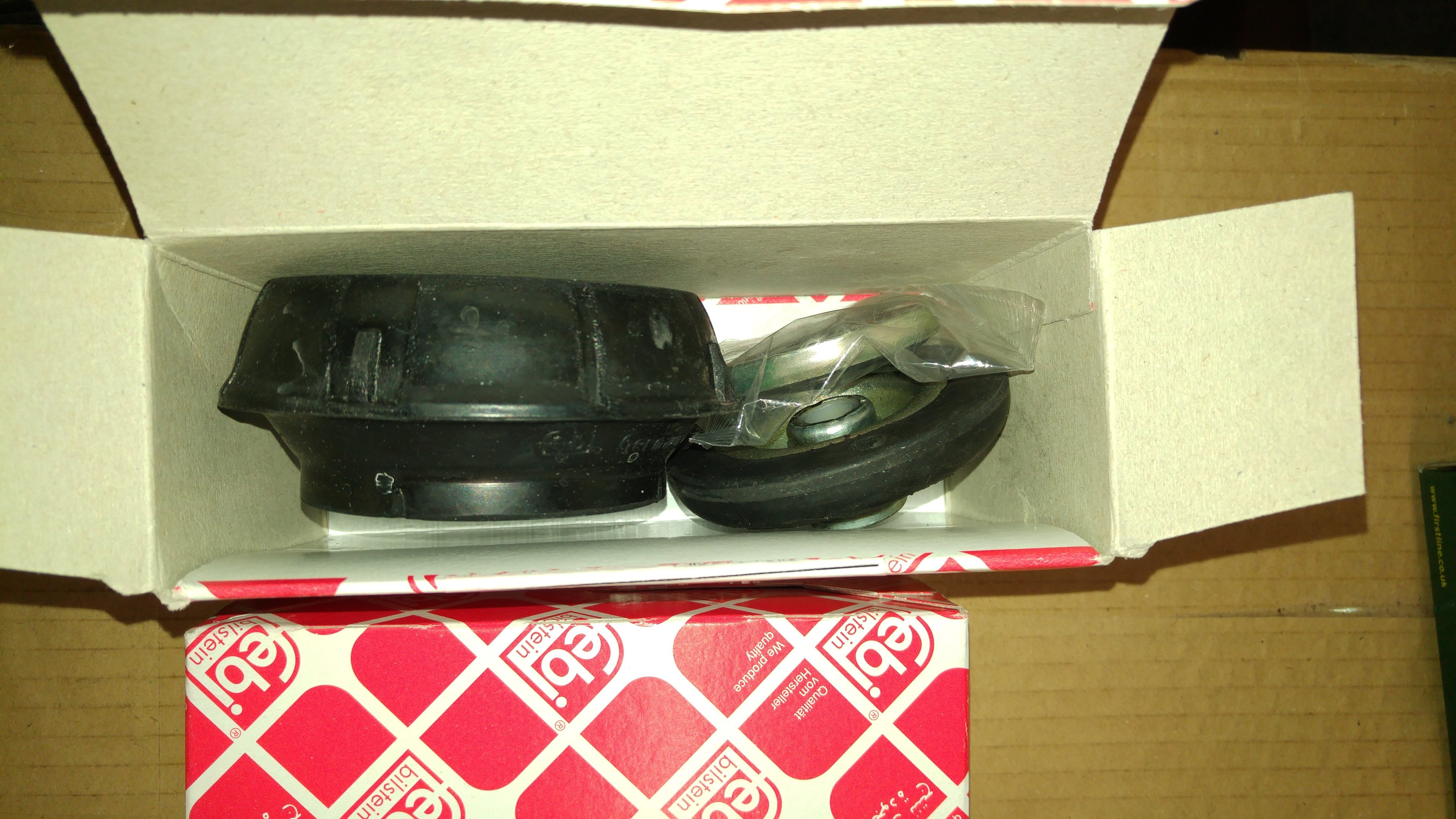

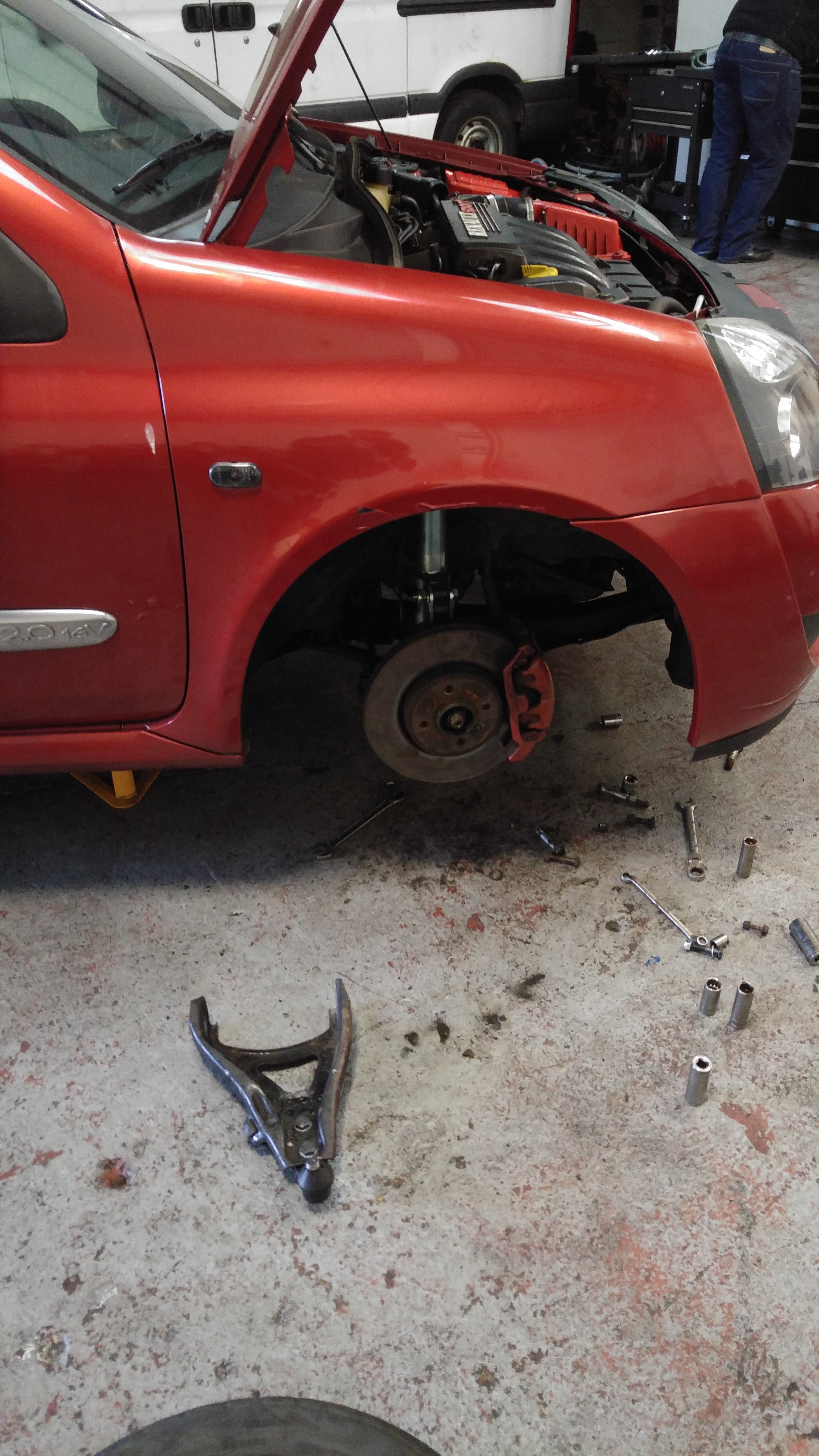

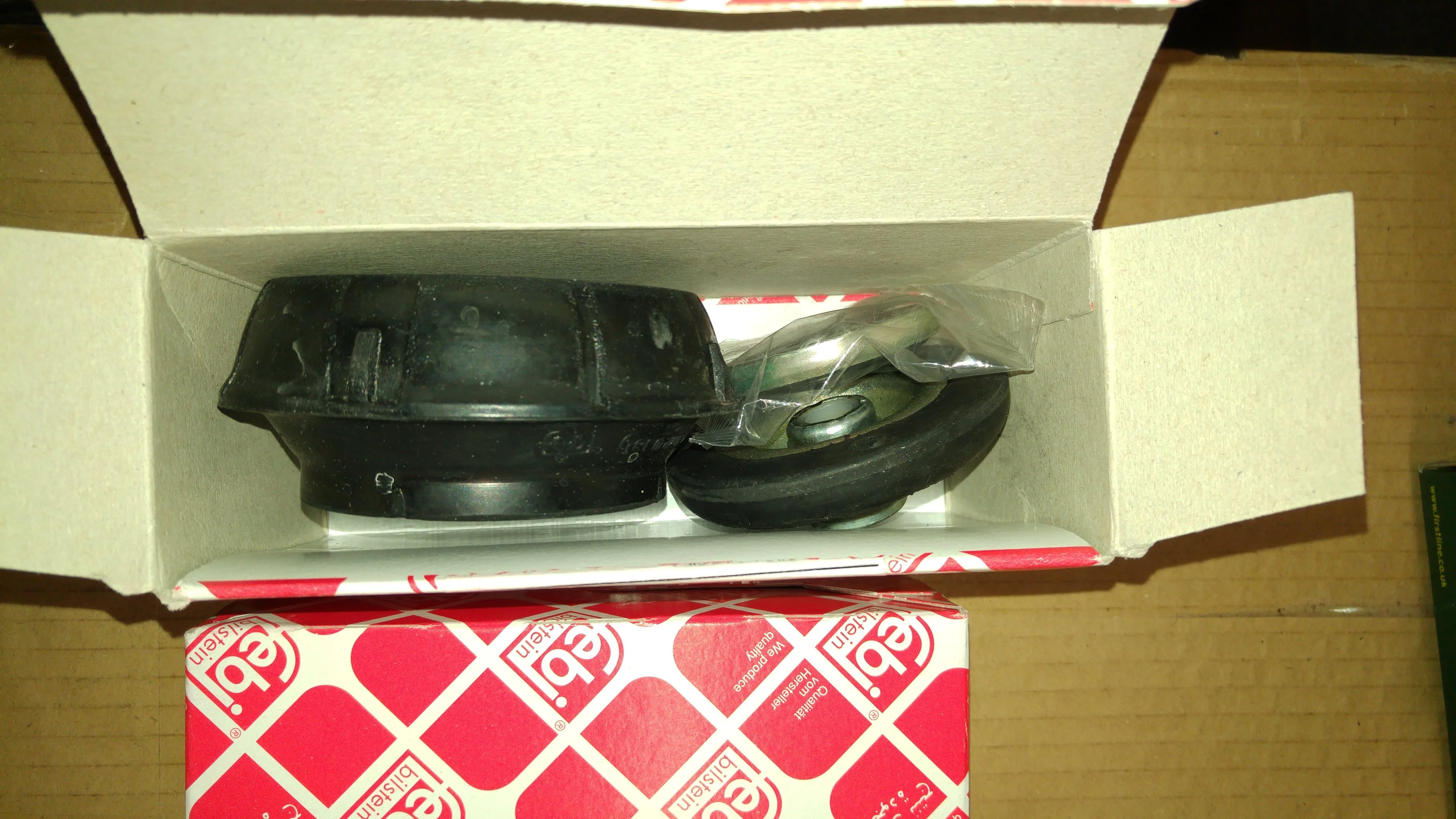

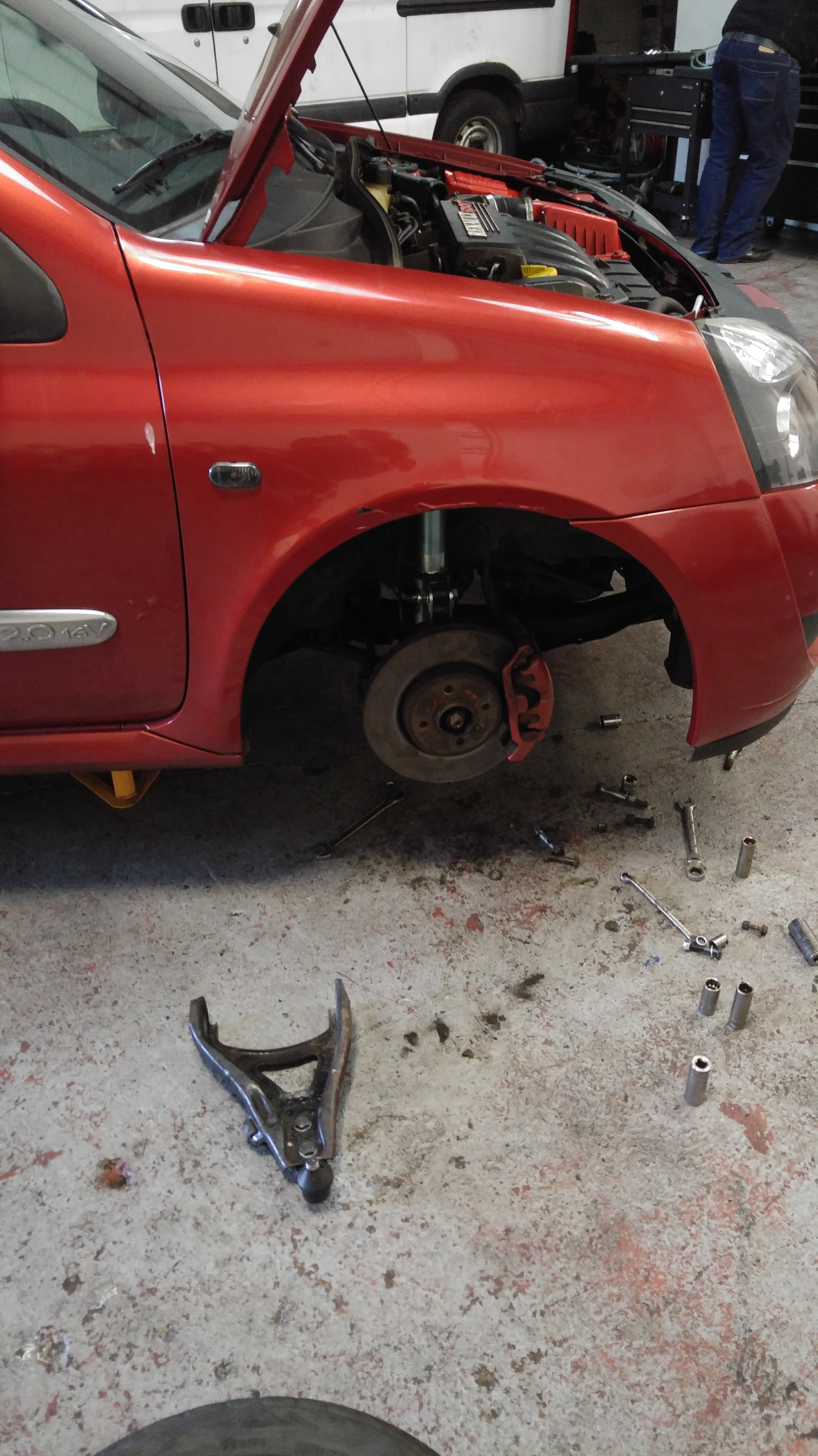

Anyway the car still had the low speed knock and the TPS code issue so i decided to double check the front suspension and replace the top mounts that i bought so i stripped the front suspension back and re assembled the full lot and raised the car up another 1cm as it was to low for me (the bearings in the old top mount where shot and full of rust so i should of replaced them the first time i guess (whilst i was at this i removed the strut brace from the rear).

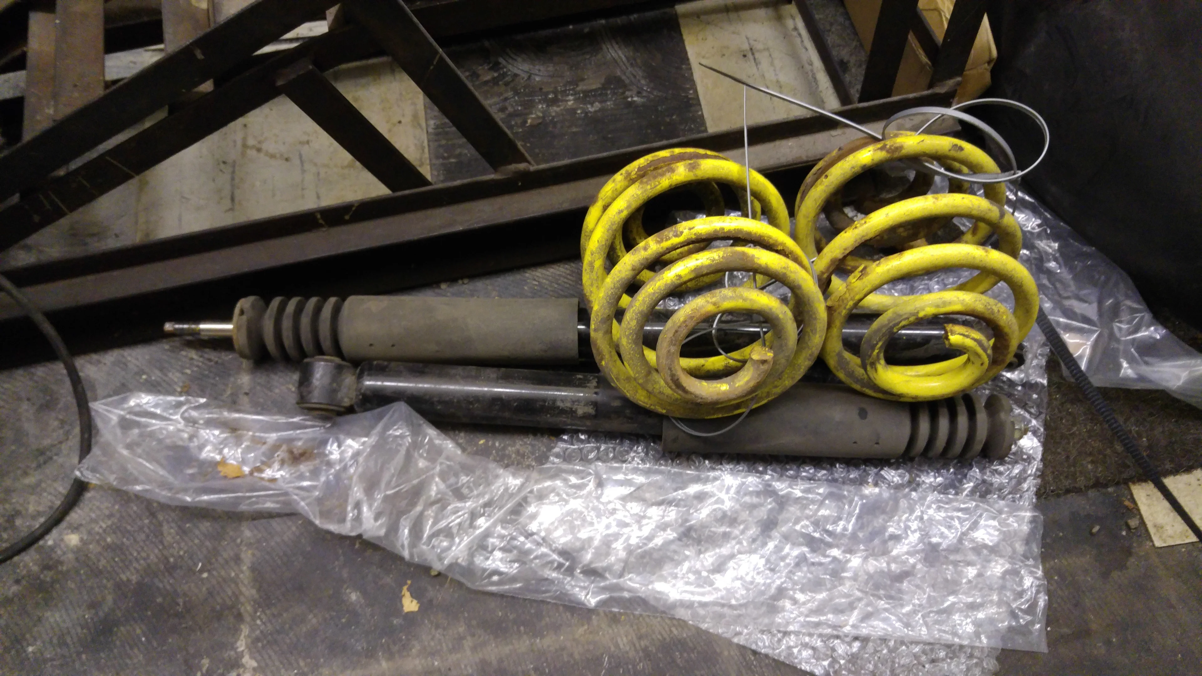

Quick update as i have been neglecting to fill in what i have been doing with the car, i have the Rainsport 3's fitted to the car now and i find them quite a nice ride. I have done a complete oil and filter change and some other bits as well. I am sure there is more but in all honesty i cant remember (I think I am going senile).
Still have the rear strut brace if anyone wants to collect it, and i also have the front wind deflector things free to a good home (condition average)

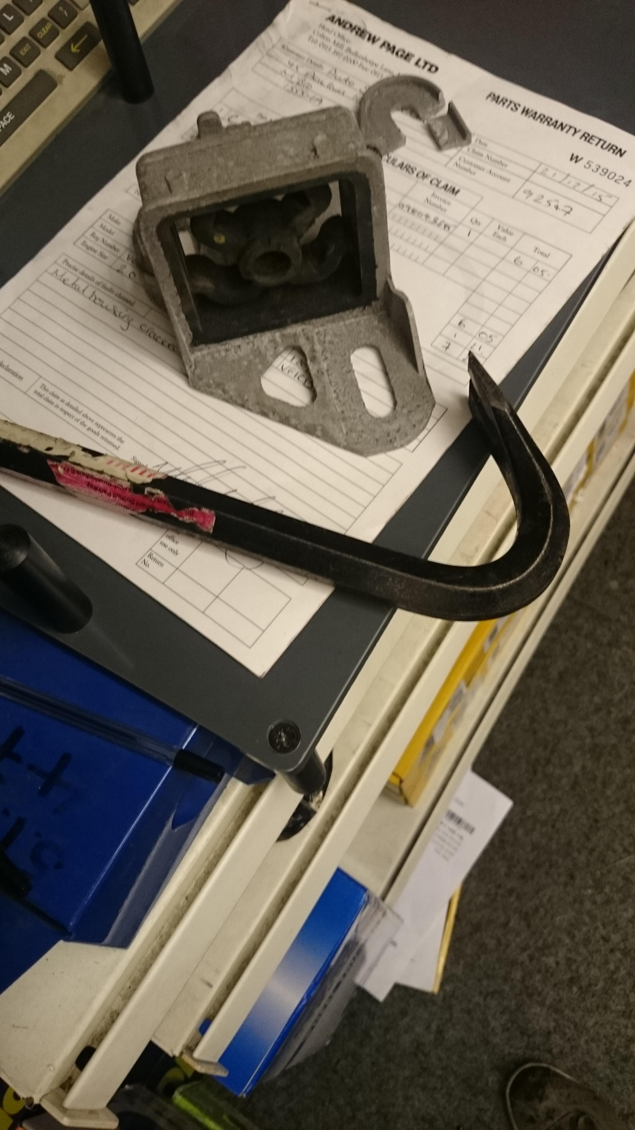

The car is still feeling neglected although it has had a few more bits done, i replaced the exhaust hanger again as they appear to be made of butter (I have now done the turn it in to a tool box modification)

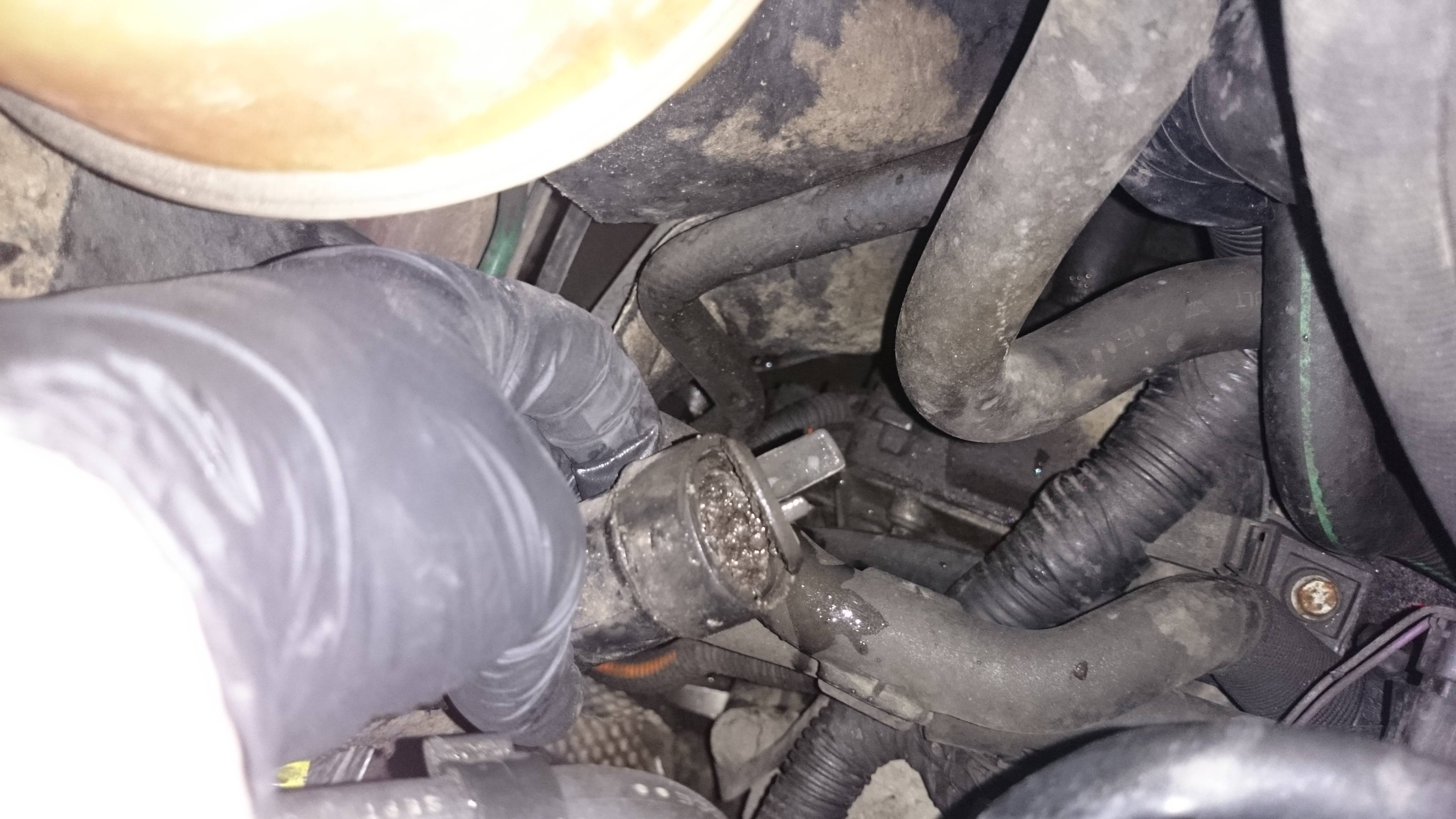

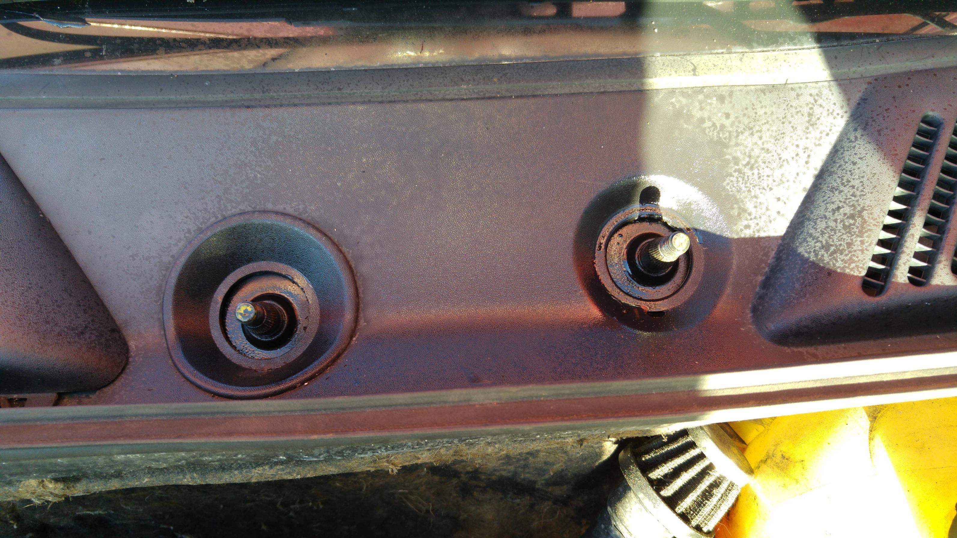

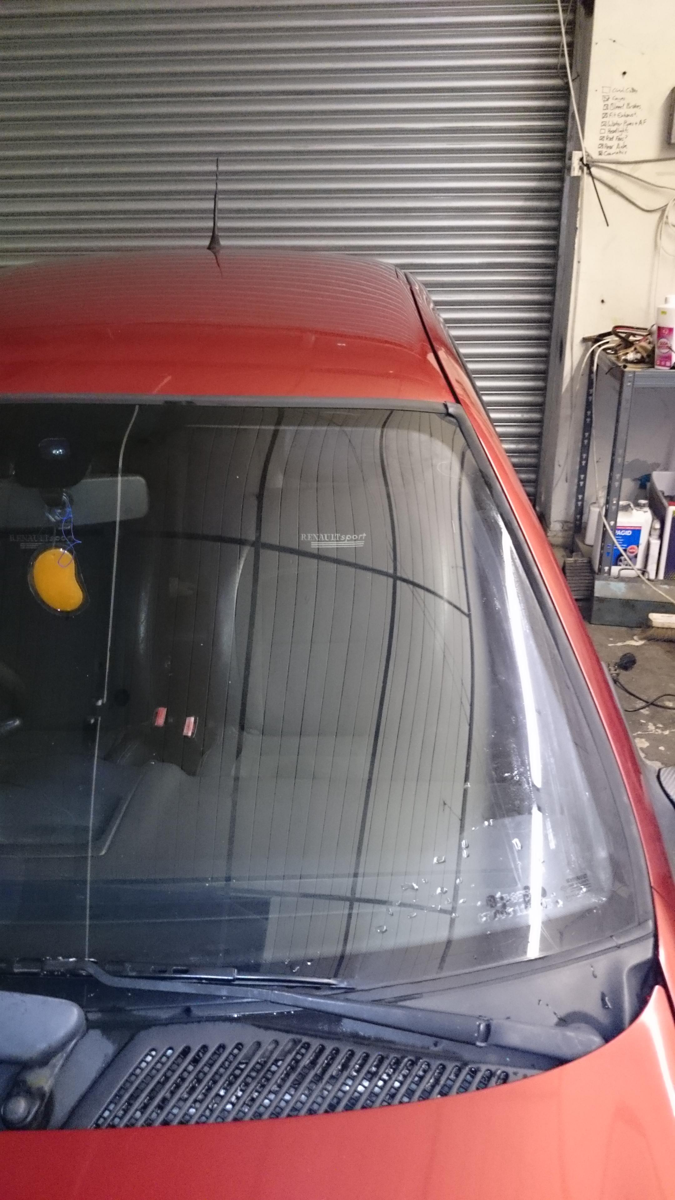

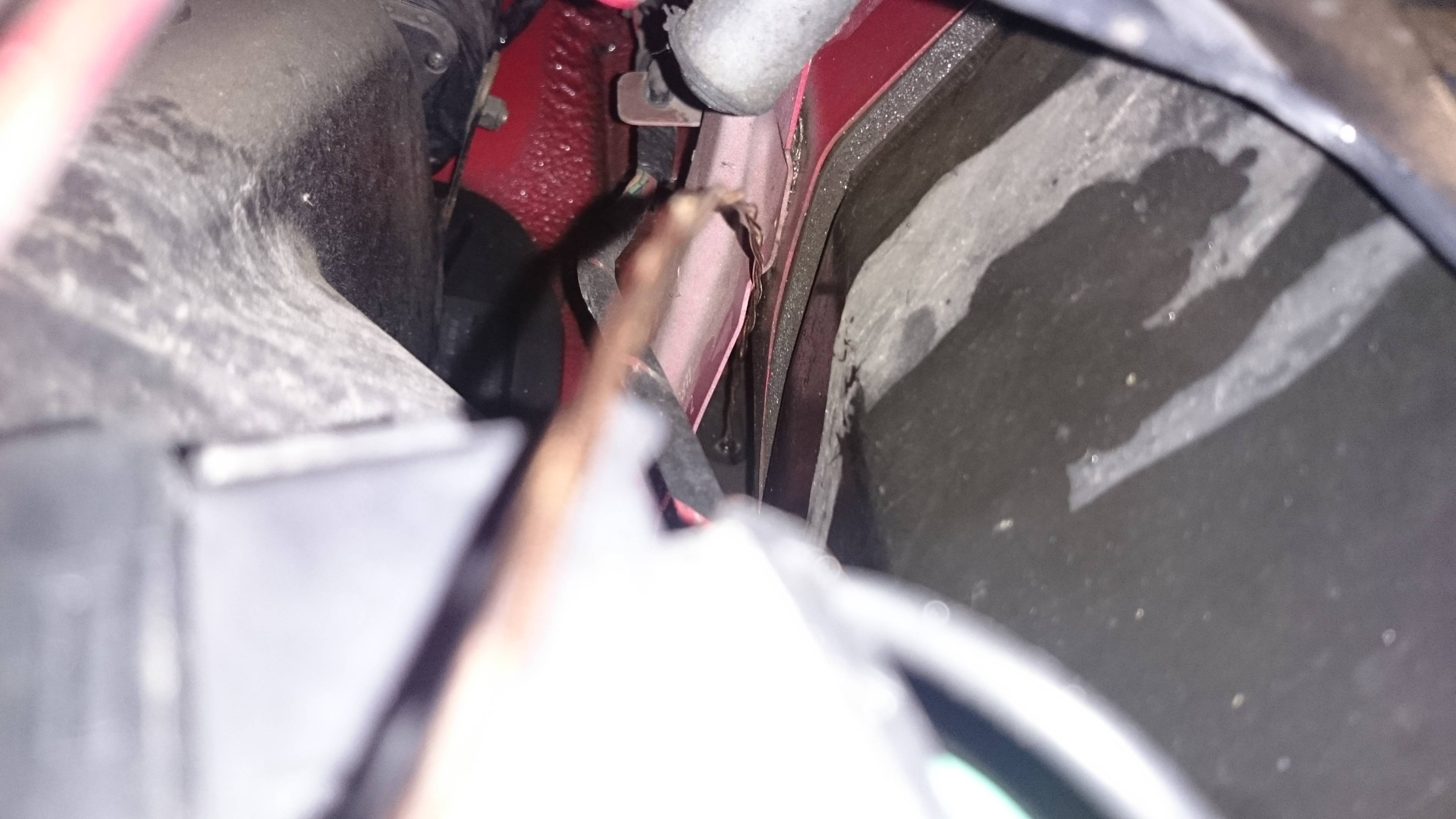

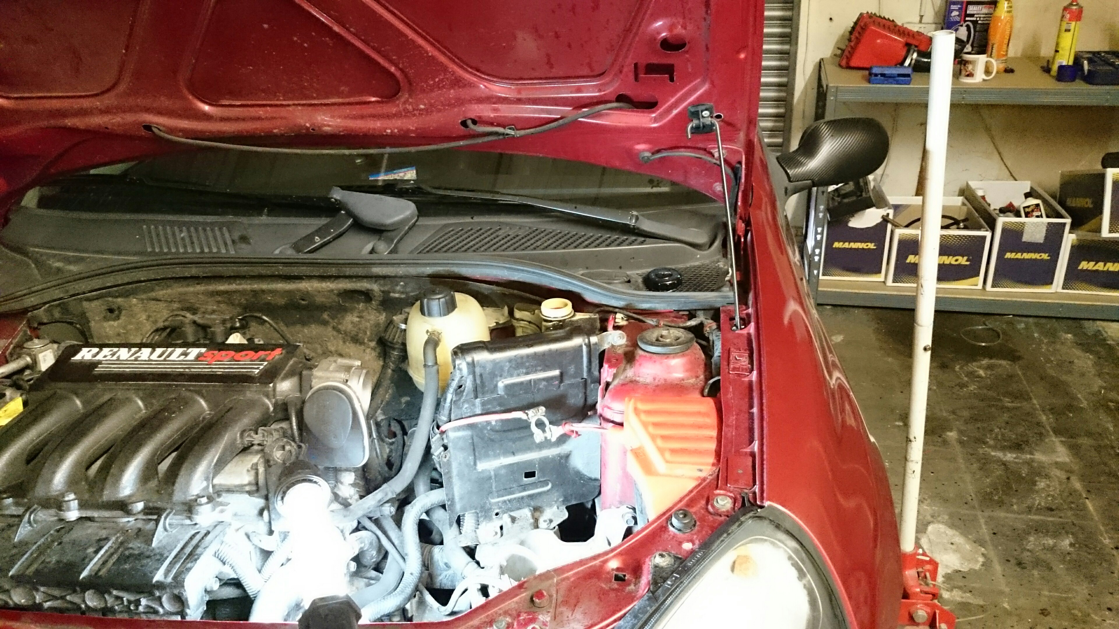

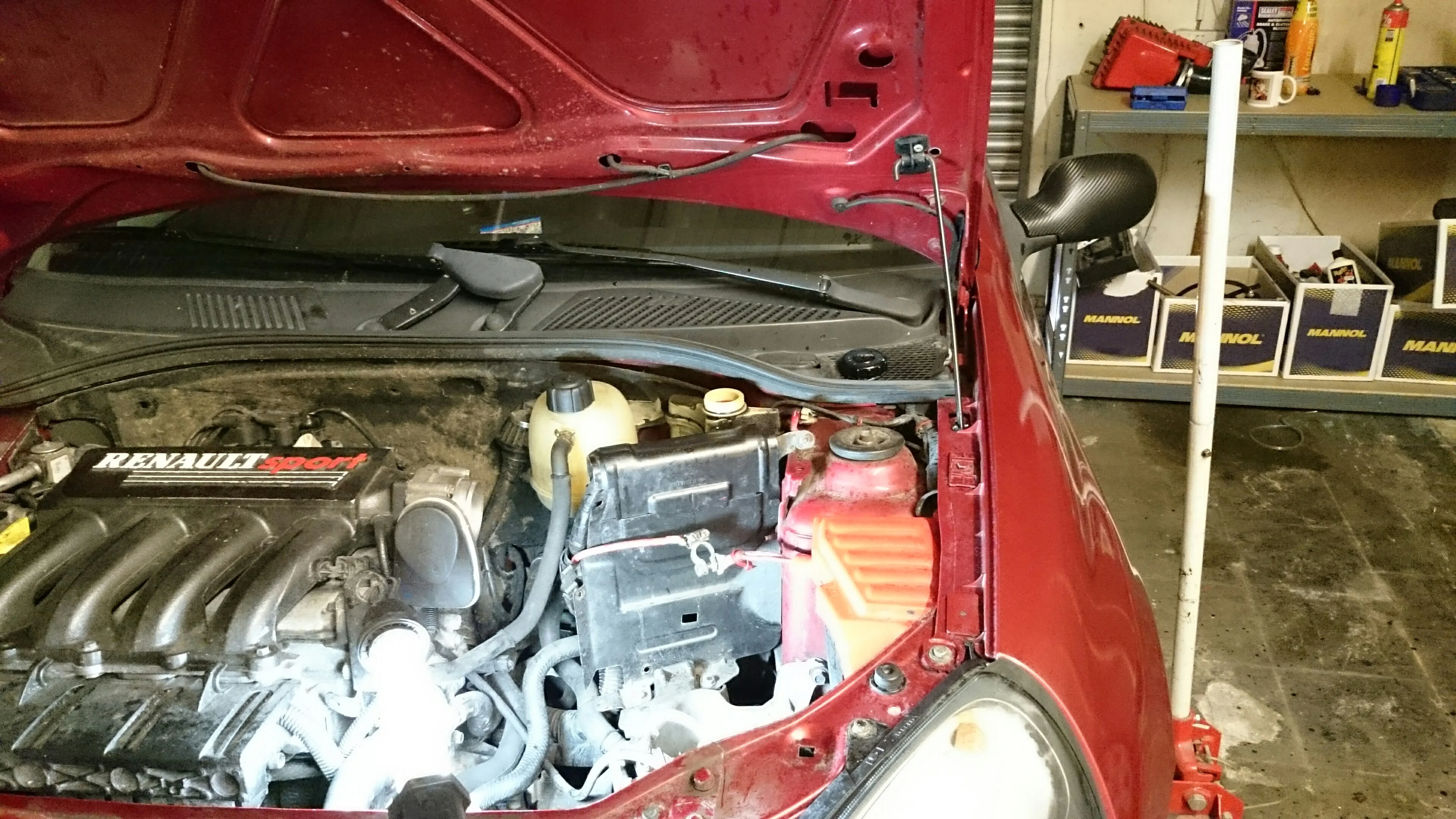

The problem with my leak was still present with all the rain so i decided to re clean my scuttle gutters (I did not do a good job first time)

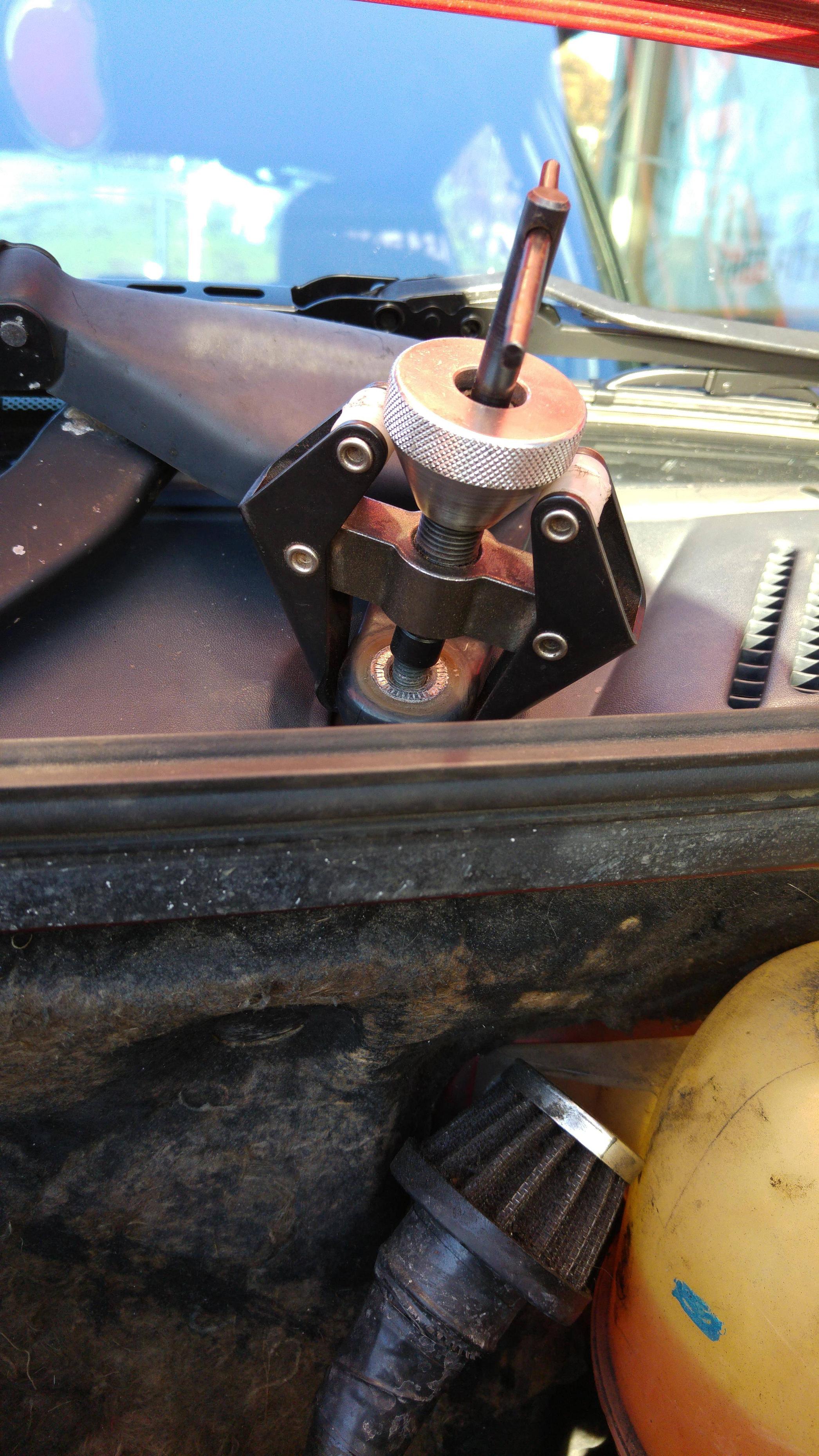

i started by removing my wipers

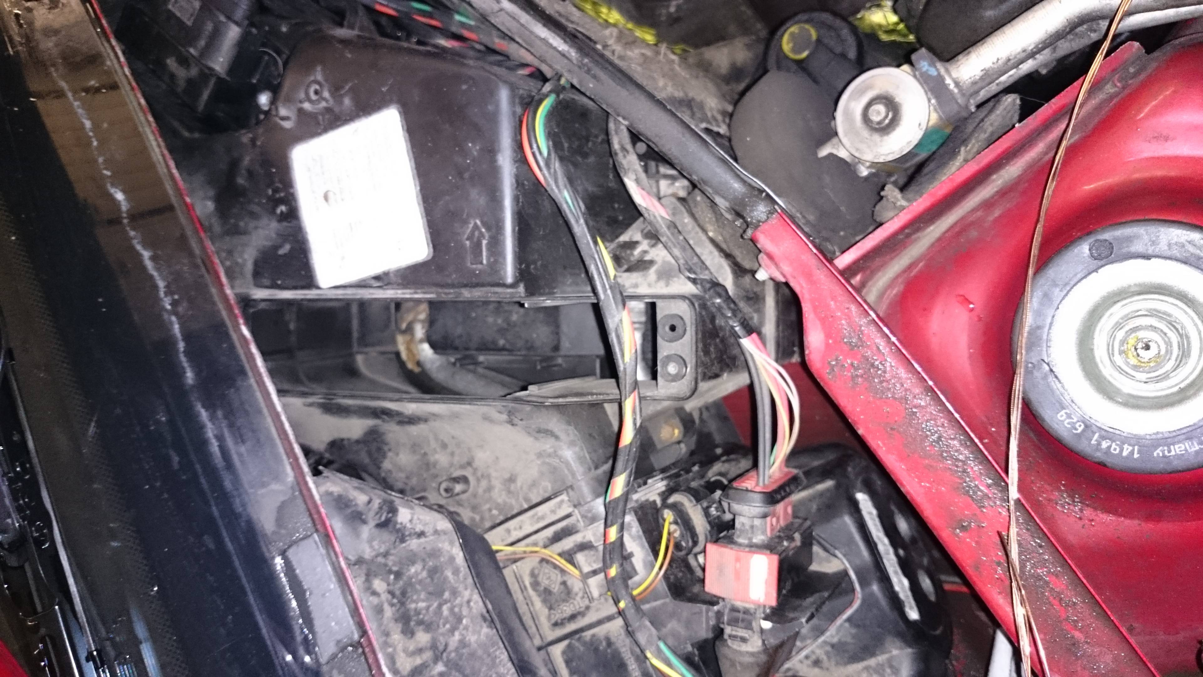

then used some welding wire to make a pipe cleaner and started to sweep the pipes
the center drain was the main problem

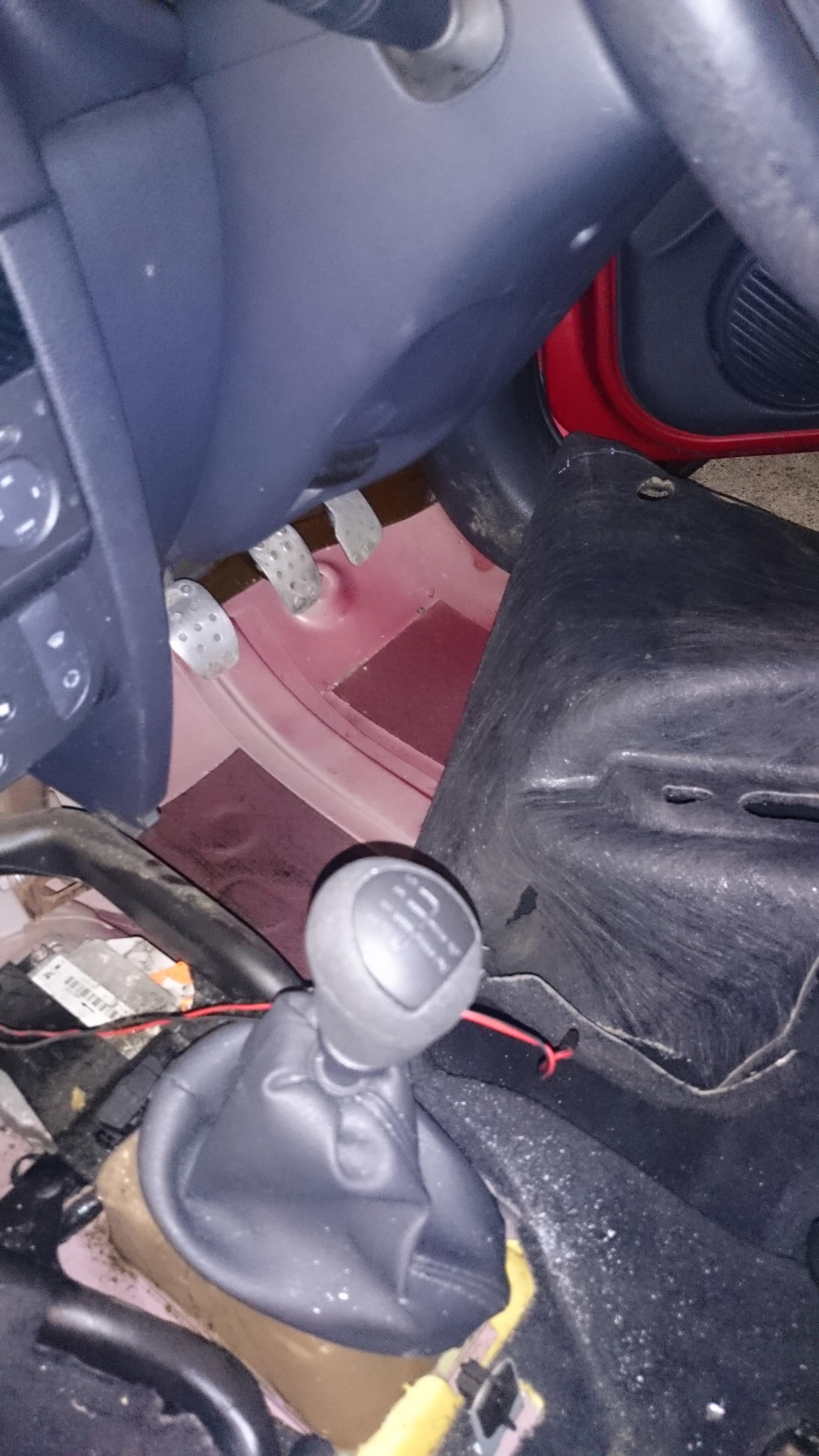

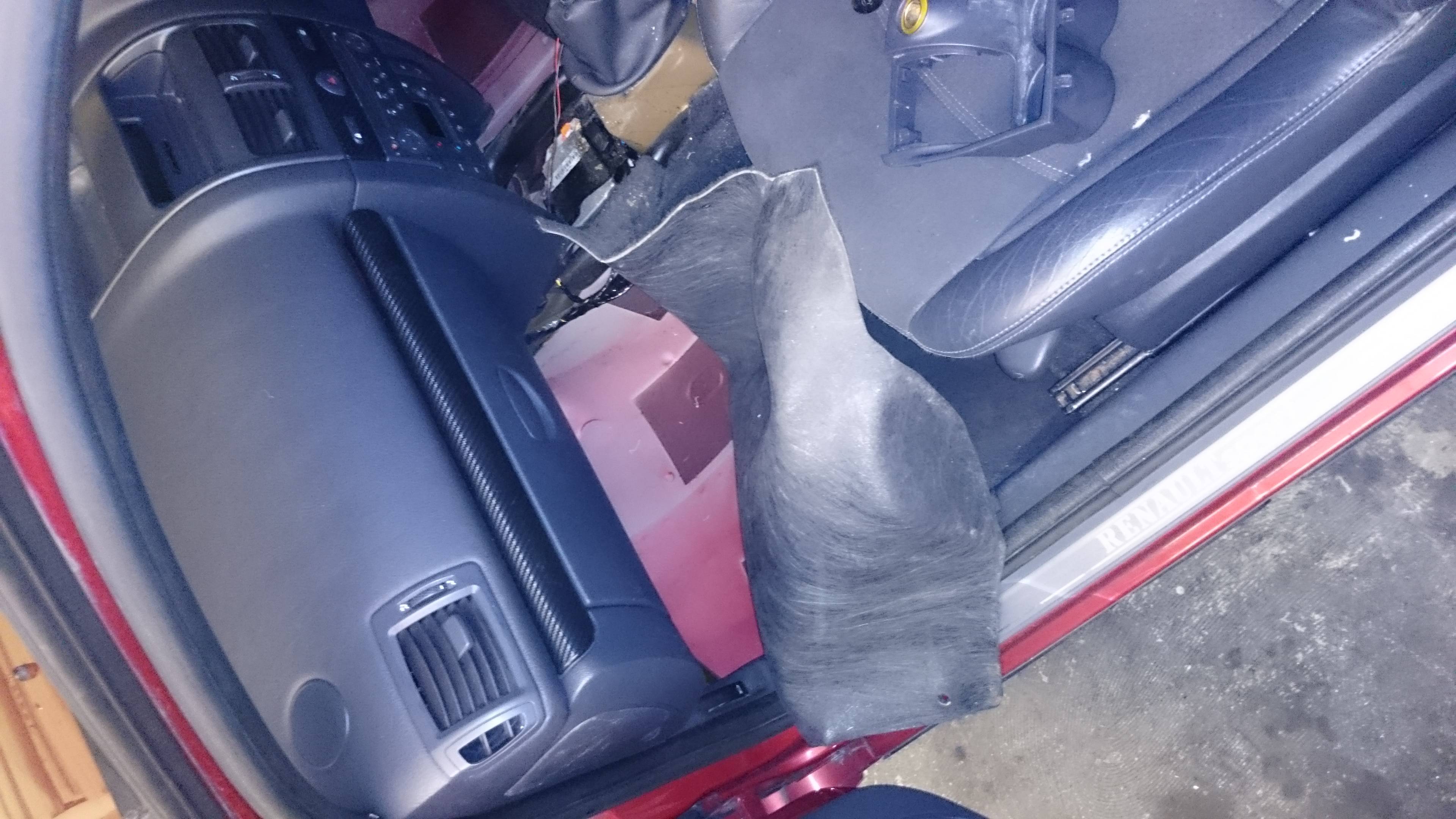

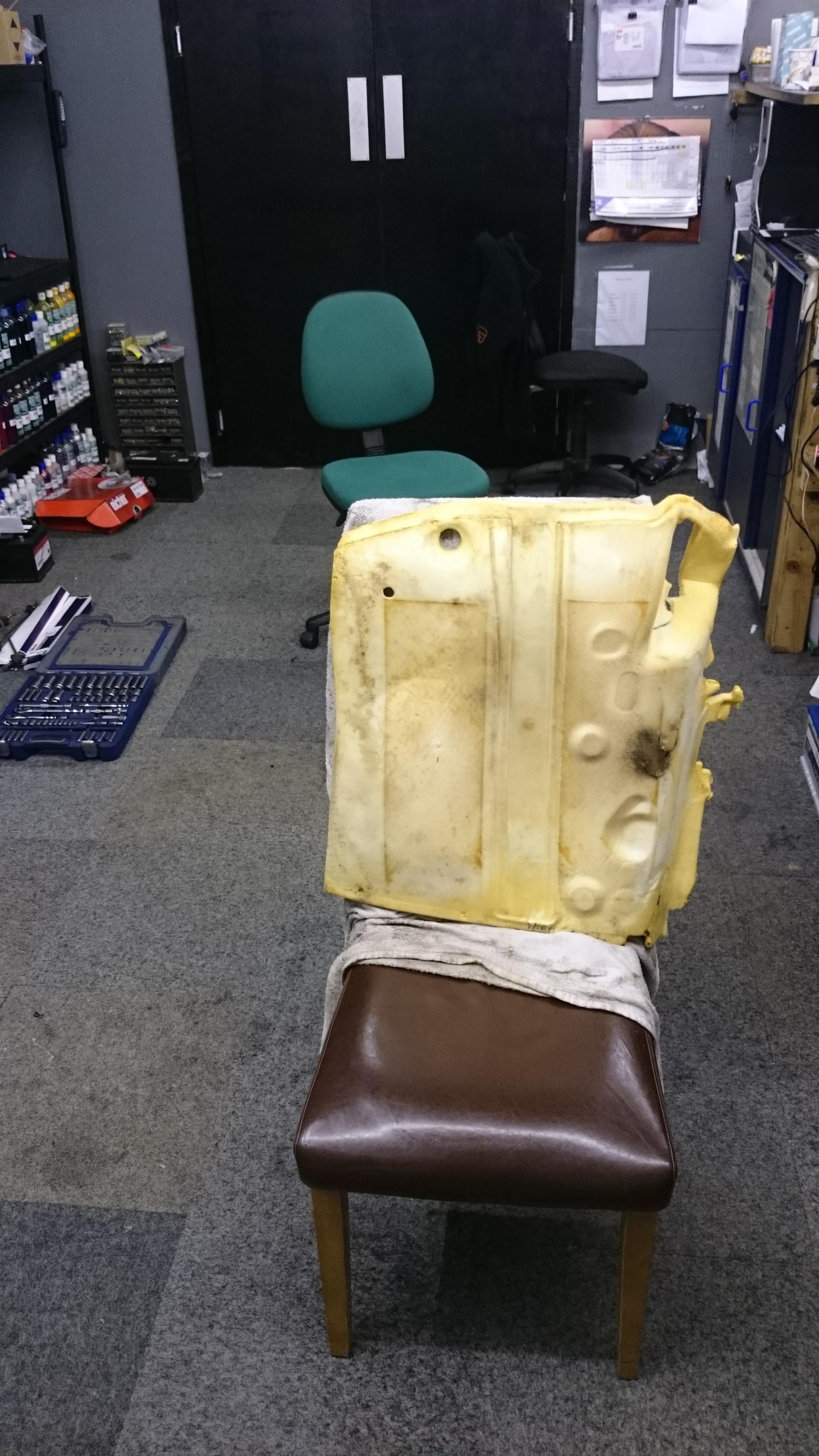

after fishing that out i lifted the carpets and dried out the foam
when it was all dried out (about 4 hours in front of an industrial heater) i placed it all back and removed the RS sticer that was backwards in my front window

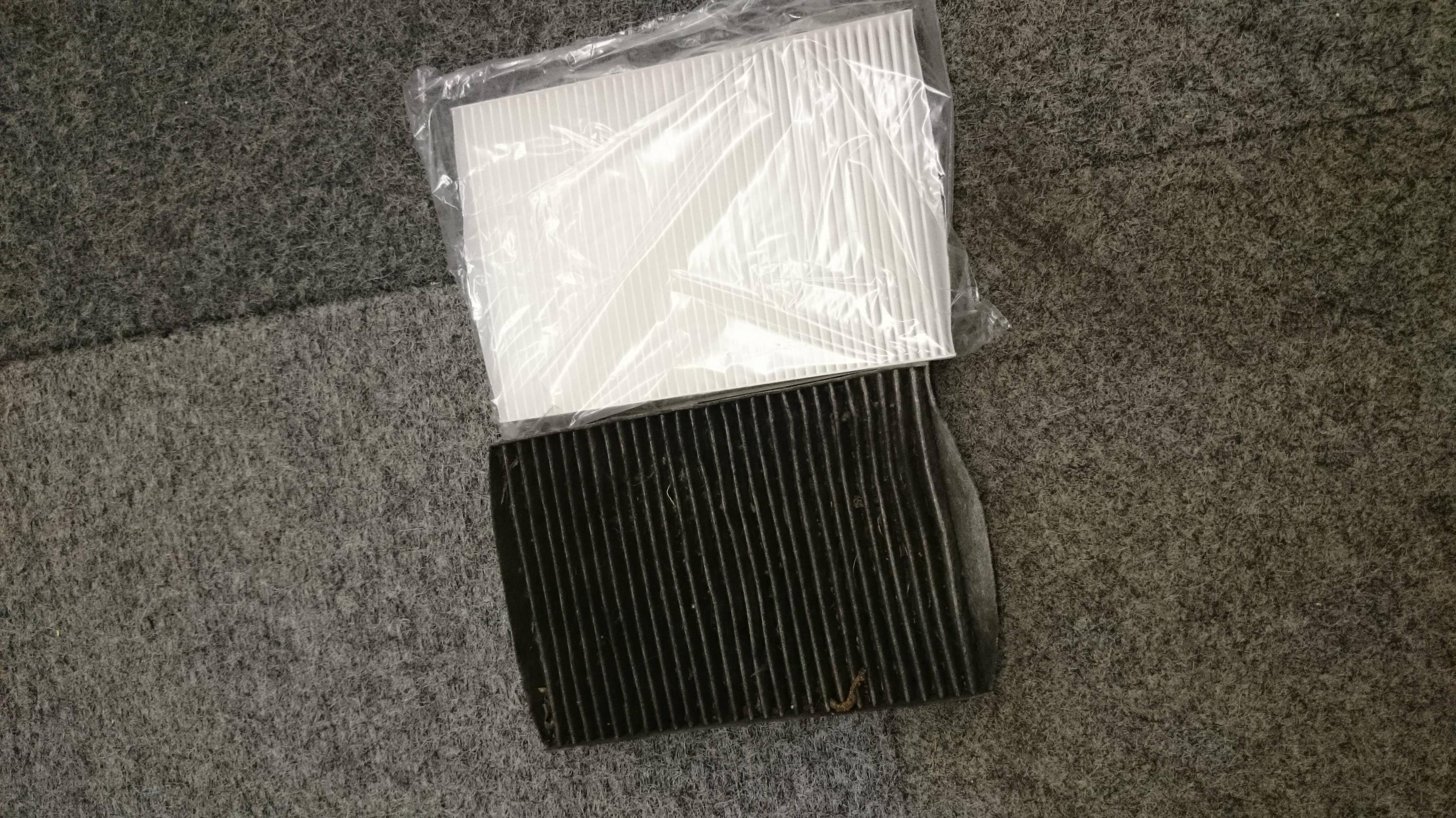

i forgot to change the cabin filter last week so it got done this week.
and to top everything off my log book finally arrived with my updated reg so i can now put the new plates one
for some reason i can never figure out how to do pictures on this thing so they are ridicules in size

Cheers looking back its crazy how much i have actually done to this car! The rubber pipe in the middle was chock full of s**t and getting access is a bit of a pain in the ass but its worth doing, i finally have a dry interior after it rains.
