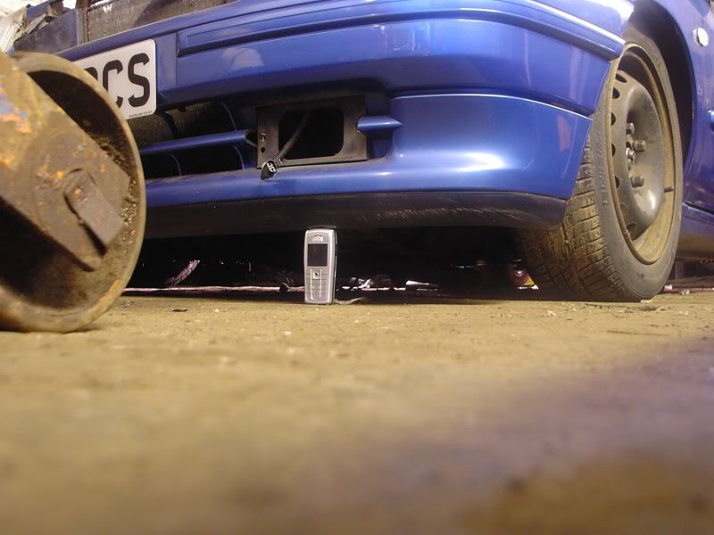

Another day working on Djw Daves clio!!
Well what do you think, in with a shout?

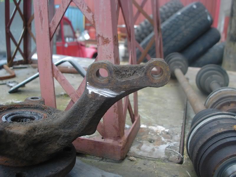

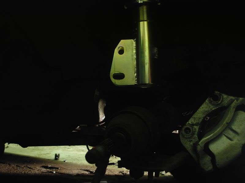

ANd to sort the huge camber at the front we had to erm 'adjust' the hub like so
and a tiny bit of filing on the coilover which you cant really see

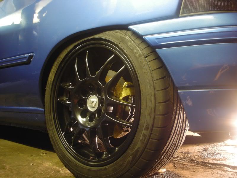

Oh yes! the back looks sweeeet!
Can you explain how you modified the coilovers in more detail?
I have the same kit running slightly too much negative camber!
Djw John
Scotland - South
Well what we figured out we need to do was to trim the hub down by about 1cm (you can kinda see the grinding marks in the pic) and then needed to file about 1-2mm out of the bottom hole on the shock, allowed much more movement and seems to have sorted the huge negative camber!!

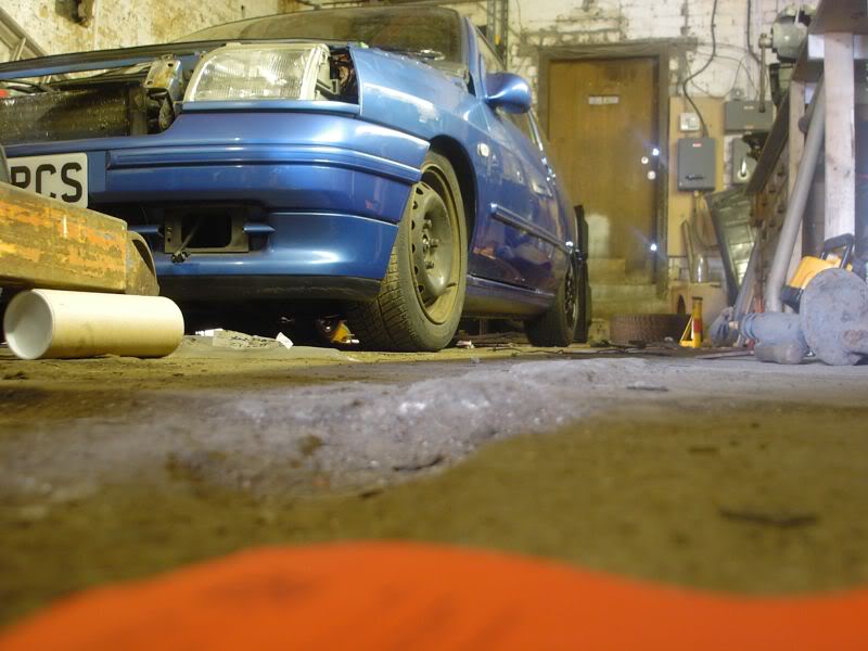

Ollie yeah yours is lower at the back by a bit but is it as low at the front?
Yeah RSi beam, bargain as well ;)
Yeah just waiting for Dave to save some cash and then the last few bits can be done to the engine and it can be dropped in in a day or 2, cant wait!
  mk1 phase 3

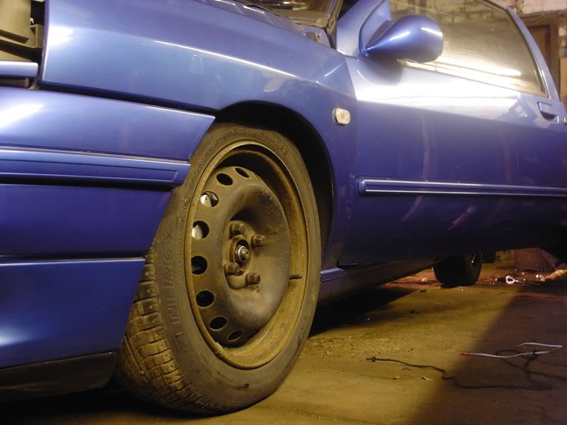

haha, it feels like the shocks have collapsed! 4 'clicks' on the torsion.
doesnt even scrape.
this is the front. 60mm. think u win there lol

Mines scrapes, everywhere, but the 172 wheels are really the wrong offset :(
  mk1 phase 3
my mates got 172 wheels on his valver and that scrapes a bit.
