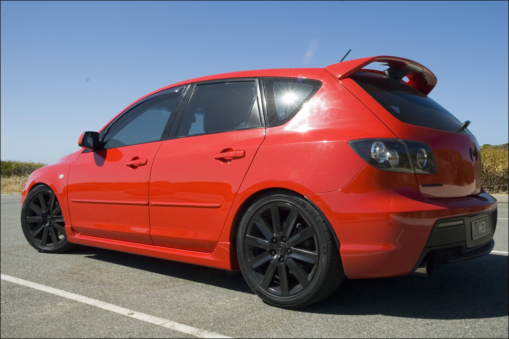

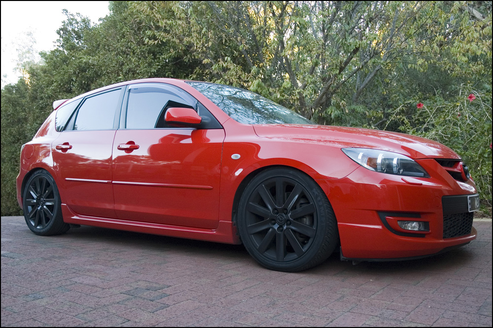

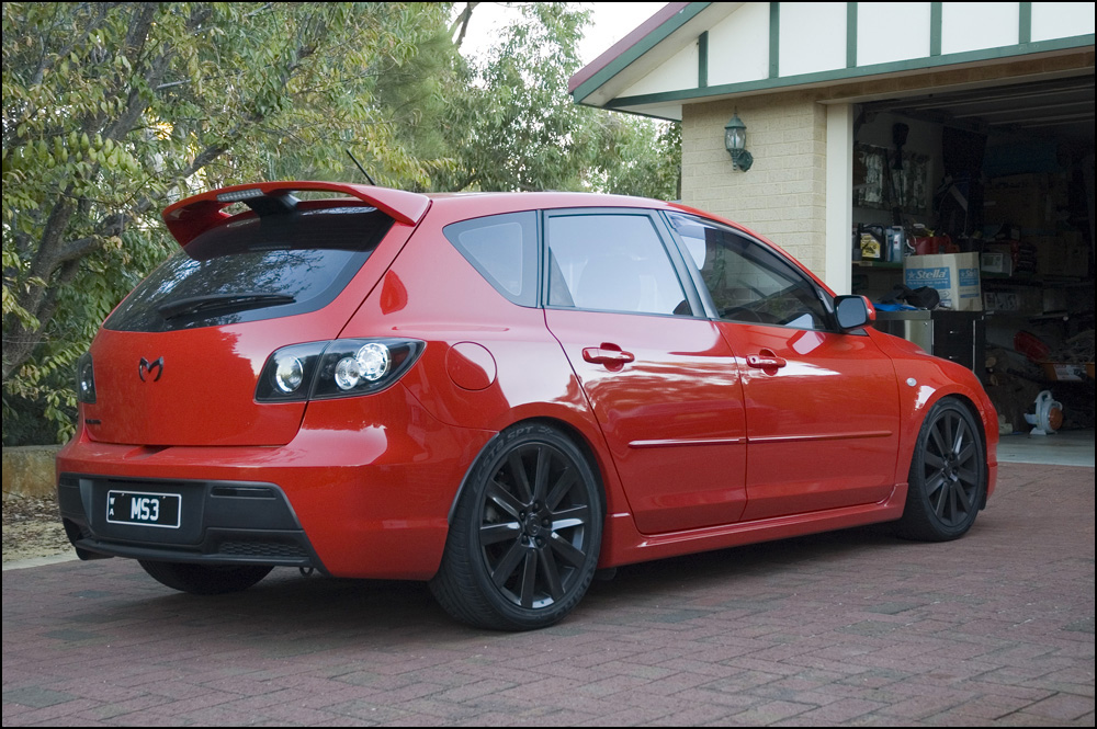

Added a few bits recently.

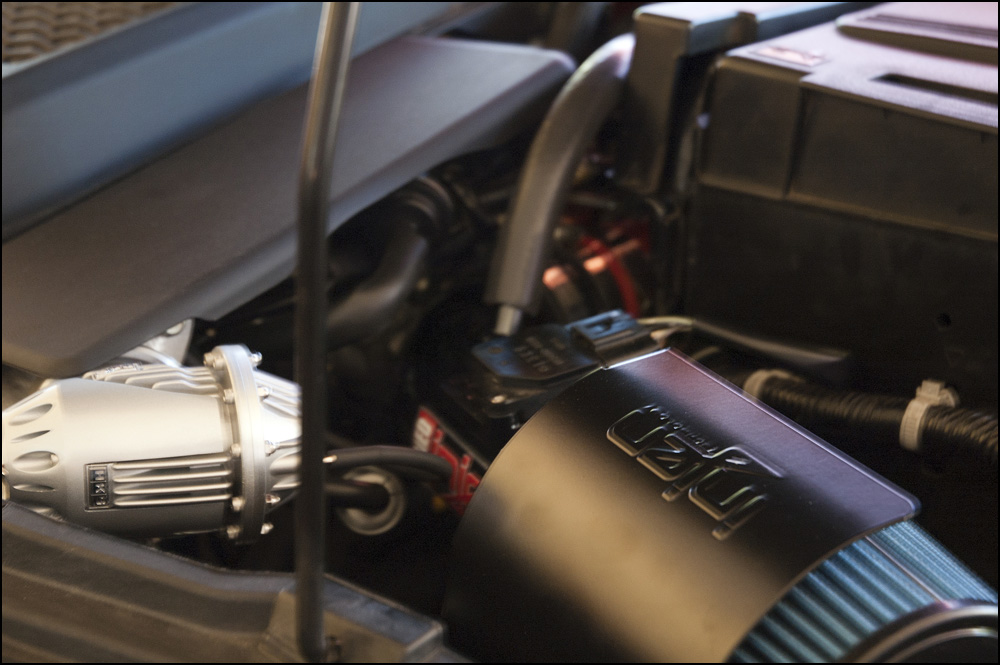

As you can see I've fitted a set of matt black standard rims, Injen short ram intake, JBR turbo inlet pipe and a HKS SSQV blow off valve.
Makes a little bit more noise now. :)

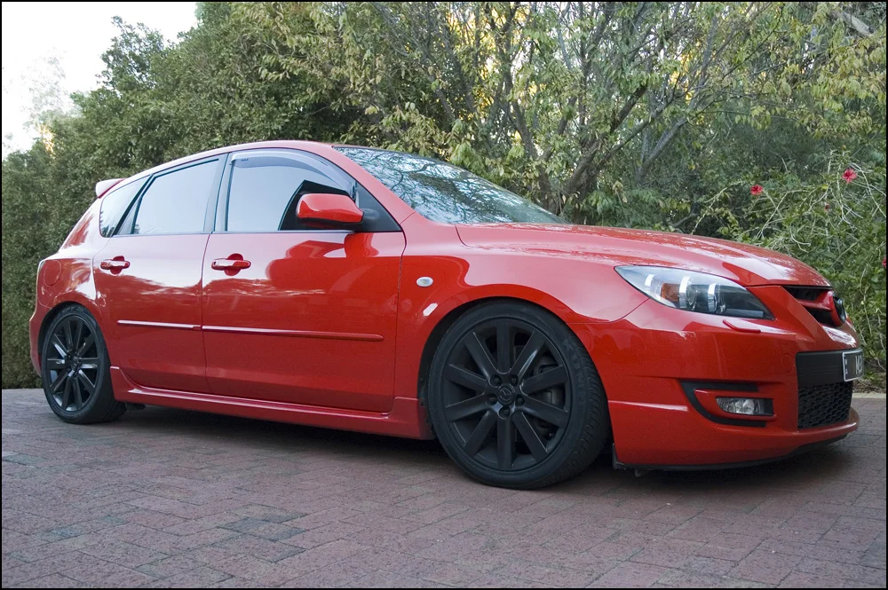

It's been a while! Couple of changes to note but not many pictures. I got sick of the matte black rims as it was a spray can job the paint kept flaking off so I had the original set of silver rims powdercoated gloss black and threw a set of KU31s on there for good measure.

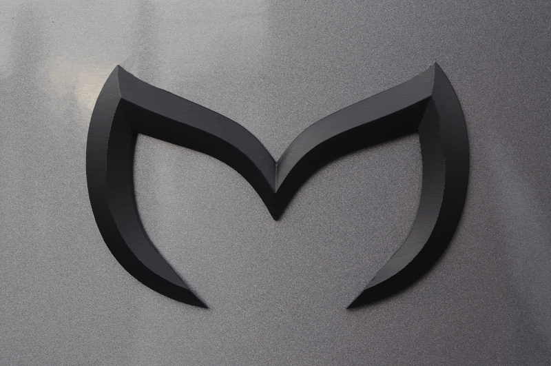

I also painted the badges black, changed the rear badge for an "evil M" badge and changed the mazda badge to a mazdaspeed one. No pictures but the "evil M" looks like this.

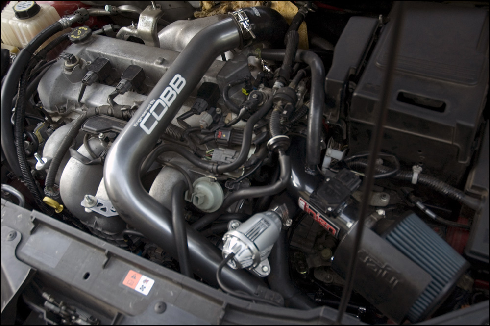

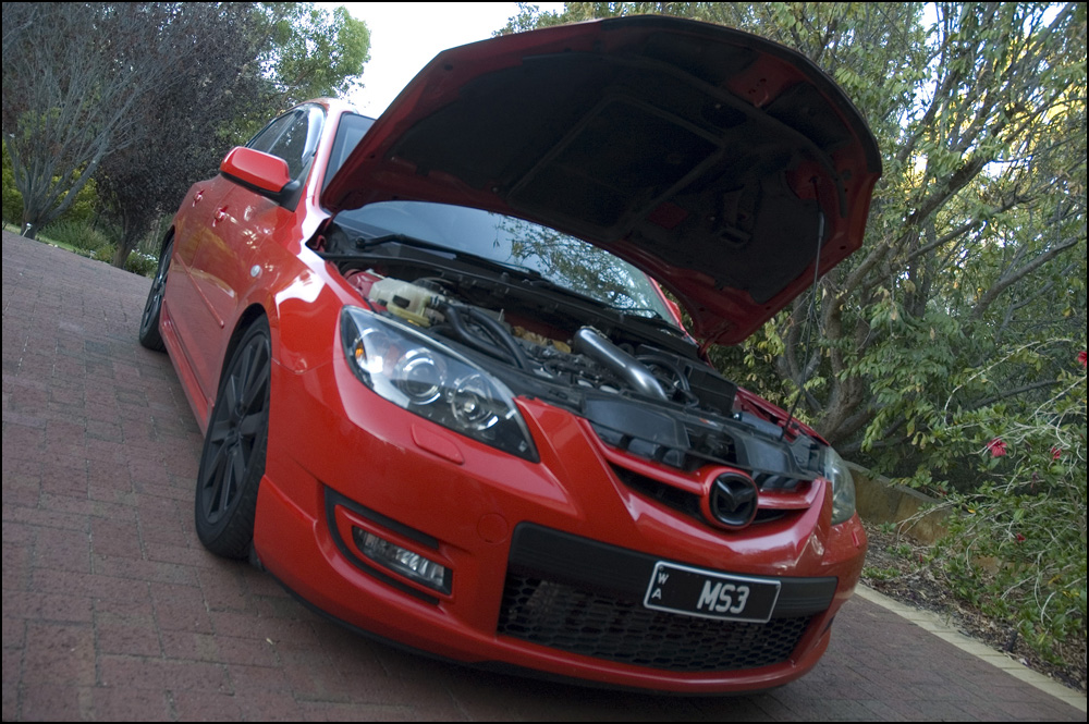

Latest mod is the COBB FMIC kit which was a doddle to fit and I'm most impressed with.
Unfortunately though it's only running about 13.5 psi max at the moment as it's leaking from the boost control solenoid (my fault I snapped it ages ago, been bodged ever since) so I've got an aftermarket one on the way which should be here tomorrow. Once I install that and get myself a custom tune from the local guru I can run it in 3 port mode for better boost control and max out the turbo at around 19 psi. Then I will get some proper up to date pictures.

Sorted the boost leak, it's now peaking at 21.5 psi and the massive increase in power from before was well worth all the faffing about to fix it.

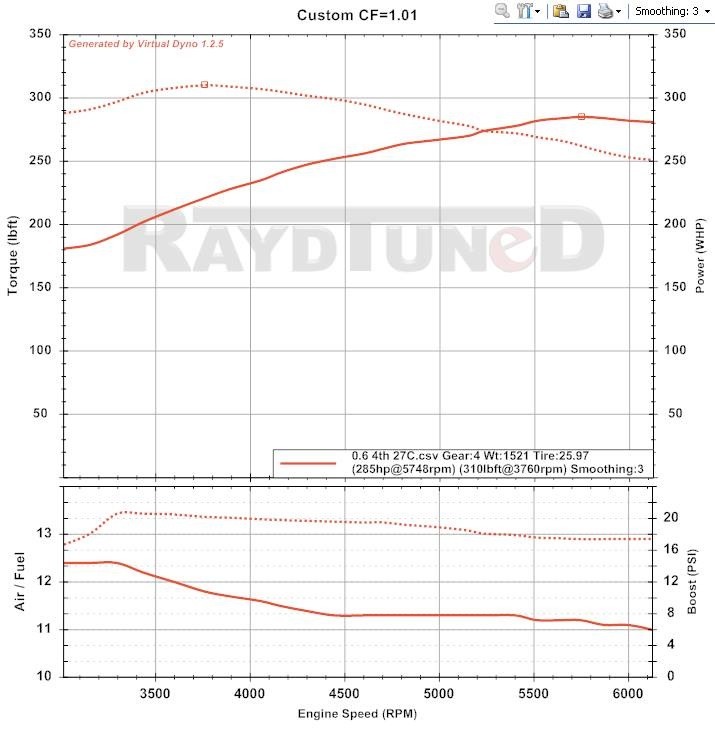

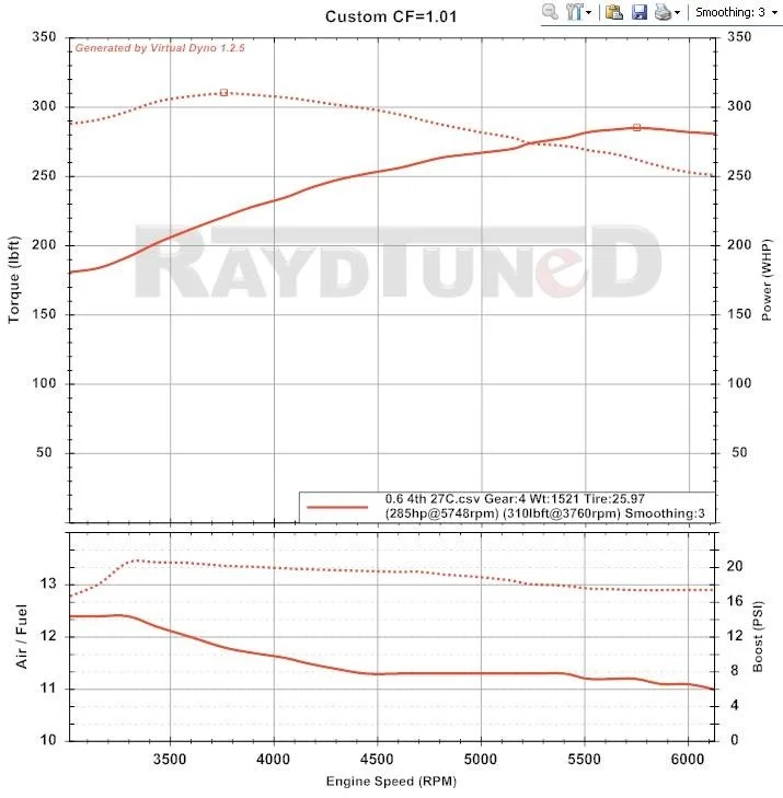

Mapping finished now here's the final graph. Figures are shown ATW.

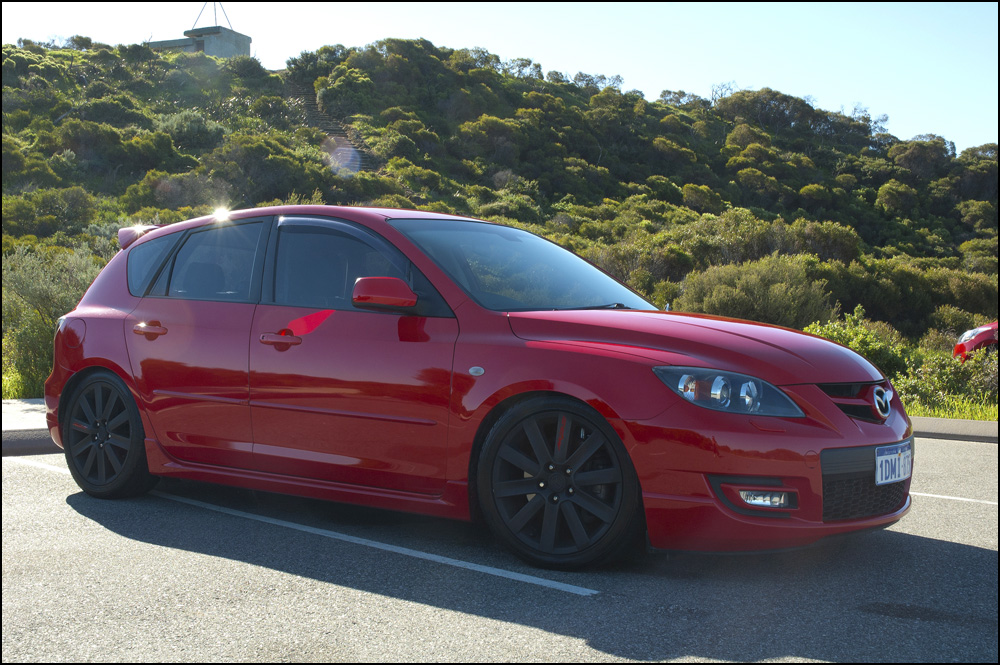

Took some random pics after giving it a vacuum. I want to focus on giving the engine bay a tidy up soon starting with painting the rocker cover.

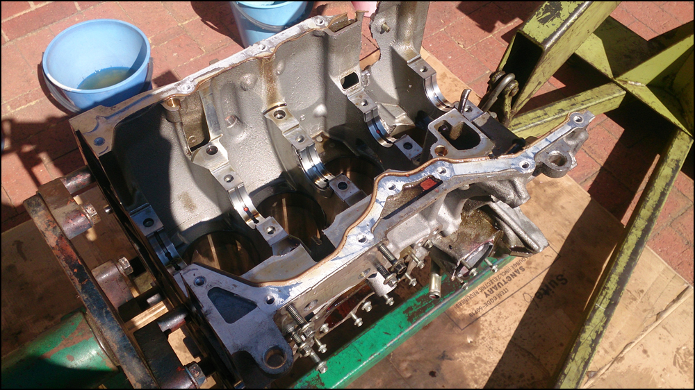

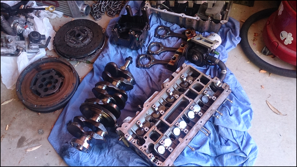

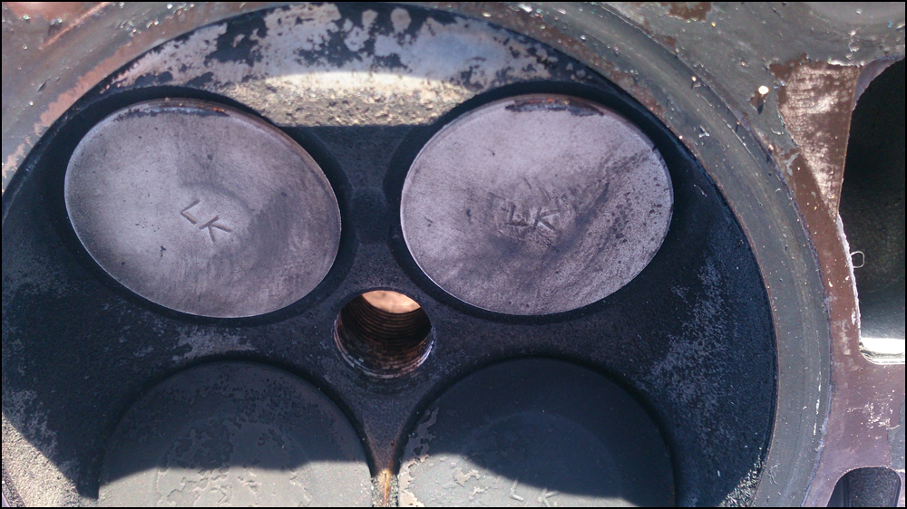

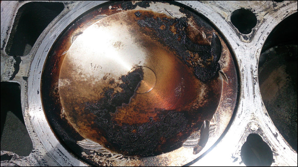

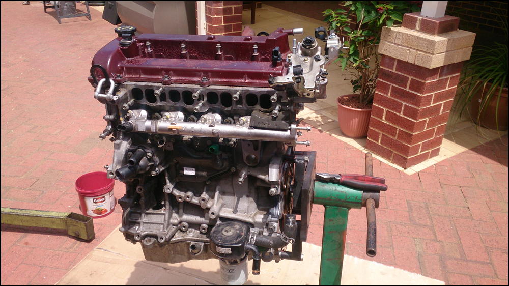

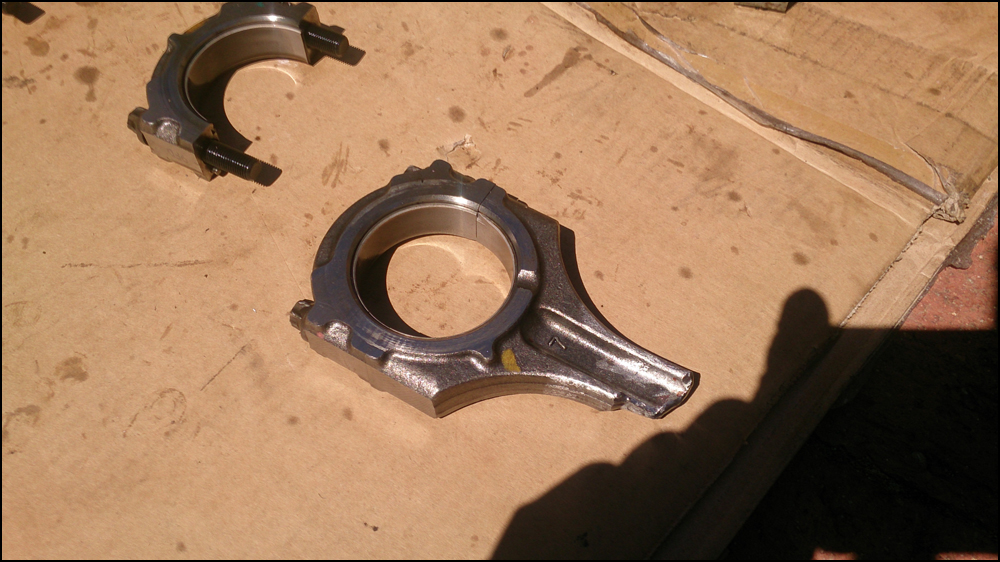

Just over a week ago the con rod on cylinder one snapped and put a hole in the front and the back of the block. So currently it's off the road and in bits until I can get all the parts I need to put it back together which won't be until after christmas as a lot of it is coming from the states.
So far I've ordered some Manley H-beam rods and I'm looking at Wiseco pistons but I want to wait until the replacement block gets here to assess the bores.
